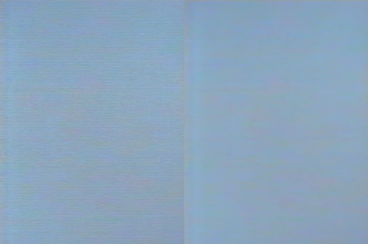

    How to remove such horizontal lines/noise from the image? This is a capture from an HDMI 576p tape from a JVC VCR (deinterlace made by DMR-EH585). QTGMC with InputType=1 cannot handle this, I also tried FFT3Dfilter(), but the effect is mediocre.
    For comparison - these lines are also visible on MPEG-2 capture (made by a different recorder), but there the deinterlace made by QTGMC handles it nicely.
    I'm also attaching a short clip of the HDMI capture.

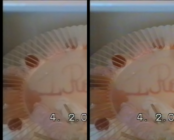

  2. Is it about the chroma noise? playing around: https://imgsli.com/MjM1MzM4
    (typically CCD can be good at filtering such noise, but for me, it seems to be either too light or too strong here.)

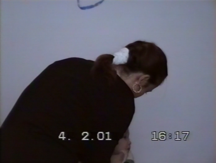

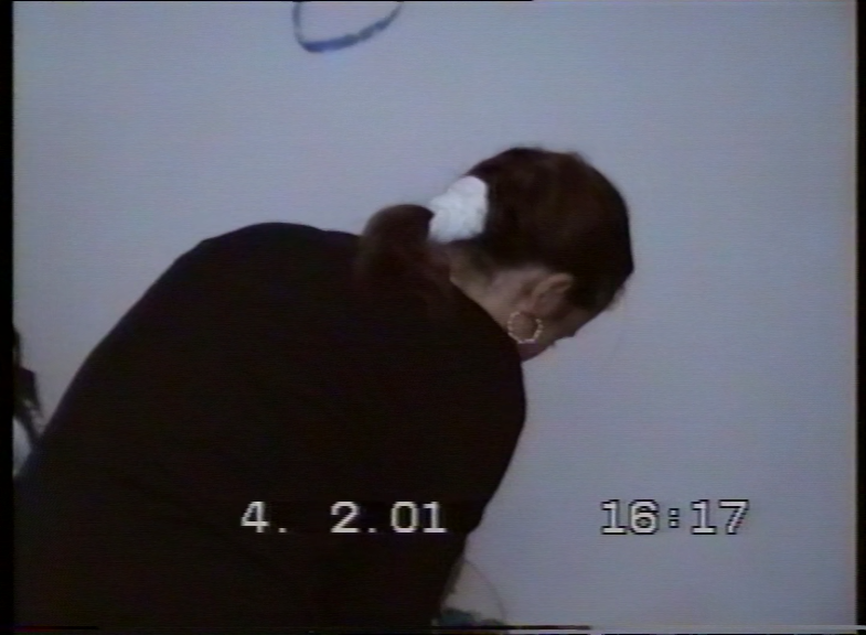

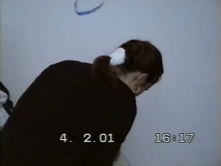

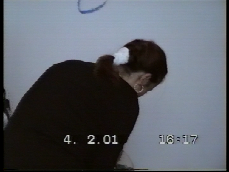

  3. Which horizontal line noise are you talking about? The head switching noise at the bottom of the frame? The light horizontal lines visible throughout the frame? The residual combing on the woman's back (third image)? The occasional horizontal time base errors (most visible around the timestamp in frames 185 to 187 of the video). The little nicks along the woman's back (fourth image, not really horizontal)?

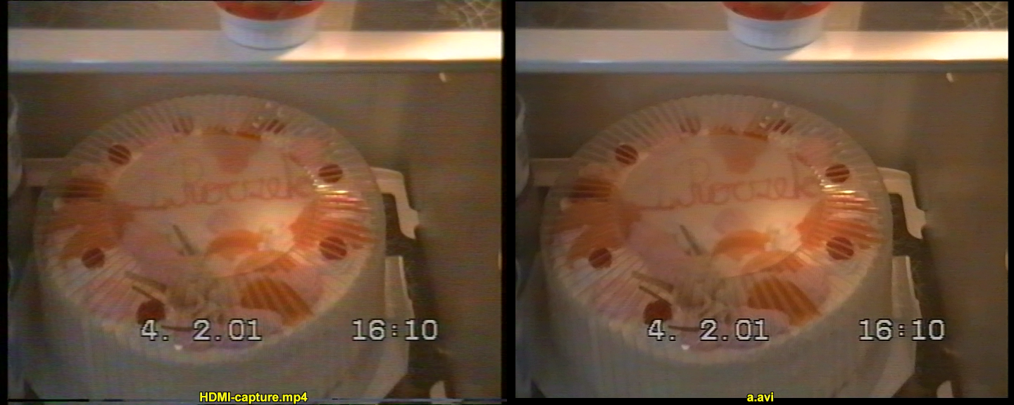

    As complement to what already properly suggested, you can also try a temporal denoise with low radius (to do not erase fine details), i.e.
    TemporalDegrain2() #default degrainTR is 1
    and a bit of sharpening
    LSFmod(defaults="slow")
    Comparison:
    Comparison with slider: https://imgsli.com/MjM1MzY0
    Try to play with TemporalDegrain2 parameters for optimal results, eventually slightly adding a spatial denoiser in TD2 post-processing as KNLMeansCL (postFFT=4) if you wish to remove all remaining noise, but try to not erase the thin vertical lines in the cake
    You can also replace the frames with more evident lines dropout with interpolated frames

    Try with
    KNLMeansCL(d=3, a=2, s=4, h=3.0)
    Wow -- the first attempt was great. Now I will check the details.
Name:	HDMI-org vs klmeans.png

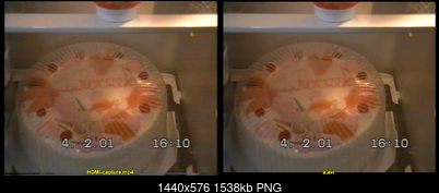

  13. For those lines I did this:
    LWLibavVideoSource("HDMI-capture.mp4", cache=false, prefer_hw=2)
    src = last
    SeparateFields()
    vInverse()
    Weave()
    vInverse()
    # then restore edges that were blurred by the above:
    emask = mt_edge(mode="hprewitt", thy1=30, thy2=30).Blur(1.0).Invert().GreyScale()
    Overlay(src, last, mask=emask)

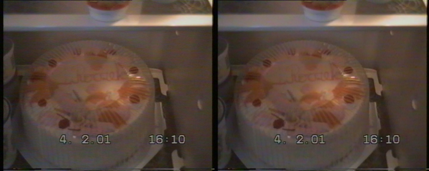

    Frame 5, before and after:
    [Attachment 76435 - Click to enlarge]
    You may need to adjust the edge thresholds depending on the source. This procedure doesn't address all the other problems.
    src = last
    SeparateFields()
    vInverse()
    Weave()
    vInverse()

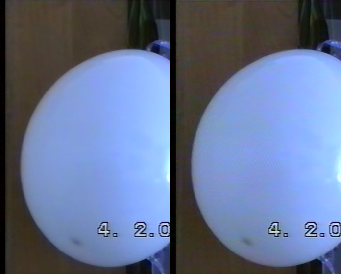

    Wow, great effect! It works great for captures made with the JVC set to Auto, but unfortunately in Edit mode, diagonal lines remain visible on the balloon (attachment).
    In general, I noticed that the JVC Edit mode offers a bit more detail, but removing noise is a hard job.
    If you have any other comments, I'd love to hear them .
    So far, I've had good results using (after vinverse):
    QTGMC(preset="slower",inputtype=1,TR2=3)
    dfttest(dither=1) (or temporaldegrain2)
    converttoyuv420.convertbits(8).lsfmod(strength=125)
    But it is very slow.
