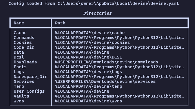

    just did it, but i feel like i am missing something because when i retried downloading smth off tubi, i still got this error. do i have to upgrade, add or remove anything?
    [Attachment 87367 - Click to enlarge]
  4. Did you follow all the steps from this guide but change the parts I said? Did all the steps go through with no errors? also how have you got your devine.yaml set?
    Dec 2024
    [Attachment 87371 - Click to enlarge]
    [Attachment 87372 - Click to enlarge]
    how its set up

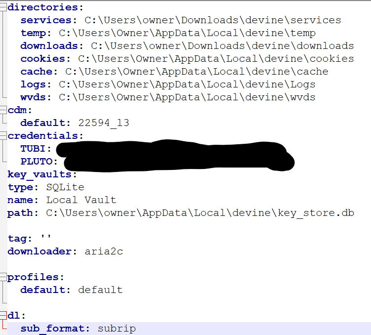

    did you correct the file mentioned earlier for Tubi? This https://forum.videohelp.com/threads/414154-Devine-Modular-Movie-TV-and-Music-Archival-...39#post2759911
    Also, there may be a formetting issue with your devine.yaml, specifically the keyvaults section
    it's imperitive that you have
    key_vaults:
    - type: SQLite
      path: C:\Users\owner\AppData\Local\devine\key_store.db
    the t in type needs to be two spaces from the edge

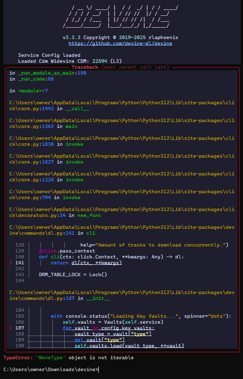

    [Attachment 87384 - Click to enlarge]

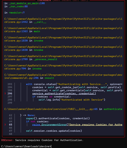

    fixed it and got this error, (tried doing a test on ripping an episode off of pluto)
  8. 2nd Army Bridgeburners. WhiskeyJack's Avatar
    Aug 2024
    Torshavn
    Post up your newly edited devine.yaml
    If possible, not a screenshot
    Dec 2024

    i put my credentials on the thing but i didnt put it here for a reason
  10. 2nd Army Bridgeburners. WhiskeyJack's Avatar
    Aug 2024
    Torshavn
    try this, do note the formatting.

        cookies: C:\Users\Owner\AppData\Local\devine\cookies
        cache: C:\Users\Owner\AppData\Local\devine\cache
        logs: C:\Users\Owner\AppData\Local\devine\Logs
        wvds: C:\Users\Owner\AppData\Local\devine\wvds
    cdm:
        default: 22594_l3
    credentials:
        TUBI:
        PLUTO:
    key_vaults:
    - type: SQLite
    tag: ''
    downloader: aria2c
    profiles:
    default: default
    dl:
    sub_format: subrip
    Dec 2024
    ok thank you
    UPDATE: yooo it works, tysm. ive been dealing with this and nobody helped me, and thank god you was there.

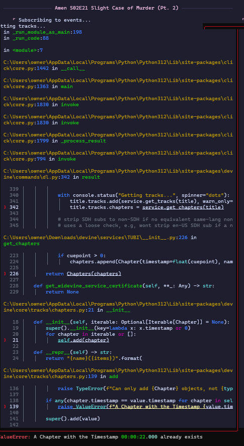

    Dec 2024
    Originally Posted by iamkennethy_ View Post
    y'all know how to fix this?
  14. 2nd Army Bridgeburners. WhiskeyJack's Avatar
    Aug 2024
    Torshavn
    that's a service issue, not your installation. And that video is not available for me, sorry
    But at a guess, try editing the __init__.py file in the TUBI folder in devine services.
    specifically line 17 to
    from devine.core.tracks import Chapter, Subtitle, Track, Tracks
    As I said, that video isn't available to me, and I'm assuming you are using StabbedbyBricks devine services from https://cdm-project.com/stabbedbybrick/devine-services
    This is the previous version of said file.
    https://cdm-project.com/stabbedbybrick/devine-services/src/commit/6567f745472f113661c4...BI/__init__.py
  15. Originally Posted by iamkennethy_ View Post
    Hi there, I'm glad you're sort of getting there, I was going to post my devine.yaml to help you out.
    What service and video is failing for you? maybe I can test it.
    Dec 2024
    [Attachment 87395 - Click to enlarge]
    alright so this is the error im getting rn. also is there a cookies extension for edge (it says firefox and chromium on the github thing) bc i put the cookies in the tubi folder and in the folder where cookies are located (what it says in the yaml file), and it didnt solve the error
    Dec 2024
    resolved this issue by renaming the cookies to js "TUBI" and now im getting "HTTPError: 400 Client Error: Bad Request for url:
    https://uapi.adrise.tv/cms/content"

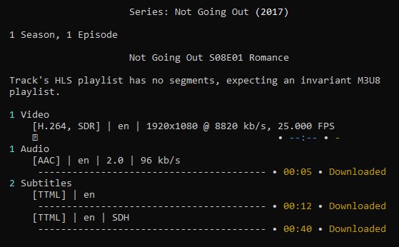

  18. Hi,
    Does anyone have any idea why devine won't download this:
    devine dl iP https://www.bbc.co.uk/iplayer/episode/b088pm6z/not-going-out-series-8-1-romance
    Seems to be something weird about Series 8, the other series download just fine.
    get_Iplayer downloads this okay, but in 720p whereas the rest of the series are available at 1080p.
    The only thing of note I can see in the output is this:
    Track's HLS playlist has no segments, expecting an invariant M3U8 playlist.
  19. Originally Posted by dodgydodgy View Post
    Hi,
    I'm not sure, but maybe there's some kind of broken structure in the season. Try downloading it episode by episode.
    https://www.bbc.co.uk/iplayer/episode/b088pm6z/not-going-out-series-8-1-romance?series...ral-8-b088pm0k

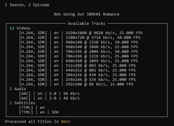

  20. Originally Posted by ListyDoM View Post
    I get the same result with that - it fails to dl the video track, and only downloads the audio and subtitles.

  22. Originally Posted by dodgydodgy View Post
    Hmm, indeed, 1080p does not want to load, probably some issue with the video file
