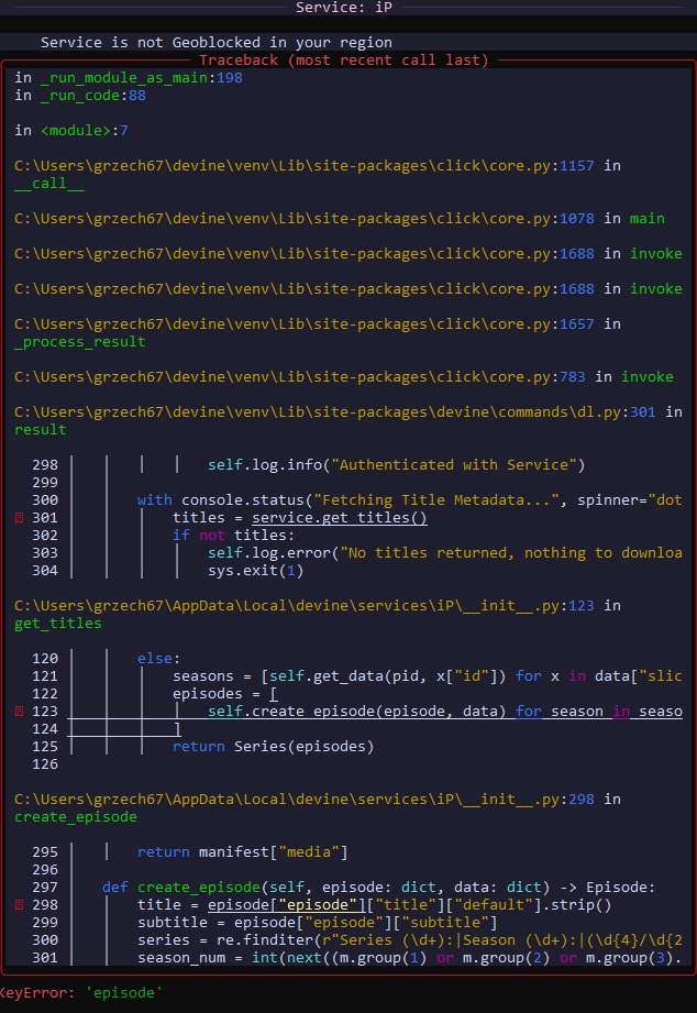

    I'm trying to download a series from BBC: https://www.bbc.co.uk/iplayer/episodes/p0260ych/our-girl , all 4 seasons with subtitles available, when I run devine I have this error :
    [Attachment 84143 - Click to enlarge]
    Where is the mistake or what am I doing wrong, can anyone help?
  15. BBC can be tricky. I've seen my downloads progressing fine only to fail towards the end. Being in the UK, I just disable my VPN and the download then works. Your screenshot doesn't show your command: if you tried to download an entire series at once then I'd suggest doing it an episode at a time.

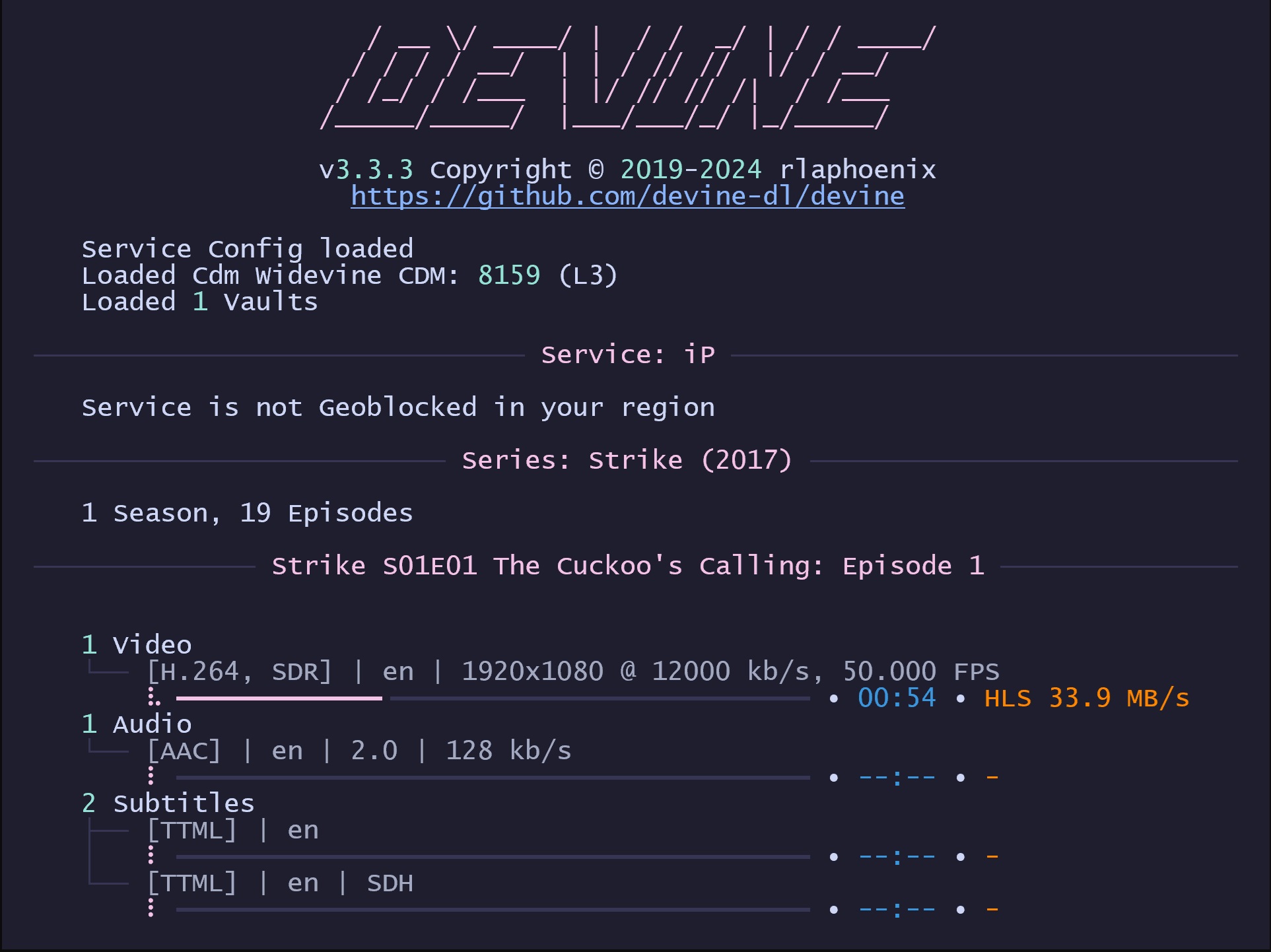

  18. Member
    Dec 2021
    england
    Originally Posted by mickmars View Post
    Hi all, Im trying to download season 6 of BBC Strike, but I cannot for the life of me figure out the season 6 command
    any help would ne most greatfully recieved
    https://www.bbc.co.uk/iplayer/episodes/b093ypxy/strike?seriesId=m0025ydf
    [Attachment 84164 - Click to enlarge]
     devine dl iP https://www.bbc.co.uk/iplayer/episodes/b093ypxy/strike?seriesId=b093ypz9
    nevermind....
    its download episode 1 every different series program

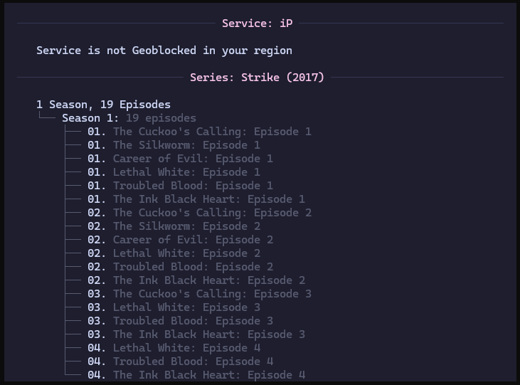

    Nov 2006
    canada
    I appreciate your response, but that is showing downloading season 1 - not season 6
    Mar 2024
    Seems the BBC have messed this up royally. Probably best to download each episode individually.
    [Attachment 84165 - Click to enlarge]
    Nov 2006
    canada
    Thanks Sainty, I am doing that.
