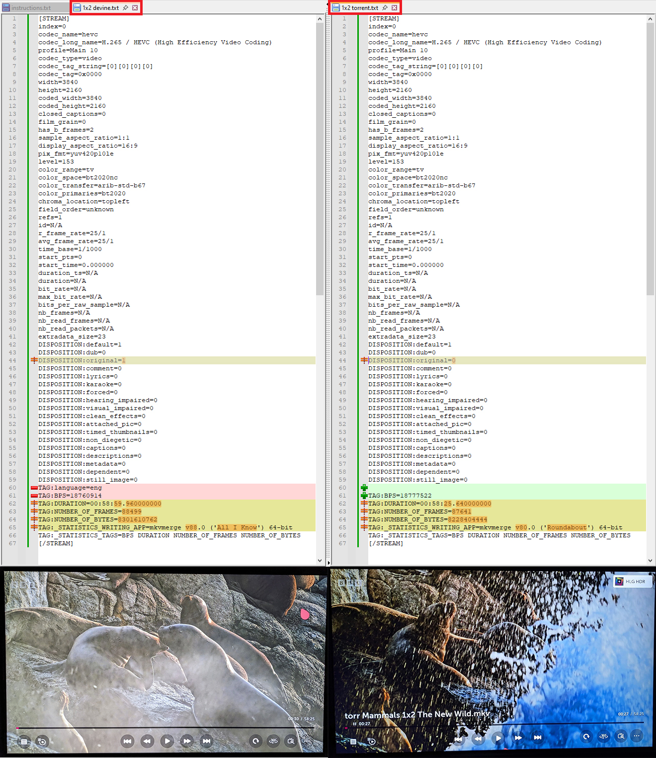

    I have actually found the UHD downloads to be failing myself.
    On the left, a file downloaded using Devine and a L3 wvd that I extracted myself from a rooted Pixel 4a. On the right, the same file downloaded from the torrents.
    The torrented one on the right will play as UHD on my LG TV both via direct play (usb), and through Plex. The one of the left is SD only.
    Mediainfo detects some very minor differences between the files, but from what I can read the "BT.2020" should mean "HDR" for both of them. I am feeling a little lost, and mightily confused.
    Does anyone have some suggestions on what I can try please? Thanks.
    a]
    iPlayer does not use L3 (can change after 2027
    What is even more upsetting to see, is that "stabbedbybrick" also marked the fact in help !!!
    https://cdm-project.com/stabbedbybrick/devine-services/src/branch/main/services/iP/__init__.py
    Security: None
    So you either did not run:
     devine dl iP -?
    Or did not read/understand the output of the command
    Plus now, "Services" are versioned. Thank you very much "stabbedbybrick".
    b]
    The file on the left is also UHD with HDR that is HLG.
    - SD up to 576p
    - HD = 720p
    - FHD = 1080p
    - UHD = 2160p
    - HDR = HLG / HDR10 / HDR10+ / DV
    I am not familiar with LG TVs, but I doubt that your TV will "downscale" to SD,
    can you expand on your statement "The one of the left is SD only." and
    how did you come to that conclusion?
    c]
    MediaInfo - Debug - Complete
    and compare the files (best to also use same S and E)
    d]
    Read the manual for your TV, what resolution/fps/codecs/containers will it play etc.
    e]
    Try editing the file with MakeMKVToolNixGUI.
    - the file on the left has tag for Video as English, set to "und" or not at all maybe could work .....
    (but I am guessing here as I have not come across TV that would downscale HLG to SD)
    f]
    Could it be the heat and the TV may need some cooling (Corona)??
    If I was in politics I make sure you drink plenty of beer
    and watch plenty of TV to keep you busy. | Data is the new oil.

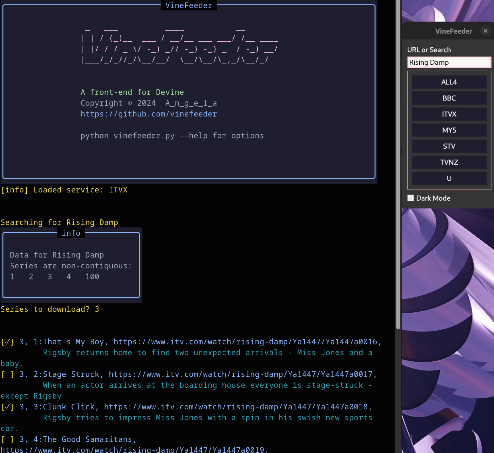

    Try vinefeeder in front of devine. that saves you having to find pids or ids. https://github.com/vinefeeder/VineFeeder
    I am not familiar with LG TVs, but I doubt that your TV will "downscale" to SD, can you expand on your statement "The one of the left is SD only." and how did you come to that conclusion?
    I really appreciate your answer, thank you. Though it looks like when I mistyped SDR as SD I opened a whole unnecessary avenue. My apologies, I know precision is key for things like this.
    The summary of my exploration was that I put both files onto a memory stick and played them one after another. The one I acquired via a torrent triggered the TVs HLG output (shown below), the one from Devine didn't. The command I have run is:
    devine -d dl -q 2160 -r HLG iP https://www.bbc.co.uk/iplayer/episode/m001y4f2/mammals-series-1-2-the-new-wild
    So as far as I can tell I am writing all the correct commands.
    Here's the diffed ffprobe output from two files of the same episode (Mammals s01e02). "Language" and "Disposition" seems to be the only differences other than the length.
    I am investigating this as I can't find HDR versions of Asia anywhere and the Devine download wasn't triggering HDR on my TV. Mammals allowed the comparison.
    Again, with thanks to @pssh I seem to have cracked this by loading the devine-created file into MKVToolNix and setting the value on "Transfer Characteristics" to 18 (rather than the 14 that Devine gave it). This swapped the value from "BT.2020 (10-bit)" to "HLG / BT.2020 (10-bit)".

    Solution
    Running this command on the created file sets the correct HLG transfer characteristics.
    mkvmerge -o output.mkv --colour-transfer-characteristics 0:18 input.mkv
    Here's the list of these 'characteristics' as it's not an area I have explored before:
    0: Reserved
    1: BT.709
    2: Unspecified
    3: Reserved
    4: Gamma 2.2 curve (BT.470 System M)
    5: Gamma 2.8 curve (BT.470 System B, G)
    6: SMPTE 170M
    7: SMPTE 240M
    8: Linear
    9: Logarithmic (100:1 range)
    10: Logarithmic (316.227:1 range)
    11: XVYCC
    12: BT.1361 Extended Colour Gamut
    13: sRGB or sYCC
    14: BT.2020 10-bit systems
    15: BT.2020 12-bit systems
    16: SMPTE ST 2084, ITU BT.2100 PQ
    17: SMPTE ST 428-1
    18: ARIB STD-B67 (HLG)

  13. Originally Posted by Tricky_Vicky View Post
    Solution
    0: Reserved
    1: BT.709
    2: Unspecified
    3: Reserved
    6: SMPTE 170M
    7: SMPTE 240M
    8: Linear
    11: XVYCC
    13: sRGB or sYCC
    17: SMPTE ST 428-1
    Great find @Tricky_Vicky
    I have checked my HLG files both .mp4 and .mkv
    #MKV
    find . -name "*.mkv" -type f | (while read FN ; do echo "$FN: $(mediainfo "--Inform=Video;Transfer_characteristics: %transfer_characteristics%" "$FN")"; done)
    #MP4
    find . -name "*.m*" -type f | (while read FN ; do echo "$FN: $(mediainfo "--Inform=Video;Transfer_characteristics: %transfer_characteristics%" "$FN")"; done)
    and it's only some of my mkv's that have the 14 (BT.2020 10-bit systems) instead of 18 ARIB STD-B67 (HLG)........
    so it could be OS (Win 11 or Debian 12) dependent problem (as I can't remember which OS I have used with Devine to get some of the HLGs)
    or version of MakeMKVToolNix ......
    But looking at the MKV's I have the wollowing:
    Writing application: mkvmerge v80.0 ('Roundabout') 64-bitTransfer characteristics: BT.2020 (10-bit)
    Writing application: mkvmerge v84.0 ('Sleeper') 64-bitTransfer characteristics: BT.2020 (10-bit)
    Writing application: mkvmerge v85.0 ('Shame For You') 64-bitTransfer characteristics: HLG
    Writing application: mkvmerge v88.0 ('All I Know') 64-bitTransfer characteristics: BT.2020 (10-bit)
    Writing application: mkvmerge v89.0 ('And the Melody Still Lingers On (Night in Tunisia)') 64-bitTransfer characteristics: BT.2020 (10-bit)
    nano $HOME/MITemplate.txt
    General;Writing application: %Encoded_Application%
    Video;Transfer characteristics: %transfer_characteristics%"
    find . -name "*.mkv" -type f | (while read FN ; do echo "$FN: $(mediainfo --Inform="file://$HOME/MITemplate.txt" "$FN")"; done)

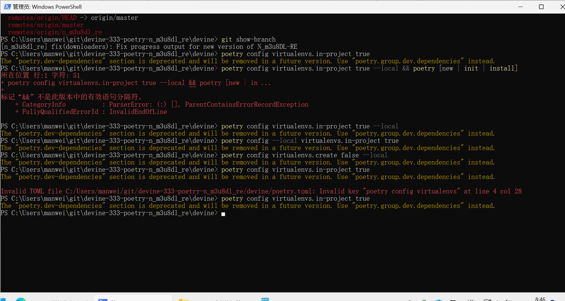

  16. Originally Posted by p1020 View Post
    [Attachment 84994 - Click to enlarge]
    i dont know what happan
    This is what works for me
    cd $home
    mkdir -p ~/git/devine-333-poetry-n_m3u8dl_re;
    cd ~/git/devine-333-poetry-n_m3u8dl_re;
    # Clone a repository into a new directory;
    git clone -b n_m3u8dl_re https://github.com/stabbedbybrick/devine.git
    cd devine
    # Check LOG for latest changes (press "q" to quit the log);
    #git log
    # Check BRANCH;
    git branch
    # List both REMOTE-tracking branches and local branches;
    git branch -a
    # Check BRANCH and their commits;
    git show-branch
    # Poetry 2.x.x removed "shell" and add it as "Add-On" so it needs to be installed;
    #poetry self add poetry-plugin-shell
    poetry config virtualenvs.in-project true
    poetry install
    poetry shell
    but you started to MIX and MATCH
    and then you fire up
    poetry config virtualenvs.in-project true --local && poetry [new | init | install]
    you get an error and again you fire up
    and "--local" after config
    poetry config --local virtualenvs.in-project true
    Is there any reason why?
    https://python-poetry.org/docs/configuration/#local-configuration

    Quick question, How do i download one series from ITV, when there are 4 series of the show ?
    Cheers
    Mar 2006
    Cheers
    What show?
    I needed to finish a few episodes of Brockmire earlier:
    devine dl -q 720 -w s02e04-s02e08 ITV https://www.itv.com/watch/brockmire/10a5428
    This could work for Brockmire as there are 8 episodes:
    devine dl -q 720 -w s02e01-s02e08 ITV https://www.itv.com/watch/brockmire/10a5428
    Also, this would work:
    devine dl -q 720 -w s02 ITV https://www.itv.com/watch/brockmire/10a5428
    But it may depend on the show. So, example??
    Nov 2006
    canada
    Cheers
    What show?
    Thanks, your third example works perfectly
    https://www.itv.com/watch/rising-damp/Ya1447
    Feb 2022
    Search the forum first!
    Cheers
    There is always an easier way.
    [Attachment 85040 - Click to enlarge]
    Noob Starter Pack. Just download any Widevine media! Over 22,000 downloads for V6!.
