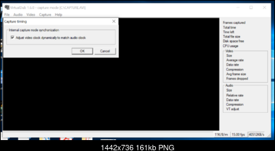

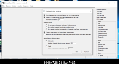

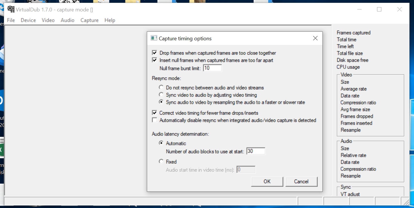

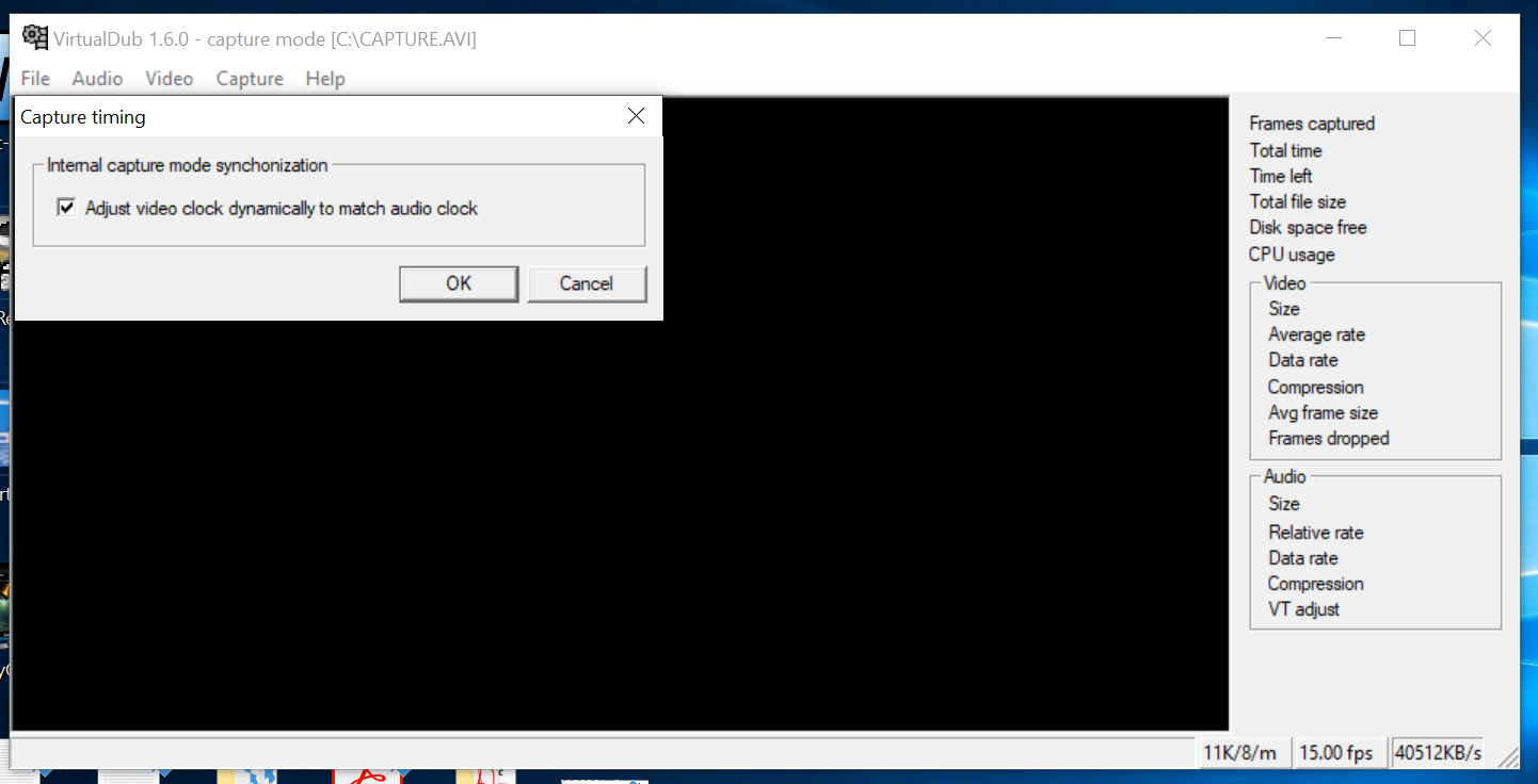

    VirtualDub is a wonderful piece of softwre. Concerning its capturing features, its core engine ws developed when the audio and video streams were captured by 2 different cards. Because the internal clocks of the 2 cards can never be exactly the same in term of frequency spread and jitter, without a "correction", the synch between audio and video is progressively lost across time. That's why you sell all that setting/options in the VirtualDub -> Timing... sub-menu, to resynch audio and video in different ways.
    When cards with integrated audio/video capture capabilities have been available, Avery Lee added that option "Automatically disable resync when integrated audio/video capture is detected", which disables all resynch features.
    Unfortunaly, with moder hardware and OSs, this does not alway works well, and VirtualDub may produce asynch captures even with a prefect workflow, including all necessay time base corrections (you can find many exaples of it in videohelp forums and digitalfaq forums.
    On the other hand AmarecTV has not this problem, and in presence of a clean input signal, it guarantees a prefectly synch audio/video capture, even when few frames are dropped or inserted.
    If you use a custom graph for capturing, the a//v synch only relies on the AVImux Microsoft filter, and in case of loss frames (note how here I do not specify dropped nor inserted), the synch is not guaranteed.
    About the specific testbench of which you are reporting the results, is indicative of the AmarecTV strength about a/v synch, but it is a borderline case where the tape has defects. For sure is better to have a better capture even in presence of major problems in the flow of the stream, but the priority is to clean as much as possible the video, prior to capturing.

    P.S.: here some capture of old VirtualDub versions where the change I was referring to was introduced (version 1.5 in 2003 and version 1.7 in 2004):
