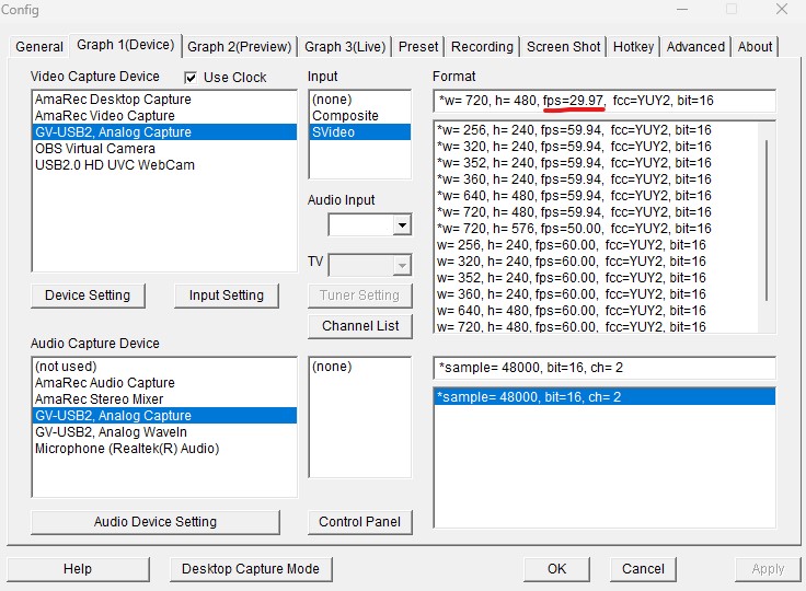

  5. I don't know if it's related but with with my avermedia U3 card, the 25 fps options don't show up in amarecTV after booting the machine until I open virtualdub and set the device to PAL in the device settings there first for whatever reason. I have not had that happen with the GV-USB2 that I use on the same machine though.
    Try Crossbar Thing.

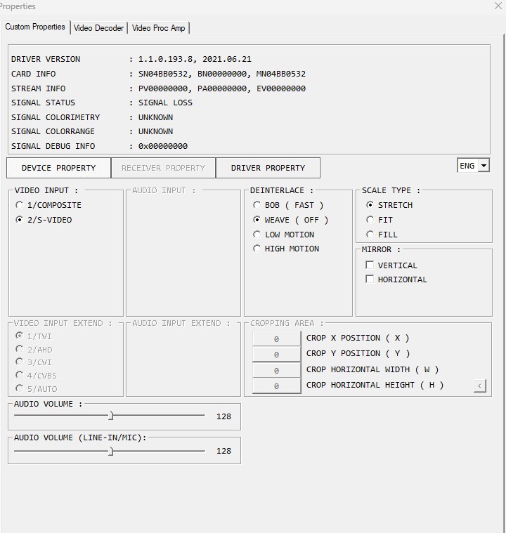

  7. Originally Posted by Alwyn View Post
    @lovethisnation, I say again, delete AmarecTV.ini and restart it.
    If that doesn't work, In Device Manager, "uninstall" the GV-USB 2, reboot your machine, then re-install the GV-USB2.
    1. I deleted AmarecTV.ini and restarted it, it didn't work
    2. I uninstalled GV-USB2 and restarted then re-installed GV-USB2 and that didn't work either.
    3. I deleted AmarecTV and re-installed and that didn't do it either.
    The driver version I get from the website download 1.1.0.193.8 does not have an option to select the 24.97 FPS using AmerecTV. Perhaps other prior versions did, but not this one. However, it does let me change the textbox but I have to manually type in the textbox and click ok. I verified the capture at 24.97 after i did this.
Name:	Screenshot 2023-06-22 204118.jpg

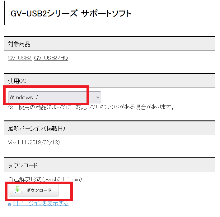

    Oct 2018
    Scotland
    @lovethisnation Just picked up a GV-USB2 and I'm having the exact same issue with the latest driver using Windows 10 64bit. Rolled back from driver gvusb2_112.exe to gvusb2_111.exe and now have PAL 720x576 25fps.
    gvusb2_112 shows driver as 1.1.0.193 dated 6/7/2021
    gvusb2_111 shows driver as 1.1.0.93.5 dated 28/6/2010
    https://www.iodata.jp/lib/software/g/1780.htm
    Just click Windows 7 on the drop down and download driver 111. Runs under Win 10 also. You'll need to enter serial no from the card then driver should download. hth
    [Attachment 73299 - Click to enlarge]

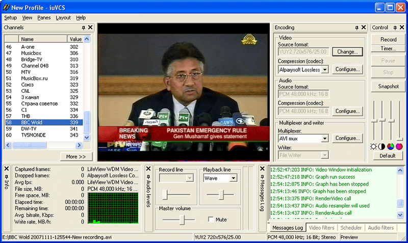

  23. Capturing Memories dellsam34's Avatar
    Jan 2016
    Don't use iuVCR, Use iuVCS, it's newer. It too geared towards tuner cards like vdub but it's slightly simplified.

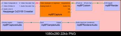

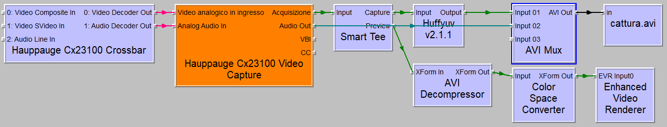

    To understand the routines used by the capture software, the DirectShow filter graph must be "hacked". You can do this using a specific DLL, called DirectShowSpy.dll. You then run the software, and while it is capturing you can extract its built graph.
    This link can be used as reference, there are others: http://alax.info/blog/777

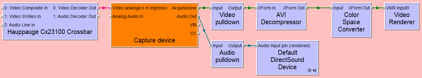

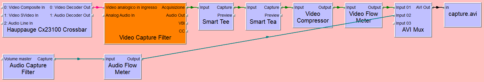

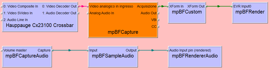

    Here the architecture of the 3 main capture sofware:
    VirtualDub 1.9.11:
Name:	REMOTE !FilterGraph 00D5C3C0 pid 00002af0.png
    AmarecTV 3.11:
Name:	REMOTE !FilterGraph 06DD1BB0 pid 00000fdc.png
    VirtualVCR2.6.9:
Name:	REMOTE !FilterGraph 02f7e990 pid 0000250c.png
    The architecture is similar, but the filter used for capturing the audio is different in VirtualDub, to allow the internal software-synch of the audio and video streams, often causing problems.
    When you mash together broadcasting and capturing, bad things can happen.
    In addition, you can also note that your non sense about "broadcast" / "streaming" architecture is really out of contest, and just "smoke in the eyes" to confuse newbies.
    Specifically, in this case, how intermittent data loss (of which dropped frames is one) is handled by the software. One stumbles through the lost data (as designed, for data flow continuity), the other halts/errors/logs on lost data (as designed, for absolute data integrity).

    I absolutely agree. I often use my own capture software, developed by me through GraphEditNext.
    Of course, it has its flaws, caveats, concerns as well.
    This is one of its architecture:
    In video, sometimes we have to use the least-worst option. No best exists, no perfection exists.
    I absolutely agree. What happens is just that in general AmarecTV is better than VirtualDub for A/V synch.
