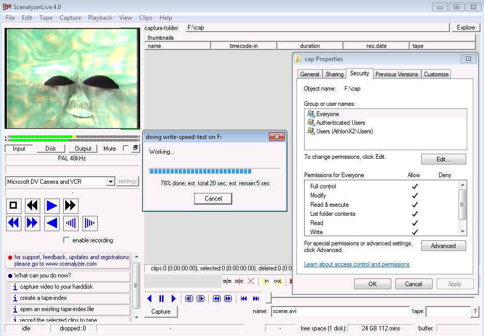

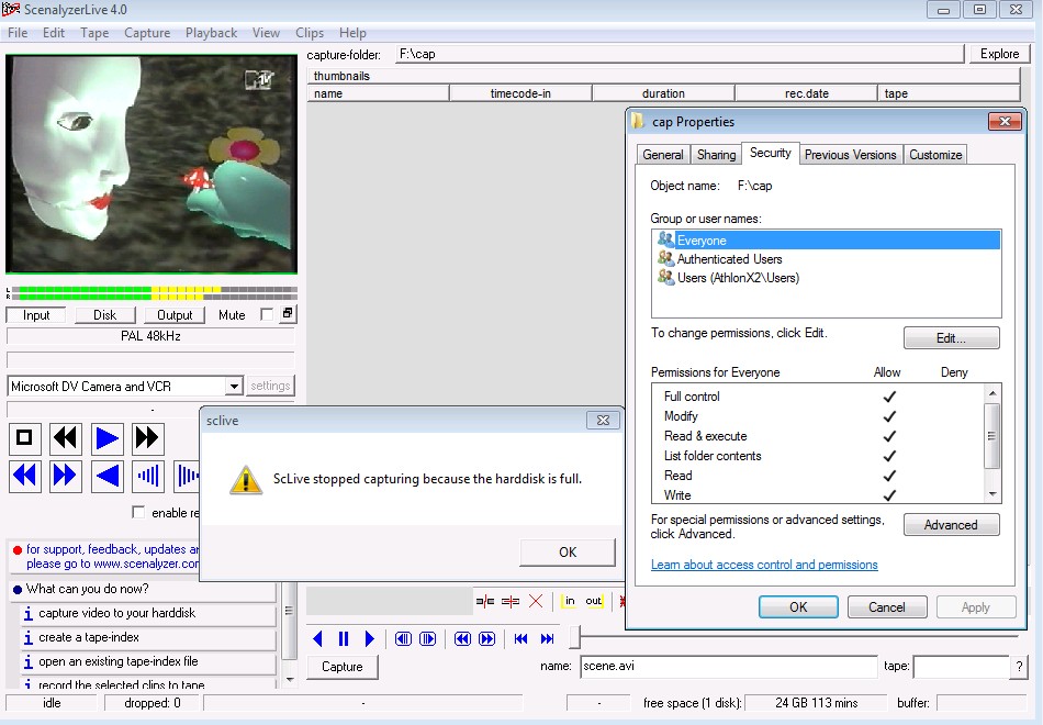

    Indeed, something unusual must be happening when Scenalyzer is using the capture disk(s), because now i have been able to reproduce the exact same situation again here too on one of my external disks.
    I can copy files to it with other programs and even the Scenalyzer disk write speed test gives no problem on the same disk??
    I will test more later if i can find the explanation of this strange problem.
    [Attachment 78468 - Click to enlarge]
    [Attachment 78469 - Click to enlarge]

    Possible i have found a cause/solution to the irregular behavior of Scenalyzer when trying to capture.
    First i changed the compatibility mode to XP/SP3, this made it work capturing to the stubborn HDD/partition.
    Running as administrator also worked for me.
    Then i turned off the User Account Control (UAC) and restarted the system.
    I normally had this turned off also on my other capture PC.
    This seems to solve the problem with Scenalyzer.
    Also creating a new capture folder with Scenalyzer now works, that also failed earlier.
    Try this if it works for you?
