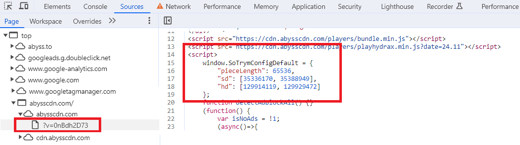

    Hello. I've been trying to find a way to download a higher quality (in this case 720p) of the demo bunny video from abyss.to for some days and I haven't found any solution. I was wondering if there's anyone who can give some pointers at least as to how to do it. The video is found at https://abyss.to/ and has available a lower quality of 360p but that can be downloaded without problems. The steps I've used are the following. I first filtered the network requests and looked for tunnel.
    [Attachment 76132 - Click to enlarge]

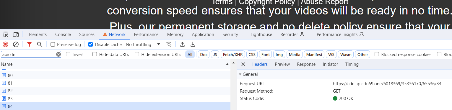

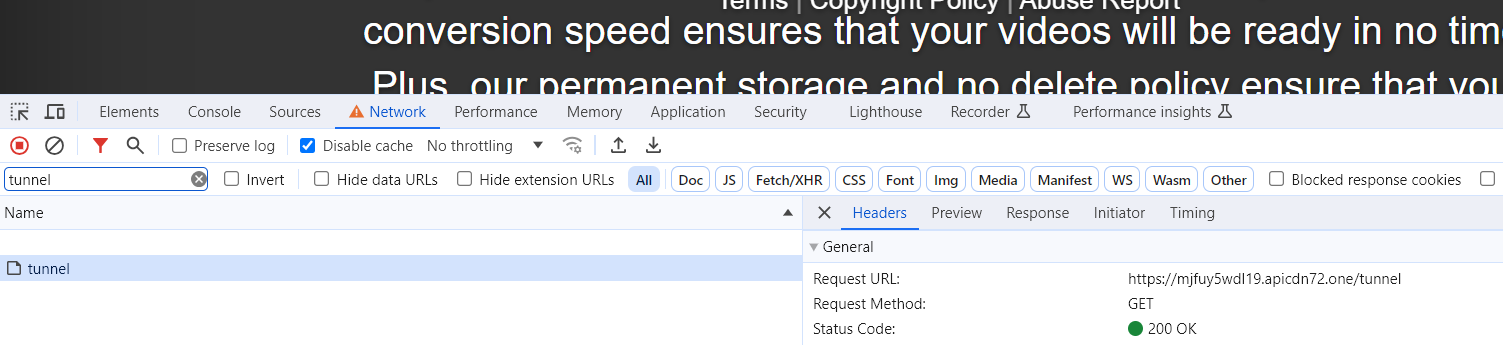

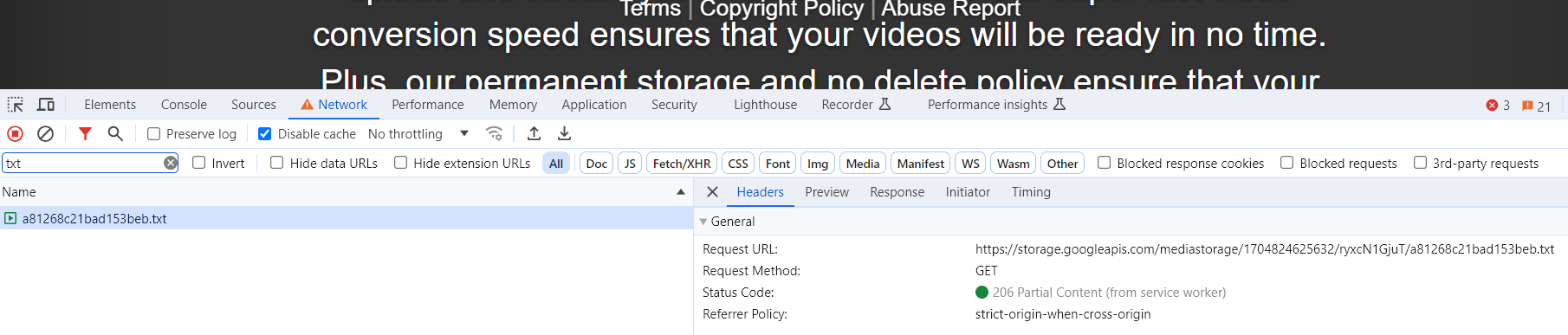

    Then I filtered the network requests and looked for txt. That Google link is where the video is found but cannot be accessed directly.
    [Attachment 76133 - Click to enlarge]
    I then combined those 2 URLs and used the following curl command (I think that the link found at the tunnel request may vary).

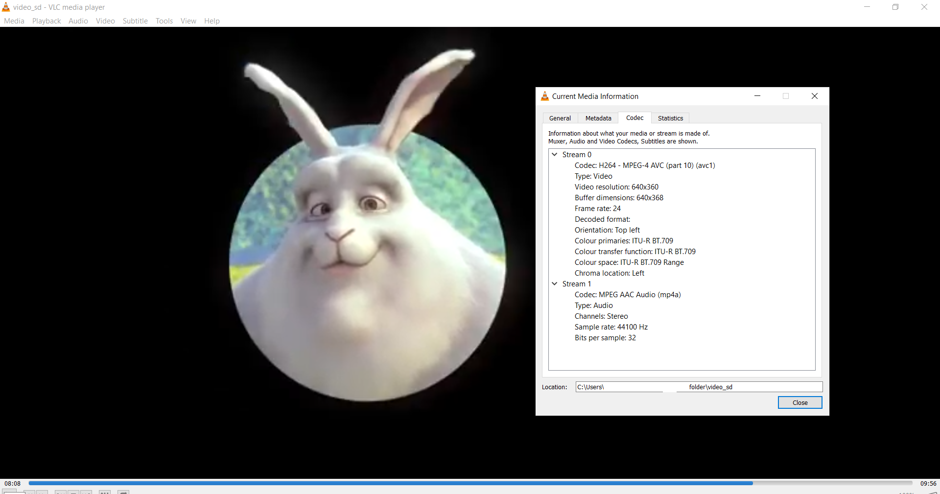

    Then I checked the downloaded video and it's 360p. The video is working.
    [Attachment 76134 - Click to enlarge]

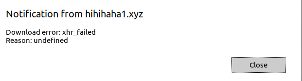

    My problem is that I don't know what exactly to modify to the request to get the 720p video. Or if it's even done in the same manner. A failed attempt to get the 720p video was to look for the requests that are getting parts of the video such as in the next image.
    [Attachment 76136 - Click to enlarge]
    I wrote a bash script that downloaded all the fragments. Each fragment then seemed to be some base64 encoded content. I then decoded it and appended all the files into a single file. I tried playing it and the player detected its full duration but only the first 20 seconds or so were working, the rest of the file was corrupted and couldn't be played. That being said I don't know what to try anymore and was wondering if someone can give some pointers at least.

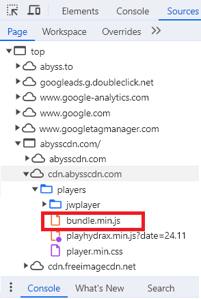

    2. Go to Sources -> Page and try to find the "bundle.min.js" file since that's where the "magic" happens.
    [Attachment 76178 - Click to enlarge]
    3. Ctrl+F and search in the js file for "prototype.put". Modify that function according to the next source code. I added some comments in the code to guide you better in understanding it. Only do this step if you understand what it does because I claim no responsibility if something goes bad, etc., etc. yada, yada.

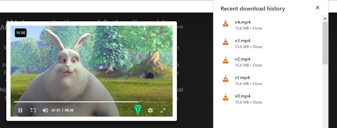

    6. Load the video and set it to the highest possible speed. The goal is to force the video player to request all video fragments (1983 in this case). And to do that you need to "watch" the whole video. What if 2x is too slow especially if you want to download a 3-hour movie? Then you can install a browser addon that lets you set an even higher speed. I personally use the "Video Speed Controller" addon and I have set it up to 16x speed. That means a 3h movie "could" be downloaded in ~12 minutes which is not that bad (ignoring the internet speed of course).
    [Attachment 76168 - Click to enlarge]
    Simply put the highest speed and let the video play out until the end (personally I let it play in the background while it downloads). If the video player gets stuck then simply go backwards 10 seconds using the video player interface. The JS code from step 3 makes sure that each fragment is sent only once and no duplicates happen.
    Make sure your browser downloads by default in your folder of choice and also that it downloads without asking you the path. The first batch of downloads may be blocked by the browser because they are too many. You need to temporarily enable "Automatic downloads" for your specific site. Don't forget to disable it back after you're done with the video!
    To save time, when the downloads happen you can check the v0.mp4 (the first fragment). If it can be played in your local video player (the first 2-3 seconds at least, since it's just a fragment), then there is a high chance that the entire video may be good. Otherwise, close the browser to stop downloading since it won't work for your specific site.

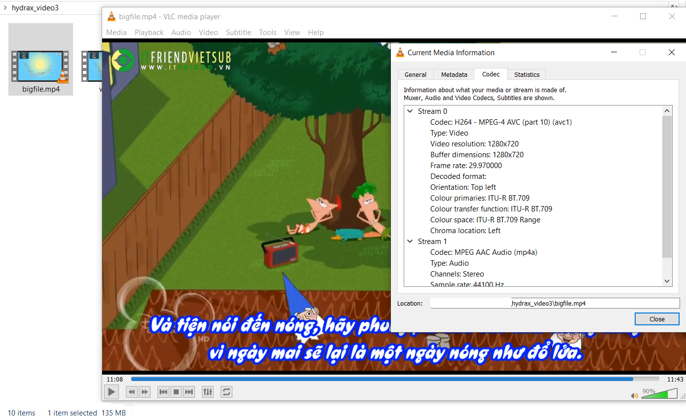

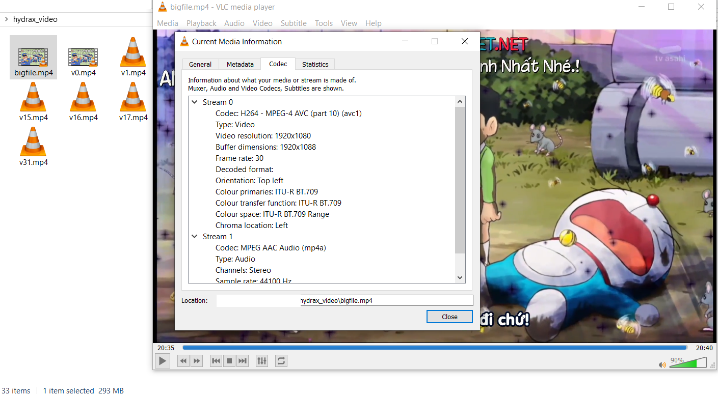

    8. The resulting mp4 file is your fully downloaded video. Check if it's a valid file by playing the video and that's it, done.

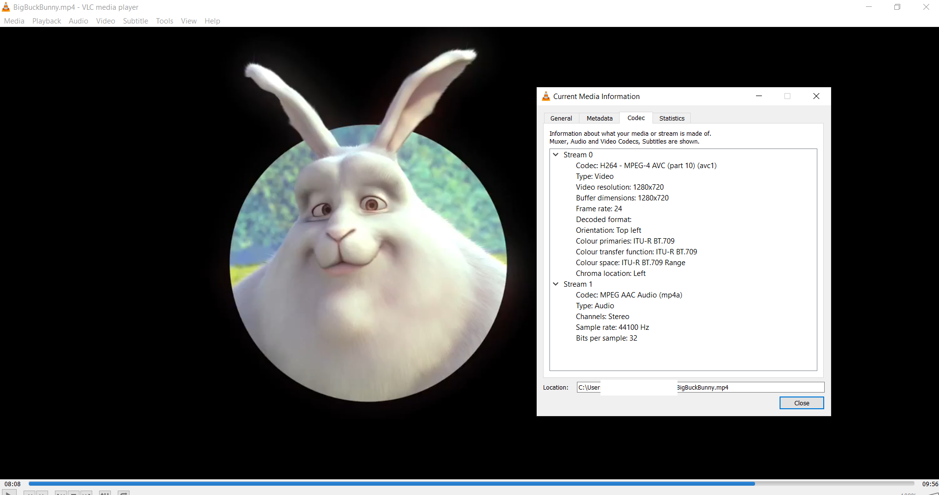

    Out of curiosity, I checked if the downloaded file is the same as the one uploaded on mega.nz in the first post reply and they match indeed.
    [Attachment 76169 - Click to enlarge]

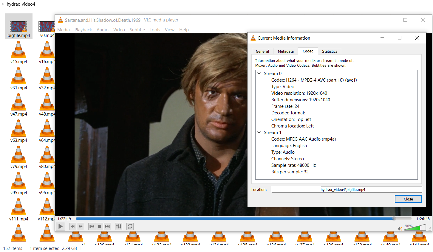

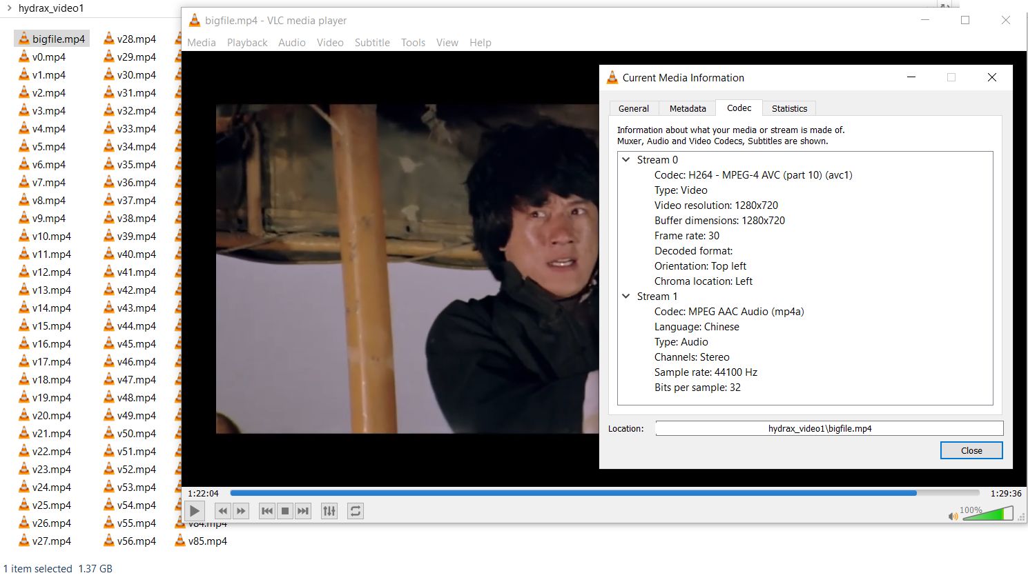

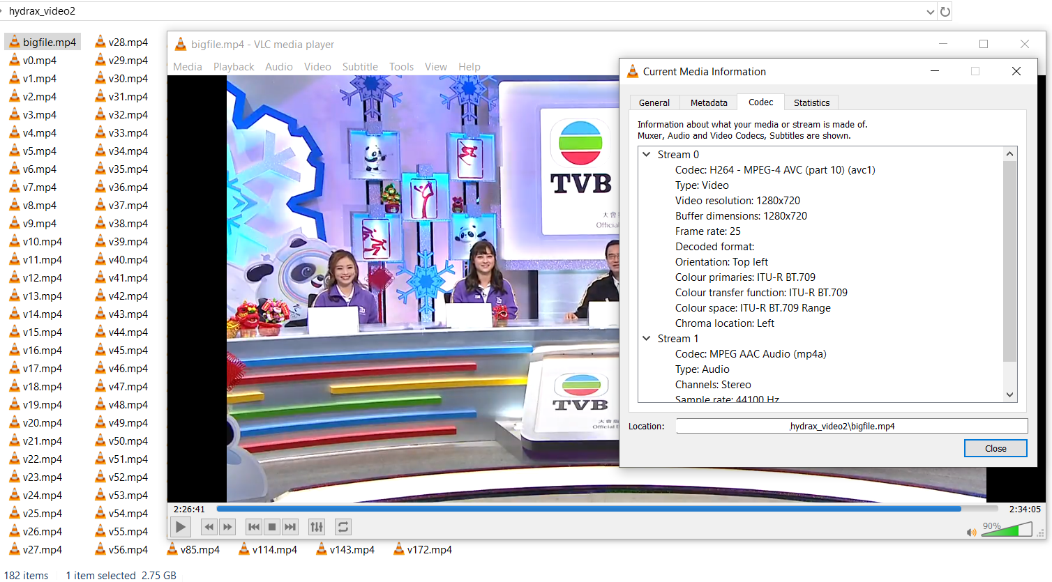

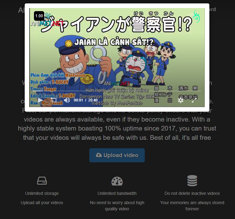

    Now I wanted to test this solution more so I grabbed some hydrax videos from past videohelp forum posts and I added some of my own.
    https://clbphimxua.com/biet-doi-rong-1983/
    [Attachment 76170 - Click to enlarge]
    https://vlist.se/hydrax.html#OHBuc0c4VE41
    [Attachment 76171 - Click to enlarge]
    https://thiendang.vn/movie/s1e2-lawn-gnome-beach-party-of-terror/
    [Attachment 76172 - Click to enlarge]
    https://ww1.m4uhd.cc/watch-movie-passa-sartana--lombra-della-tua-morte-1969-255412.html
    [Attachment 77864 - Click to enlarge]
    Even though it works for the previous sites, it couldn't possibly work for all of them. So I began looking for places where it doesn't and found this one:
    https://animet.net/phim-doraemon-new-tv-series-tap-688-1591.138916.html (use the Hydrax player - HRX#1).
    But at least as a starting point, it looks good. If you were interested only in the practical part of this solution then you can skip entirely the next theoretical part.

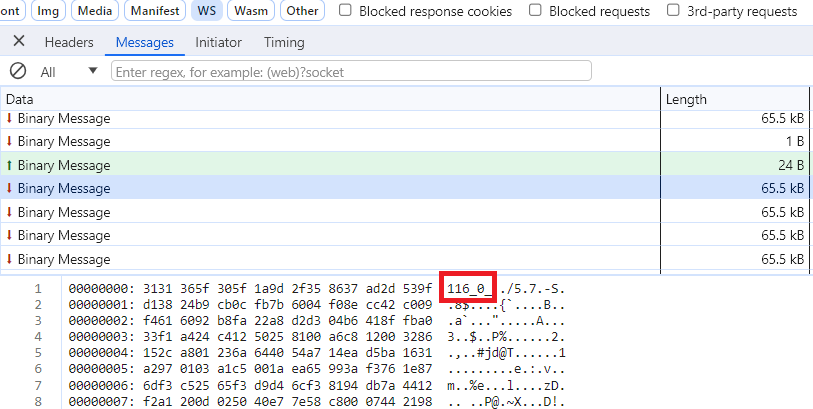

    The worst that could happen with the JS code approach is that they simply obfuscate the code even more. The main idea should remain the same. Moving on, knowing the video was sent somehow with WebSockets, I needed to find a fragment.

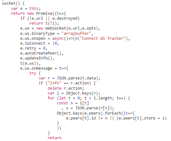

    [Attachment 76175 - Click to enlarge]
    That fragment contains additional data that is used in maintaining their websocket protocol. And even if you captured that fragment, you still needed to "alter" it somehow to construct the full video. Knowing that the video fragment needs to be sent to the video player, then there is some piece of code that alters it. All I did was find a random function that handles the final video fragment and especially receives as another parameter, its index.

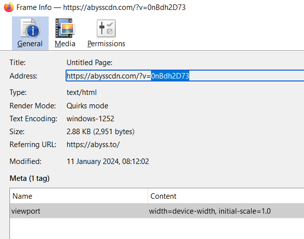

    1. In the first step go to your site and get the video ID by opening the "Frame Info" (as explained in the hellabyte solution). Then keep in mind the resolution you want from that video (1080p for example). This is all the information you need and you can close that site now because it's of no use anymore.

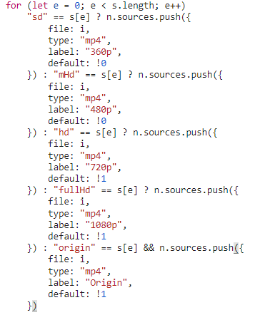

    Those variables are used to load a specific video into the JW player. So obviously, if we want to attach a video from one site to another, we would need its initiating base64 value. The Python script below does that. It uses the video ID and extracts the base64 value by sending a GET request to the player URL and by using regular expressions.

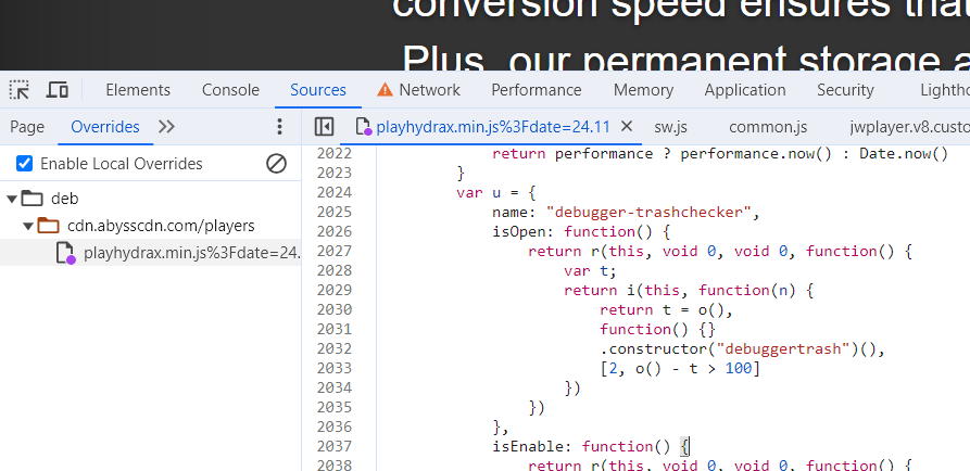

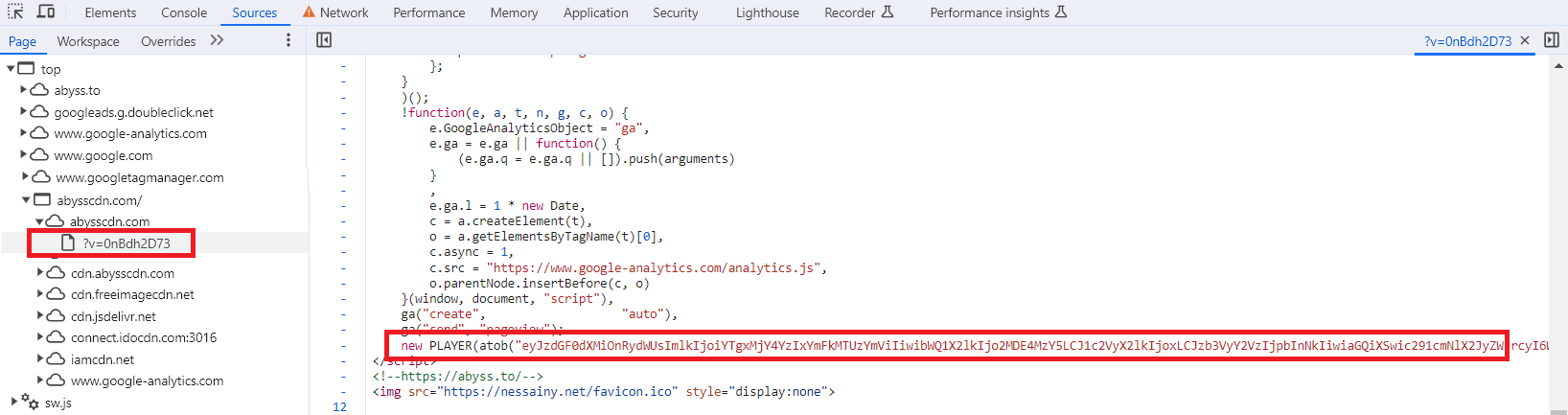

    4. Load the chosen page. Break its debugger detector. Try to find the page in the Sources tab that deals with the JW player creation. The code may look something like:
    new PLAYER(atob("string"))
    [Attachment 76189 - Click to enlarge]
    Replace the atob parameter with the base64 value returned by the Python script from step 2. Reload the page and you should now see your video attached to it, instead of the old one. Interestingly, if you hover over the video bar, you will get previews of the old video. However, that is no problem so don't worry.
    [Attachment 76184 - Click to enlarge]

    [Attachment 76186 - Click to enlarge]
    So if you attached a video for which you know for sure 1080p is available, you will be interested in the "fullHd" value. Then look again in the sources tab and try to find where the resolutions are configured by default. Usually, that piece of code is found in the same page as the PLAYER initialization from step 4.
    [Attachment 76187 - Click to enlarge]
    If you don't see your wanted resolution written in that piece of code, simply add it together with some random values. It seems that they don't matter that much. Doing that, you will get something like this:
    window.SoTrymConfigDefault = {
       "pieceLength": 65536,
       "sd": [35336170, 35388949],
       "hd": [129914119, 129929472],
       "fullHd": [1, 2]
    Override the source code. Now reload the page, set your wanted resolution, and refresh a couple of times. If your specific resolution is set by default properly that's it, done. You can now download the video by following the tutorial from the batch JS method. Initially, it didn't work on the problem site for some unknown reasons but on this one where we attached the video it works.
    [Attachment 76188 - Click to enlarge]
    Now concluding. In theory as of now, the attaching method + batch JS should work for any hydrax video on any site you want and with any level of quality you need. You are not relying anymore on external sites and have a little more freedom of choice. The best thing is that you don't even care about their websocket streaming protocol since you "intercept" their raw video fragments by using the JW player as an intermediate. Of course if the "bundle.min.js" file from hydrax changes then the batch JS solution needs to be modified for another function of interest that deals with video fragments. But that remains a problem for the future.
    If someone finds a site where the entire explained method doesn't work then I'll gladly look into it.
    I downloaded it from hellabyte to compare the video fragments. Funnily enough, the original bad file I got was almost the same size as the one from hellabyte. A couple of kilobytes were missing. My guess is probably the debugger detector is messing with something and I didn't notice. But at least you can completely ignore any source site now by attaching the video somewhere else.
    Edit: as of 15-aug-2024, they refactored some code. The trick is 99.99% identical, except you apply it to the file "core.bundle.js" and you look for the text "? (clearTimeout" to find the place where you inject code.

    That's a Python script. You replace <VIDEO_ID> with the hydrax ID taken from the frame info. And you replace the DOWNLOAD_RES value with the value of your wanted quality (360p, 720p, or 1080p). It will try to download that resolution or at least the next highest one. So if you want to try 1080p for a 720p max video only, you will get 720p.

  22. is it still working solution? i've tried to download the video from m4uhd and I got the error Image
    [Attachment 79545 - Click to enlarge]
  23. Try the python downloader
