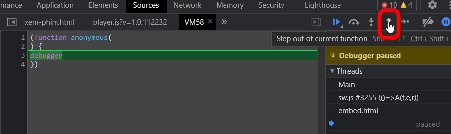

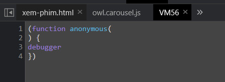

    When playing the video on chrome (make sure its the actual video but not the ads), press F12 to load devtools. Once it detects devtools/debugger, it triggers "Paused in debugger".
    And you can see this function-anonymous-debugger on devtools:
    [Attachment 58922 - Click to enlarge]

    On upper right of the 'Sources' tab of devtools, click 'Step out of current function':

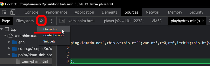

    On left panel part, find and click 'Overrides':
    [Attachment 58924 - Click to enlarge]
    Then under 'Overrides' tab, click '+ Select folder for overrides' and choose a folder to store files. I just created a folder 'chrome_overrides' on my desktop.

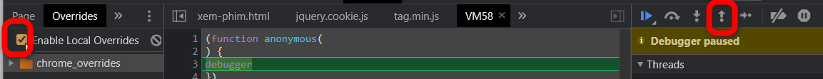

    Start over again. Close devtools, refresh the webpage, play the video, press F12 to load devtools, and the debugger paused again.
    This time remember to check 'Enable local overrides' under the 'Overrides' tab.
    And click 'Step out of current function':

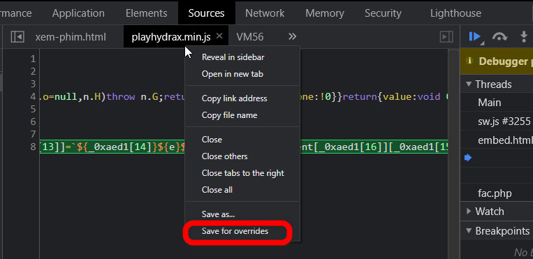

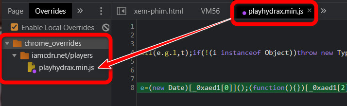

    Now we're at the javascript file playhydrax.min.js, right click it and select 'Save for overrides':
    [Attachment 58927 - Click to enlarge]
    Then you should be able to find it under 'Overrides' tab:
    [Attachment 58928 - Click to enlarge]
    If you can locate this file on the 'Network' tab, you can also right click it and select 'Save for overrides' there.

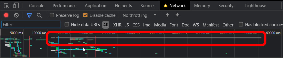

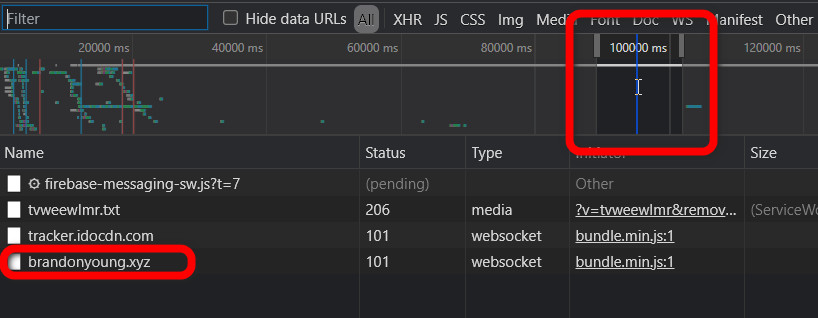

    Play the video for a while, on the devtools 'Network' tab you'll see a long bar and it's getting longer and longer:
    [Attachment 58931 - Click to enlarge]
    Click on it and use mouse scroll to adjust the size of interval:
    [Attachment 58932 - Click to enlarge]
    (Usually this method does not work on m3u8 and mpd but it works in this case.)

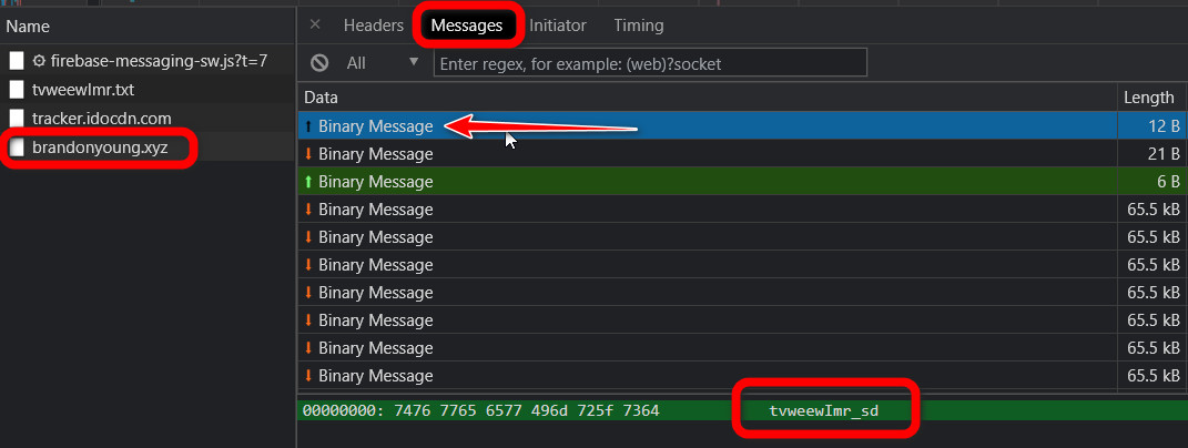

    Only couple items left on the left panel, and I finally found brandonyoung.xyz is the one we want.
    Click on it and on the right side, check 'Headers' and 'Messages' to see:
    On 'Headers', we need to copy down some info:
    Request URL: wss://brandonyoung.xyz/ (this is websocket server)
    Request Headers -> Origin: https://geoip.redirect-ads.com (without this, the server will not respond)
    On 'Messages', you'll see a lot Binary Message receiving from the server:
    [Attachment 58933 - Click to enlarge]
    Scroll up to the top and find the very first Binary Message that we sent to the server.
    Click it and on the bottom you can copy down the message:
    First message sent to the server: "tvweewImr_sd"
    The message is basically the vid "tvweewImr" plus the video quality "sd".
    If you check the second message which is the response from the server: "sd_254620732_65536_sd"
    Here "254620732" is the total bytes of the video, and "65536" is the size of one segment.

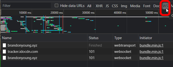

    Btw, since we know it's websocket transfer, we can click on 'WS' (WebSockets) right to the filter box to quickly locate it next time:
    [Attachment 58934 - Click to enlarge]
