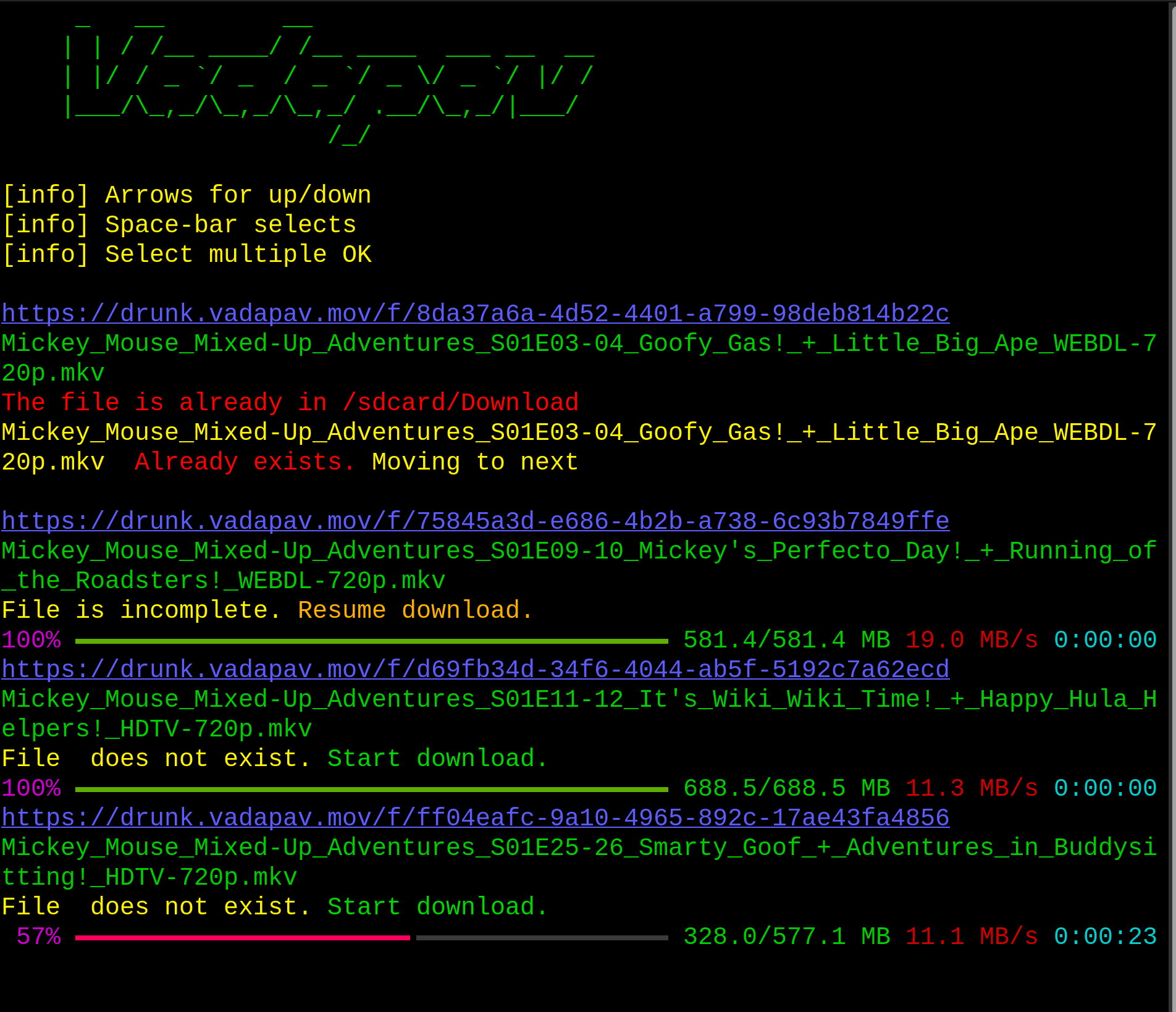

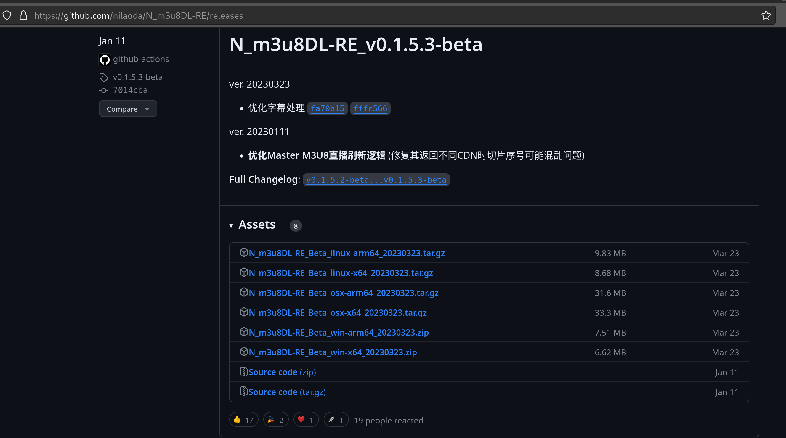

    A while ago I posted about decrypting on your Android Phone. That post is still sound but it deals with key finding, using WKS-KEYS, downloading with yt-dlp and decrypting, mainly by hand. We now have scripts and N_m3u8DL-RE to play with
    The above linked post is a little out of date now we have N_m3u8DL-RE as a fast all-in-one downloader. But scripts, generally, are more available to do the grunt work of downloading.

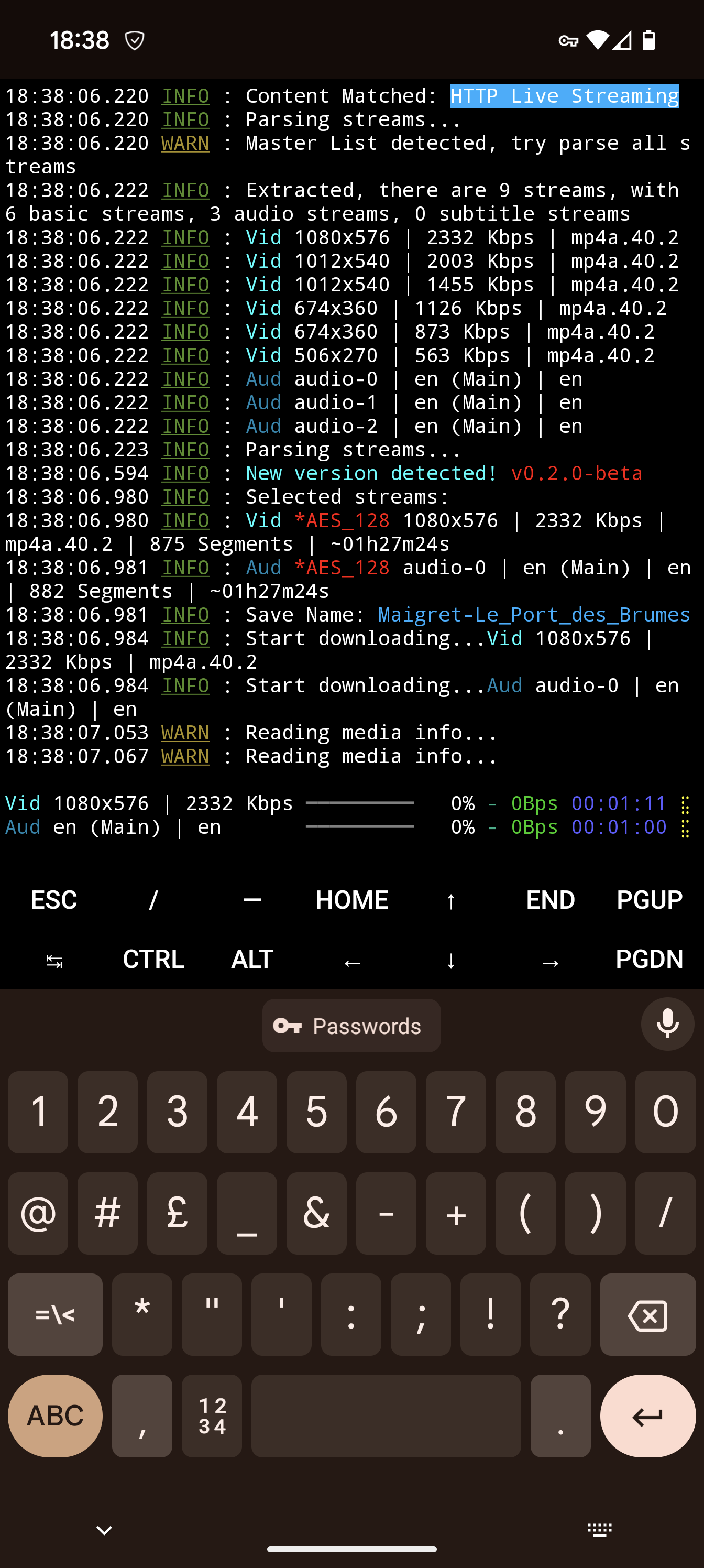

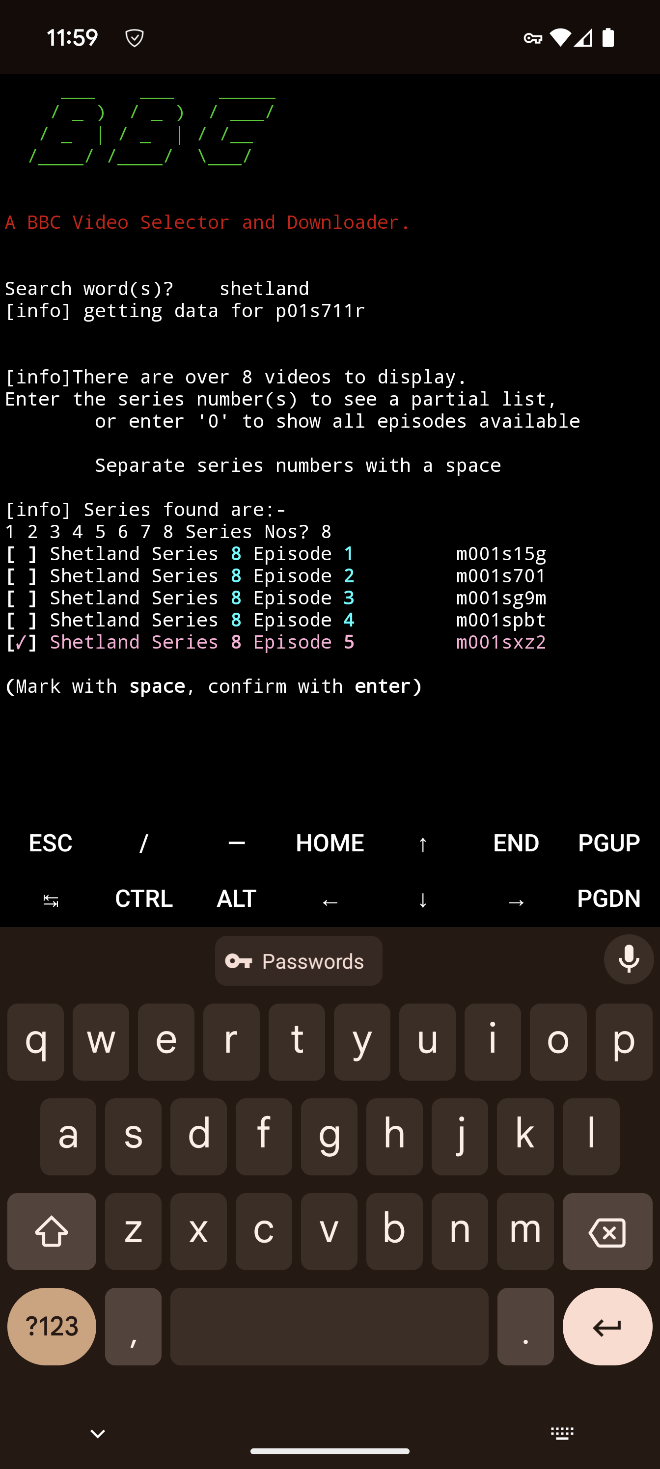

    [Attachment 74937 - Click to enlarge]

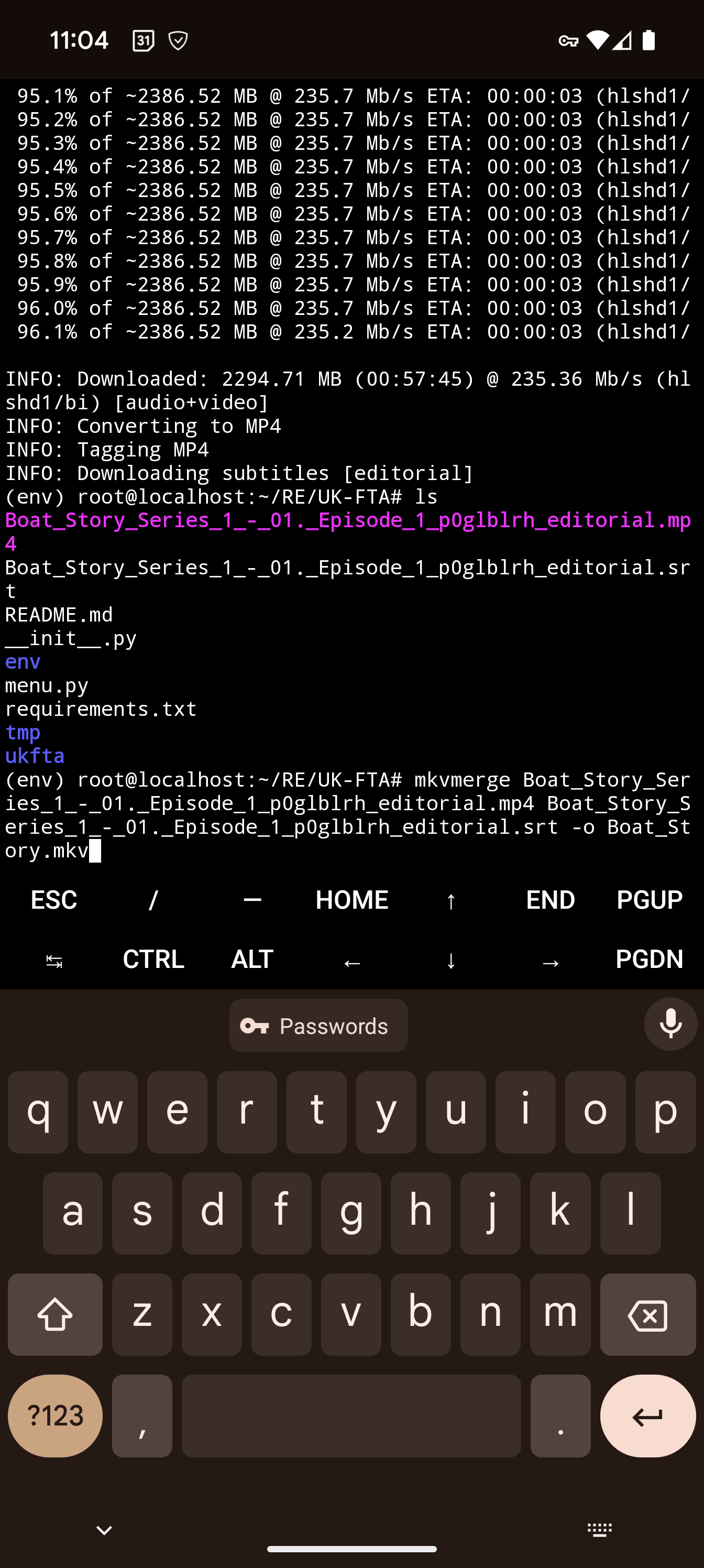

    Such as running get_iplayer
    [Attachment 74938 - Click to enlarge]
    Or other software
    With a friendly interface it is now child's play to download to and decrypt videos to your phone. This post is about setting up software on your phone that allows Ubuntu, a variety of Linux, to run scripts as if it were a PC.

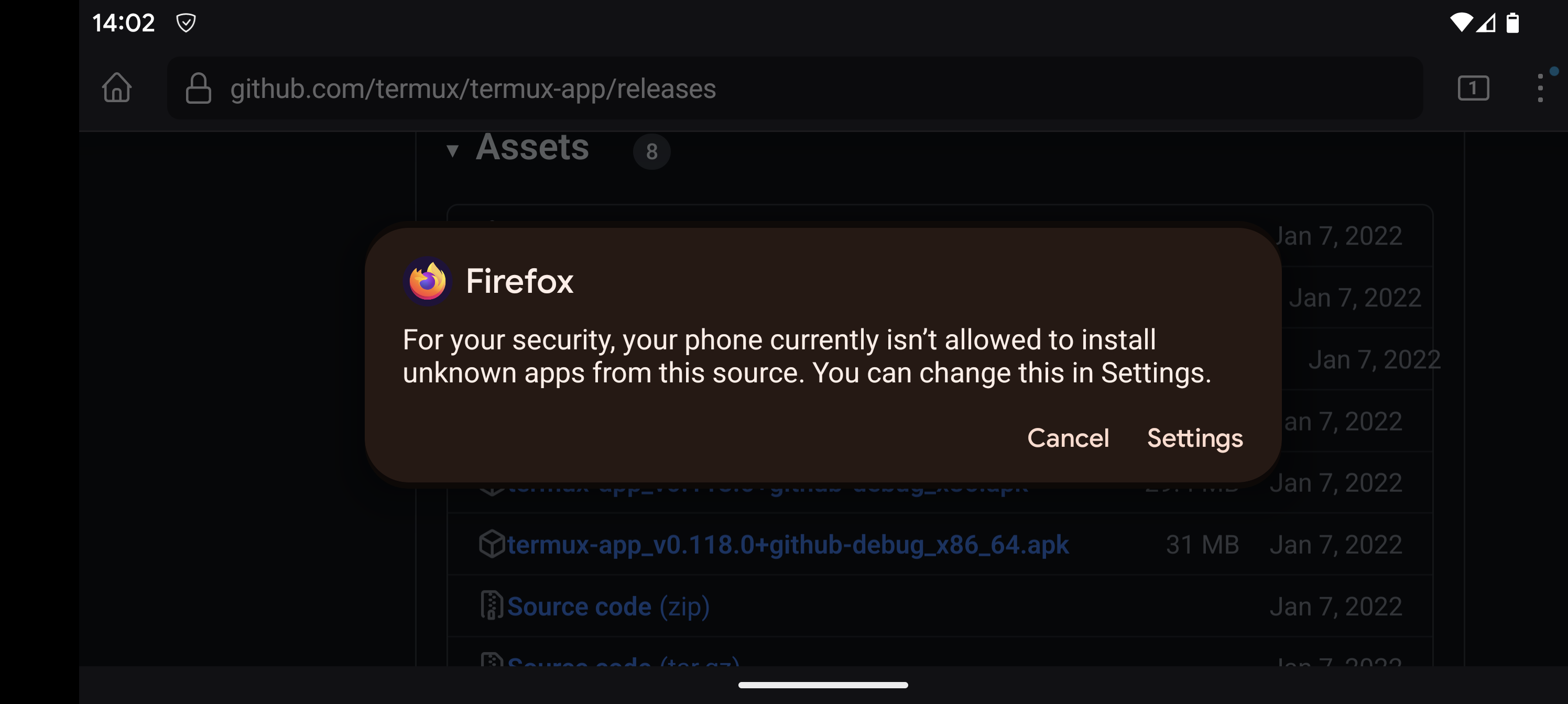

    Termux is a phone app that allows a Linux emulator to run on your phone. It cannot change anything on your phone system other than files in the storage area that you can see with a file manager - the area known as /sdcard/.
    Termux may be installed by getting the apk from github https://github.com/termux/termux-app/releases and selecting arm.v8.
    If your phone will not handle arm.v8 or x64 then N_m3u8DL-RE will not work on earlier systems. (A Google Pixel 4XL can be had quite cheaply.)

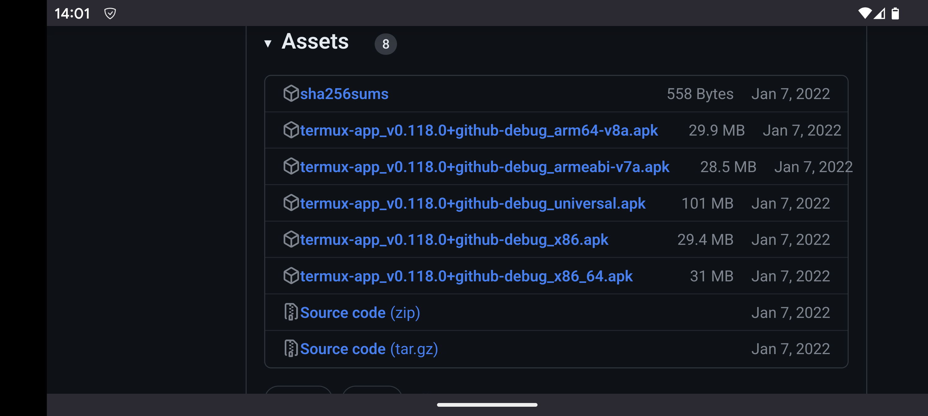

    [Attachment 74933 - Click to enlarge]
    So visit Termux on github and download the apk to your phone. Use your phone's file-manager and click on the download to install it. You may need to give system permission to do this.

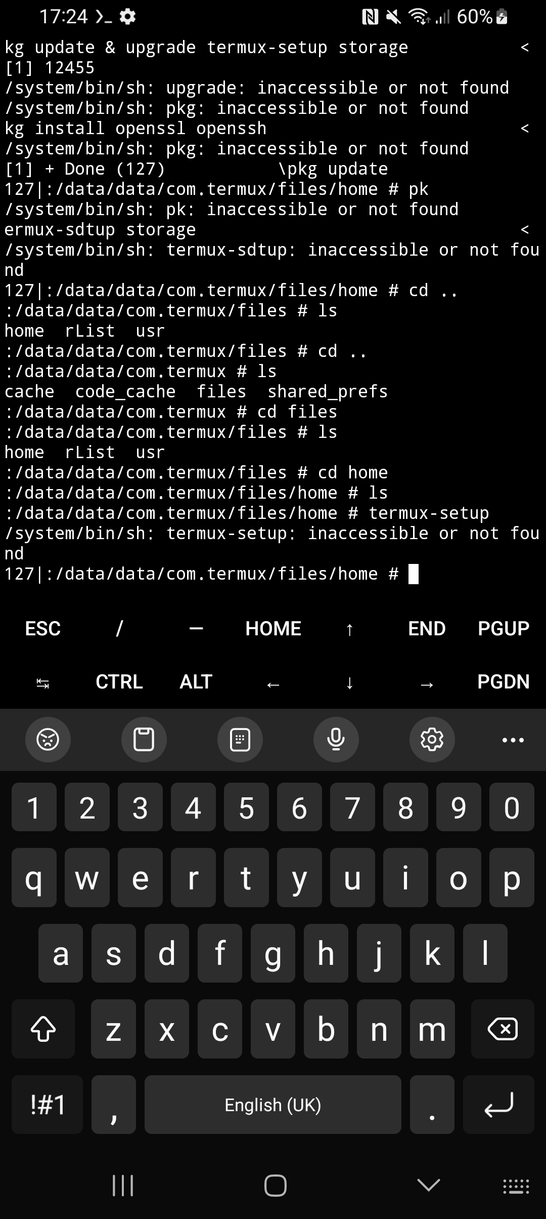

    First you'll want to set up house in Termux:
    pkg update & upgrade
    termux-setup-storage
    pkg install openssl openssh
    You now have a basic Termux working environment.

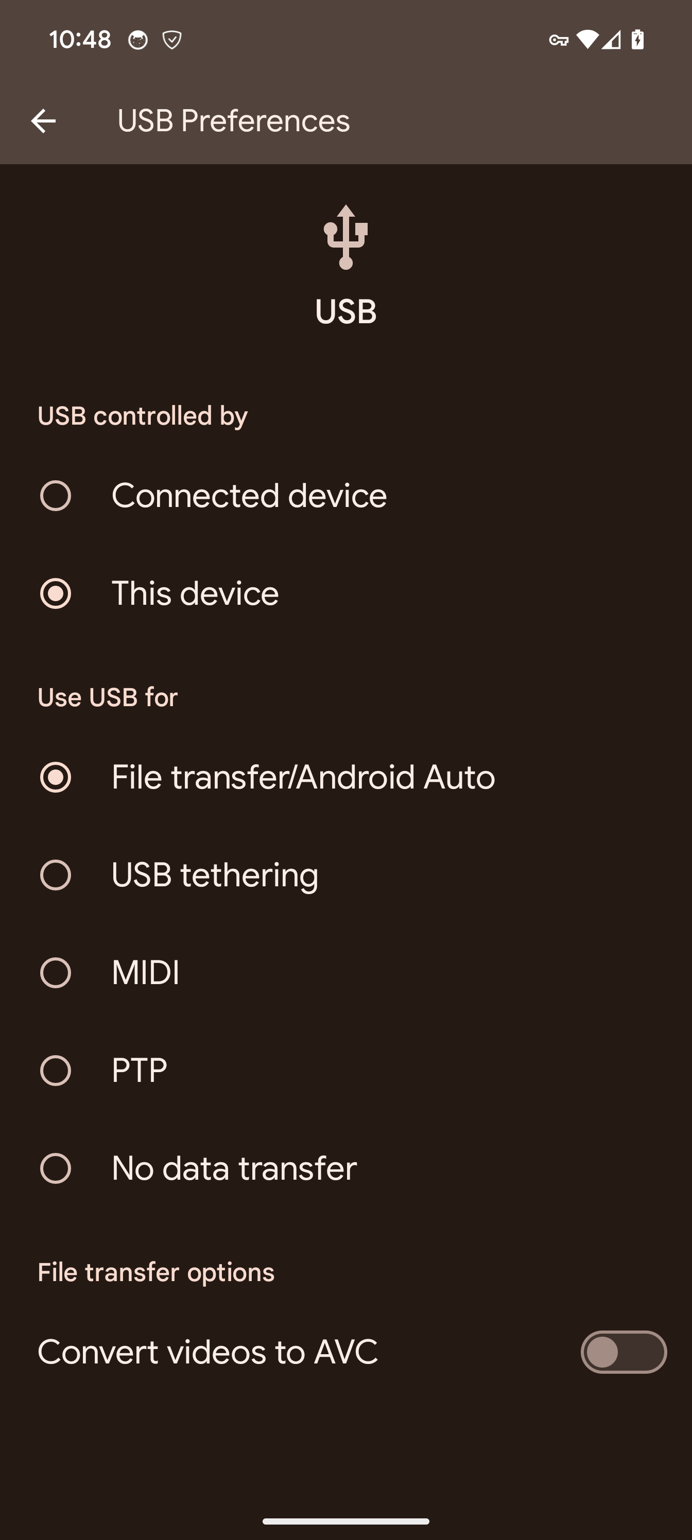

    Getting stuff on your phone is easy. cable connect and set-up permission for file transfer.
    [Attachment 74940 - Click to enlarge]
    Android Debug Bridge (adb) is an Android tool supplied by Google. Getting adb set up on your PC is harder on Windows than Linux but use this guide to get adb running IMPORTANT you do need to setup developer permissions on your phone so if yuu need to do that read the XDA article carefully!
    adb push ./<some folder>  /sdcard/
    sends the whole directory and sub-folders to your phone. We wil use this later.

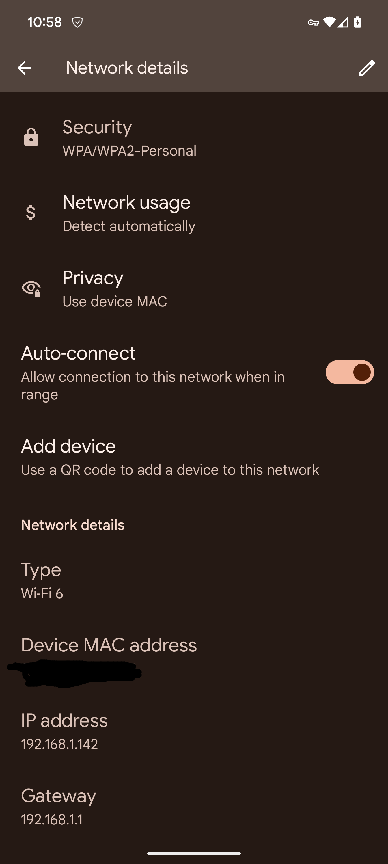

    You will need your local network address:-
    [Attachment 74966 - Click to enlarge]
    Find your phone's local network address is in Network Settings.

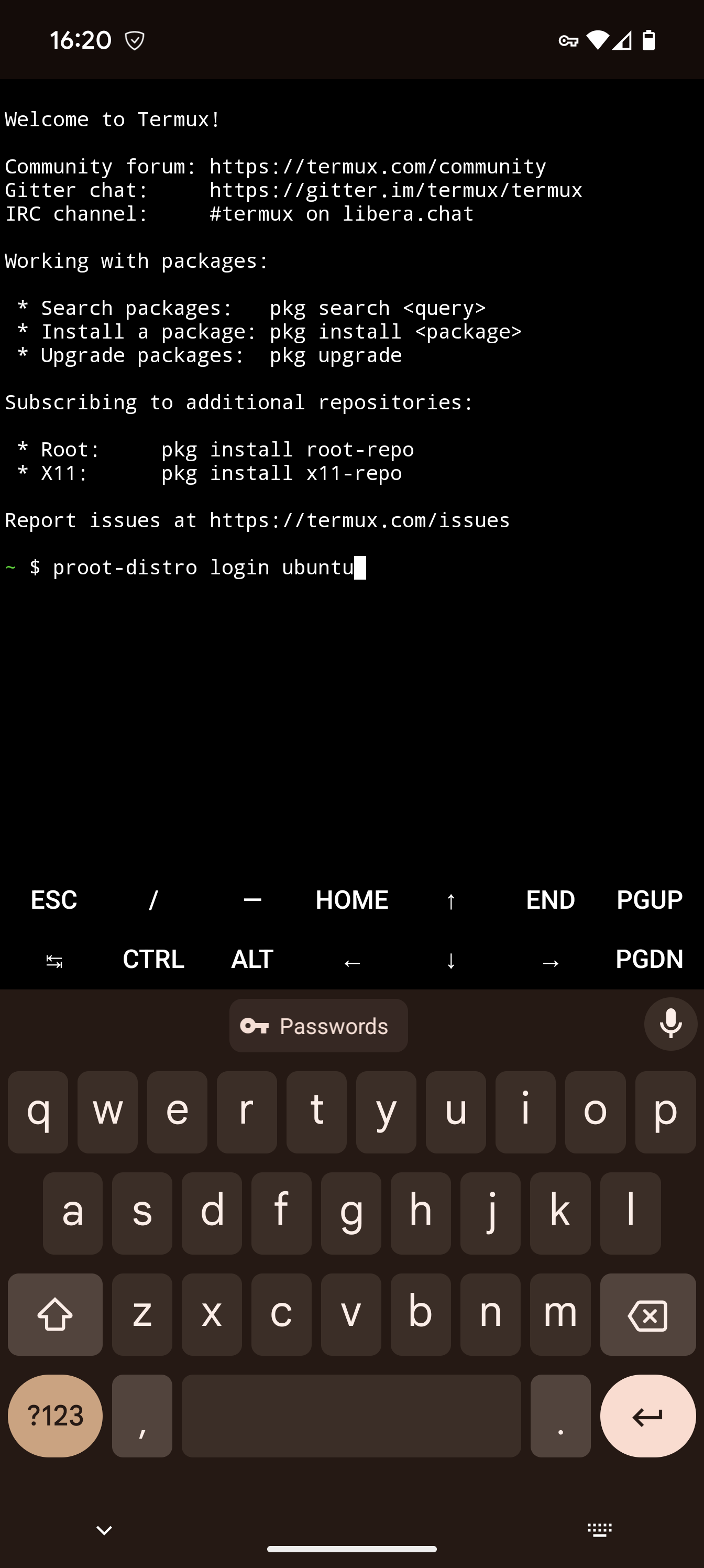

    We will be setting up a Proot using an Ubuntu Linux Distribution. Proot and I quote Google "PRoot allows one to mix transparently the emulated execution of guest programs and the native execution of host programs in the same file-system namespace." that basically means we can run Ubuntu within Termux and Ubuntu may use any Termux programs as its own.
    pkg install proot-distro
    will install the software to allow PRoot
    Once complete we can use proot to install Ubuntu with:-
    proot-distro install ubuntu
    Wait while it downloads and unpacks. Once finished
    proot-distro login ubuntu
    will start an ubuntu session.
    You can also type directly in Termux too should you wish.
    [Attachment 74942 - Click to enlarge]
    If you want to end your session type 'exit' to get back to Termux. You may close Termux by typing 'exit' too.
    But that's enough for now part 2 will setting up Ubuntu with N_m3u8DL-RE, ffmpeg and all tools needed to download and decrypt will be along soon.

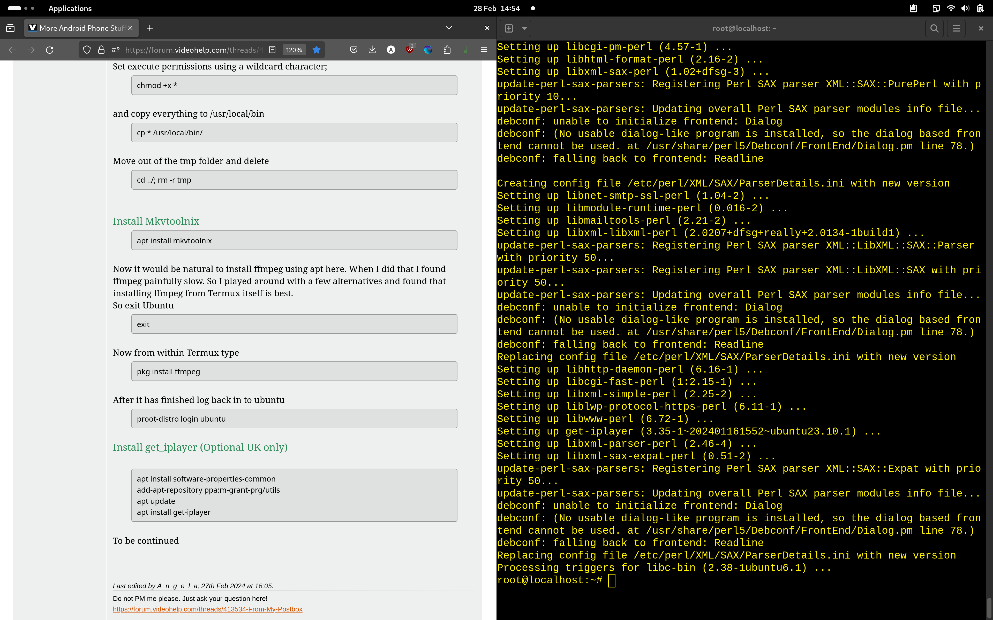

    Install Mkvtoolnix
    apt install mkvtoolnix
    Now it would be natural to install ffmpeg using apt here. When I did that I found ffmpeg painfully slow. So I played around with a few alternatives and found that installing ffmpeg from Termux itself is best.
    So exit Ubuntu
    exit
    Now from within Termux type
    pkg install ffmpeg
    After it has finished log back in to ubuntu

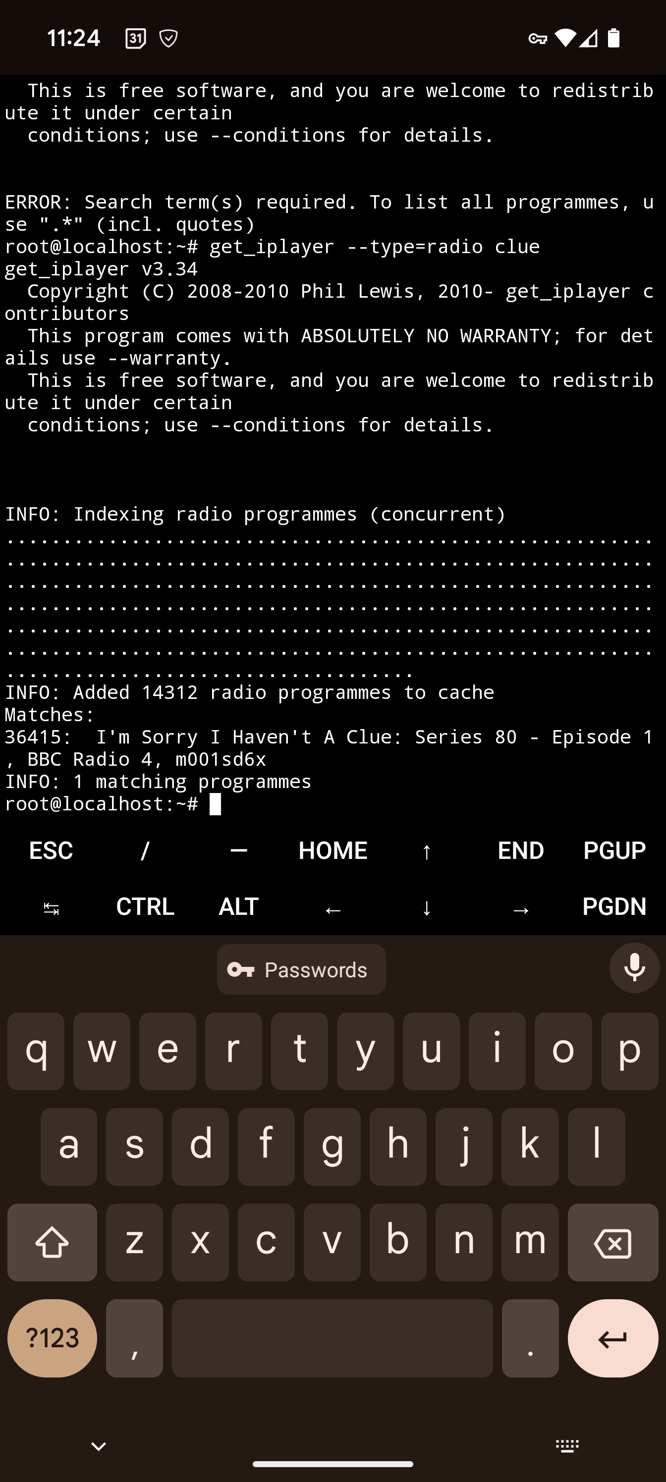

    Install get_iplayer (Optional UK only)
    apt install software-properties-common
    add-apt-repository ppa:m-grant-prg/utils
    apt update
    apt install get-iplayer

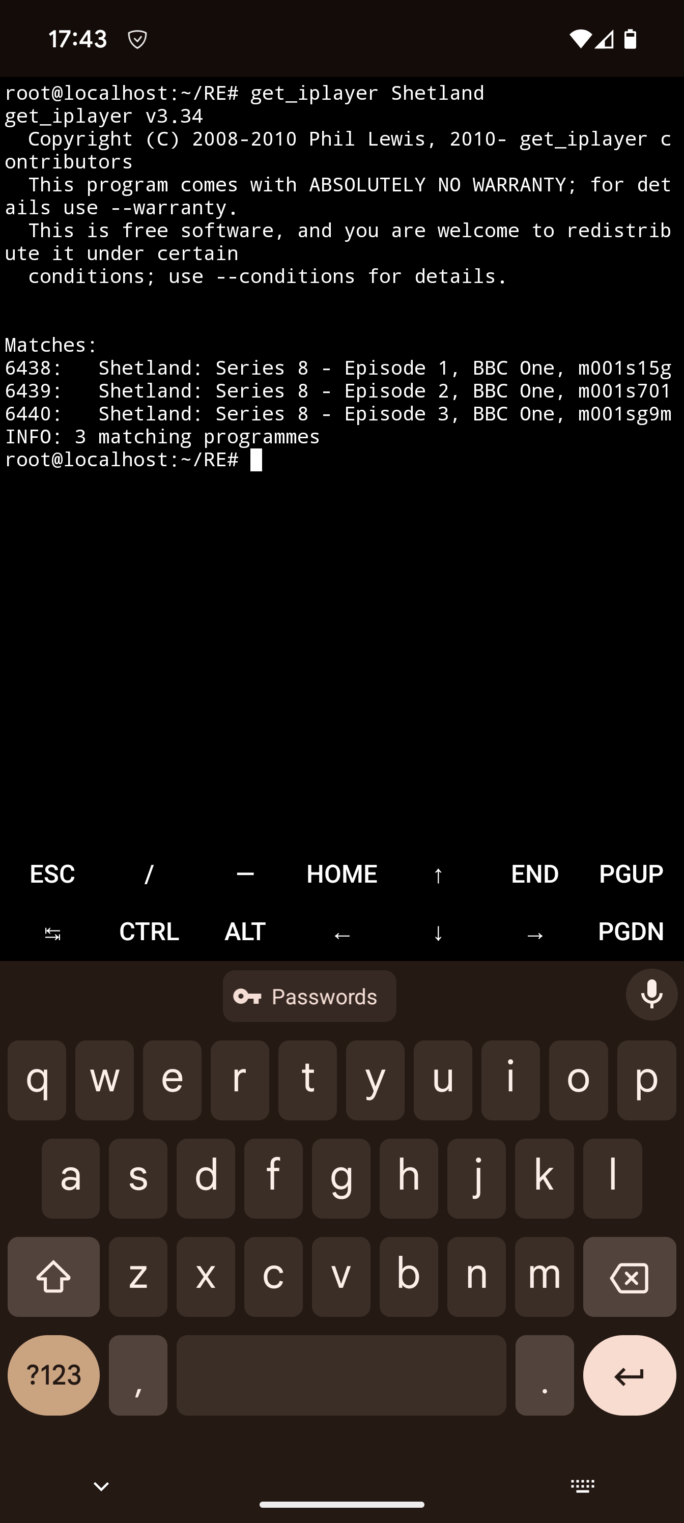

    Setting up Python and installing scripts
    [Attachment 74955 - Click to enlarge]
    get_iplayer, installed in the last part, running on an Android phone.

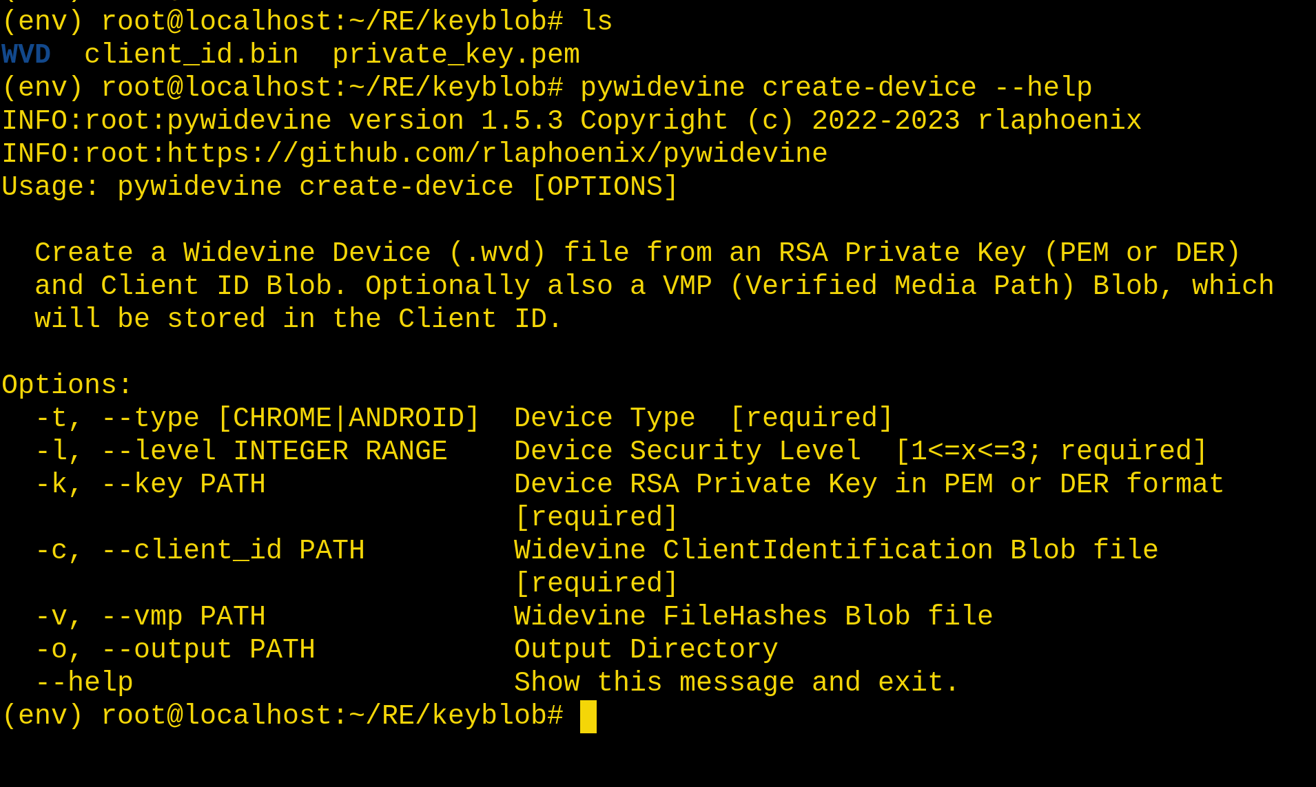

    Create a WVD file
    [Attachment 74956 - Click to enlarge]
    Change the names your your blob and key in this command
    pywidevine create-device -c client_id.bin -k private_key.pem -t ANDROID -l 3 -o WVD
    Should complete without fuss. Now cd to the WVD folder and use 'ls' to list the file contents,
    You should find a long name refecting the orgin of the CDM. We will simplify this to mbox.wvd.
    Move the file to a new name start by typing mv and the first characters of the name and use auto-complete. My key for that is 'tab'.
    mv <wvd-filename> mbox.wvd
    note the location /root/keyblob/WVD/mbox.wvd, if ever scripts ask where your wvd file it is /root/keyblob/WVD/mbox.wvd

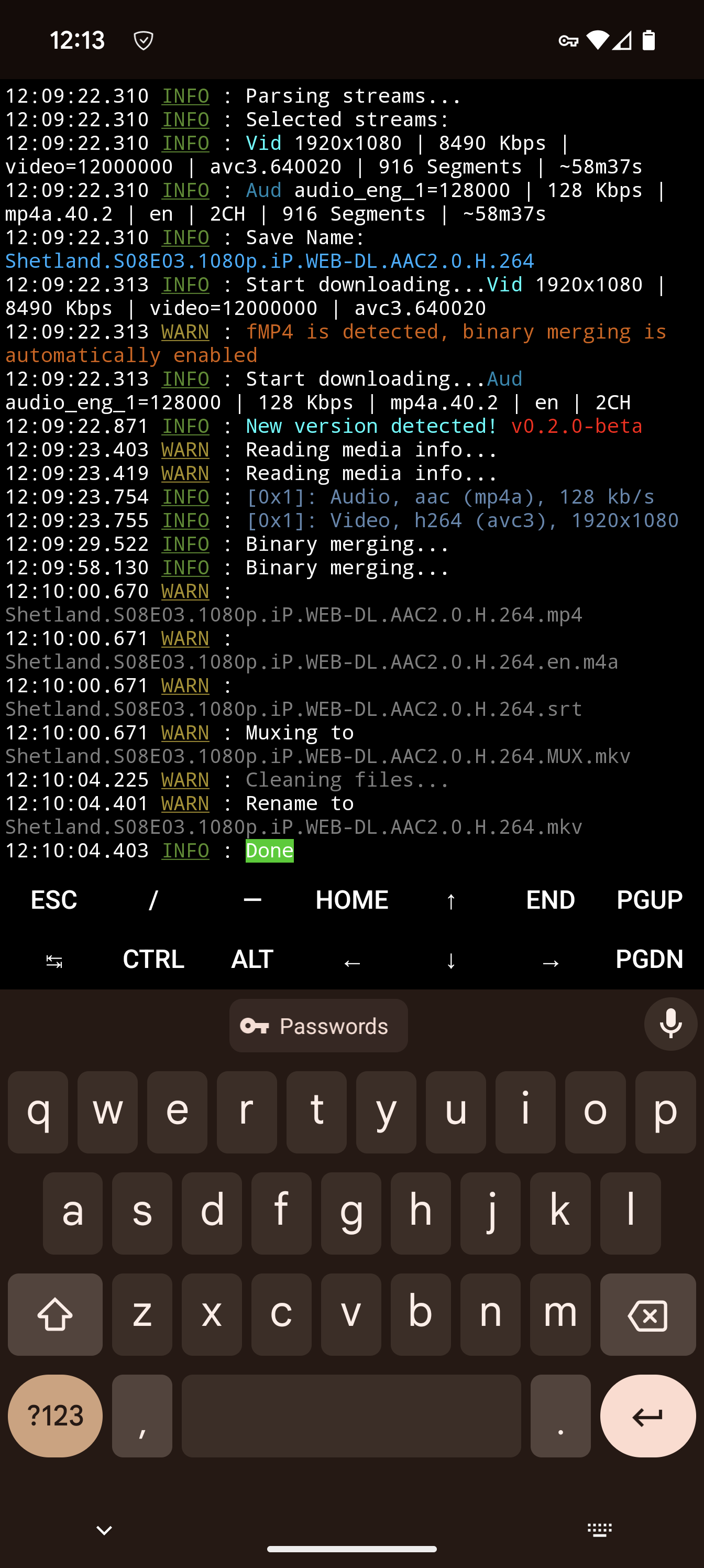

    You now have a working python environment and any scripts that work on a PC should work here.

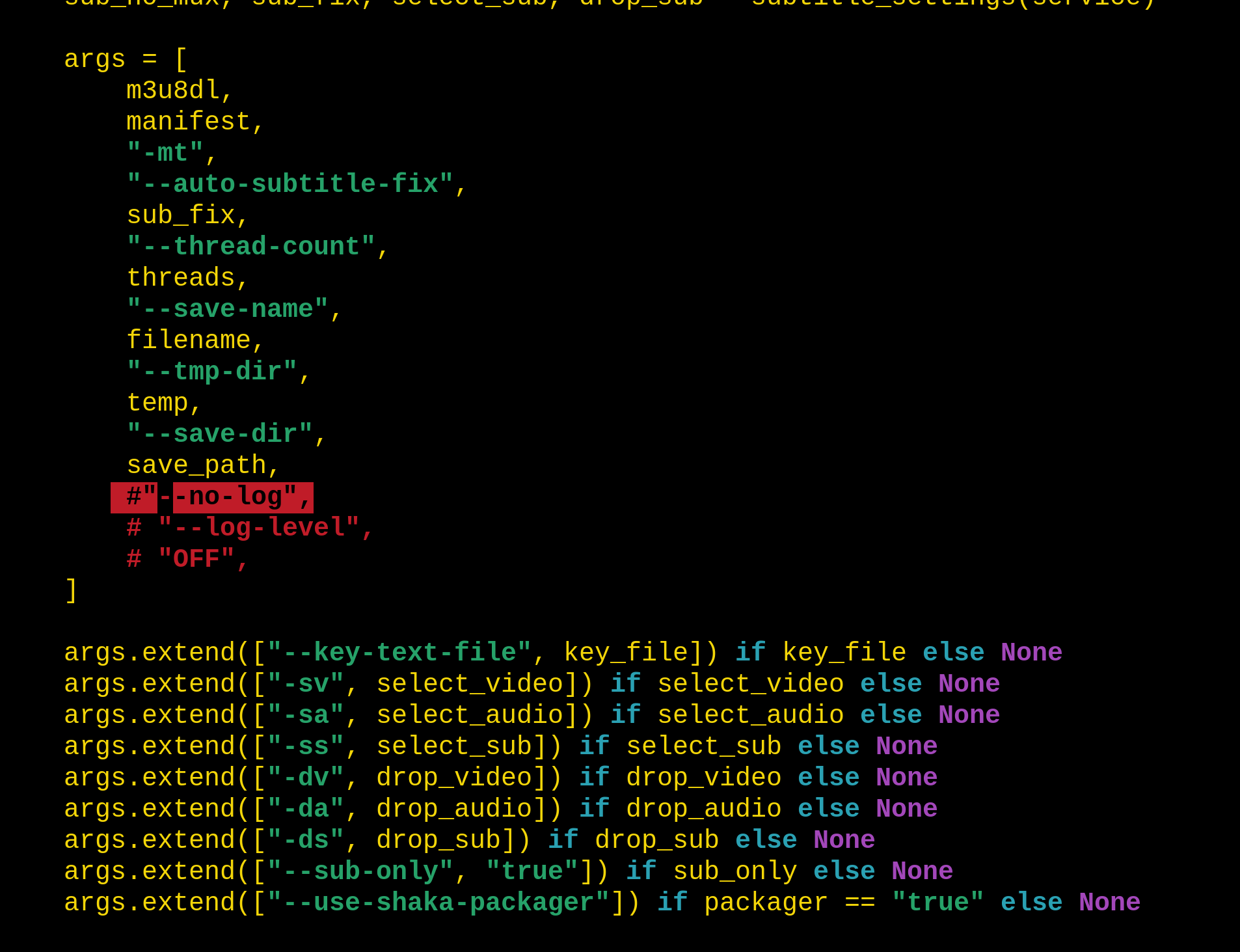

    The only change needed to to note that N_m3u8DL-RE is an earlier version and --no-logs in the N_m3u8DL-RE command will crash it. Edit out --no-log
    In any folder where you suspect N_m3u8DL-RE is being use of this command will find files that need editing
    grep -r --no-log .
    will show if any files have the command present and will need editing.
    Nano is the editor
    nano <file_path/filename>
    to open it. Ctrl +W --no-log to find it. Then put # in front to edit it out.

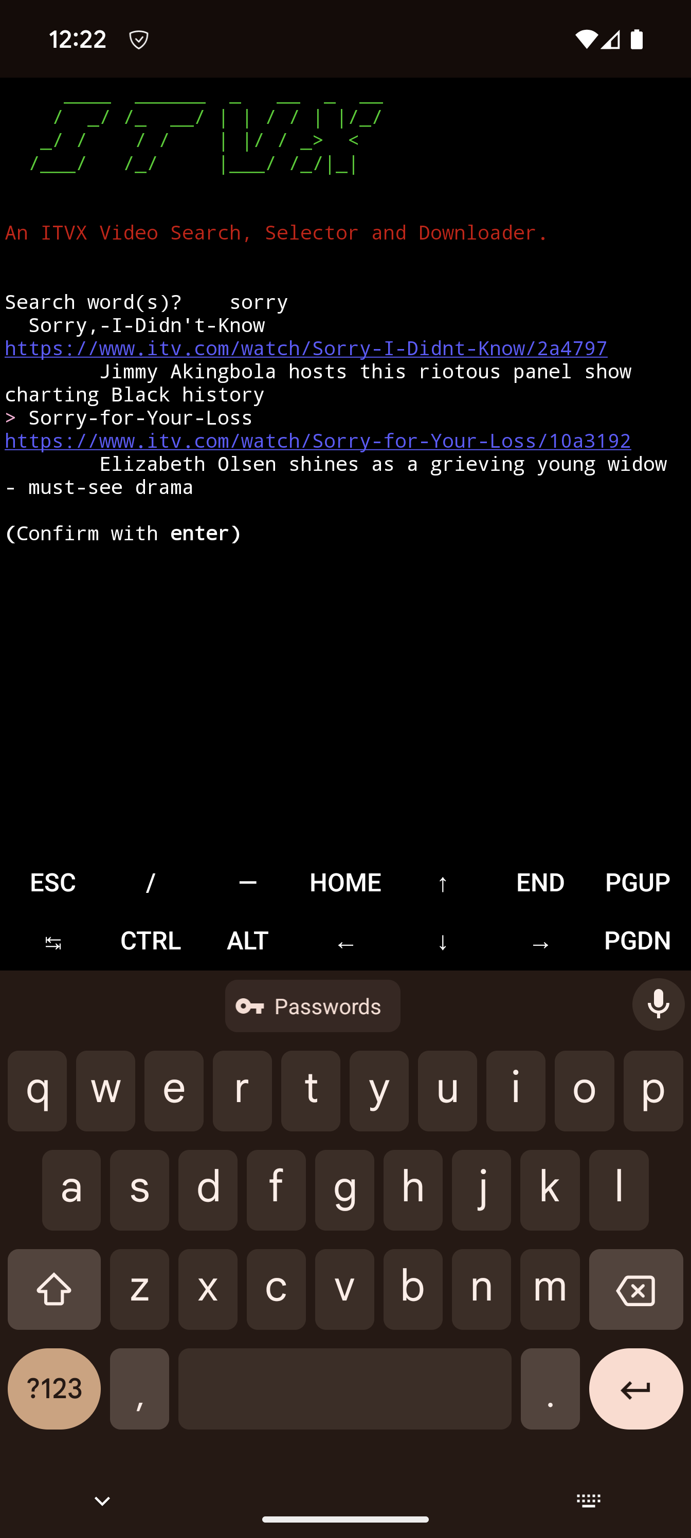

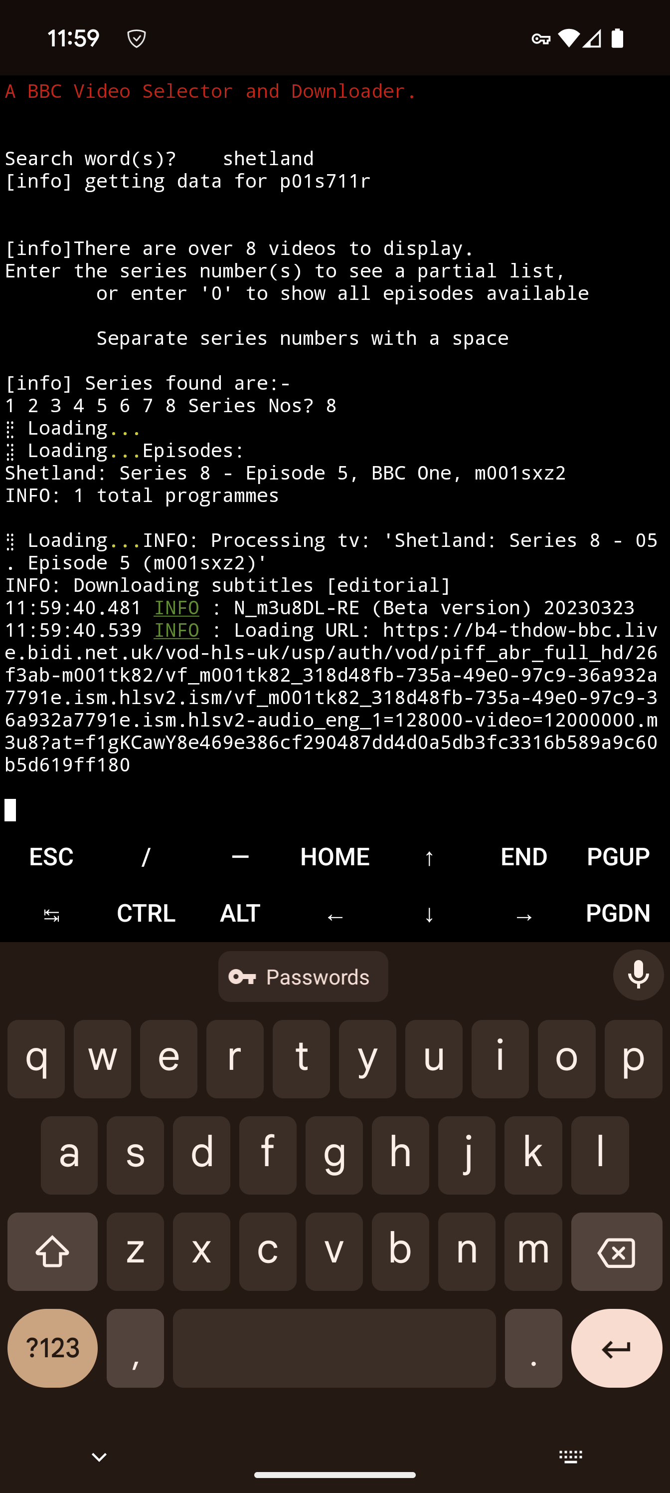

    Any scripts should work now that use N_m3U8DL-RE. yt-dlp can be installed too. (My UK- FTA installs yt-dlp using pip )
    If you wish to use my UK-FTA scripts I have an edited version made more suitable for a phone screen.
    cd /root/RE/UK-FTA
    unzip UK-FTA.zip
    should inflate the zip to the current directory
    Install the required module

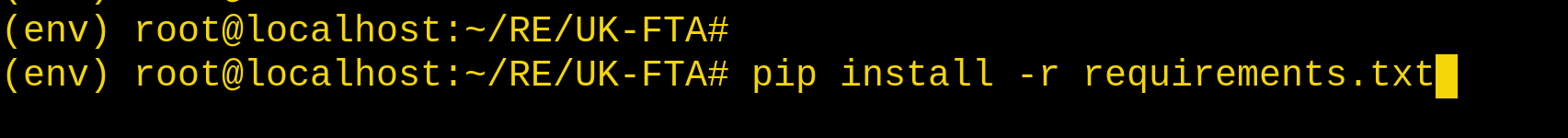

    [Attachment 74957 - Click to enlarge]
    Still within the python (env) - (if not restart it)
    pip install -r requirements.txt

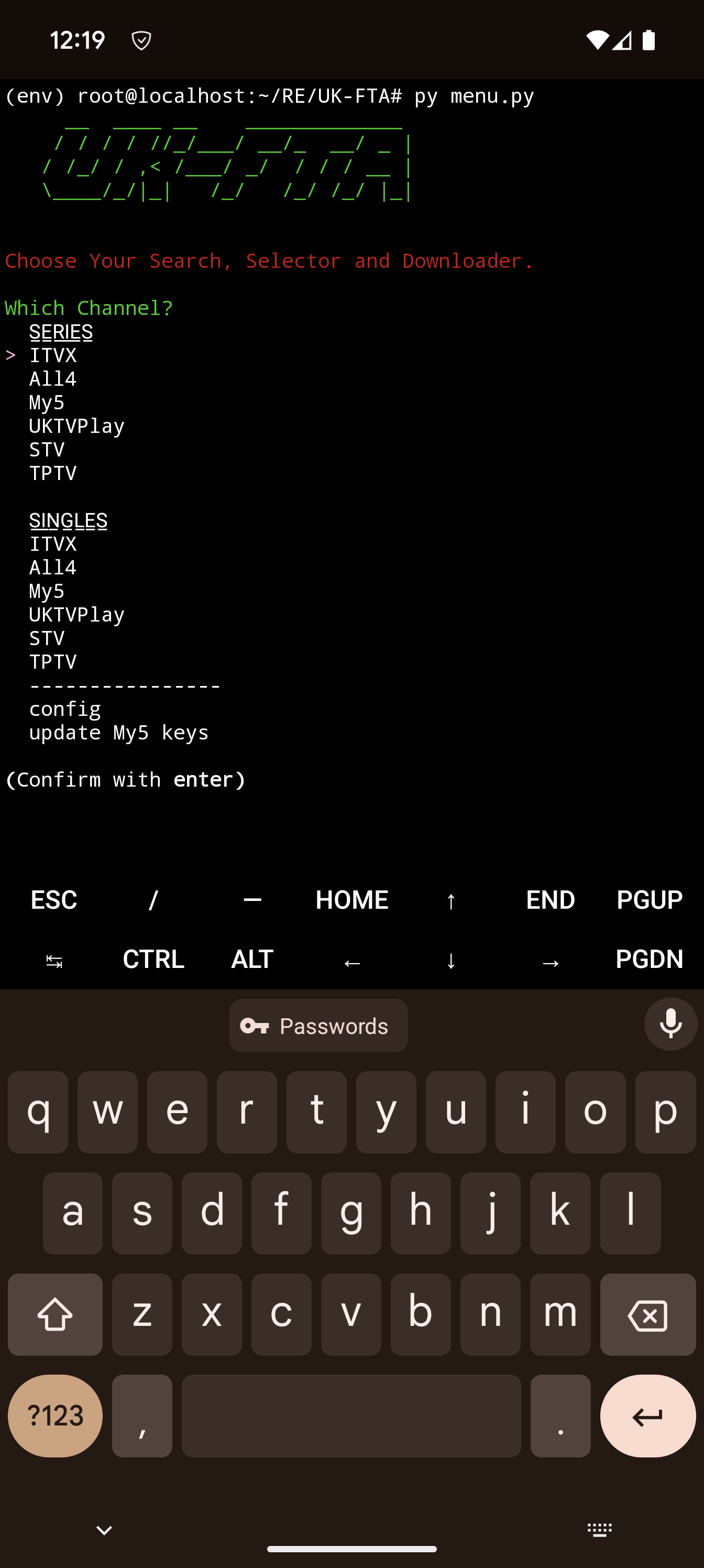

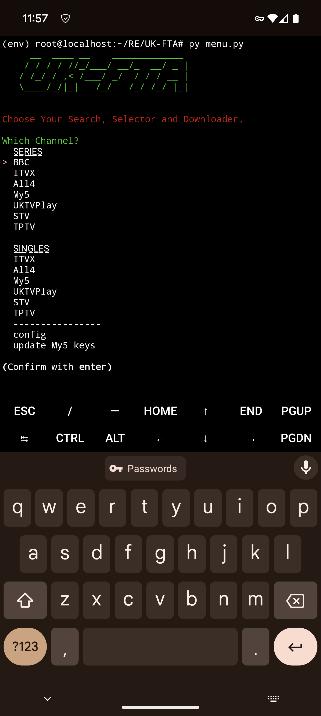

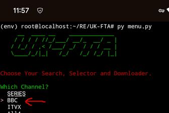

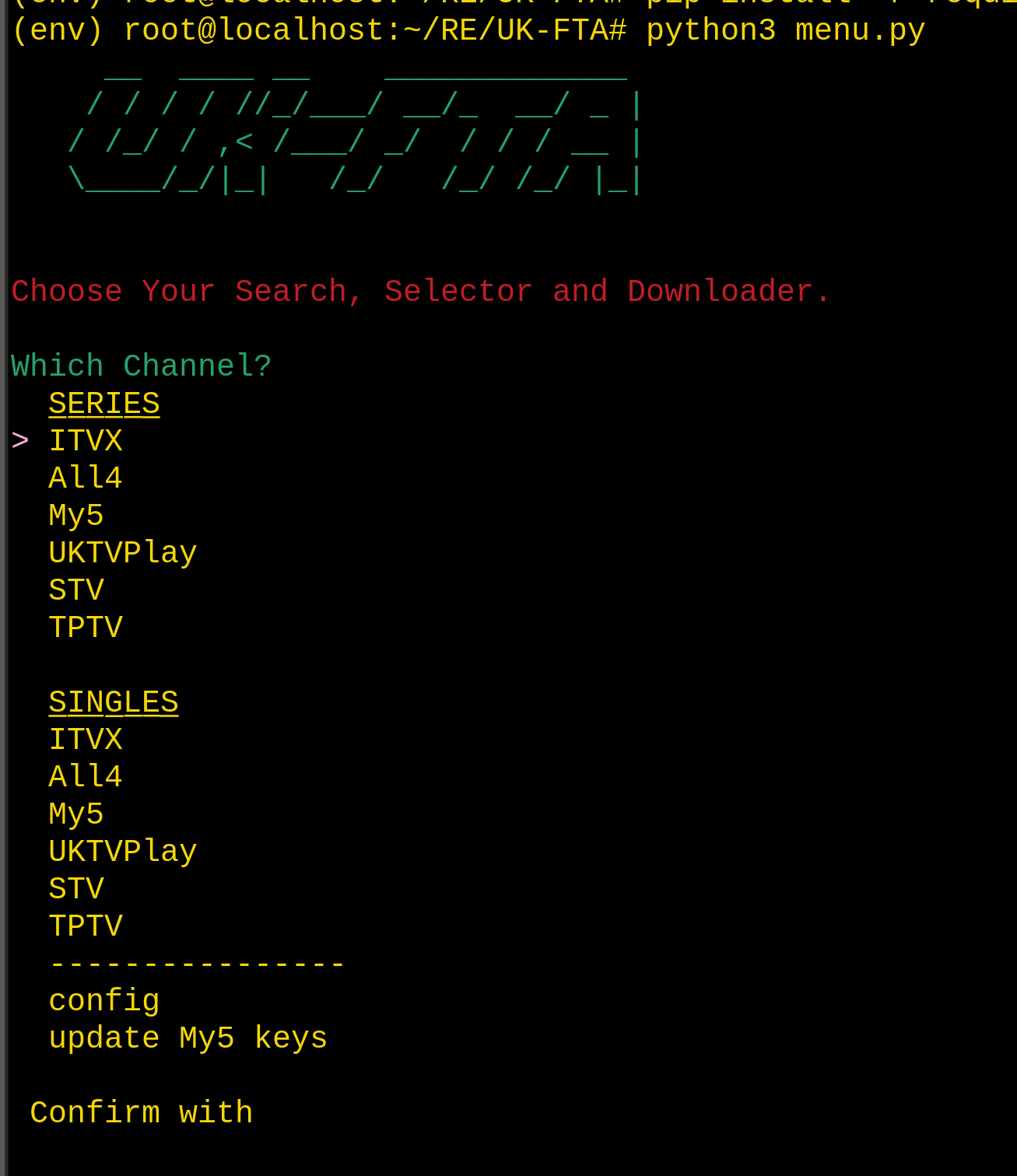

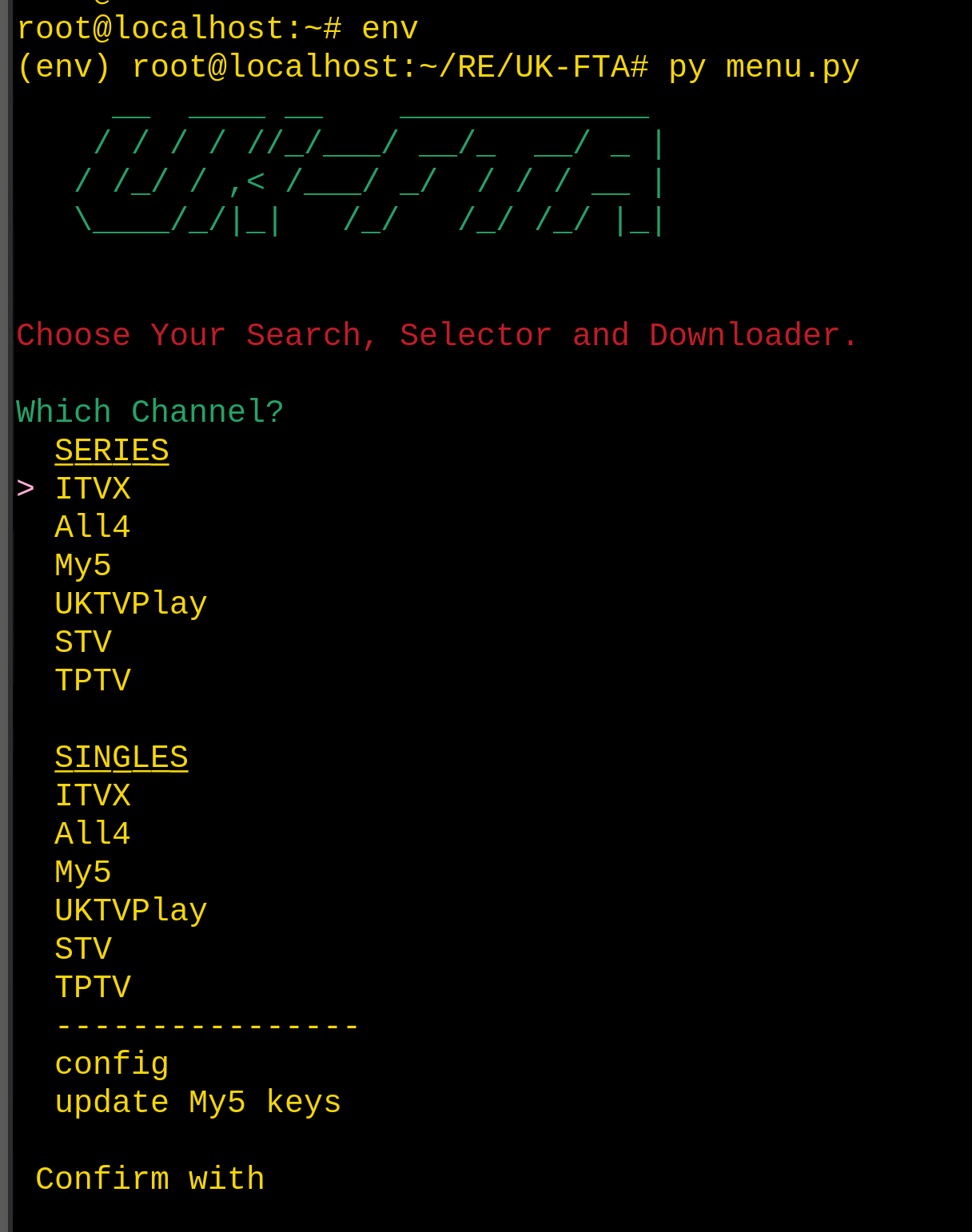

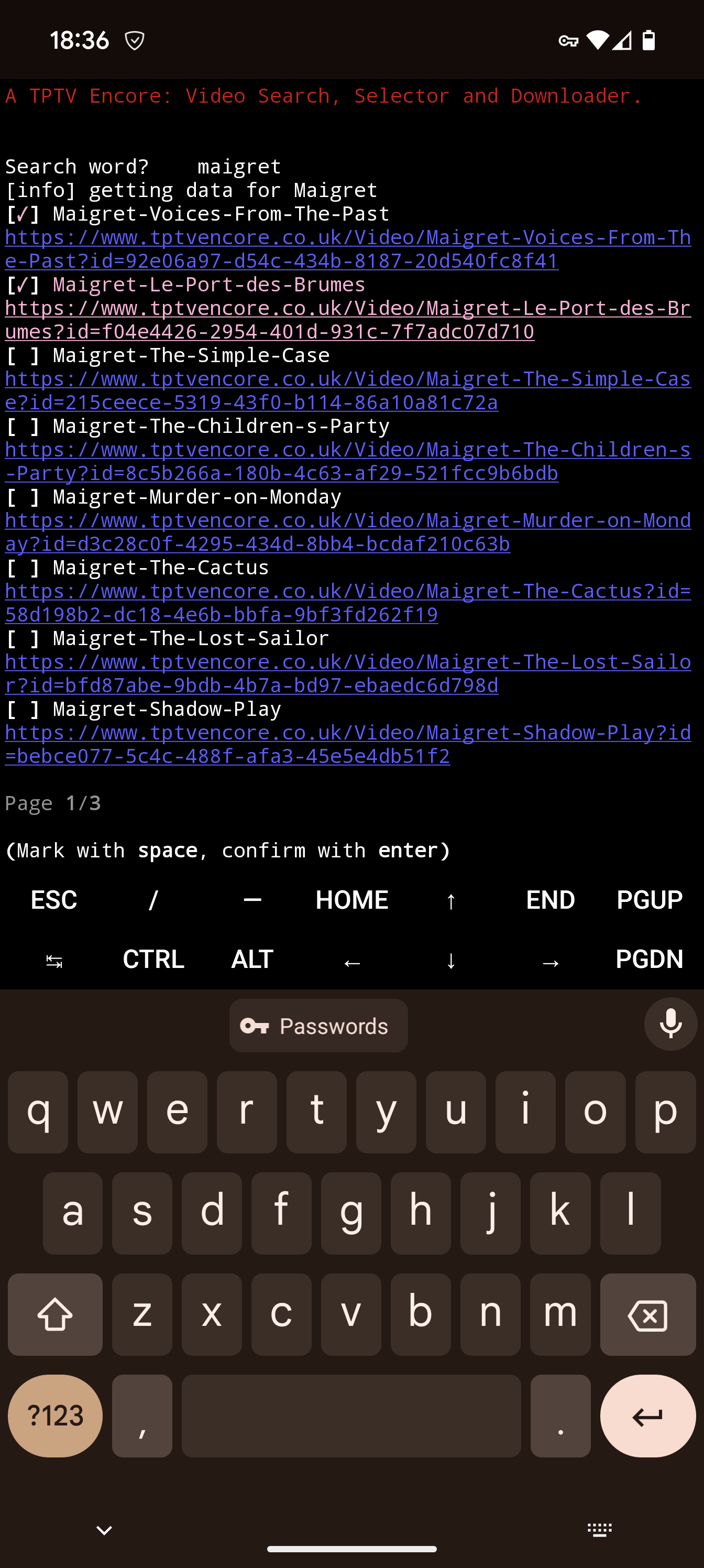

    Start the script

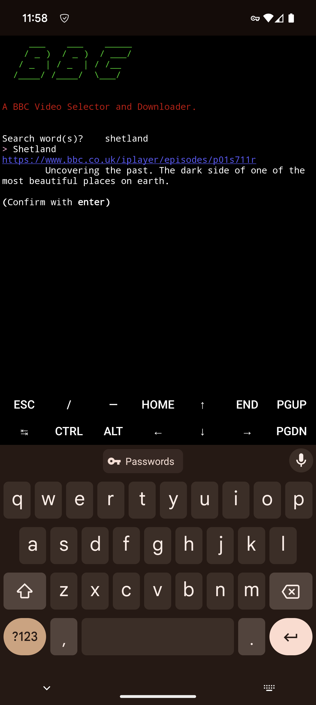

    python3 menu.py
    If all has gone well you should see
    [Attachment 74958 - Click to enlarge]

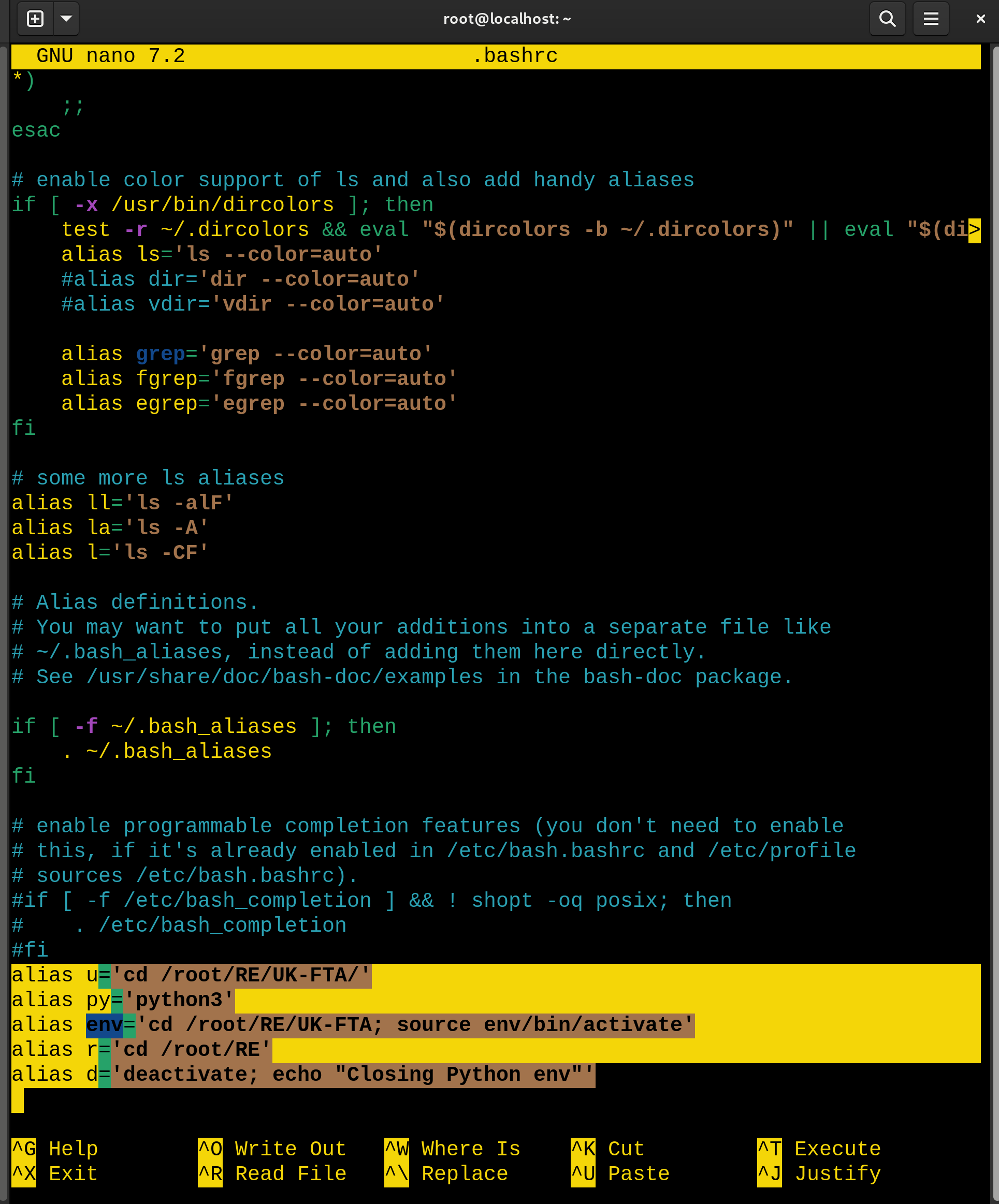

    Before going any further let us close the env and make a few simple changes to make working and typing on the phone easier.
    deactivate
    will close env
    cd /root
    nano .bashrc
    (Note the full stop)
    We are going to add a few aliases such that we can type just one letter to change to a UK-FTA and call python3 just by typing 'py'.
    [Attachment 74959 - Click to enlarge]
    paste this to the very end of the .bashrc file
    alias u='cd /root/RE/UK-FTA/'
    alias py='python3'
    alias env='cd /root/RE/UK-FTA; source env/bin/activate'
    alias r='cd /root/RE'
    alias d='deactivate; echo "Closing Python env"'
    Ctrl+s saves and ctrl+x exits nano editor.
    Now logout from Ubuntu and login again to activate the aliases we have set
    exit
    drops you back to a $ prompt in Termux
    re-enters Ubuntu now type env and the prompt changes to show env and you've also changed to UK-FTA folder.
    This time 'py' can be use instead of python3 and use auto-complete to avoid typing too much.
    On your phone screen look for the two opposing arrows in the region just above the keyboard - these arrows are the auto-complete key.
    The other extra Termux functions above the phone keyboard have up-down/left-right controls for moving a cursor. CTRL is sticky and waits for the next key C or D, or whatever, to allow emulation of a PC keyboard. Everything you might need is there for keyboard entry. Scripts ideally would try to minimise keyboard entry.

    UK-FTA should run 'out-of-the-box as all configs follow the install pattern of placing and naming files. If you made changes then maybe the config file will need editing in nano
    Any videos downloaded by UK-FTA will appear in the sdcard Download folder so it is accessible to apps like VLC or Casting apps.

    Copy your CDM to Freevine
    from within freevine-main
    cd utils
    mkdir wvd
    cd wvd
    cp -r /root/RE/keyblob/* .
    (Note the full stop!)
    And wait for it to finish.

    Get_iplayer
    I thought I would have issues with get_iplayer but it does what it does on a mobile phone very well.
    [Attachment 74987 - Click to enlarge]
    As well as downloading video get_iplayer will fetch radio broadcasts too.
    [Attachment 74988 - Click to enlarge]

    get_iplayer leveraged to play nicely with N_m3u8DL-RE on a mobile
    :Image
    [Attachment 75149 - Click to enlarge]
    :Image
    [Attachment 75150 - Click to enlarge]
    :Image
    [Attachment 75146 - Click to enlarge]
    :Image
    [Attachment 75147 - Click to enlarge]
    Get_iplayer fetches the file url for download by N_m~:Image
    [Attachment 75148 - Click to enlarge]

  10. Looks really good. I didn't realise you'd added BBC to the FTA downloader.
    Feb 2022
    Search the forum first!
    I haven't.

    I'm not sure FTA needs a BBC downloader. There are tools already out there and there is no encryption. So anyone can download from the BBC without a problem.
    Yt-dlp downloads 720p from a URL; get_iplayer will download at 1080p.
    On a phone screen, typing is a issue, so it makes sense, to me, to use a script.
    I posted this as I'd never seen anyone using get_iplayer to find download URLs for another downloader.
    Noob Starter Pack. Just download any Widevine media! Over 30,000 downloads for V6!.
  14. I really like the search bit of your FTA script, it's useful not even having to go to the website.
    I'm going to add it to mine just to see if I can work out how you do it. It is great fun doing stuff like this and it is good to not be spoon-fed all the time and I really appreciate all you do for the forum.

    Updated Vadapav only. Now has extended timeouts for all https traffic. Reworked the data displayed to only show filenames. Plus a few bugs squashed.
    So in the meantime just releasing the vadapav.py phone version. Copy it into the UK-FTA/ukfta/vadapav/ folder on your phone and replace the existing vadapav.py with this:-
    https://files.videohelp.com/u/301890/phone_vada.py
    Be sure to rename it vadapav.py

    A new update to sync to the PC Version. Version number jumps as a consequence.
    Changes have been made to vadapav so it uses the configuration file to find its storage requirements. Vadapav.mov is a file reposository with film and TV media. Some media is 4k and a 2160 search will find it. It probably shouldn't be in an FTA list but I use use it and it is convenient to access here.
    Channel 4 updated with my spoof data.
    Channel 5 now updates its own HMAC secret and AES keys. It will update the first time my5 is called and once every three days, but only when my5 is used. It shouldn't need intervention. (I only use my5 rarely but I got fed up running my5 and having it fail with out of date keys.)
    The menu has been adjusted to reflect changes getting my5 HMAC secret and AES key.
    NOTE: It is important to replace the total existing UK-FTA folder as there have been structural changes. Run config from the menu to set up storage and the wvd location. (Maybe copy those from the current config before installation of the new version?)
    Requirements.txt has been updated and reduced. The need for get_iplayer, as a helper program, has been added to the top level README.md
    The last phone version had 25 downloads; either that is because it had a Channel4 script that worked or because more of you are finding out just how useful it is having it on your phone. With Channel4 fixed on the PC version I'll soon know!
    https://files.videohelp.com/u/301890/phone-uk-fta_13.zip

  26. Image
    [Attachment 77460 - Click to enlarge]
    Latest version of termux doesnt like the commands ive searched the folders to do the commands
    Ignore sorry had to change repository to add these
    Last edited by PSXman_uk; 6th Mar 2024 at 13:41. Reason: Error caused by repository

  28. Re read and fixed issue was sdcard when you adb to it is the download folder on the device not sdcard itself
  29. Member
    Feb 2022
    That is not standard behaviour, adb push <filename> /sdcard/ is expected to send filename to the base of your personal internal memory where Download is a folder.
    If you want to place something in Download
    adb push <filename> /sdcard/Download/
    Unless you have a phone with a slot for an extra card memory, and I cannot remember how those are accessed from adb
