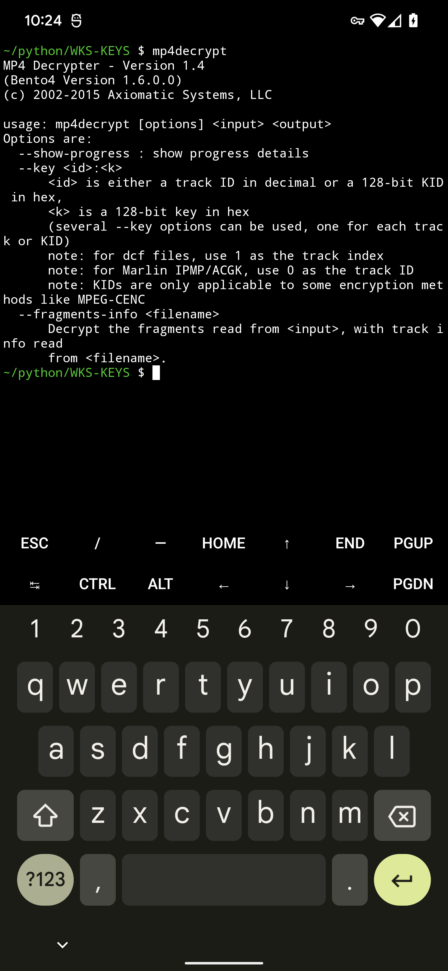

    give execute permissions and check it is working:-
    chmod +x /data/data/com.termux/files/usr/bin/mp4decrypt
    mp4decrypt

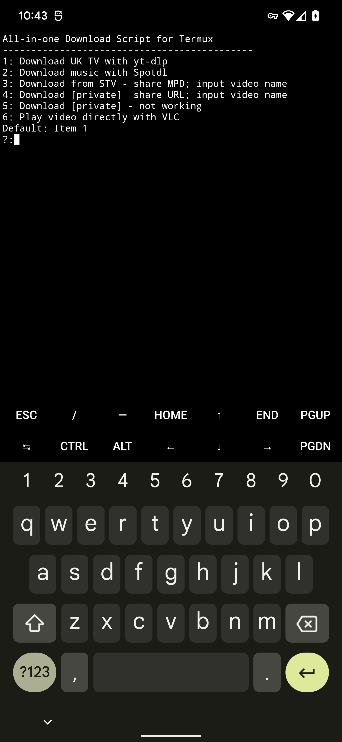

    Termux has a simply wonderful facility to accept a shared piece of text or url!! So if I touch a url in my phone's browser window it can be shared to Termux.
    In bin I have a file with execute privileges (chmod +x filename) called termux-url-opener - this is special name Termux recognises. Termux shares automatically to this file. When run it calls python/opener.py which is a menu program
    #!/bin/bash
    python  ~/python/opener.py

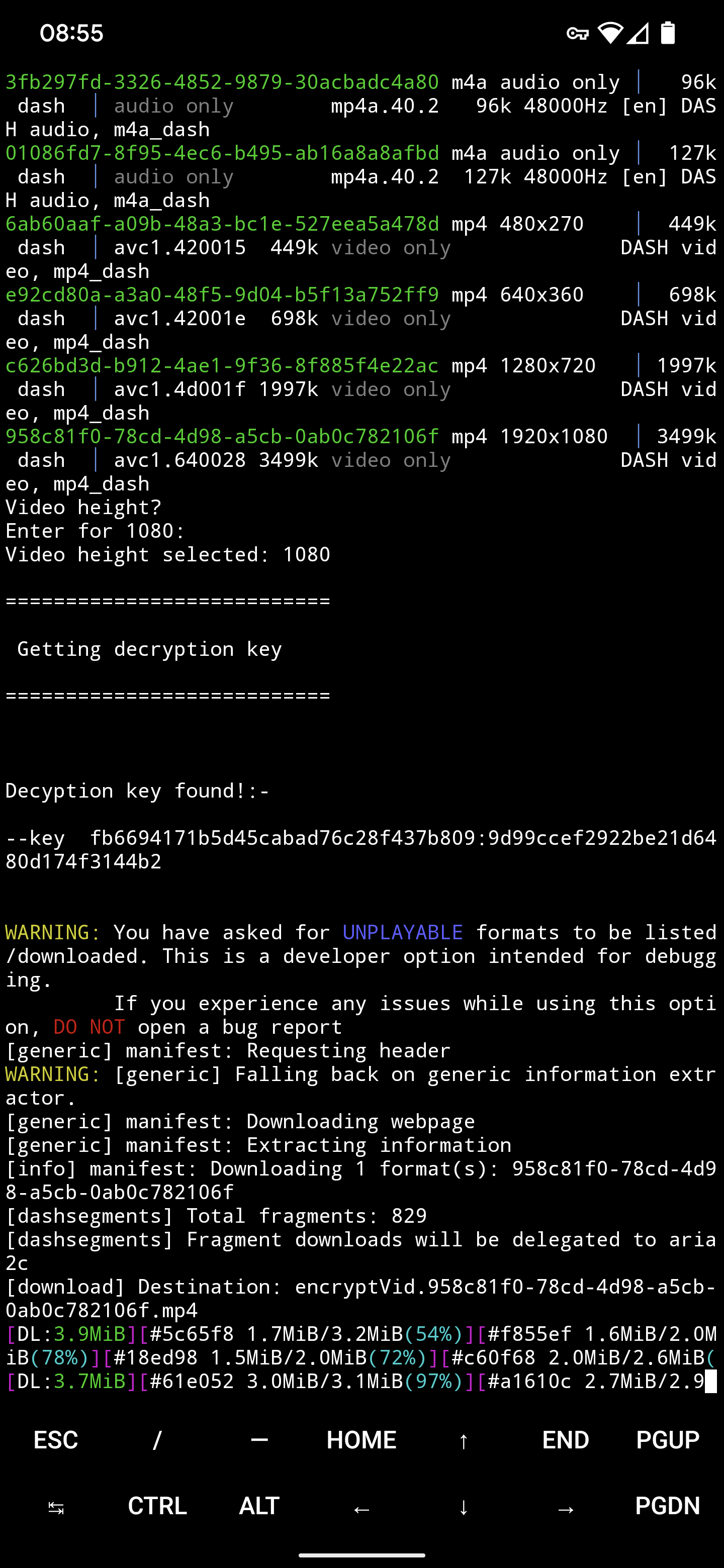

    Now sharing can only pass one argument. Some of my scripts use two or three. No matter; adapt your opening routine to use the first argument but wait for input on the others.
    So calling STV (and similar mpd - tg4.ie -uktvplay) I shared the mpd and entered the menu.
    The code called by the menu waits for further input. So my progam entry point looks like this and allows a hybrid of command line and input commands.

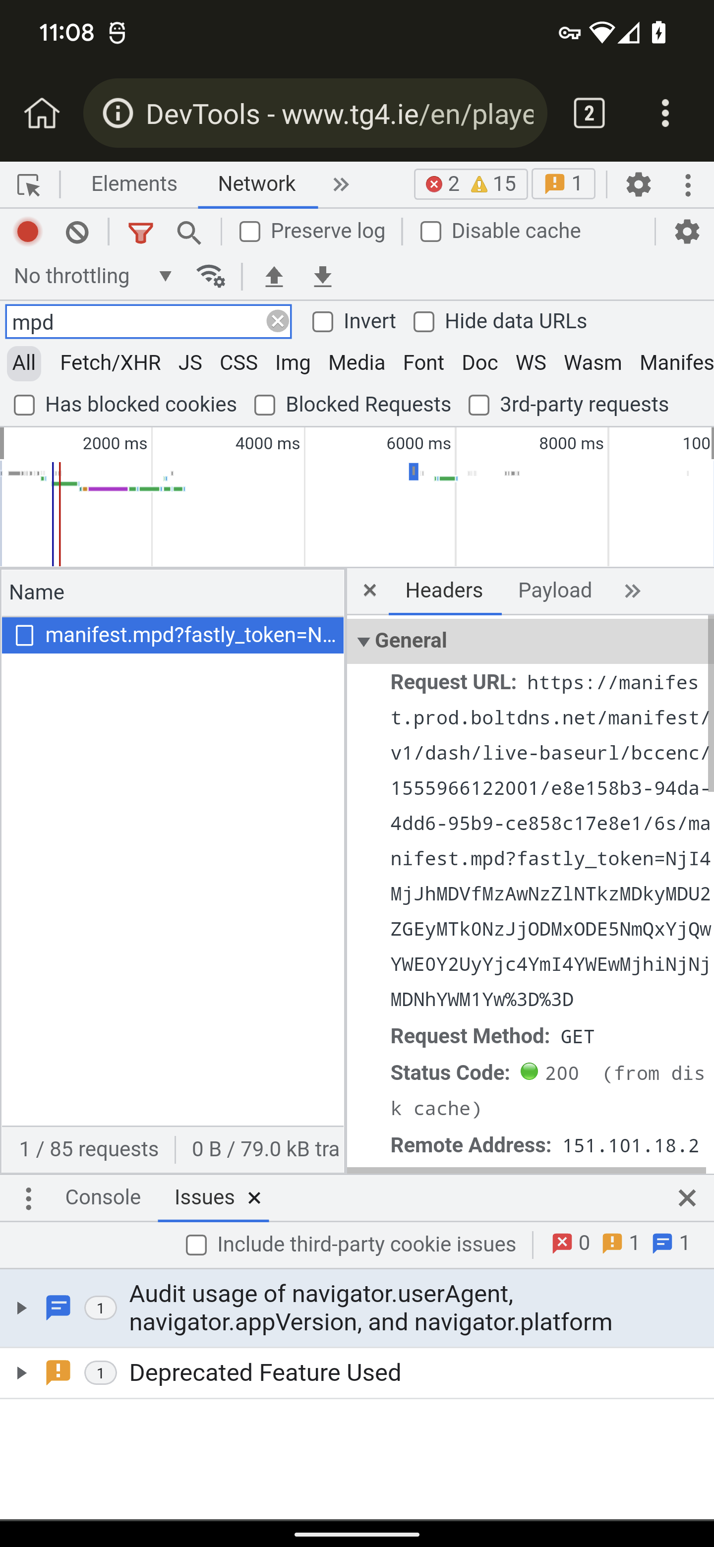

    Getting the mpd is easy. Using Kiwi-browser on your phone, install 'developer-tools' extension if not present already. kiwi browser is an adapted chrome browser so it can run chrome's extensions without the Chrome Police looking over your shoulder.
    In use, start a web page with your target video; select 'developer tools' from the browser menu. It opens another tab; start and stop the video; change tab; select the manifest et voila!

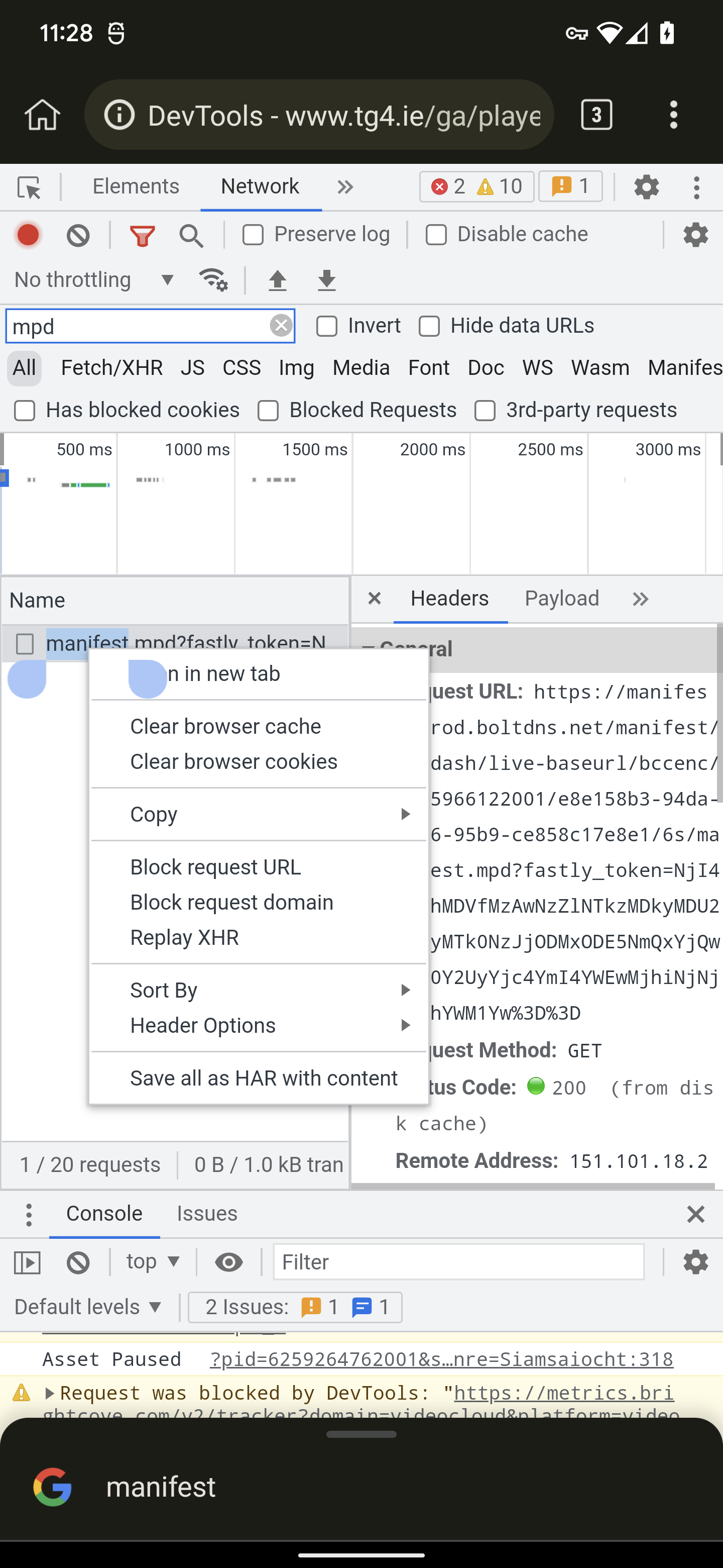

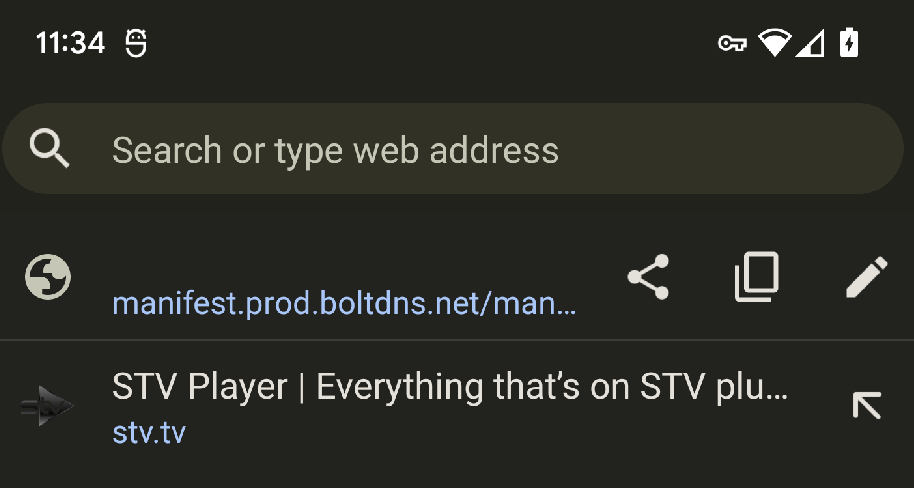

    Sharing an mpd can be a bit of a fiddle. We need the manifest as a url link in kiwi-browser to share.
    Click on the manifest and in the pop-up choose Open in new tab (the top item).

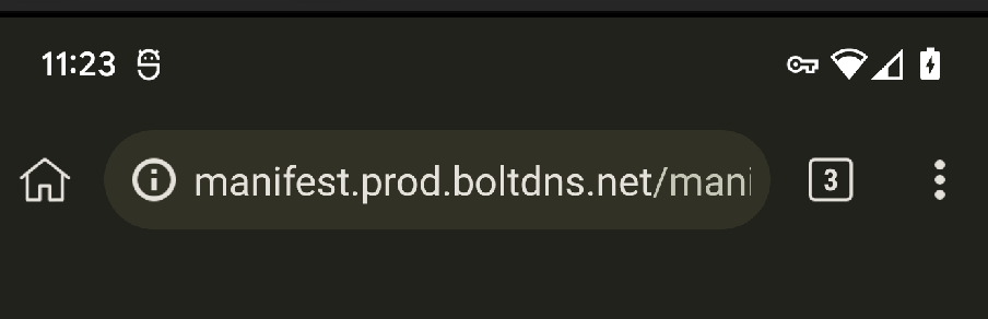

    [Attachment 64393 - Click to enlarge]
    long press to share -
