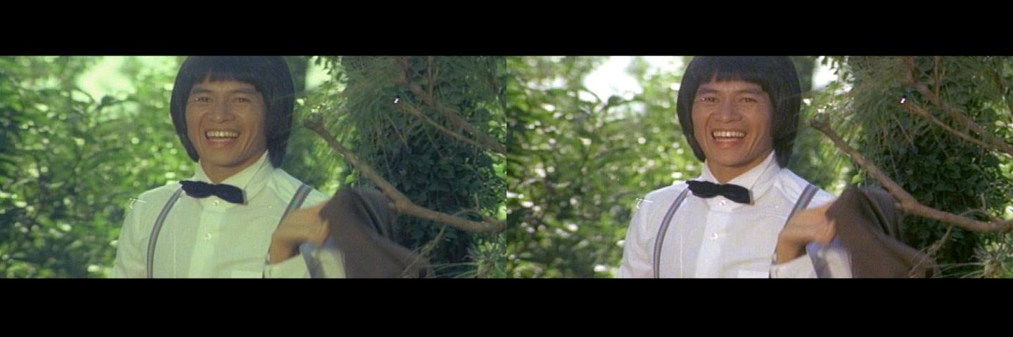

And some color correction:
before/after:Code:ColorYUV(gain_y=30, off_y=-14) ConvertToRGB().RGBAdjust(r=221.0/192.0, b=221.0/138.0, bb=-42).ConvertToYV12()
[Attachment 74153 - Click to enlarge]
This works pretty well for some shots, not so good for others. Averages out to ok-ish. -
