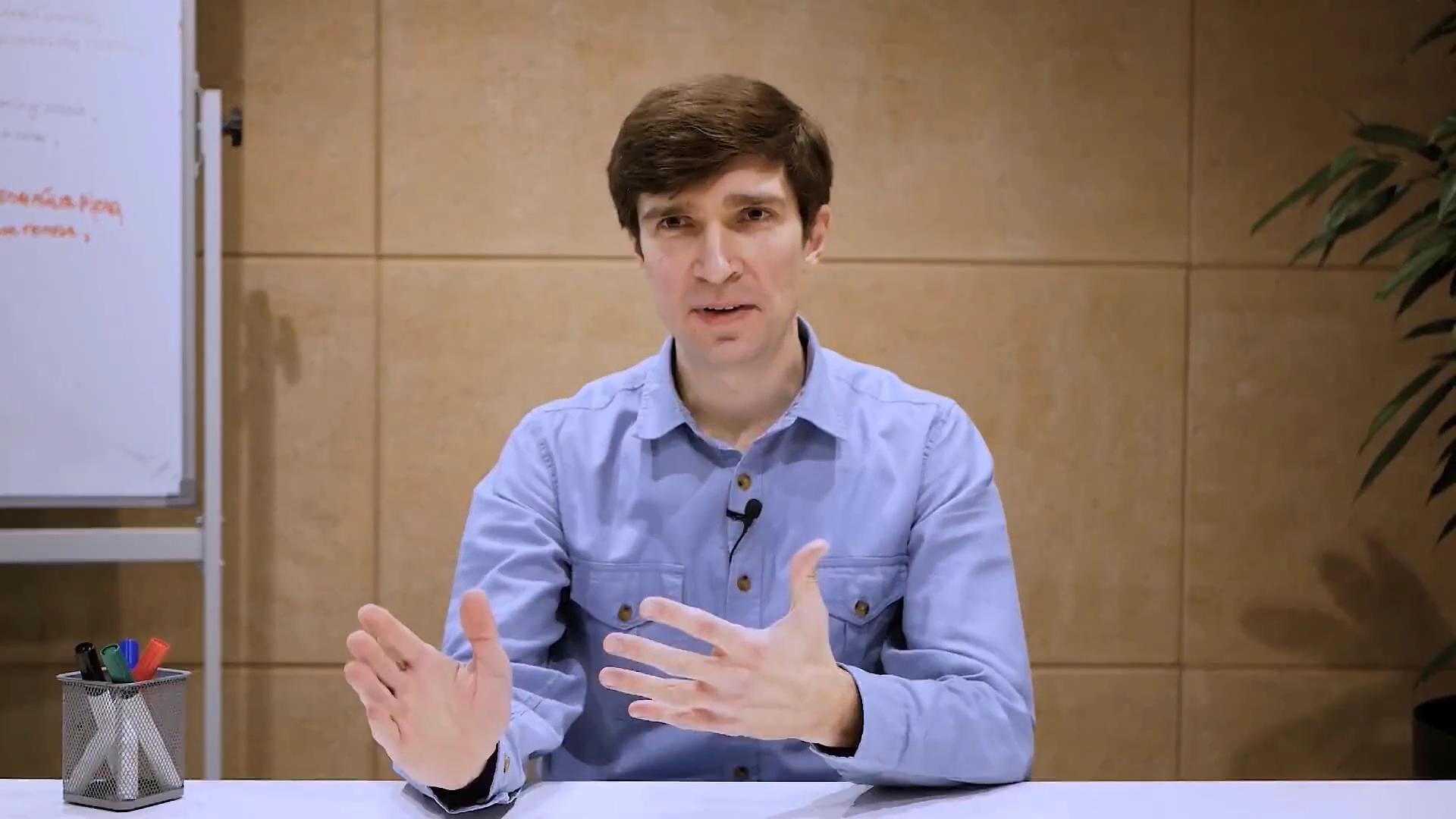

    Hello Dear forum users. I have a question. Is it possible to find marks on the video. I know that there are marks in several places on the video with the length of one frame of the video. I know how the mark looks like, it is a set of a few numbers and I know them. Is it possible to find them, any program or script.
  2. Do they ever change location ?
    Do they ever change appearance /color ? Opaque or semi-transparent ?
    How large ?
  3. It's best if you provide some sample videos. Or at least images.

    The label can be in any place, the color can also be any color. The video marks 0:02:36.05
  5. AviSynth's RemoveDirt() or RemoveDirtMC() can remove that particular mark. Here's the same frame after RemoveDirt(5,false)
    [Attachment 68684 - Click to enlarge]
    If you're only looking at finding them (for example printing a list of frames that have a mark) one can do that too. It may not be 100 percent accurate though (some false positives and some false negatives). And it may not work if the mark appears right over a moving part of the picture (the man's hands, for example).

    I need a way to find these tags . Here is the tags I was looking for looking at each frame to show which tags I need to find.
    Can you tell me in more detail how to do this.
  8. Here's an AviSynth+ script that finds the frame in the sample video:
    source = LSMASHVideoSource("tags.mp4") # mark on frame 4685
    source = source.Blur(1.0)
    RemoveDirtMC(source, 10, false)
    mt_lutxy(source, last, mt_polish("abs(x-y)"), chroma="-128")
    ColorYUV(gain_y=1000, off_y=-100)
    WriteFileIf(last, "match.txt", "AverageLuma>0.010", "current_frame", """ " : " """, "AverageLuma", append=false)
    ScriptClip(last, "Subtitle(String(AverageLuma))")
    prefetch(4)
    It gets the source video and blurs it to reduce noise. It then uses uses RemoveDirtMC to remove "dirt" that appears for only one frame, including the mark you are trying to detect. The difference between the cleaned frame and the original blurred frame is computed with mt_lutxy. That difference is amplified (and small differences discarded) with ColorYUV. If the average luma of the resulting difference stream exceeds a threshold (0.010) the frame number (and the average difference) is written to a file called match.txt. Finally the difference value is written to the video for visual reference. the output file looks like:
    102 : 0.014081
    4685 : 0.037033
    17445 : 0.010202
    Here it found three frames where something was removed by RemoveDirtMC: frames 102, 4685, and 17445. If I had used a higher value, say 0.030, it would have found only the one frame with the mark we are looking for. But sometimes the cleaned portion of the frame may not stand out as much (depending on the brightness and color of the mark and background. It will also vary depending on the size of the mark (if it ever varies). So I used a lower threshold, assuming a few false positives were preferable to not finding anything.
    You can run the script by opening it in VirtualDub (File -> Open Video File) and selecting File -> Run Video Analysis Pass. Or drag/drop it onto a batch file that uses ffmpeg to read every frame:
    time /T
    ffmpeg -loglevel fatal -i %1 -c copy -f null -
    time /T
    pause
    The script took about 15 minutes to complete on my computer. You could make it faster by reducing the frame size at the start of the script. But you will also need to change the RemoveDirt strength and the difference threshold. A quick test shows that it took about 5 minutes and half width and height.
