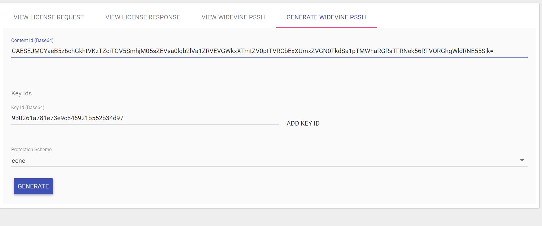

Using the https://integration.widevine.com/diagnostics site, I get this as the PSSH:
Code:AAAAjnBzc2gBAAAA7e+LqXnWSs6jyCfc1R0h7QAAAAAAAABqImIIARIQkwJhp4HnPpyEaSG1UrNNlyJMZXlKaGMzTmxkRWxrSWpvaVVrVlFURUZaTFdOa1lXSm1NVEJsTFdSbFlUY3ROR1JrWlMxaFpEZGxMVE16TnpFNU5EaGpaV1E0TnlKOUjj3JWbBg==
[Attachment 74123 - Click to enlarge]
[Attachment 74124 - Click to enlarge]
Running that through keysdb.net, I get a 412 Precondition failed error, which I believe means it doesn't like my headers.
[Attachment 74125 - Click to enlarge]
Am I doing something wrong here?

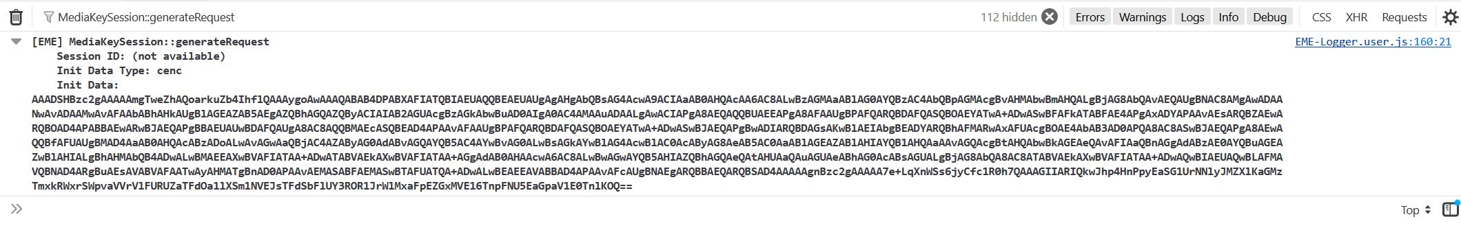

I also tried using the TamperMonkey EME logger script method and get this:
[Attachment 74126 - Click to enlarge]
The instructions I am finding for this method say to run it through here: https://base64.guru/converter/decode/hexCode:AAADSHBzc2gAAAAAmgTweZhAQoarkuZb4IhflQAAAygoAwAAAQABAB4DPABXAFIATQBIAEUAQQBEAEUAUgAgAHgAbQBsAG4AcwA9ACIAaAB0AHQAcAA6AC8ALwBzAGMAaABlAG0AYQBzAC4AbQBpAGMAcgBvAHMAbwBmAHQALgBjAG8AbQAvAEQAUgBNAC8AMgAwADAANwAvADAAMwAvAFAAbABhAHkAUgBlAGEAZAB5AEgAZQBhAGQAZQByACIAIAB2AGUAcgBzAGkAbwBuAD0AIgA0AC4AMAAuADAALgAwACIAPgA8AEQAQQBUAEEAPgA8AFAAUgBPAFQARQBDAFQASQBOAEYATwA+ADwASwBFAFkATABFAE4APgAxADYAPAAvAEsARQBZAEwARQBOAD4APABBAEwARwBJAEQAPgBBAEUAUwBDAFQAUgA8AC8AQQBMAEcASQBEAD4APAAvAFAAUgBPAFQARQBDAFQASQBOAEYATwA+ADwASwBJAEQAPgBwADIARQBDAGsAKwBlAEIAbgBEADYARQBhAFMARwAxAFUAcgBOAE4AbAB3AD0APQA8AC8ASwBJAEQAPgA8AEwAQQBfAFUAUgBMAD4AaAB0AHQAcABzADoALwAvAGwAaQBjAC4AZAByAG0AdABvAGQAYQB5AC4AYwBvAG0ALwBsAGkAYwBlAG4AcwBlAC0AcAByAG8AeAB5AC0AaABlAGEAZABlAHIAYQB1AHQAaAAvAGQAcgBtAHQAbwBkAGEAeQAvAFIAaQBnAGgAdABzAE0AYQBuAGEAZwBlAHIALgBhAHMAbQB4ADwALwBMAEEAXwBVAFIATAA+ADwATABVAEkAXwBVAFIATAA+AGgAdAB0AHAAcwA6AC8ALwBwAGwAYQB5AHIAZQBhAGQAeQAtAHUAaQAuAGUAeABhAG0AcABsAGUALgBjAG8AbQA8AC8ATABVAEkAXwBVAFIATAA+ADwAQwBIAEUAQwBLAFMAVQBNAD4ARgBuAEsAVABVAFAATwAyAHMATgBnAD0APAAvAEMASABFAEMASwBTAFUATQA+ADwALwBEAEEAVABBAD4APAAvAFcAUgBNAEgARQBBAEQARQBSAD4AAAAAgnBzc2gAAAAA7e+LqXnWSs6jyCfc1R0h7QAAAGIIARIQkwJhp4HnPpyEaSG1UrNNlyJMZXlKaGMzTmxkRWxrSWpvaVVrVlFURUZaTFdOa1lXSm1NVEJsTFdSbFlUY3ROR1JrWlMxaFpEZGxMVE16TnpFNU5EaGpaV1E0TnlKOQ==
Which I do and get this result:
[Attachment 74127 - Click to enlarge]
Running that output back through Hex to Base64, I then get this:Code:000000827073736800000000edef8ba979d64acea3c827dcd51d21ed0000006208011210930261a781e73e9c846921b552b34d97224c65794a6863334e6c64456c6b496a6f69556b56515445465a4c574e6b59574a6d4d54426c4c57526c595463744e47526b5a5331685a44646c4c544d7a4e7a45354e44686a5a5751344e794a39
[Attachment 74128 - Click to enlarge]
Which also doesn't seem to work running through keysdb.net.Code:AAAAgnBzc2gAAAAA7e+LqXnWSs6jyCfc1R0h7QAAAGIIARIQkwJhp4HnPpyEaSG1UrNNlyJMZXlKaGMzTmxkRWxrSWpvaVVrVlFURUZaTFdOa1lXSm1NVEJsTFdSbFlUY3ROR1JrWlMxaFpEZGxMVE16TnpFNU5EaGpaV1E0TnlKOQ==
[Attachment 74129 - Click to enlarge]
So clearly I'm doing something wrong in this process, but I'm not sure what. Any pointers would be appreciated! -

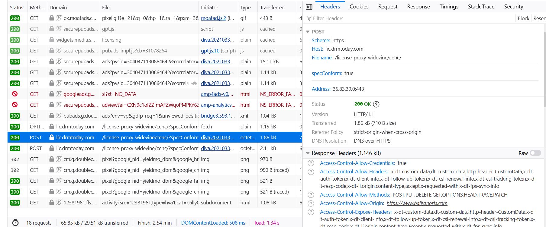

geo lock maybe, you will need add proxy
save as proxy.pyCode:import json import random import uuid import time import httpx from lxml import html class Settings: def __init__(self, userCountry: str = None, randomProxy: bool = False) -> None: self.randomProxy = randomProxy self.userCountry = userCountry self.ccgi_url = "https://client.hola.org/client_cgi/" self.ext_ver = self.get_ext_ver() self.ext_browser = "chrome" self.user_uuid = uuid.uuid4().hex self.user_agent = "Mozilla/5.0 (X11; Fedora; Linux x86_64) AppleWebKit/537.36 (KHTML, like Gecko) Chrome/79.0.3945.130 Safari/537.36" self.product = "cws" self.port_type_choice: str self.zoneAvailable = ["AR", "AT", "AU", "BE", "BG", "BR", "CA", "CH", "CL", "CO", "CZ", "DE", "DK", "ES", "FI", "FR", "GR", "HK", "HR", "HU", "ID", "IE", "IL", "IN", "IS", "IT", "JP", "KR", "MX", "NL", "NO", "NZ", "PL", "RO", "RU", "SE", "SG", "SK", "TR", "UK", "US", "GB"] def get_ext_ver(self) -> str: about = httpx.get("https://hola.org/access/my/settings#/about").text if 'window.pub_config.init({"ver":"' in about: version = about.split('window.pub_config.init({"ver":"')[1].split('"')[0] return version # last know working version return "1.199.485" class Engine: def __init__(self, Settings) -> None: self.settings = Settings def get_proxy(self, tunnels, tls=False) -> str: login = f"user-uuid-{self.settings.user_uuid}" proxies = dict(tunnels) protocol = "https" if tls else "http" for k, v in proxies["ip_list"].items(): return "%s://%s:%s@%s:%d" % ( protocol, login, proxies["agent_key"], k if tls else v, proxies["port"][self.settings.port_type_choice], ) def generate_session_key(self, timeout: float = 10.0) -> json: post_data = {"login": "1", "ver": self.settings.ext_ver} return httpx.post( f"{self.settings.ccgi_url}background_init?uuid={self.settings.user_uuid}", json=post_data, headers={"User-Agent": self.settings.user_agent}, timeout=timeout, ).json()["key"] def zgettunnels( self, session_key: str, country: str, timeout: float = 10.0 ) -> json: qs = { "country": country.lower(), "limit": 1, "ping_id": random.random(), "ext_ver": self.settings.ext_ver, "browser": self.settings.ext_browser, "uuid": self.settings.user_uuid, "session_key": session_key, } #print(qs) return httpx.post( f"{self.settings.ccgi_url}zgettunnels", params=qs, timeout=timeout ).json() @staticmethod def sleep() -> None: min_tunnels_pause = 10 max_tunnels_pause = 25 def rand_range(low: int, hi: int) -> float: if low >= hi: raise Exception("RandRange: low boundary is greater or equal to high boundary") delta = hi - low return low + random.random() * delta sleep_duration = int(rand_range(min_tunnels_pause, max_tunnels_pause)) # sleep_duration = 10 # seems 10 is enough print("Please wait for "+str(sleep_duration)+" seconds.") time.sleep(sleep_duration) class Hola: def __init__(self, Settings) -> None: self.myipUri: str = "https://hola.org/myip.json" self.settings = Settings def get_country(self) -> str: if not self.settings.randomProxy and not self.settings.userCountry: self.settings.userCountry = httpx.get(self.myipUri).json()["country"] if ( not self.settings.userCountry in self.settings.zoneAvailable or self.settings.randomProxy ): self.settings.userCountry = random.choice(self.settings.zoneAvailable) return self.settings.userCountry def init_proxy(data): settings = Settings( data["zone"] ) # True if you want random proxy each request / "DE" for a proxy with region of your choice (German here) / False if you wish to have a proxy localized to your IP address settings.port_type_choice = data[ "port" ] # direct return datacenter ipinfo, peer "residential" (can fail sometime) hola = Hola(settings) engine = Engine(settings) userCountry = hola.get_country() session_key = engine.generate_session_key() #engine.sleep() tunnels = engine.zgettunnels(session_key, userCountry) return engine.get_proxy(tunnels) if __name__ == "__main__": CC = input("Input desired country code: ") test = init_proxy({"zone": CC, "port": "peer"}) print(test) -

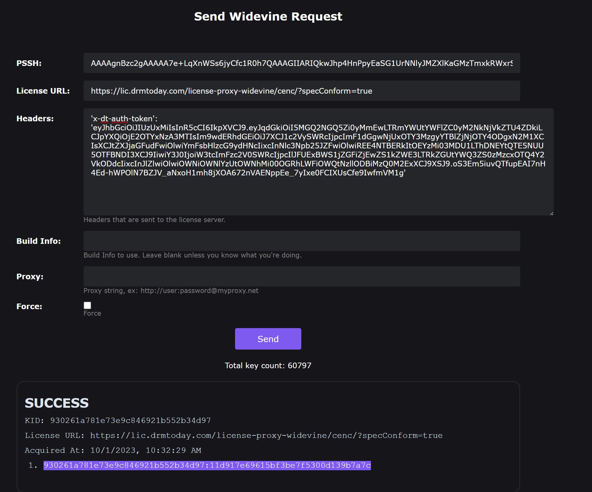

Thanks, iamghost. It looks like you're onto something with the geolock. I refreshed my browser trying to pull the cURL values and noticed it was asking to allow to find my location.
[Attachment 74130 - Click to enlarge]
I allowed that and entered in the newly generated token and that seems to have worked, running through keysdb.net.
[Attachment 74131 - Click to enlarge]
Will that be enough with my local CDM, or would I need to add in your script somewhere into my l3.py workflow if I'm using that method to generate the keys? -

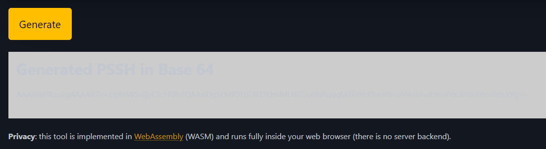

great work, that will be a nice replacement to the axinom tools!
ive been testing the new updates and the hex value "3200" gets appended to the pssh after the key_id or content_id, when the policy field is empty. i think this should be removed if theres no policy.
oh and i dont know if its something thats easy to fix but the generated pssh output box is hard to see when the windows theme is set to dark.
[Attachment 77257 - Click to enlarge] -

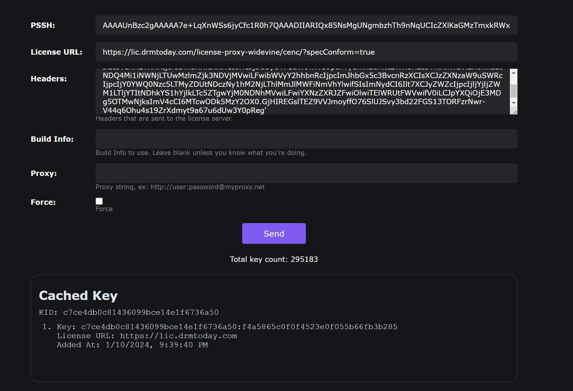

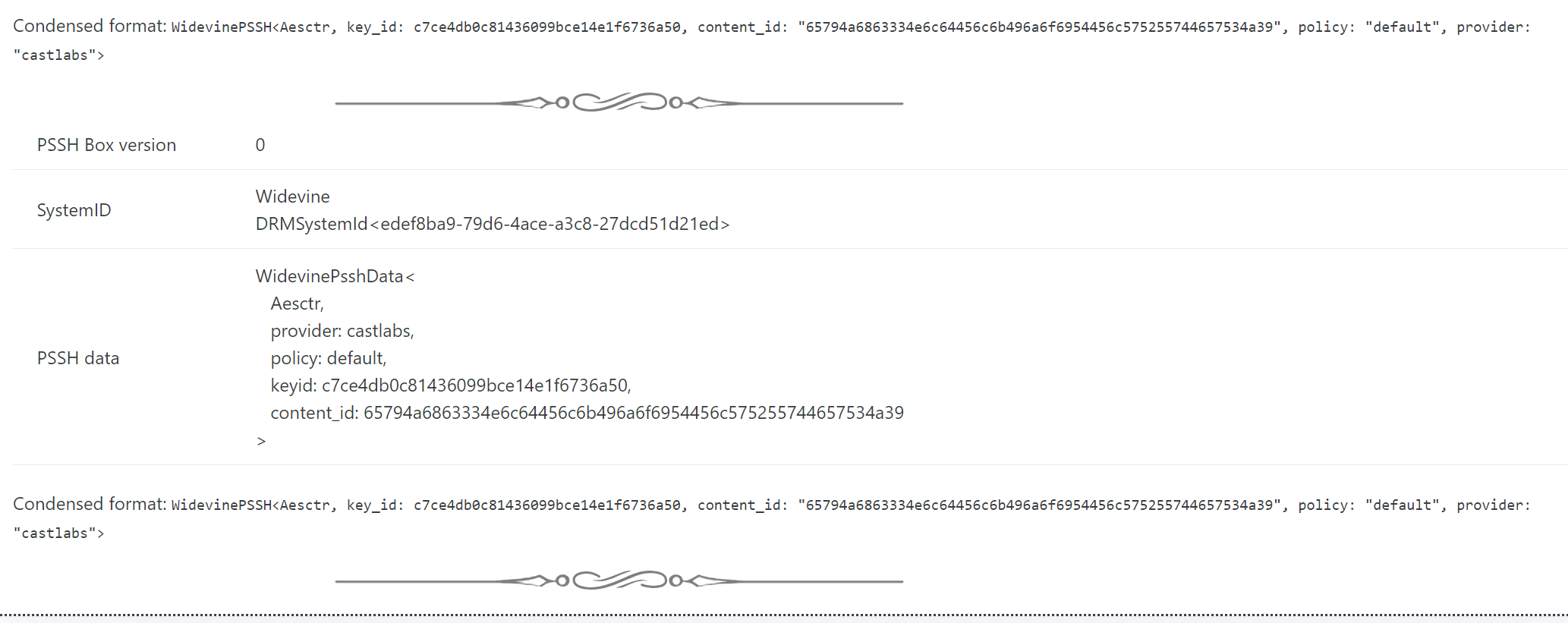

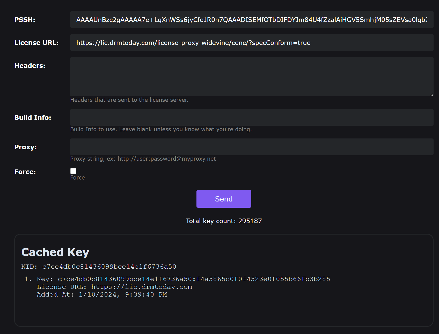

Just as an update with my test for any who might be interested.
I used the Fetch PSSH Data tool to retrieve information from the init I find in developer tools:
[Attachment 77284 - Click to enlarge]
Then use the keyid and contentid from there in the PSSH Box Generator (leaving all other fields default), to get a PSSH.
This is a different PSSH I get then by using the EME script logger method, which is:Code:AAAAUnBzc2gAAAAA7e+LqXnWSs6jyCfc1R0h7QAAADISEMfOTbDIFDYJm84U4fZzalAiHGV5SmhjM05sZEVsa0lqb2lURWxXUlV0RldTSjkyAA==
However, running both PSSHs through a CDM does yield a decryption key. Not sure why the methods generate different PSSHs, but they both worked for me, nothing that they both did pull up a previously cached key.Code:AAAAUnBzc2gAAAAA7e+LqXnWSs6jyCfc1R0h7QAAADIIARIQx85NsMgUNgmbzhTh9nNqUCIcZXlKaGMzTmxkRWxrSWpvaVRFbFdSVXRGV1NKOQ==
[Attachment 77285 - Click to enlarge]
[Attachment 77286 - Click to enlarge]
I'll try another file later tonight or tomorrow and note if I find anything different.
