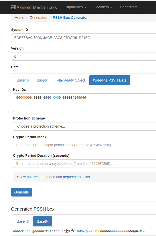

  1. Hi there,
    I've been reading through a post on here of how to figure out the pssh if one isn't shown in the mpd, it says you can determine this by the cenc:default_KID= and the schemeIdUri=
    I'm trying to figure out the pssh from this info using https://tools.axinom.com/decoders/PsshBox when I input that info I get an error, could someone please explain what I'm doing wrong? Thanks again for all the help on this great board it is much appreciated.
    urn:uuid:EDEF8BA9-79D6-4ACE-A3C8-27DCD51D21ED
    cenc:default_KID="00000000-0000-0000-0000-000004140946"
  2. Originally Posted by kev043 View Post
    Hi there,
    Not that but this: https://tools.axinom.com/generators/PsshBox
    [Attachment 63118 - Click to enlarge]
  3. Ah thanks zackmark29, I wondered why it was different. Cheers

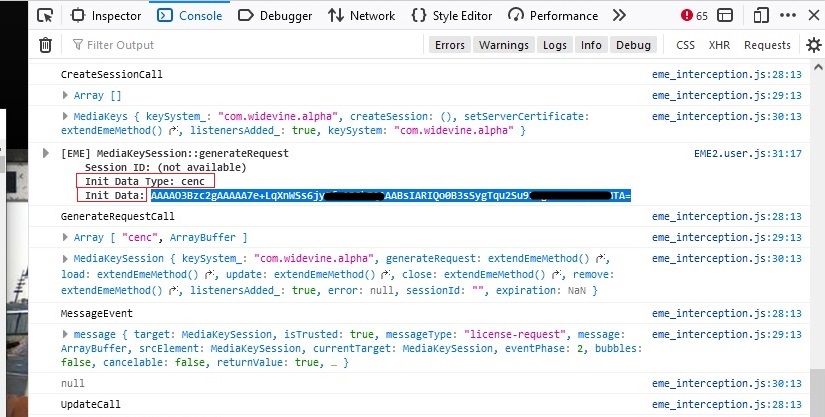

  9. 3 methods to find PSSH:
    1- The simplest one: PSSH is clearly indicated in MPD file. Download MPD file (browser add-on "MPD Detector" will give you MPD link), open it with Notepad, search for pssh value.
    2- If there is KID, but no PSSH in MPD, calculate PSSH by using KID:
    3- EME Logger script (installed on "Tampermonkey" add-on) will give you init data. That's your PSSH... Developer Tools>Console, under "MediaKeySession::generateRequest" you will find Init Data.

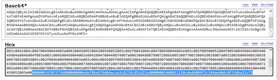

    If that Init Data is very very long, convert it to HEX:
    https://base64.guru/converter/decode/hex
    Find the Widevine-characteristic segment: 7073736800000000edef8ba979d64acea3c827dcd51d21ed
    PSSH box = PSSH header + PSSH system ID (for Widevine, EDEF8BA9-79D6-4ACE-A3C8-27DCD51D21ED) + 32-bit data size (0000001c) + PSSH payload
    PSSH header is (000000xx70737368), you will take the 8 digits before 7073... xx is changeable.
    Copy from "8 digits before 7073" to the end. These are in HEX. Convert it to Base64 again. That's your PSSH. The image will make it clear:

  12. If you still can't understand...
    After Base64>HEX conversion, you will find a Widevine-PSSH box like this:
    000000347073736800000000edef8ba979d64acea3c827dcd51d21ed0000001408011210d46997150ece4f3ca1b249bdb8be1102
    PSSH header is always 000000xx70737368 - xx is changeable, here it is 34 and you will take 6 zeros before it.
    Then comes 8 zeros.
    Then, system ID. For Widevine, it is edef8ba979d64acea3c827dcd51d21ed. You will easily find that value after HEX conversion.
    Then, 32 bit data (0000001x format), here x is 4.
    Then PSSH payload. 40 digits in my case, could be more or less.
    They are shown in different colors.

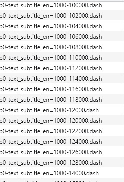

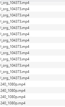

    I use 4 sites:
    On 3 of them, Dev.Tools-Network shows me lots of dash files (fragments) incoming.
    On the other site, I see single-mp4-files incoming (One mp4 file for each video resolution and one mp4 file for each audio language).
    Never seen an "init mp4" file.

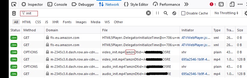

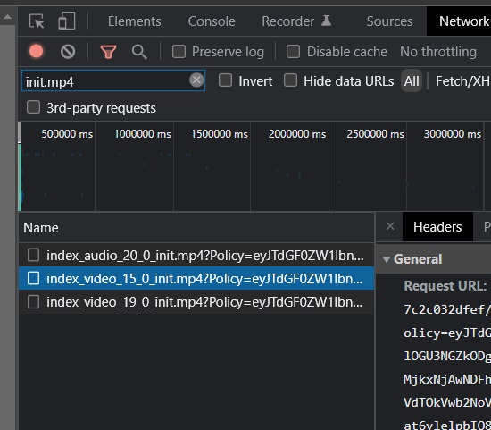

  18. If you are filtering the url for mpd (or lic, wv etc) you may not see the init.mp4. If you dont filter the url for anything and F5, you may then see it. Vegeta is correct, the vast majority of sites use an init segment for both video and audio, typically named init.mp4 and init.m4a. (Audio extension can vary inc mp4 too).
    If you only use 3-4 websites you are getting a distorted narrow view of the reality out there. The vast majority of dash websites use intitialization segments.
    And the pssh and lots of other info can be gathered by running:
    mp4dump.exe init.mp4

  20. No one is trying to 'make you wrong'. The 3 websites you use out of the whole internet is giving you a distorted view, because you won't accept what people with more experience like vegeta are trying to explain to you, that is; your experience of not dealing with inits is the exception to the rule, not the norm.
    Plus, you are not the OP, you hijacked the thread. The OP's original question was: "how to work out the pssh when its not in the mpd" and the surefire way is mp4dumping the init.
    The most convenient/quickest method is the EME logger tampermonkey script. There are lots of other methods too.
    Tampermonkey script in action below using the init data from Fubo USA to attain the pssh:
    [Attachment 63584 - Click to enlarge]
    Another minor little website called NBA League Pass uses init files too.
    Also recognize this one below ? Inits.
    [Attachment 63585 - Click to enlarge]

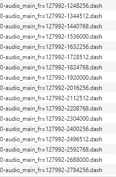

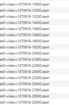

  21. Single mp4-files incoming (no init mp4. A mp4 file for each resolution and for each audio track):
    [Attachment 63593 - Click to enlarge]
    Dash files incoming (There are much more dash fragments, that is only a tiny screenshot):
    [Attachment 63594 - Click to enlarge]
    [Attachment 63595 - Click to enlarge]
    [Attachment 63596 - Click to enlarge]
    @codehound Did I really hijack this thread? "How to work out the pssh when its not in the mpd"...
    Are you blind or are you a troll? Look at the second and the third methods I wrote. One is "when there is only KID in MPD", the other one is "when there is no KID and no PSSH". What do these mean? "Pssh is not in the mpd". Use your brain.
    I wrote all the methods I used in a single post. Should I write them to other threads, so they will be harder to find? 4-5 guys thanked me for that message.
    If you don't like my posts, add me to your ignore list.
