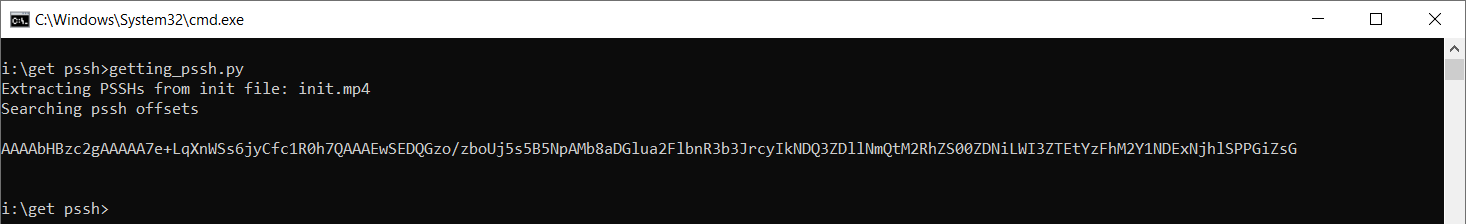

  9. I need a script which shows all 3 scripts, do you have one? I am writing a script which will decrypt and download, if I can get the proper pssh. It would be helpful!
  10. thanks zackmark29,
    changeing a little to getting the all pssh's from init and filter with characters limit 70 to 190
    and write just filtered in pssh.txt file
    import base64
    from pathlib import Path
    def find_wv_pssh_offsets(raw: bytes) -> list:
        print('Searching pssh offsets')
        offsets = []
        offset = 0
        while True:
            offset = raw.find(b'pssh', offset)
            if offset == -1:
                break
            size = int.from_bytes(raw[offset-4:offset], byteorder='big')
            pssh_offset = offset - 4
            offsets.append(raw[pssh_offset:pssh_offset+size])
            offset += size
        return offsets
    def to_pssh(content: bytes) -> list:
        wv_offsets = find_wv_pssh_offsets(content)
        return [base64.b64encode(wv_offset).decode() for wv_offset in wv_offsets]
    def from_file(file_path: str) -> list:
        print('Extracting PSSHs from init file:', file_path)
        return to_pssh(Path(file_path).read_bytes())
    pssh_list = from_file('init.mp4')
    target_pssh = None
    for pssh in pssh_list:
        if 70 < len(pssh) < 190:
            target_pssh = pssh
    print(f'\n{target_pssh}\n')
    print(target_pssh, file=open("pssh.txt", "w"))
    [Attachment 70739 - Click to enlarge]
    should i have mp4dump.exe inside the folder?
