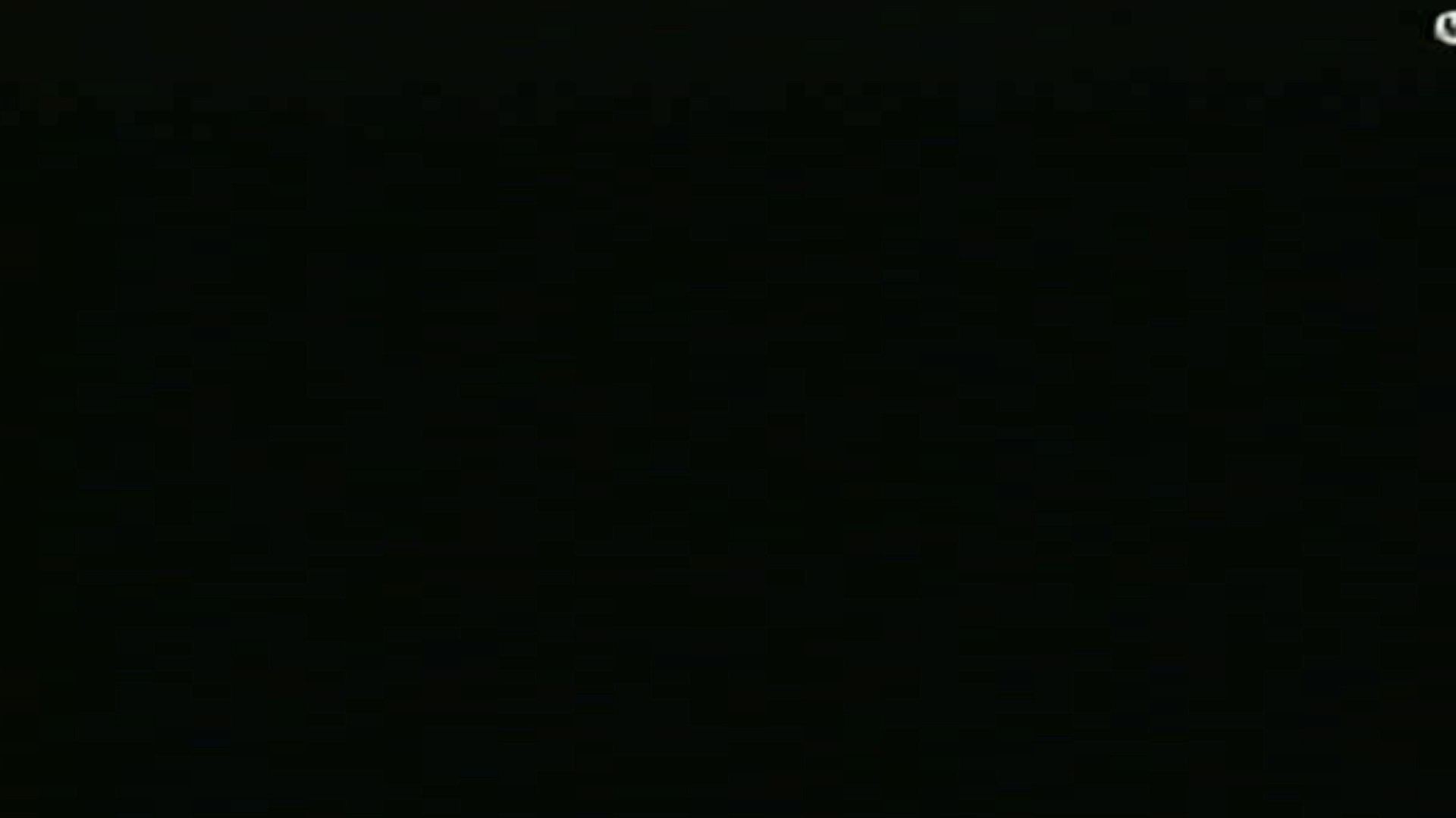

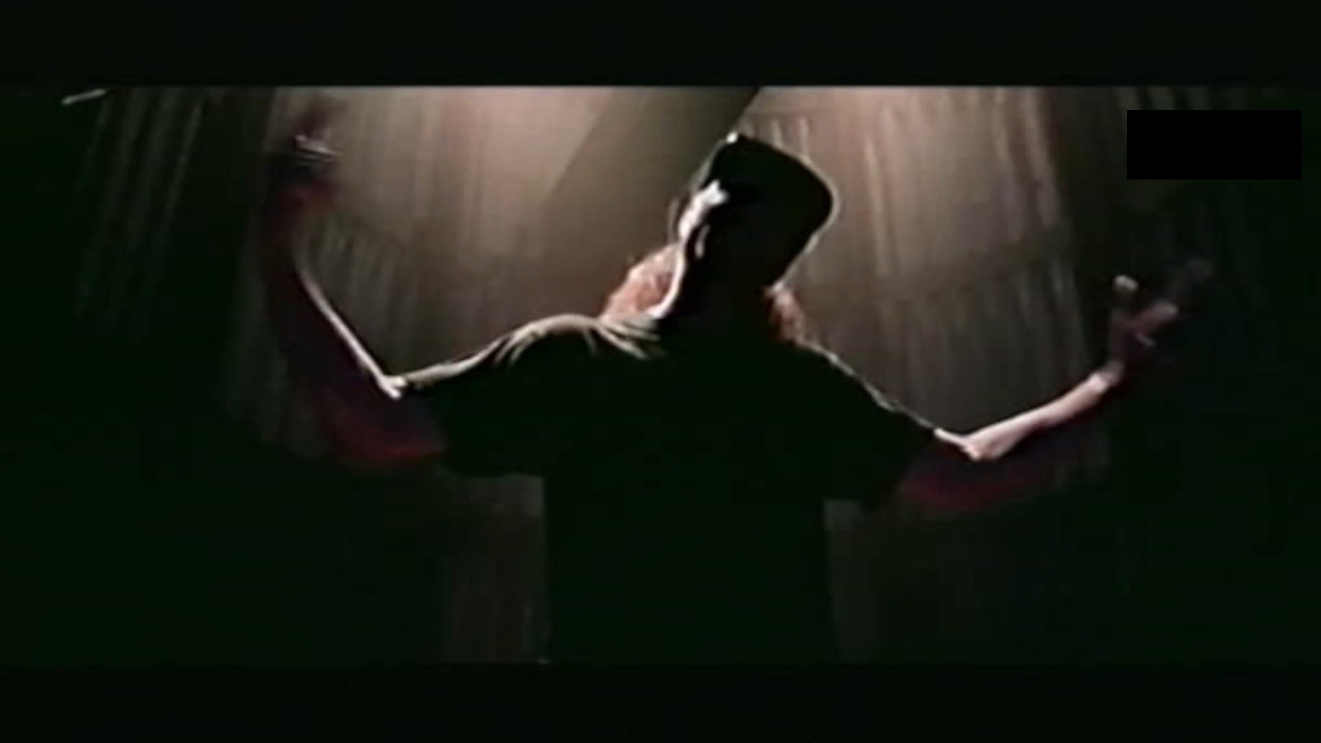

  3. Hide there is also another problem/question, a black/grey screen/collor get greeny (green tint), how this can be?
    vhs
    [Attachment 71622 - Click to enlarge]
    vhs "black" screen
    [Attachment 71623 - Click to enlarge]
    YouTube:
    [Attachment 71624 - Click to enlarge]

  7. Originally Posted by anonymoustly View Post
    Misaligned White Balance, for example.
