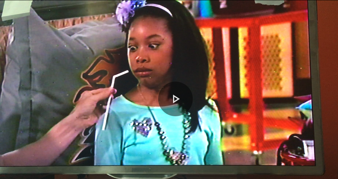

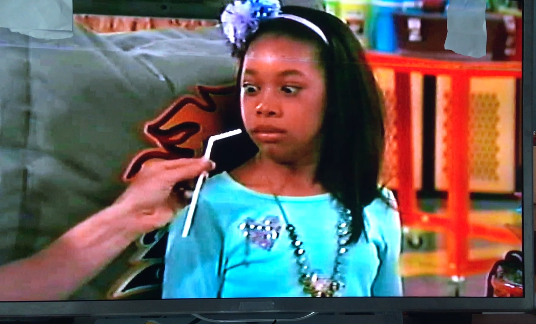

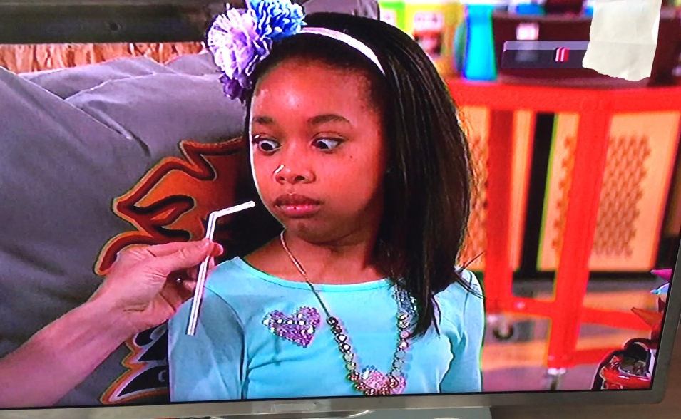

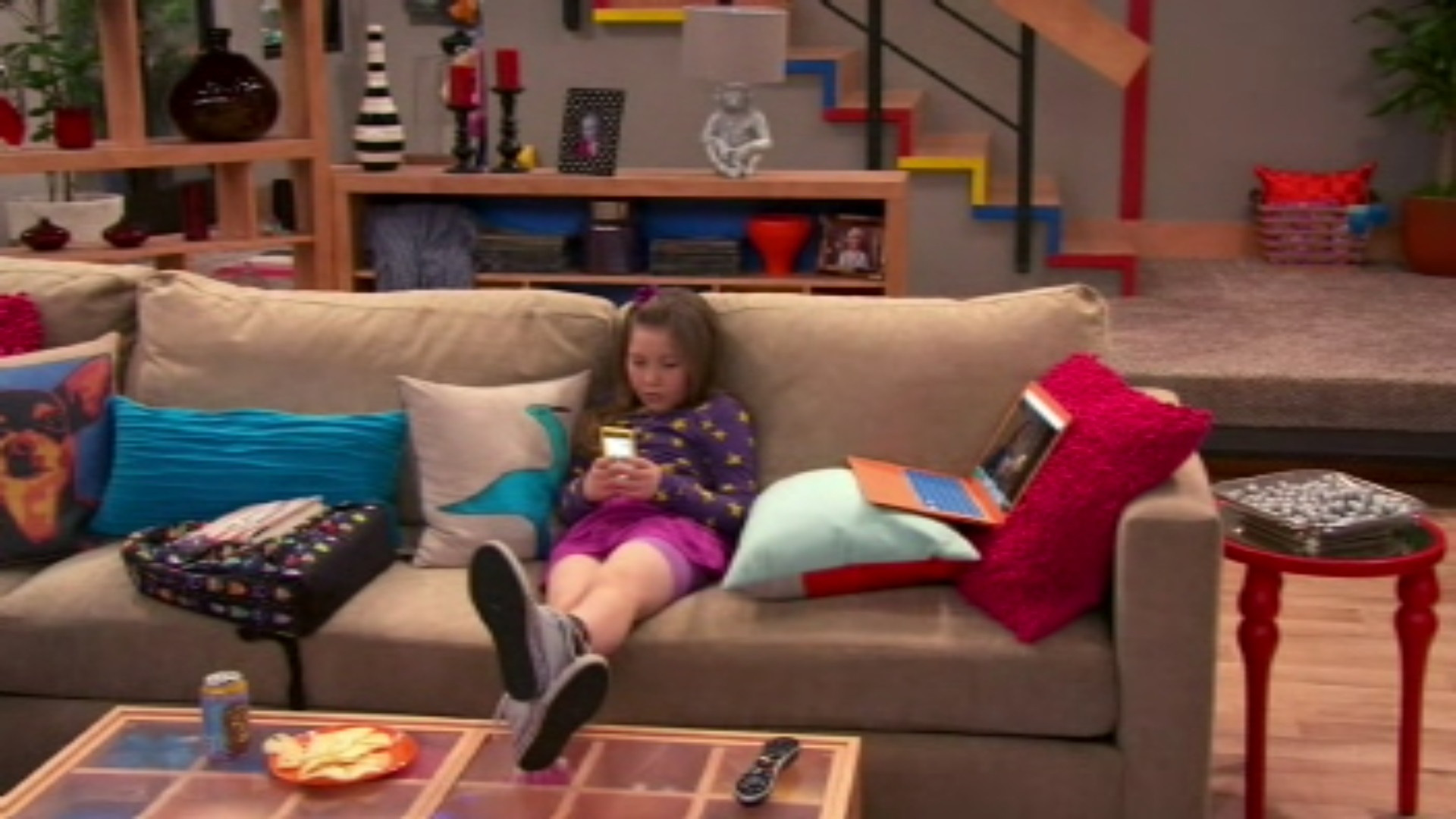

    And do VHS recorders sometimes add blur when downconverting from 720x576 to 352x288 resolution to reduce aliasing effects? That's what I can reason.
    look at the photo frame near the candles, with DVD CIF you can see the dots, with VHS only a blurry spot.
    DVD CIF (352x288 pixel)
    [Attachment 71599 - Click to enlarge]
    VHS 240 lines NTSC
    [Attachment 71600 - Click to enlarge]

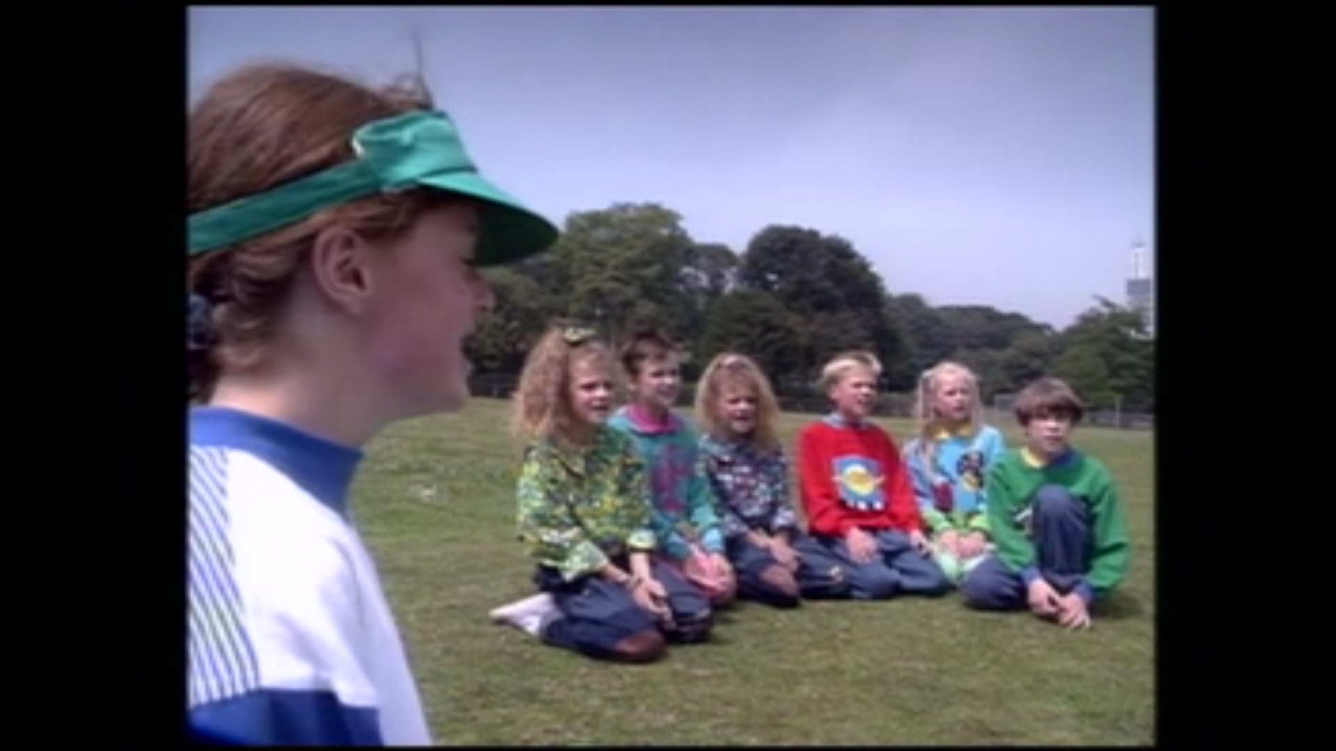

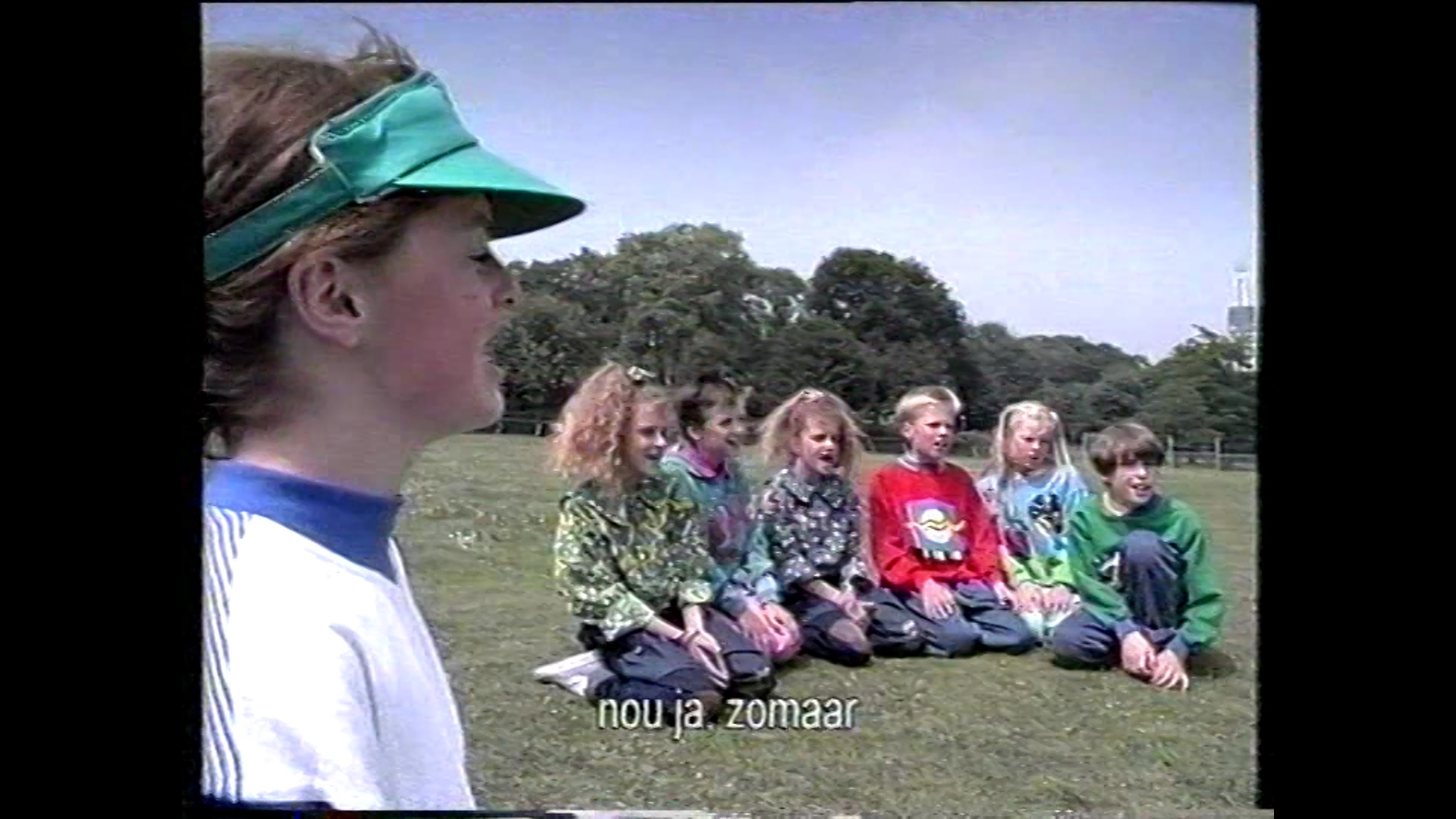

  5. Strange no the qaulity is swapped.
    DVD CIF
    [Attachment 71602 - Click to enlarge]
    VHS PAL
    [Attachment 71603 - Click to enlarge]
    and what are this shadows? (VHS, not on the DVD CIF version)
    [Attachment 71604 - Click to enlarge]
  6. Originally Posted by anonymoustly View Post
    this is luminance/chrominance misalignment - common for analog video where luminance signal and chrominance signal are processed separately - due different bandwidth (and as such time delay a.k.a. group delay) frequently luminance and chrominance signals can be shifted - luma/chroma delay.
    Also effect can be emphasized if luminance processing circuitry use some form of TI (transient improvement) only for luminance (LTI) but not for color transient improvement (CTI).

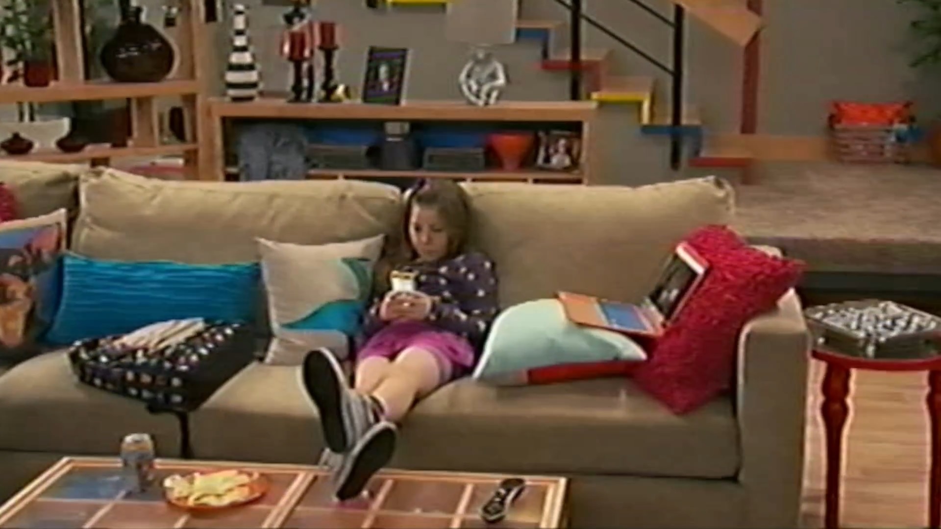

  21. VHS original screencap
    [Attachment 71615 - Click to enlarge]
    VHS to Digital screencap
    [Attachment 71614 - Click to enlarge]
    Composite from 1024x576 DVD (seperate MPEG file, not DVD standard 720x576)
    [Attachment 71616 - Click to enlarge]
    It seems most of shapness already lost at the VHS recording. And not at the TV capture card.
    The Digital VHS copy very grainly and also MPEG blocks, however the bitrate is very high.
  22. Member Skiller's Avatar
    Oct 2013
    Germany
    Yes, of course.
    I noticed your VCR needs a heads cleaning procedure (or at least a cleaning tape). The first photo shows the typical comet-like drop outs of dirty video heads.
    Other than that, you are probably asking for too much with a standard VCR connected to a modern TV. That combination is going to look bad in any case.
