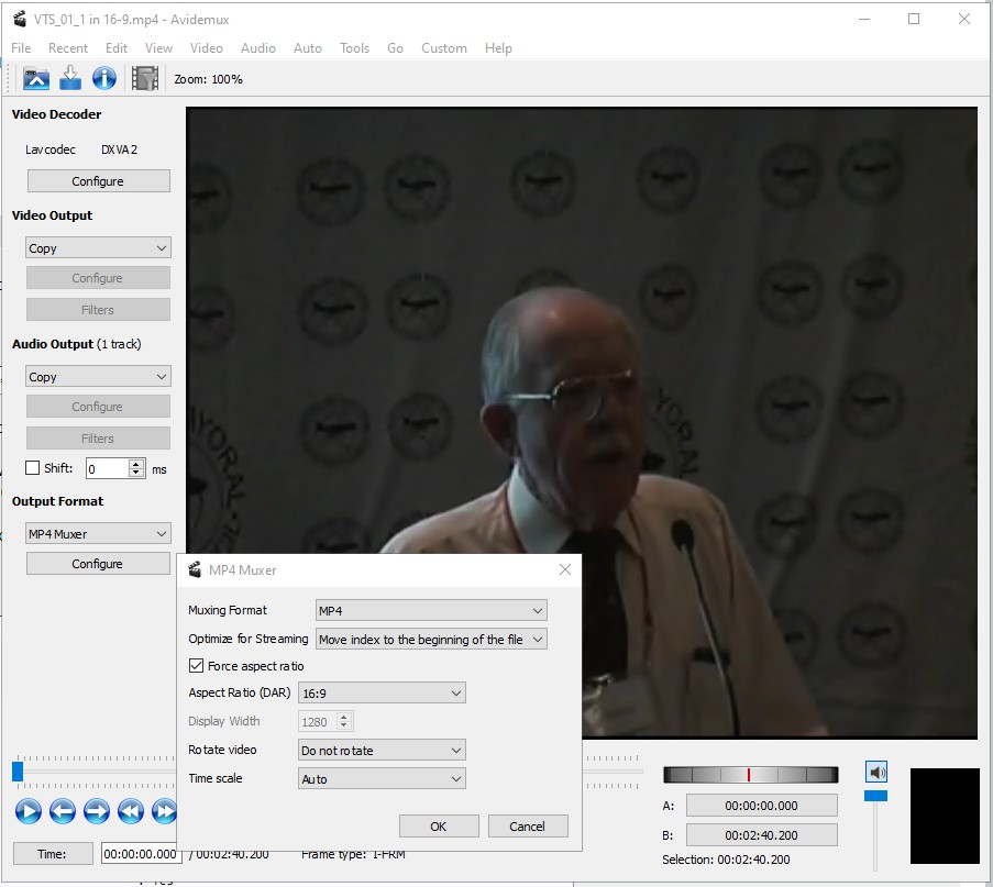

    AVIDemux should do it. It can be run in portable mode so you don't need to install it.
    Set it up as follows, setting the DAR in the MP4 Muxer Config:
    [Attachment 67791 - Click to enlarge]
    Then click the Down arrow at the top to smart-render your MP4 into whatever DAR you chose.

    Did some trials with AVIDemux: VLC Player correctly played a 1024x576 4:3 file I converted to 16:9, but Windows Film and TV and my NLE still displayed it as 4:3. The Mediainfo DAR is 16:9, the ODAR is 4:3. Bummer.
    Where's ProWo when we need them?

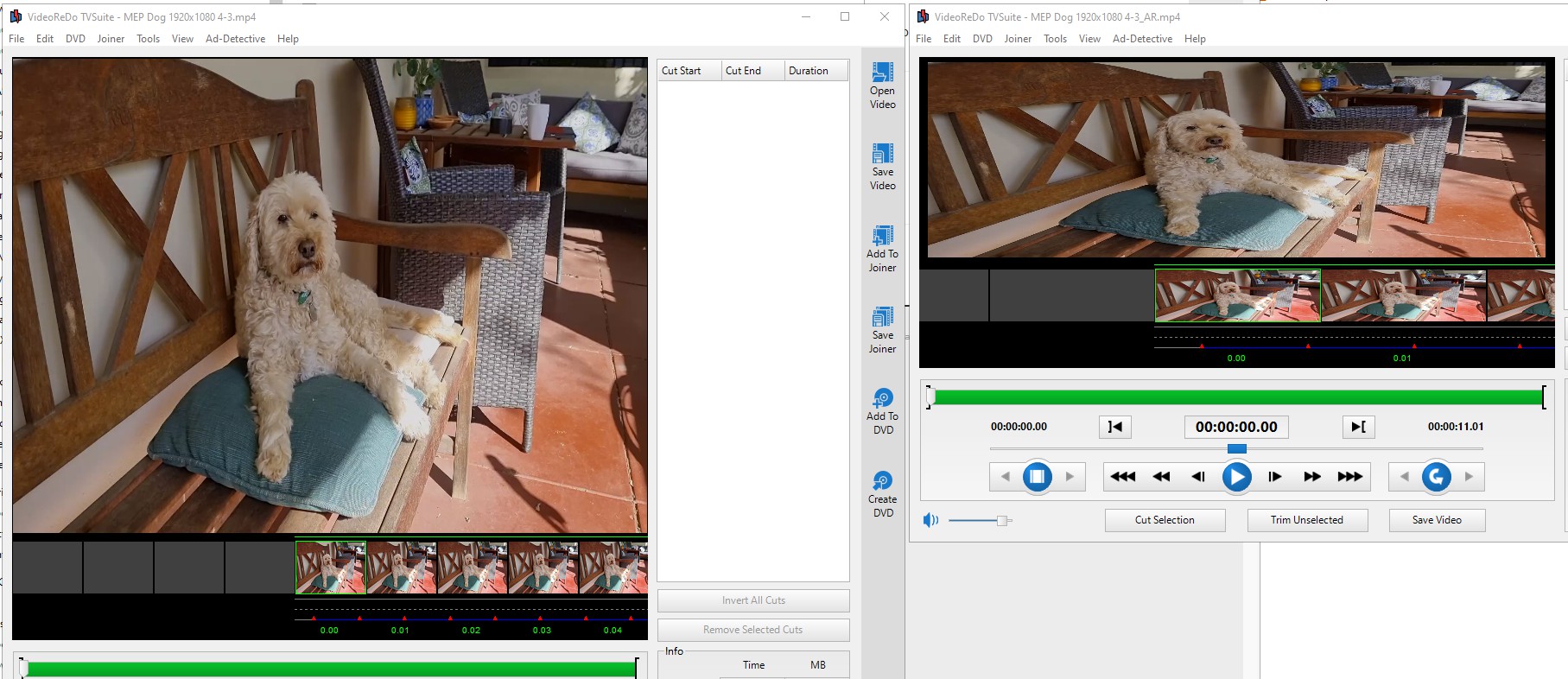

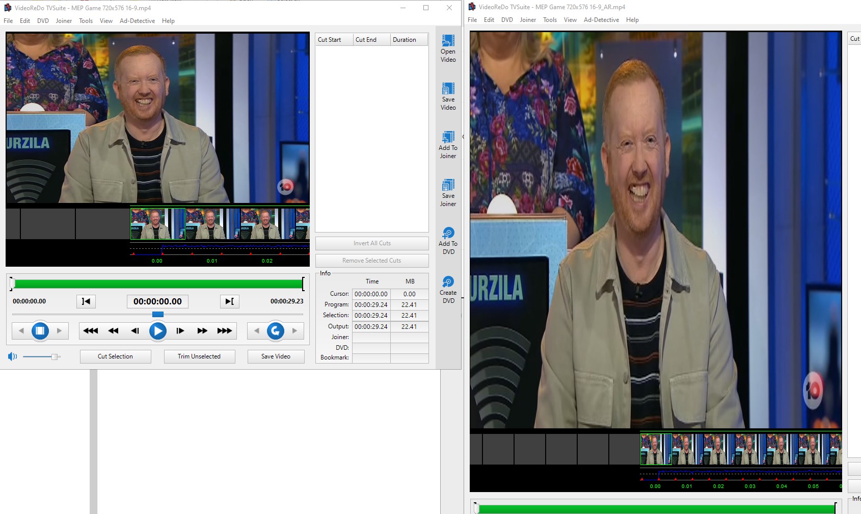

    I'm having no luck with this. I've got both BATs working OK, but every conversion is still not displaying properly in Films and TV my NLE and VideoRedo. In VLC Player and VDub, all conversions display correctly.
    Attached are are my two source files. The game show is encoded correctly at 16:9; the dog video needs to be stretched from 4:3 to 16:9.
    Game:
    [Attachment 67807 - Click to enlarge]
    Dog:
    [Attachment 67808 - Click to enlarge]
    Last edited by Alwyn; 24th Nov 2022 at 21:59. Reason: Images added, black bars ref removed.
  14. For the Dog, you wouldn't use the values posted above
    a 16:9 1920x1080 file would need a SAR of 1:1, and a DAR of 16:9 - so you'd adjust those values accordingly
    because DAR = FAR x SAR (these sometimes have different names, but the ratios mean are the same)
    Display Aspect Ratio = Frame Aspect Ratio x Sample Aspect Ratio
    16/9 = 1920/1080 * 1/1
    -aspect 16/9 -bsf:v h264_metadata=sample_aspect_ratio=1
    There are rare cases in some software where sometimes the container AR signalling is combined with the stream signalling and you get distorted results. If you had to choose (1), go with the stream values

  18. Originally Posted by Alwyn View Post
    Where did you get the photos on the right?
    When I open both files in Videoredo, they are displayed correctly, MEP_Game as 16:9, MEP_Dog as 4:3.
    Both are also displayed correctly on the left side of your photos.
    So where is the problem?
  19. Originally Posted by Alwyn View Post
    A further question: there is a similar topic here:
    https://forum.videohelp.com/threads/407660-Convert-DVDs-with-Incorrect-Resolution-Header/page2
    where the header of a VOB (let's say an MPEG) needs to be changed in a similar fashion to this topic to make it play correctly.
    I've used DVD Patcher to change the header but it then won't play in some players.
    Can a similar FFMPEG command (smart-recode) be used on an MPEG 2 file and if so, what would it be?
    The subject VOB is attached (I hope greenrobert doesn't mind!). It is 4:3 but should be 16:9.
    Thanks!
    ffmpeg -i VTS_01_1-00.07.43.863-00.07.54.874.VOB -map 0 -c copy -bsf:v mpeg2_metadata=display_aspect_ratio=16/9 VTS_01_1-00.07.43.863-00.07.54.874_16_9.VOB
    May 2005
    Australia-PAL Land
    After running my files thru the earlier scripts; note the _AR suffixs.
    Yes, I agree, but the dog is 4:3 (as shown) when I want to change it to 16:9.
    The game is correctly displayed as 16:9 (which I shouldn't have used, because the issue was converting a incorrectly coded 4:3 file to 16:9; I should have used a 4:3 file incorrectly coded as 16:9).
    The dog is incorrectly displayed (well, the VRD display is correct, but the file is incorrectly coded as 4:3).
    The dog needs to be changed from 4:3 to 16:9. The latest script does that.

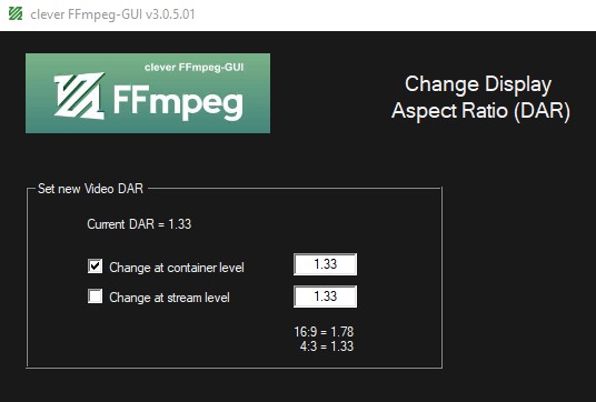

  22. @ Alwyn
    You can try the newest beta of clever-FFmpeg-GUI.
    Added: Change DAR at stream level and/or container level, for avc, hevc, mpeg2.
    https://files.videohelp.com/u/292773/clever_ffmpeg_gui_newest_beta.zip

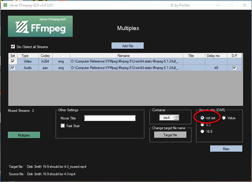

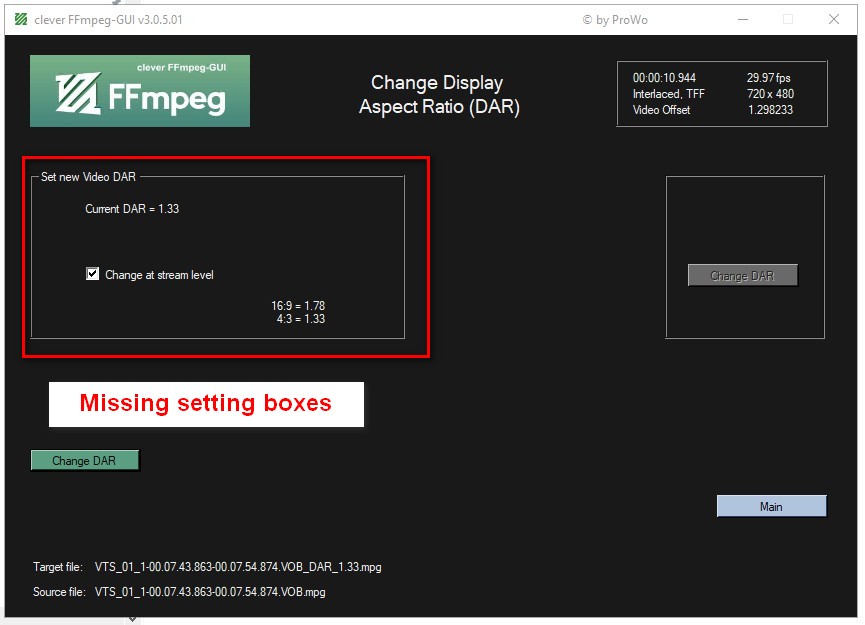

    @ProWo, excellent! That changes H264 and HEVC (got a warning about couldn't find scan type for the HEVC).
    I tried it with a MPG/VOB, and I couldn't change the DAR:
    [Attachment 67840 - Click to enlarge]
    Otherwise, should be a great solution for the OP.
    I note you've simplified the setting of that "bin" folder with that image; makes life much easier for us non-nerds.
    The only other comment I have would be that we have to also set the DAR on the Multiplex screen. be good if that was set from the info we put in on the "Change DAR" screen. Not a major issue but just another thing to set (or miss) prior to Multiplexing.
    [Attachment 67839 - Click to enlarge]
    One more thing! We get an MKV and MP4 on Output, as opposed to just the selected container.
    Great work though. Thanks.

    So MPEG 2 will require a different bitstream filter (mpeg2_metadata=...). HEVC will require another (hevc_metadata=...). Etc.
    Understood, for MPG/VOB, Clever FFMPEG is missing the input boxes for the Container and Stream DARs:
    [Attachment 67841 - Click to enlarge]
  27. Originally Posted by Alwyn View Post
    Should work now, in the newest beta (link below).
    Done too.

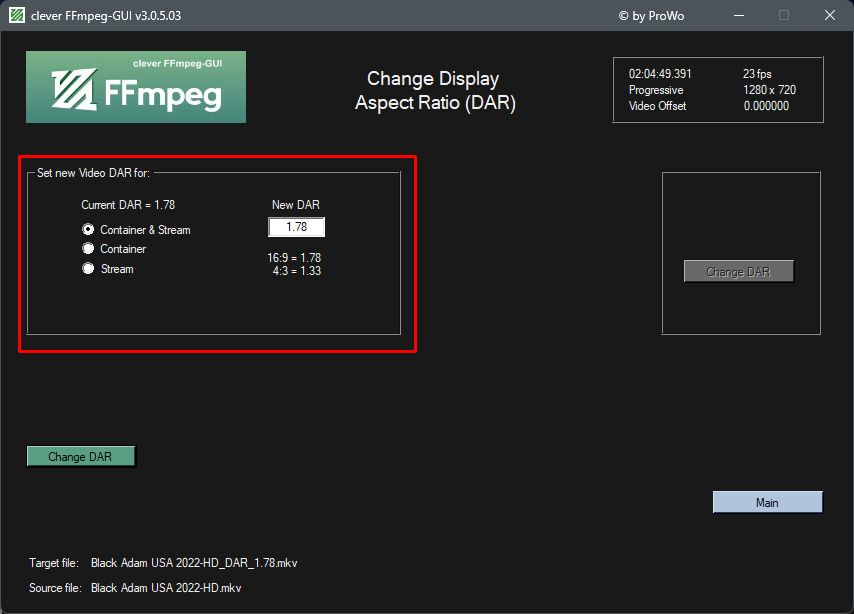

  28. Originally Posted by jagabo View Post
    Bitstream settings are specific to each codec.
    https://ffmpeg.org/ffmpeg-bitstream-filters.html
    This will be taken into account in the newest beta (Link above).

    @ProWo, that's fantastic. It all works perfectly, I changed 16-9 and 4-3 MP4s and MPEGs to the opposite without a problem.
    Thanks very much.
