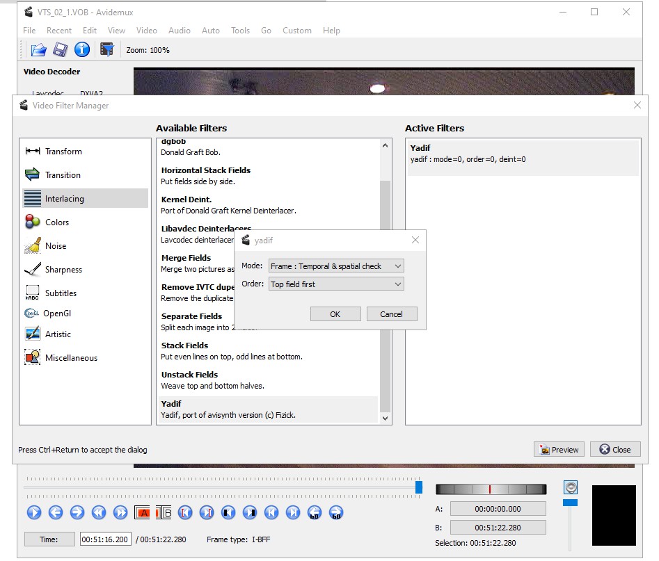

    AVIDemux does have a de-interlace setting in the "Filters" section of the Video Output; some of the forum members may have comments to make about what to set there, or if it is necessary at all. Mediainfo reports the resulting MP4 is Progressive, and I can't see any interlacing.
    [Attachment 67738 - Click to enlarge]

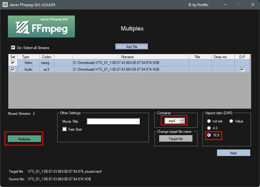

    Can you tell me exactly how I would "mux your source file into a mp4 container"? Yes, it would be nice not to have to re-encode. But I have no idea what you mean or how to do that.
    Use clever FFmpeg-GUI.
    Load your vob, click main, click multiplex, select mp4 as container and 16:9 as DAR, click multiplex, done.
    [Attachment 67739 - Click to enlarge]

  25. Originally Posted by Alwyn View Post
    If you're not going to recode, wouldn't you be better off saving as a MPG?
    The other issue is, does this join the multiple VOBs?
    The op asked for a simple way to turn his dvd into an mp4. A simple remux is one possibility.
    As for your second question:
    clever FFmpeg-GUI can merge all VOB's automatically.
    To do this, select the first VOB file (e.g. VTS_01_1) at startup and answer yes to the question.
    This also works directly from the DVD in the drive if it is not protected.
    Thank you for your help, Alwyn. I know very little about the video world and appreciate all the help people are offering here.
    Can you please explain the talk about interlacing? Is it a good thing or a bad thing? I only know the term from CRT televisions. Should I be concerned about this? If so, why? Thanks!

  28. Originally Posted by GreenRobert View Post
    Thank you for that clever FFmpeg-GUI suggestion, ProWo. This does indeed produce an MP4 quite rapidly. I am guessing it somehow does this without recoding? I don't understand how that is possible as I thought VOB is an older standard than MP4. But that probably shows my ignorance about "containers" and all that other stuff.
    VOB or MP4 are containers, like ZIP or RAR.
    The streams contained in the VOB container of a DVD are compatible with the MP4 container. Thus, when muxing, the streams contained in the VOB container are simply copied to an MP4 container. That's why it's so fast.
    One question: When I pick the first VOB and say "Yes" to ripping the entire "movie" it only produces a joined VOB. Is there any way to go directly from this step to the MP4 output? As it is, I need to create that intermediate joined VOB file and then run the program again.
    This joined vob file is the new sourcefile and, after ripping all parts and joining them, is automatically loaded as new source file. Do you can just continue with main, then either re-encode (convert video stream) or just re-mux (multiplex) as discussed above.
    If you take only a single VOB file from the DVD (e.g. VTS_01_1.VOB), then you have only a part of the movie.
    Therefore you have to join all parts first.
    Thank you! I indeed see now that after it joins the pieces it gives the option to return to Main to do the conversion. This utility is indeed exactly what I needed!
    Thank you for explaining how MP4 is like ZIP. So... Is there something like an un-ZIP utility that allows you to peek inside the MP4 and see what is inside? And to extract what is inside?
