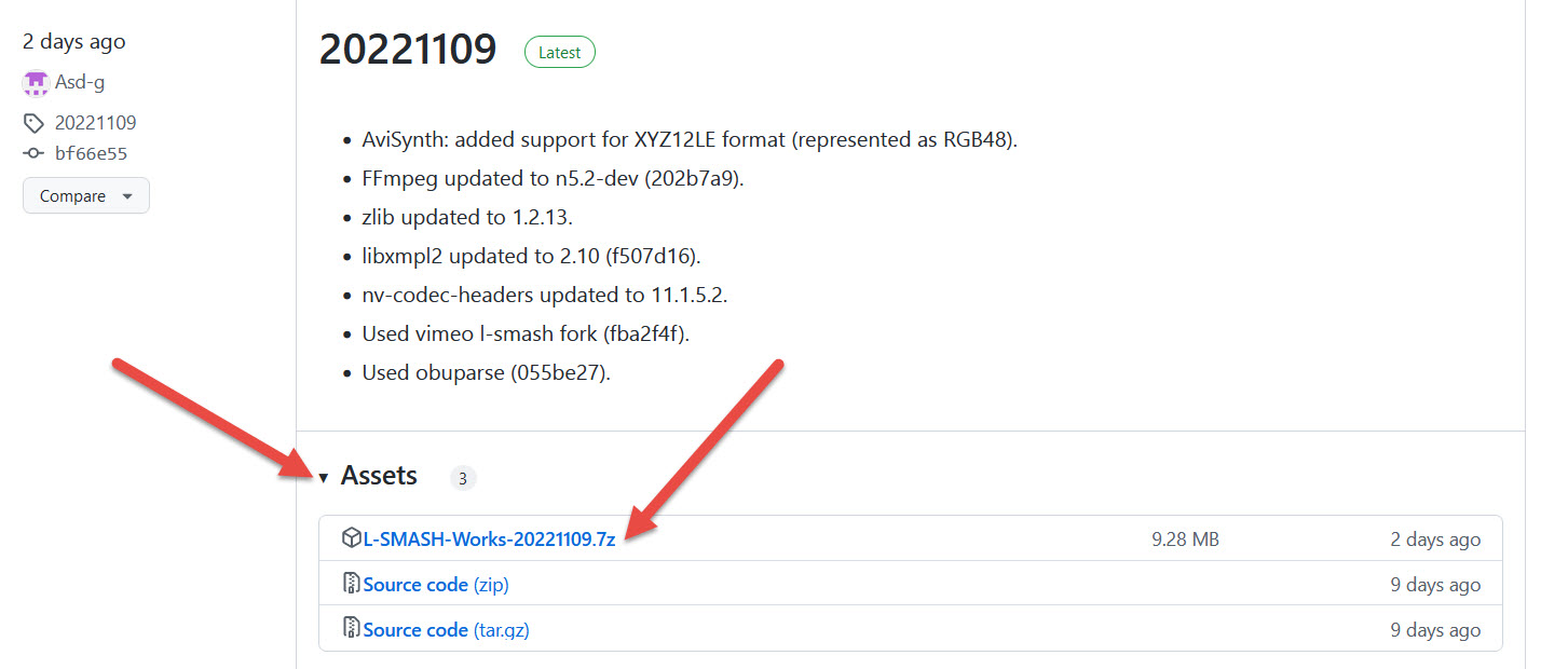

  16. Link worked, many thanks but how did you find this?
    The other file links on github were revealed by Clicking on "Assets"!
    I know this might seem odd, but I can find no links on above releases page.
    Thanks for your reply, turns out it was the browser not showing links.
    probably a security setting went rouge or something.
  17. Originally Posted by Tom4 View Post
    I have no idea where to find the file links from here: https://github.com/HomeOfAviSynthPlusEvolution/L-SMASH-Works/releases
    I know this might seem odd, but I can find no links on above page.
    Twirl down (open) the Assets menu by clicking on the black triangle
    I posted a direct download link above as well
