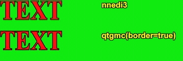

  1. Hi there.
    sorry for the rant but I just don't get it. I have a large collection of DVD's and spent a long time figuring out how to properly encode/deinterlace them. For some titles I just keep them as a Remux but the majority needs some enhancements (e.g. correcting AR, cropping, deinterlacing, etc.).
    I kept hearing about QTGMC and for a long time I was actually one of the people who believed it to be the best deinterlacer out there. Until I started observing and questioning things.
    Don't get me wrong, QTGMC is a great script and it's way more than just a deinterlacer. But for my purposes I don't think QTGMC is the best deinterlacer out there like so many people claim.
    So to my first question: why is QTGMC so destructive?
    I get it, the script has so many possibilities and it's a great denoiser. However for deinterlacing purposes I think NNEDi3 is still the best possible option out there.
    I have a lot of DVD's which are very grainy (shot on film) or "suffer" from digital noise (shows shot on tape). I am a purist and I like to keep things as they are - and call me crazy but I actually like digital noise (well, it depends..) as it adds some texture to the content. Note that I'm mostly talking about content from the 80's to early 2000's so the noise (old sitcoms for example) look more like grain (luminance noise?) than the typical digital camera noise (chroma noise?).
    I haven't found a way to make QTGMC look like the actual source or close to lossless. This is most likely because you can't turn off denoising completely. Trust me, I have spent countless of hours tweaking my settings with lossless presets, ezkeepgrain, grainrestore, noiserestore, sigma, etc.
    At first glance it might seem everything is okay and looks good, but the reality is that QTGMC is "too smart" and there's no way to make it dumber.
    For example no matter the settings you choose, the grain/noise will not stay the same.. The image looks sharper and cleaner, so does the grain/noise (it looks finer, like a DVD source grain compared to 1080p scan grain if you get me). But that is entirely artificial and shows that QTGMC isn't really retaining the grain, it adds artificial one.
    And in my cases this has become very obvious and it looks very bad in some scenes. For example a wall looks grainy and when a person in front of it is walking or moving their head it kinda acts like a magnet to the grain making it appear very weird and it just looks off and inconsistent. I have noticed this across various sources as well.
    I know QTGMC uses a mix of many different deinterlacers on a scene by scene basis such as NNEDI3, yadif, etc. so I dared to take the step to finally replace QTGMC with something else..
    I always wondered why yadif in VLC was less destructive than QTGMC when obviously yadif is way worse (aliasing). That's because yadif is mostly just deinterlacing/interpolating and it does not really process the whole image.
    I now completely switched to NNEDI3 and couldn't be happier to be honest. Yes, QTGMC might be doing a better job completely eliminating jaggies but so far I haven't noticed any problems or visual annoyances using NNEDI3, to me it's literally perfect and I wish I tried it sooner.
    So my last question is: why do so many people still recommend using QTGMC when asked about a good deinterlacer? Am I just weird for liking grain or noise and trying to not mess with the picture as best as I can? I can't stand grainy (live-action) sources being heavily filtered, there's always some leftover grain/noise that will make the picture look completely inconsistent and horrible to watch, that's also why I can't stand low bitrate encodes (especially when viewing on modern screens).
    There will probably be people who call me dumb and that I haven't fiddled with the settings enough to make it work (which I did, it's impossible imo). But why would I need to do that? Especially when people recommend QTGMC to noobs who most likely just use the standard presets because they don't want to spend time fine-tuning the settings.
    I'm curious to hear other people's opinion about it as I haven't heard anything negative about QTGMC at all which confuses the heck out of me.
    Thanks for reading and Merry Christmas to all

    I myself do not like QTGMC much – at default settings.
    I spent... I don't know... years tweaking and refining it to find settings that make it close to transparent for my sources. And I pretty much suceeded.
    You said if you make QTGMC keep the grain, the grain looks too fine and artificial. I had this problem as well. The key setting here is NoiseDeint="bob". And there are more which may not even seem like they are (as a side effect) related to noise (especially the TR and Rep settings).
    The reason QTGMC is so "destructive" is due to the way the core works. It basically works like this: first it does a dumb bob-deinterlace (with or without more intelligent spatial interpolation such as NNEDI), then temporally blurs the differences in bob-shimmer away and uses motion compensation to detect where to do that and where not to avoid a motion blur effect. That was the original concept written by Didée and named TempGaussMC. It's a bob-shimmer remover. As you can imagine, the side effect of this approach is rather strong denoising. But luckily the script evolved dramatically over the years and allows for the side effects to be compensated – although not too many peoply seem to be offended by those.
    Here is my honest recommendation of settings for keeping grain and making the deinterlacing quite transparent to my eyes.
    Even if you are happy with NNEDI3 alone now, I would like to hear your thoughts on these settings.
    QTGMC(TR0=2, TR1=2, TR2=1, Rep0=1, Rep1=0, Rep2=4,
    \ DCT=5, ThSCD1=300, ThSCD2=110,
    \ SourceMatch=3, Lossless=2, Sharpness=0.1, Sbb=0, MatchPreset="slow",
    \ NoiseProcess=2, GrainRestore=0.0, NoiseRestore=0.4, NoisePreset="slow",
    \ StabilizeNoise=false, NoiseTR=0, NoiseDeint="bob")

  29. Originally Posted by sebastiaaan View Post
    NNEDI3 is a single field deinterlacer only . When used alone for double rate deinterlacing, NNEDI3 does not compensate for the odd/even field ofset . You can end up with up/down/up/down motion (it might not be as noticable with a shaky camera, or lower quality/soft video). On adjacent frames, lines don't match up between objects - this one of the causes for NNEDI3 temporal aliasing and flickering artifacts. Similarly, NNEDI3 doesn't address the top/bottom frame border edges either - there is missing data on either the top or bottom frame edges on adjacent frames (because of even/odd scan lines) - QTGMC with border=true switch (not the default setting) compensates for that.
    [Attachment 62572 - Click to enlarge]
    This is a slowed down gif demo about 1/6 the speed (note in realtime 59.94p the artifacts will be less noticable to most people..., and on certain "organic" images with curves, not lines like buidings, fences etc.. - but the fact is there are expected artifacts because of how NNEDI3 works as an intrafield deinterlacer).
    For QTGMC - The denoising and softening is by far the most common complaint. Another is the default sharpening strength is too high - when combined with the denoising at default settings, many sources look like "waterpaintings" or "plasticky." Other semi common QTGMC "negatives" - temporal artifacts. Sometimes the motion estimation is incorrect. e.g. ghosting issues. Another semi-common QTGMC complaint is the mvtools2 block discrepanies. Instead of being a single consistent image, some blocks or parts of the image might appear to move in slightly different directions (This can affect mvtools2 based denoisers as well).
    Pros/cons to everything. Tradeoffs no matter what you do. The underlying problem is interlace in the first place - there is only so much you can do when 1/2 the lines are discarded. QTGMC is recommended for general use because in most cases it resembles the original 59.94p source the most (before the immediate source became interlaced) . A true progressive source shouldn't have that flicker or aliasing artifacts common to most deinterlacers.
