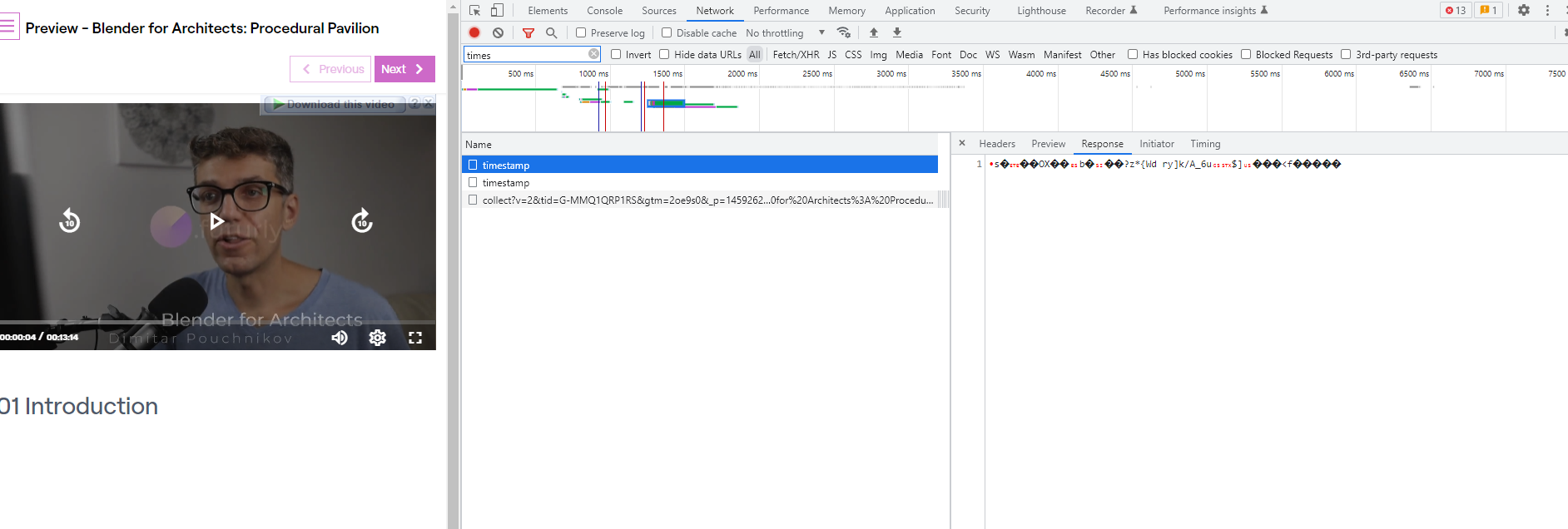

  1. i am trying to download this video
    https://www.futurly.com/s/preview/courses/blender-architecture#6337f80fe4b05a534f0e3d5a
    it is encrypted with aes 128 , i have gone through many post on videohelp , but there is no solution for this
    the key uri is k/timestamp
    #EXT-X-KEY:METHOD=AES-128,URI="k/timestamp",IV=0x496daa1c6914000e408c65cead91fc29
    how to deal with this timestamp file , the response is encrypted too
    [Attachment 67104 - Click to enlarge]
    i am as a worst developer gone throuhg the javascript but found nothing but one of my freind send me this
    [Attachment 67105 - Click to enlarge]
    as a poor guy i dont even know how to deal with this
    pls help me crack this encryption

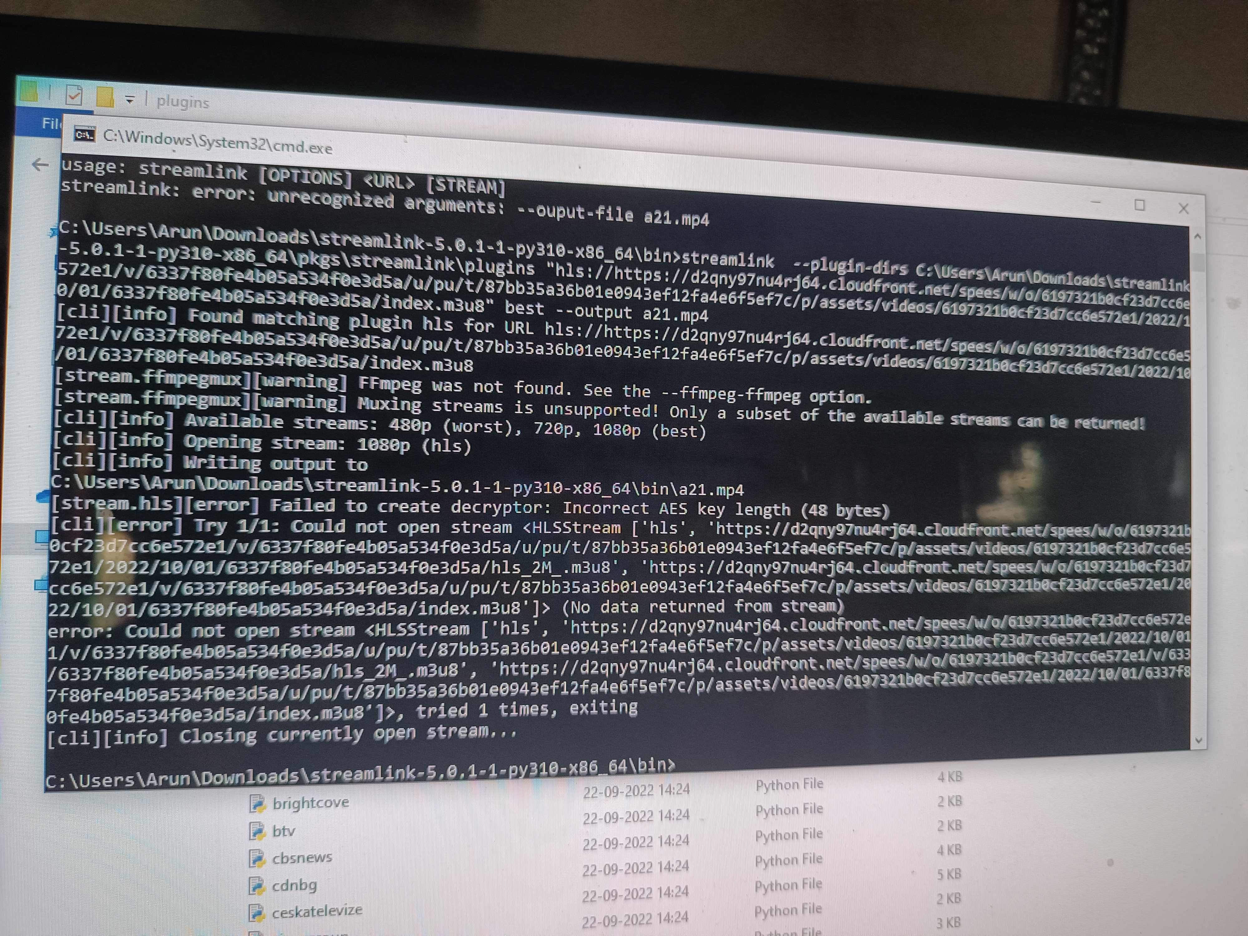

  5. Getting error incorrect aes length 48 bytes
    Failed to create decryptor

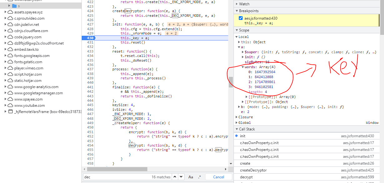

  13. LOL I'm not interested in the video but in the encryption (for future use)
    Because of this interesting topic, I've tried to debug it and successfully found the solution. But of course I won't share since it's not that easy.
    Good luck of finding it too
    Just a hint for the method:

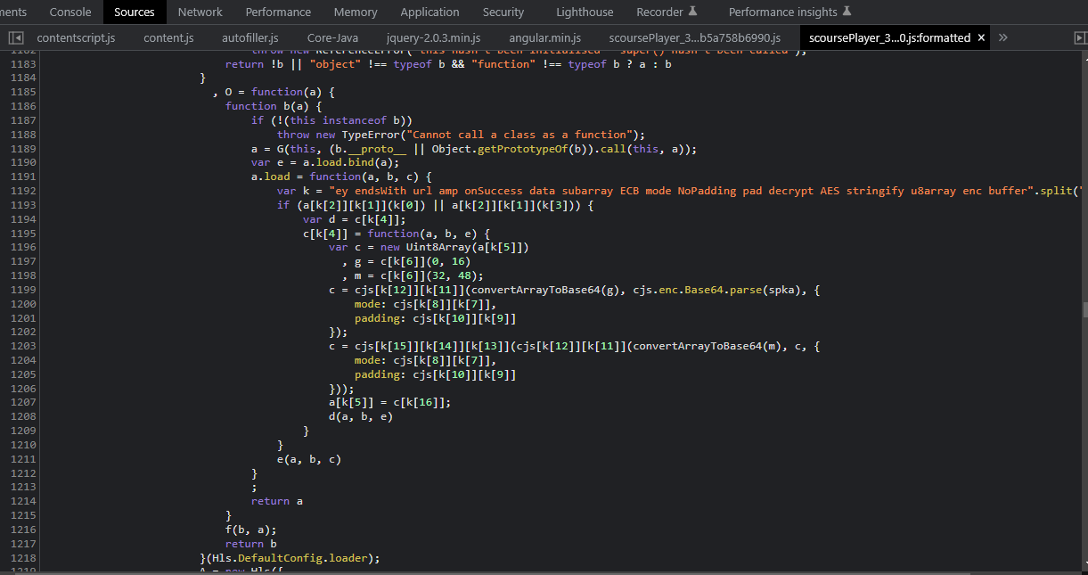

    [Attachment 67156 - Click to enlarge]
  14. Originally Posted by zackmark29 View Post
    I know this function decrypting the key , but this code is obfuscated and i am not a javascript developer, the only solution is to write a javascript or python code to override this decrptor function

  16. i replaced spka although no output was on cmd how can i do this???
  17. It's my first time using streamlink, you can find more commands here:
    https://streamlink.github.io/cli.html
    I created a "plugins" folder and there I placed the python script called futurly.py
    E:\streamlink\bin\streamlink.exe --plugin-dirs E:\streamlink\plugins {URL} best --output file.mp4
    https://mega.nz/file/Jdpx0BQT#z4kUWm6qmsChjd5gGaN9YzY7lhWj4PDR1qPgWuDe1lc
  18. Same error I already specified the directory for this and saved spayee.py into that still error

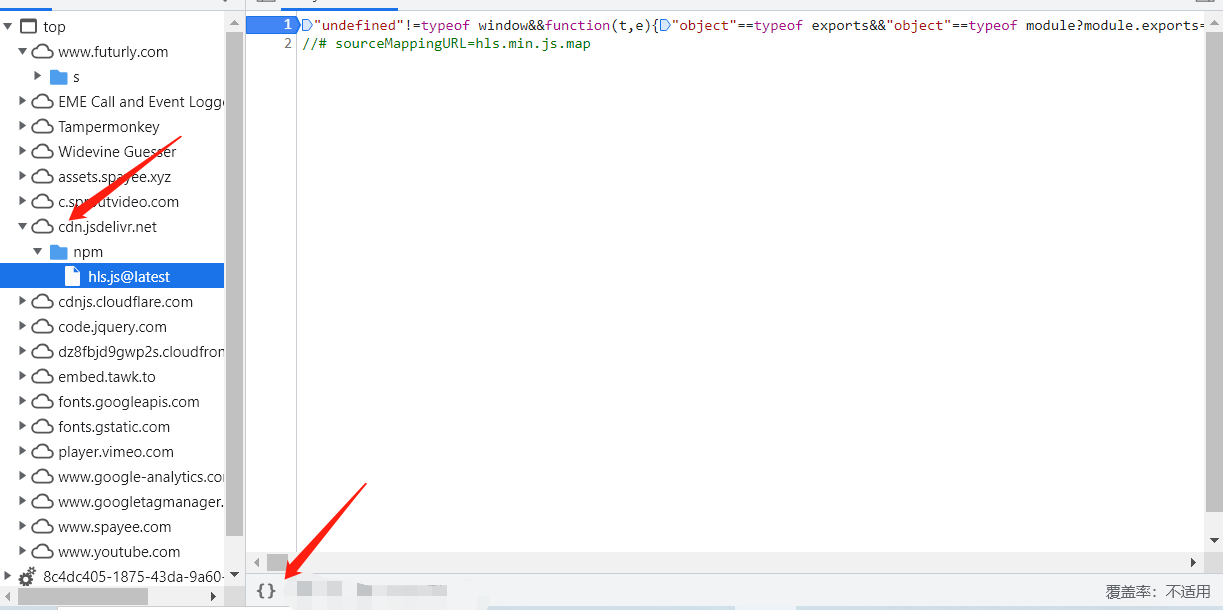

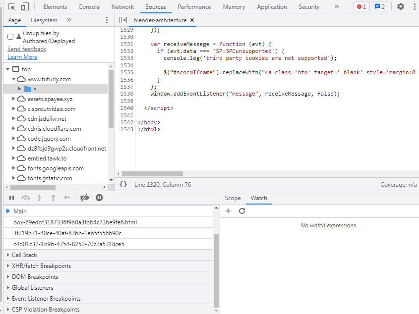

  19. it seem you have found easy way to do. but my source tab it's different by yours.
    i've only 1543 lines (you more than 6000) and i can't find key value ...
    [Attachment 67167 - Click to enlarge]

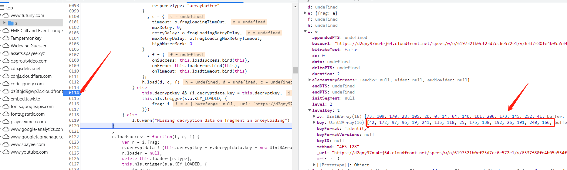

  20. nxhda
    Sep 2022
    look here ,go to js search decryptkey
  21. ok, found
    now have trouble to convert unit8array(16) [42 172 97 .... ] to base64
    i've found many script for console tab, but no understand how to put my unit8array value

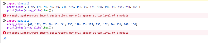

  23. @ naim
    thanks but your code have error
    [Attachment 67170 - Click to enlarge]
    and yes, i know base64 site. but this site convert only base64 to hex. no unit8array(16) to hex or unit8array(16) to base 64 ...
    anyway i've found another working code. thank you so much NBA456017 for your amazing tip
    all work fine now!
    I get the same error as well ."Failed to create decryptor: Incorrect AES key length (48 bytes)"
    What i missing here?!

    Originally Posted by whs912km View Post
    @ naim
    anyway i've found another working code. thanks so much NBA456017 for your amazing tip
    all work fine now!
    Use code as python script man not put it in browser
