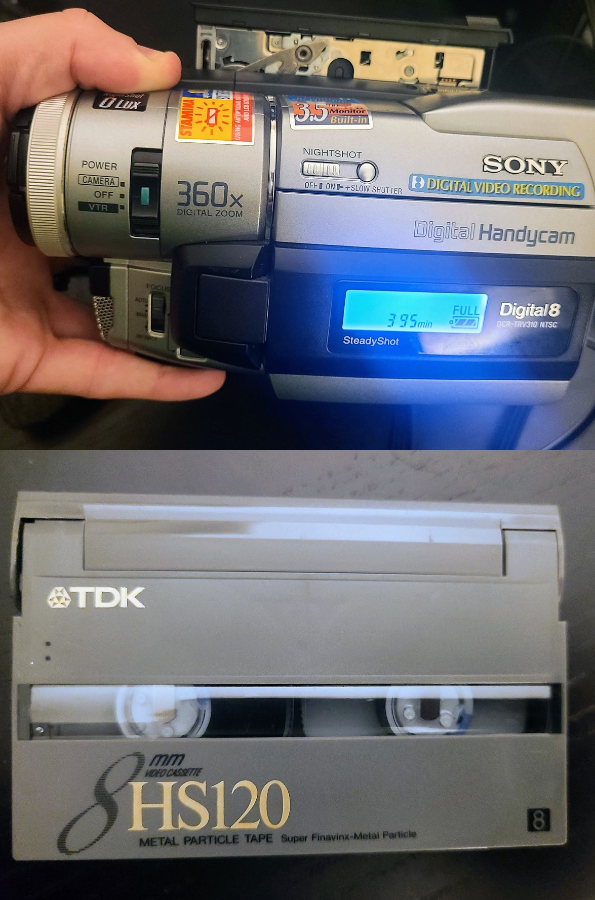

    And I swear it's Video8 tape going through a Digital8 camera. Maybe it looks so good just bc it's a screen shot? I forget what it called the default compression for DV capture (I don't have it hooked up right now but it was whatever it defaults to/the only option), but the default compression setting used for the S-Video in VDub says "No recompression: MJPG" and has "FOURCC code" and "Drive name: uncompressed" next to it.
    Here are both the tape and my camera FYI:
    [Attachment 64661 - Click to enlarge]
