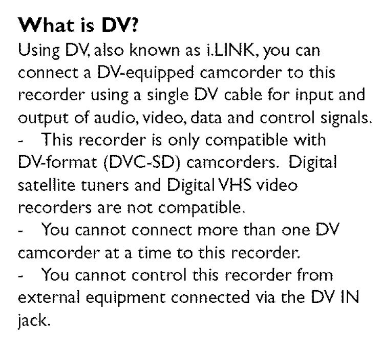

  1. Your DVD recorder does not accept MPEG-2 off DV connector. It only accepts DVC-SD, that is, regular DV, not HDV or MPEG-2 SD or something else. It clearly says, "Digital VHS video recorders are not compatible". Case closed.

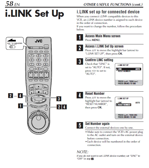

  13. Caius, I think we established that your DVD recorder cannot record off your D-VHS VCR. So, what do you want to do now? Do you want to connect it to a computer to download videos from the VCR to the computer, or upload videos from the computer to the VCR?
    The user manual for your D-VHS VCR only mentions computer in the context of controlling the VCR through JLIP connector. It does not mention the possibility of transferring video to/from a computer. So, even if you find the correct device driver, the most you will be able to do is to control some editing operations. I agree, it would be nice if you could record to/from a computer. I cannot help here, today I tried to connect a JVC DV camcorder to my Windows computer, and failed.
    I could not find a version of the user manual in Portuguese.

    My main question is: Why doesn't the d-vhs connect to the computer anymore! Yes, it connected before, but I still didn't know about CapDVHS.exe yet.
    It stopped connecting when I switched devices and plugged in the cables with the equipment all turned on. I think I chipped the input or output of one of them.

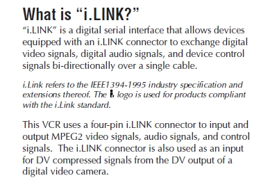

  22. Originally Posted by Caius View Post
    On the d-vhs it says: I-Link out / in and on the DVD recorder it has this I-link. What it means?
    i.Link / Firewire / DV connection / IEEE-1394 is the digital interface used for digital video in the late 1990s - early 2000s. We have established that your DVD recorder would not record from your D-VHS VCR.

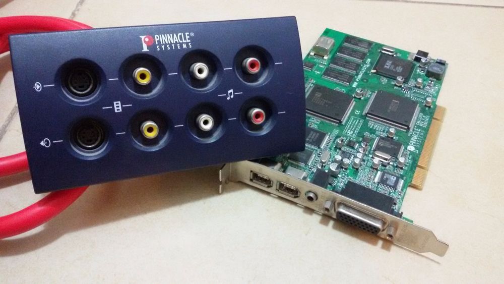

    [Attachment 64362 - Click to enlarge]
    It's here i want to connect the D-Vhs, but the driver installation always goes wrong now. Or it was the firewire inputs of this capture card that failed or the I-link output of the D-Vhs. I have the camcorder, but I'm afraid to connect it to any of them and damage the DV output of this camera too.
  29. Capturing Memories dellsam34's Avatar
    Jan 2016
    Delete all drivers for both the card and D-VHS machine and start over.
