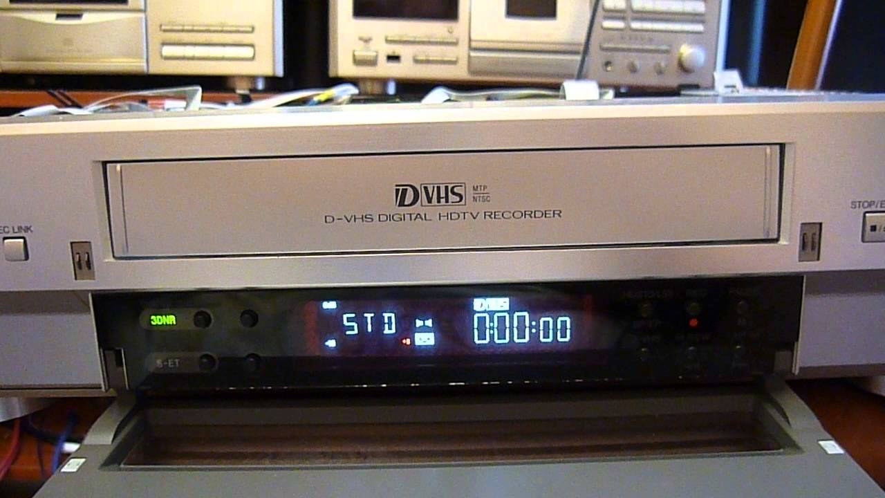

    Here's the thing, i buyed this cables to use on this model of JVC D-vhs. I don't know what i did wrong but at the first time i connected it showed a message on PC saying that drivers were installed successful, but when i unplugged and plugged it again i now only got a message that isnt installed anymore, just part of it. It only shows an exclamation sign on PC.
    Any solution?

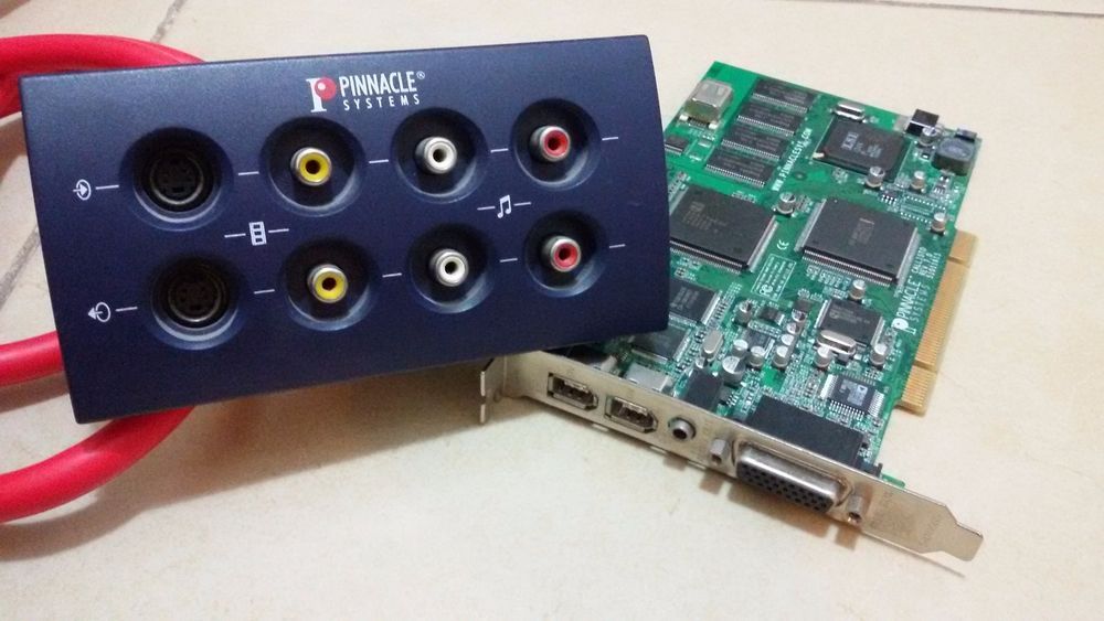

    Im useing a pinnacle 700 pci to capture the DV-Firewire port.
    Maybe I have damaged the firewire / DV entries in JVC while i was plugging and unplugging the cable??

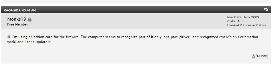

    Yes, it's this same problem of this dude here.
    [Attachment 62373 - Click to enlarge]
    I did buy another same cable, i will test tonight, but i guess it will not work as well. Sad!

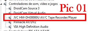

    New cables, and the problem remains. But I noticed that now is showing this (Pic 1)
    But the other part continues with the exclamation thing appearing for this driver (Pic 2)

    Originally Posted by Caius View Post
    Hello dears.
    All i need is this JVC-HM-DH3000U AV/ C Turner to install.
    Where can i get it? I can't find anywhere.
    You don't need the tuner part for capturing tapes, The first one is what you need, Fire up CapDVHS and see what happens.

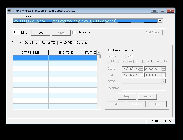

    That's not what I asked, In CapDVHS drop down box, what do you see, Post a picture please. I know what you have in Device manager, I've already seen it.
  23. Banned
    Nov 2021
    You mean this?? Image
    [Attachment 62693 - Click to enlarge]
  24. Capturing Memories dellsam34's Avatar
    Jan 2016
    Now go to setting and select a folder then press Rec. button. Make sure the analog tape is not Macrovision copy protected and the D-VHS tape is not a D-Theater tape.

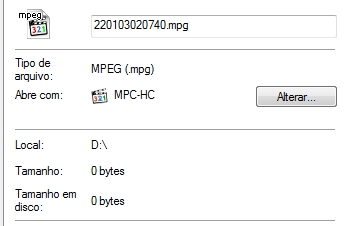

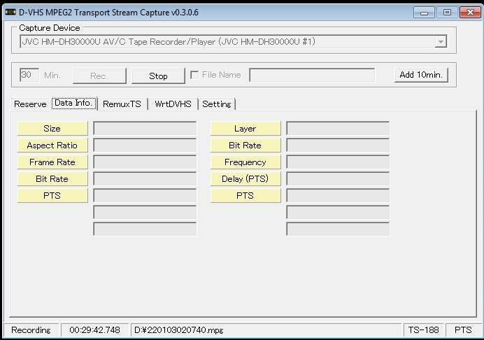

    I Already did this, i only got an archive with zero bytes. I am thinking buying another pci card with firewire or dv entries port, to have sure what i damaged, i pray that is not the d-vhs.

    If you have provided this information before we could have saved several posts, In this case it is the D-VHS, The card is detecting the device and the software is attempting to collect data, It is your deck that is not providing that data, This could be due to several reasons, Your deck does not support analog tape streaming over firewire, The tape you are playing is copy protected or corrupted to the point the VCR thinks it's copy protected, Your VCR is defective and does not provide an analog video signal to the ADC chip (this can be tested using a TV from an analog output), The ADC chip is defective, I can go on but those are the most obvious ones. and frankly you are not providing enough informations to help yourself, it seems like I'm beating a dead horse, I let other members chime in, I tried my best.
