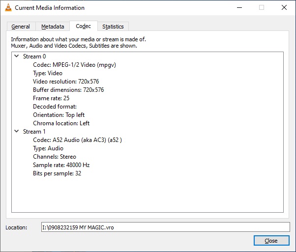

    I can access the file on the hard disk and confirm is in mpeg2 format.
    [Attachment 64200 - Click to enlarge]
    Is this good enough?

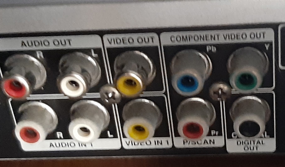

    Pass thru = Handycam -> DVD recoder -> USB composite capture.
    The DVD recorder has Ypbpr output.
    [Attachment 64201 - Click to enlarge]

    Jan 2016
    YPbPr capture is okay as long as the DVD recorder has the ability to take the S-Video input and converts it to component, Most have component for the DVD playback only. As said certain DVD recorders only have image stabilization.
