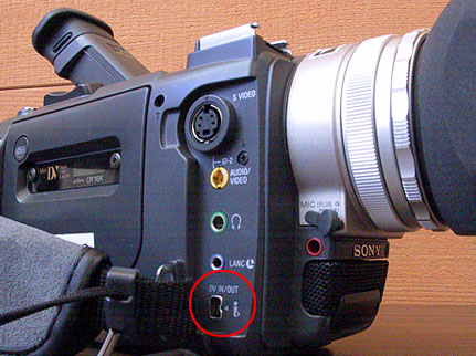

  1. Trying to covert miniDV tapes from an older camera (Sony TRV900 - photo below) over to my 2017 iMac.
    I've been out of the game for a while, and unfortunately misplaced all the chords I used to edit/upload with years ago.
    I'm not seeing any clear & obvious solutions online that don't involve purchasing anywhere from 2-5 chords/adapters,
    so I wanted to see if anybody on this forum had ideas to help me streamline the process and save some $$.

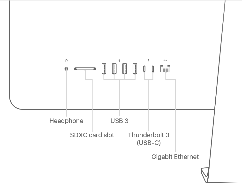

    So, I'm starting with the 4-pin firewire port on the actual camera and need to get to the Thunderbolt 3 port on my iMac.
    [Attachment 52572 - Click to enlarge]
    Do the newer USB-3 ports carry video?? If it's not HD, would/could those ports be useful?
    [Attachment 52573 - Click to enlarge]
    Any help, ideas, assistance on helping me figure out this ENTIRE puzzle would be huge.
    I APPRECIATE AND RESPECT YOUR TIME>>>
    Shamus
