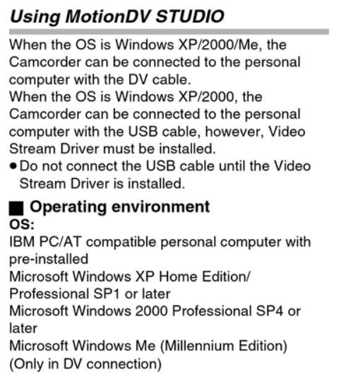

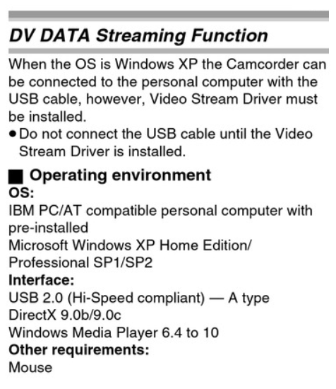

    I have both Panasonic PV-GS500 and NV-GS500 and can confirm that they transfer DV video over USB2+. Works for me in Windows 7 64-bit. No special drivers. Worked in Vegas capture module, then audio became disabled somehow. But Windows Photo Gallery works fine.
    To everyone who thinks that USB transfer is low quality - it is not. Panasonic listed USB transfer as the primary method, and Firewire as the optional one. USB method was not available on Mac, though.

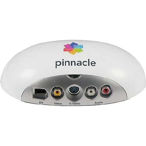

    One such device is the Pinnacle Moviebox.
    [Attachment 64224 - Click to enlarge]
  12. Formerly 'vaporeon800' Brad's Avatar
    Apr 2001
    Vancouver, Canada
    Originally Posted by pchan View Post
    mini DV tape only run at one speed and it need firewire to handle its throughput in DV format.
    Otherwise, it needs to encode into another format in order to reduce its throughput either by the camcorder or some other device in order for the USB to handle.
    The Pinnacle Moviebox does not re-encode the incoming DV stream. Anything that did would break compatibility with DV capture software.

    There are quite few besides the Moviebox, the 500-USB, the flat square model, and probably more, As I said I managed to get mine working on Win10 using the old Win7 driver, But since they are driver dependent I suppose the camcorders with USB out will need some drivers from the camcorder manufacturer otherwise Windows will not see the camcorder.

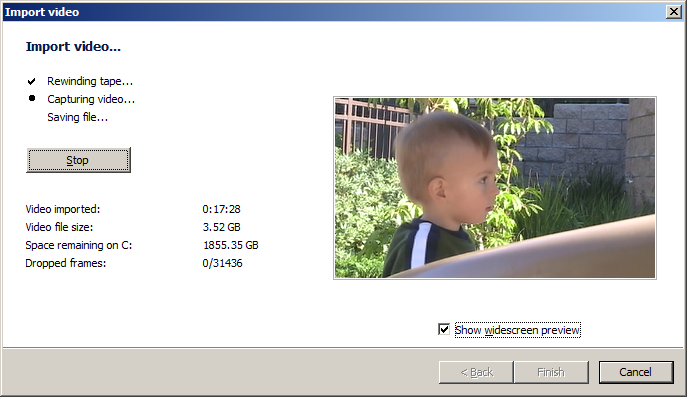

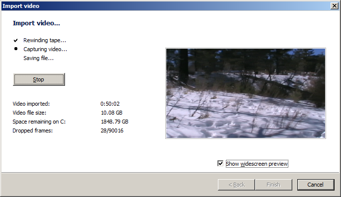

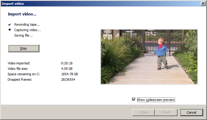

  15. The battery died at minute 53, it was still 28 dropped frames. Captured from the Panasonic PV-GS500.

  16. Capturing Memories dellsam34's Avatar
    Jan 2016
    Have you tried the same tape for 53 minutes over iLink to see how many frames will be dropped?
  17. Member DB83's Avatar
    Jul 2007
    Well that sample kinda confirms what I previously wrote - that we now have DVCPro and not vanilla DV.Maybe it does not matter and I simply over-react. Maybe this is a result of a trim and the program that did the export applied that codec. Which is why the request was for a straight-from-camera sample and not, potentially, a resampling.

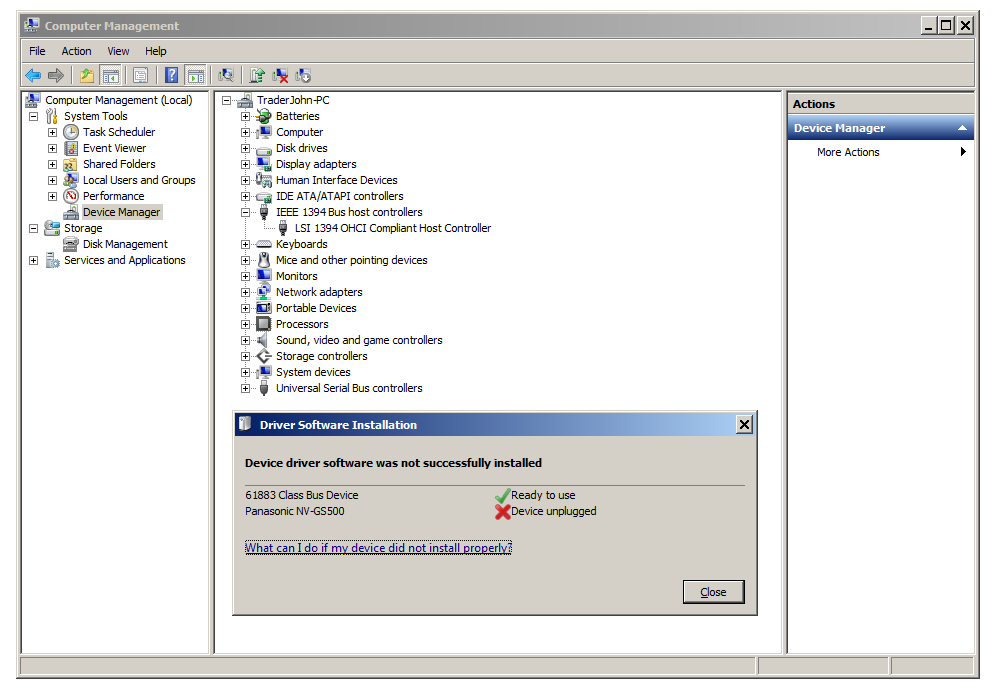

  22. @DB83, no dice. This is exactly why I bought a Panasonic DV camcorder - to send video over USB and not to fiddle with Firewire. I tried rolling up Windows updates, and it completely destroyed my install, the machine would blow up into BSD and restart every freaking time it would get to the login screen. I had to roll the update back.
    I tried using legacy 1394 driver, did not help.
    My Canon DV camcorder is recognized both by WinDV and by Scenalyzer. I had to install Canon's driver. When I turn it on, it shows as a separate audio/video device in the device manager.
    So, maybe some other time.

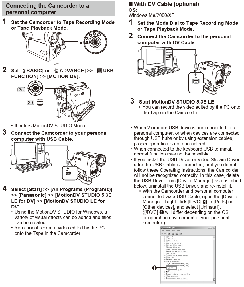

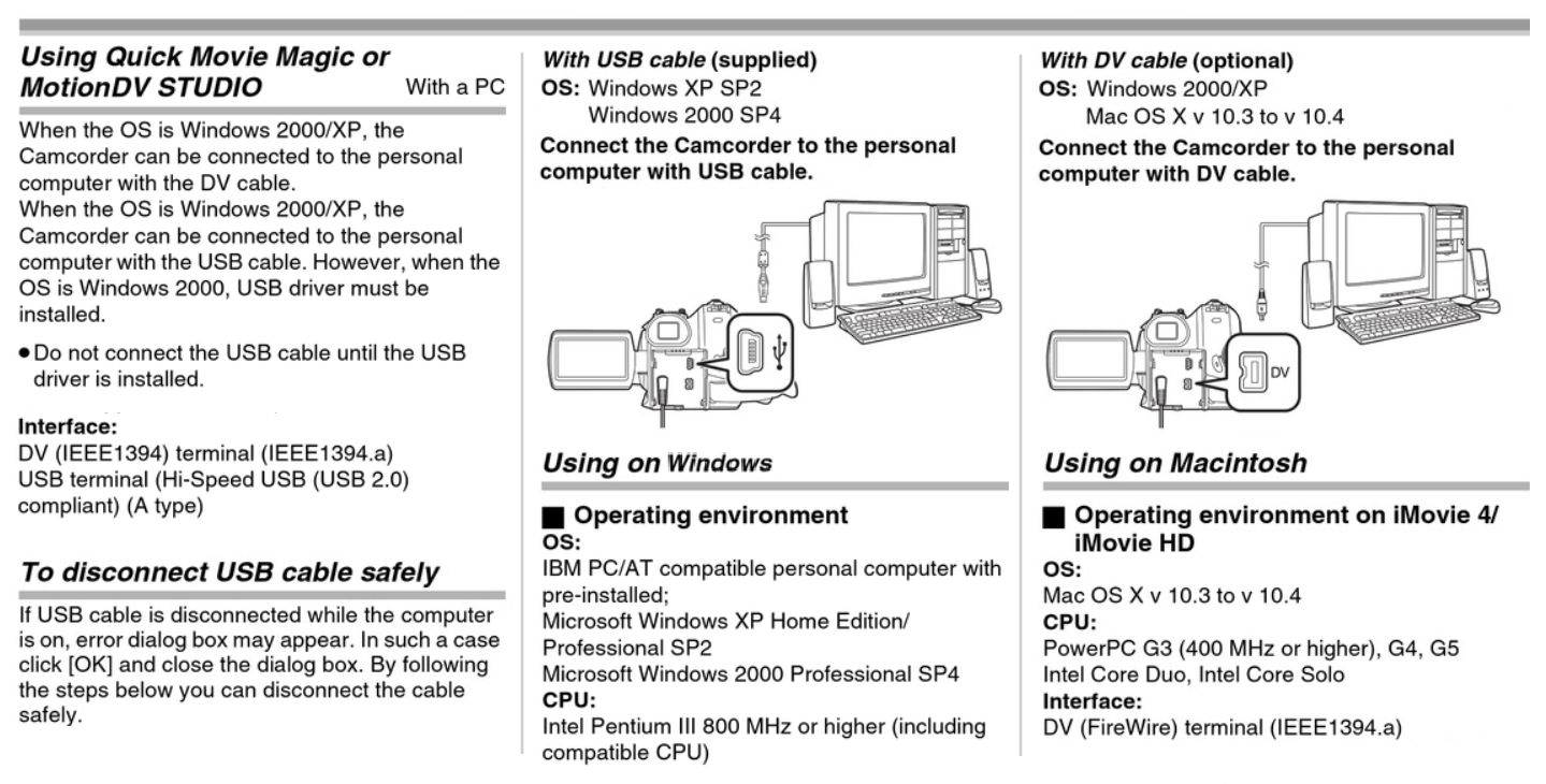

    The camcorder can be connected to a computer for editing or viewing using the DV port or the USB port.
    Last edited by ConsumerDV; 13th Apr 2022 at 00:00. Reason: PV-GS250, not NV-GS230.

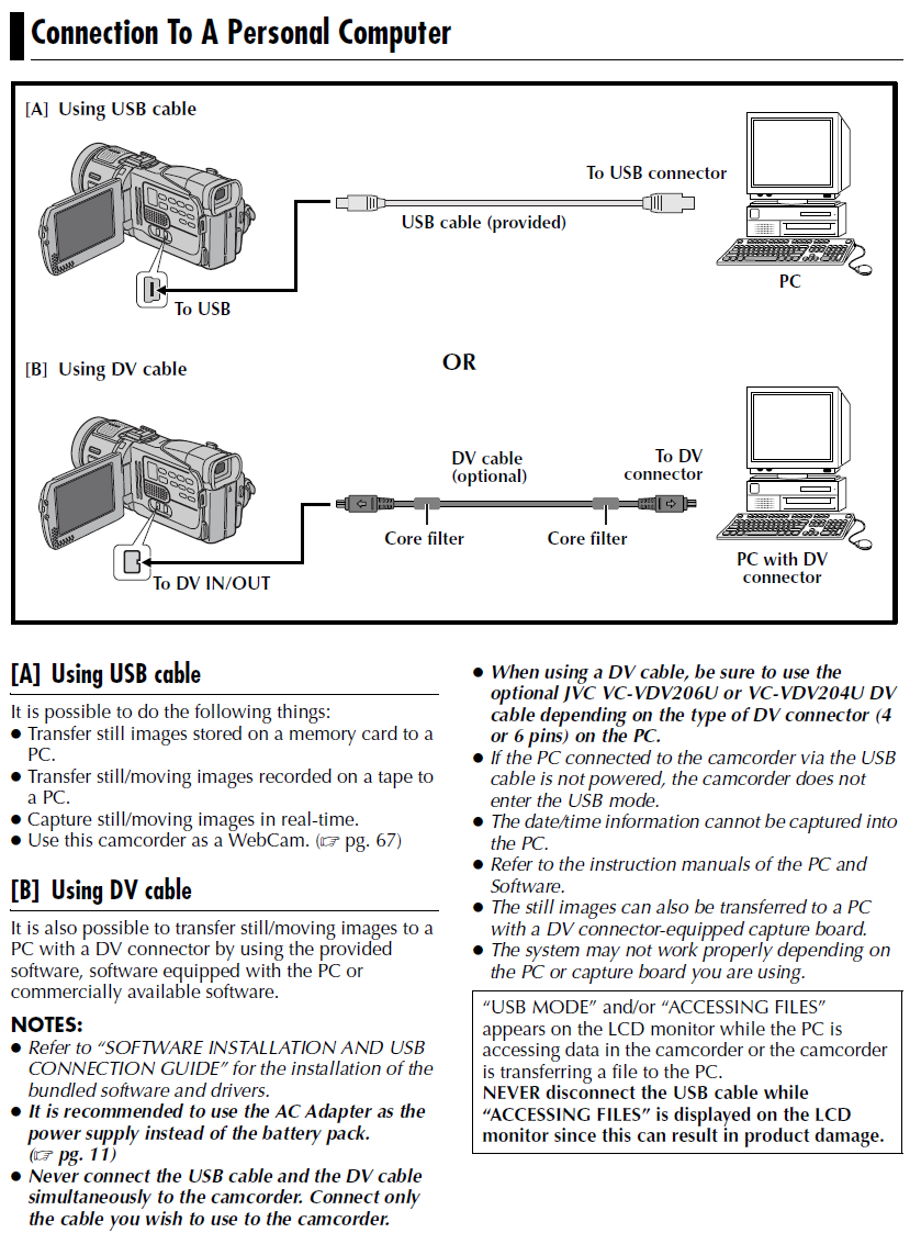

  28. From the JVC GR-DV500, GR-DV800, GR-DV900 operating manual (attached). I with there was a spoiler feature on the forum. Panasonic's manuals are atrocious! I had to re-edit a couple of them. JVC's manuals in comparison are very concise.
