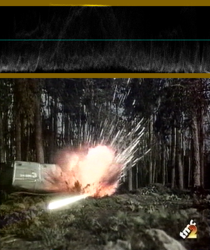

    Could you upload a short sample of the video captured with the Hauppauge? I'd like to see its Histogram. Or you can do it yourself and post the result:
    TurnRight.Histogram.TurnLeft
    or
    ConvertToYV12(interlaced=true).Histogram("levels")
    Its range for capture is 16-254 (same as ATI 600 USB) http://www.digitalfaq.com/forum/video-capture/9865-canopus-advc-110-a.html#post62640
    At capture the procamp should be tuned to stay inside correct range.
    If the Histogram is correct you can use AviSynth filters (ColorYUV, Tweak, ...)

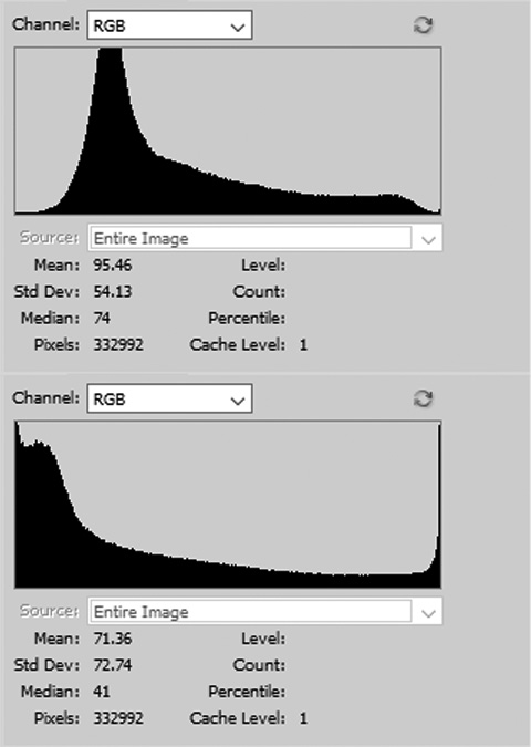

  3. Here are the two histograms, for the images that I posted (top Dazzle; bottom Hauppauge):

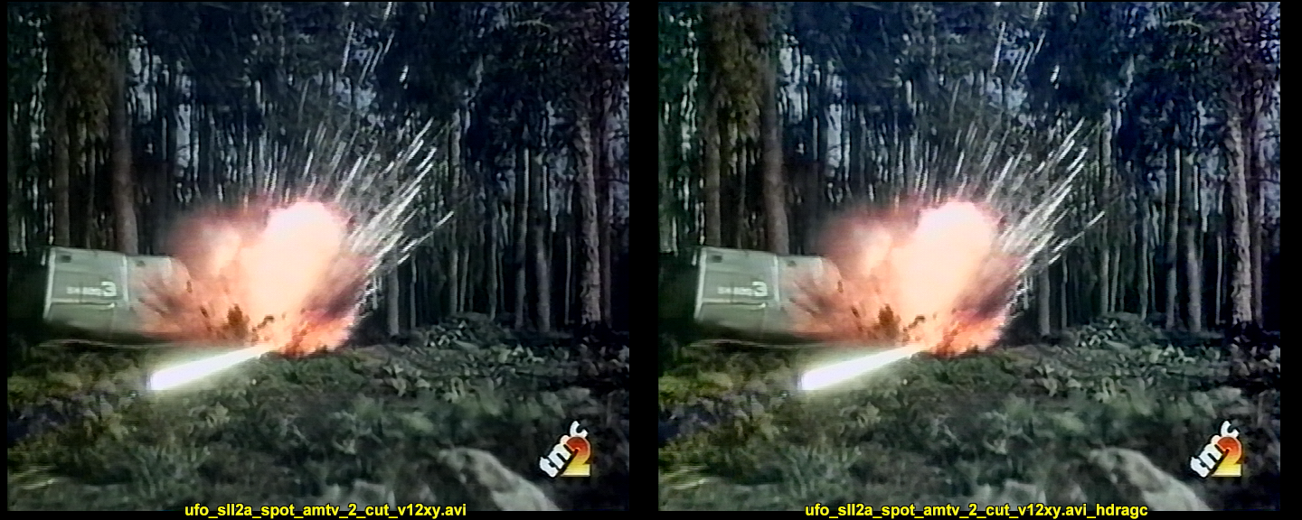

    I do not think that the images are representative when extracting the histogram.
    Here one of my capture (raw, untouched, except removal of black borders and heads switching noise to do not alter the histograms) similar to yours. (in my case is very similar to the dvb-s stream; it is also possible that the dvb-s original stream does not have many details in the darks)
    [Attachment 58023 - Click to enlarge]

  5. I would suggest investing in a ES10 or similar first, and starting from there. Very few capture cards really handle video straight from a vcr particularly well.
    For the hauppauge, you will need to adjust the video levels when capturing, how to do it depends on what application you are using.
    What do you mean by the dazzle being usb1 only? Does it only output compressed video? The image you show from it looks like it has been deinterlaced, while the hauppauge one is not. The "combing" is expected on interlaced material, what you are seeing is really 2 half-frames weaved together.

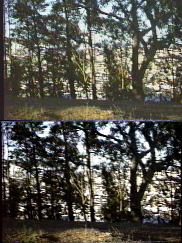

  6. Oh, there is plenty of detail in the dark areas (note the top image). Both captures are of the same frame of video---just using different capture devices. I understand that i could use the software proc-amp to adjust this. But, I have to wonder about the results, when the setting is that far-off.
    I was referring to my captures. In yours, if the blacks are not crushed, the details can be restored.
    However, the levell adjustement is mandatory for every card if the default is not good for your particolar tape. Often also for different sequences inside same tape.

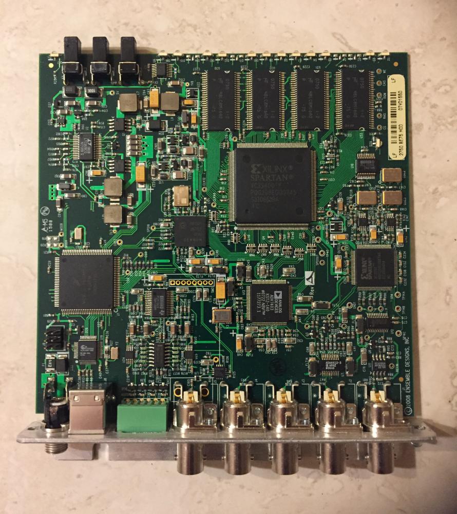

  9. Capturing Memories dellsam34's Avatar
    Jan 2016
    I found "Ensemble Designs" devices' design is very interesting, Caps used are of a different kind:
  10. Thank you for the replies, so far. I am intrigued by the Ensemble Designs "BrightEye" units. Has anyone worked with one of these? I gather, from the claimed specs, that some of these units incorporate both A/D conversion and frame TBC (e.g. BrightEye 3). Any good? The prices are definitely more reasonable. However, these would require capturing SDI video. I would be interested in hearing about the workflow.

  12. Capturing Memories dellsam34's Avatar
    Jan 2016
    These SDI devices and workflows are really hard to find that's why I never really recommend them at least to the average Joe who seeks a $5 capture device from China. The reason being is they were not mass produced like consumer devices, and when production houses and studios who used them moved to 100% digital most ended up in the recycling facilities, The few that survived the dump are being used and passed on to others with high price tags.
    Ensemble Designs is one of the few companies that perfected a device for a noisy consumer format like VHS and they are the very few who put a TBC in their devices, I had a conversation with the ED lead design engineer and asked him about how the TBC is implemented in the BE family and he was very informative.
    Some senior members here don't like such workflow and prefer the consumer workflow whom comfortable with, For me I tried many workflows and this is the closest to the best VHS-decode capture done so far, and the main benefit is that after the TBC is applied the signal stays in digital and never converted back to analog like in some other workflows that use a stand alone frame TBC. Off course the TBC can be turned off just like physically removing an external TBC from the workflow.
    If you are up for the hunt and have some money for it (which is what you will pay for an external TBC anyway) then go for it, Be aware of the technical names though even the manufacturers' ones are misleading, The main analog to digital capture device is called converter, The SDI to PCI or SDI to USB interface is called the capture device (even-though it's a straight 1:1 AVI transfer from SDI to HDD), So use the manufacturer terminology when searching for them, Not all of them are built in TBC, So the datavideo linked above is just a camera converter, not for consumer sources.

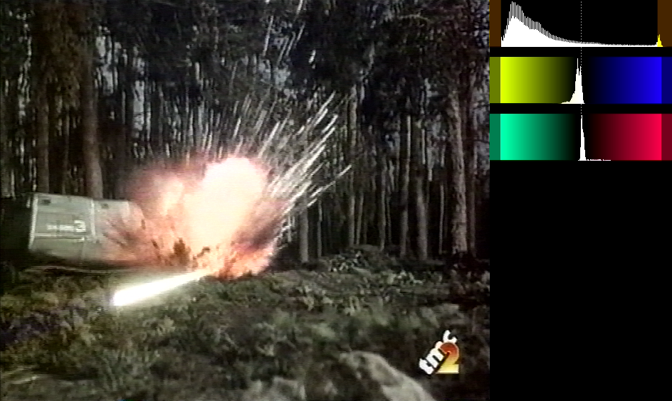

    Just a quick addition to the original problem.
    If by any reason you are uncomfortable with extensive procamp level adjustements you can give a try to hdragc() plugin. In this example I used default parameters except corrector=0.5.
    In any case, to recover the details the blacks must not be crushed.
