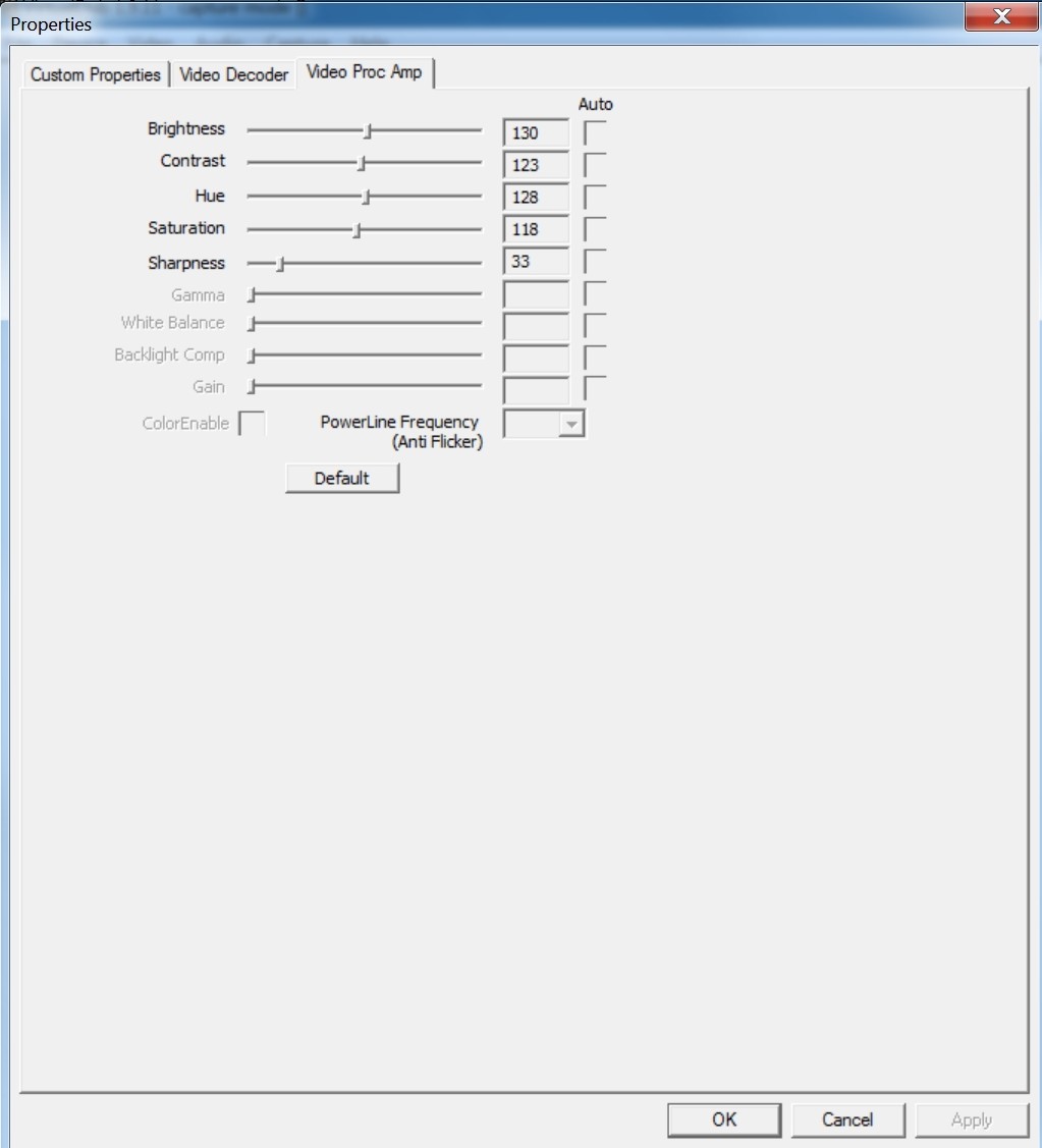

    I forgot to mention in the USB3HDCAP thread that you need to make sure the proc amp is set to default when capturing HDMI. The levels in your captures are only within 17-233. And you're sure it's set to output YCbCr?
    There's a lot to digest here. My only other comment at the moment is that of the VHS captures, only the DV appears to be free of luma noise filtering (chroma is still frame-averaged, as seen at the scene change).
    Mar 2015
    Europe
    Well no , I have used the sames values used for analog captures as the histogram was ok I have not changed them. I made a capture with the default values in the video proc. amp. and the captures now are within 16-240 and it seems better.I´m including the capoture equivalent to workflow 1 but with the default values on the startech pro.amp..Should I shrink the output color range to 16-235?
    related to the output beeing YCbCr I have no control on the DVD recorder but the startech identifies the stream as BT601 signal colorimetry and as I think BT601 is indeed YCbCr , yes I think so.
Name:	video proc. amp..jpg

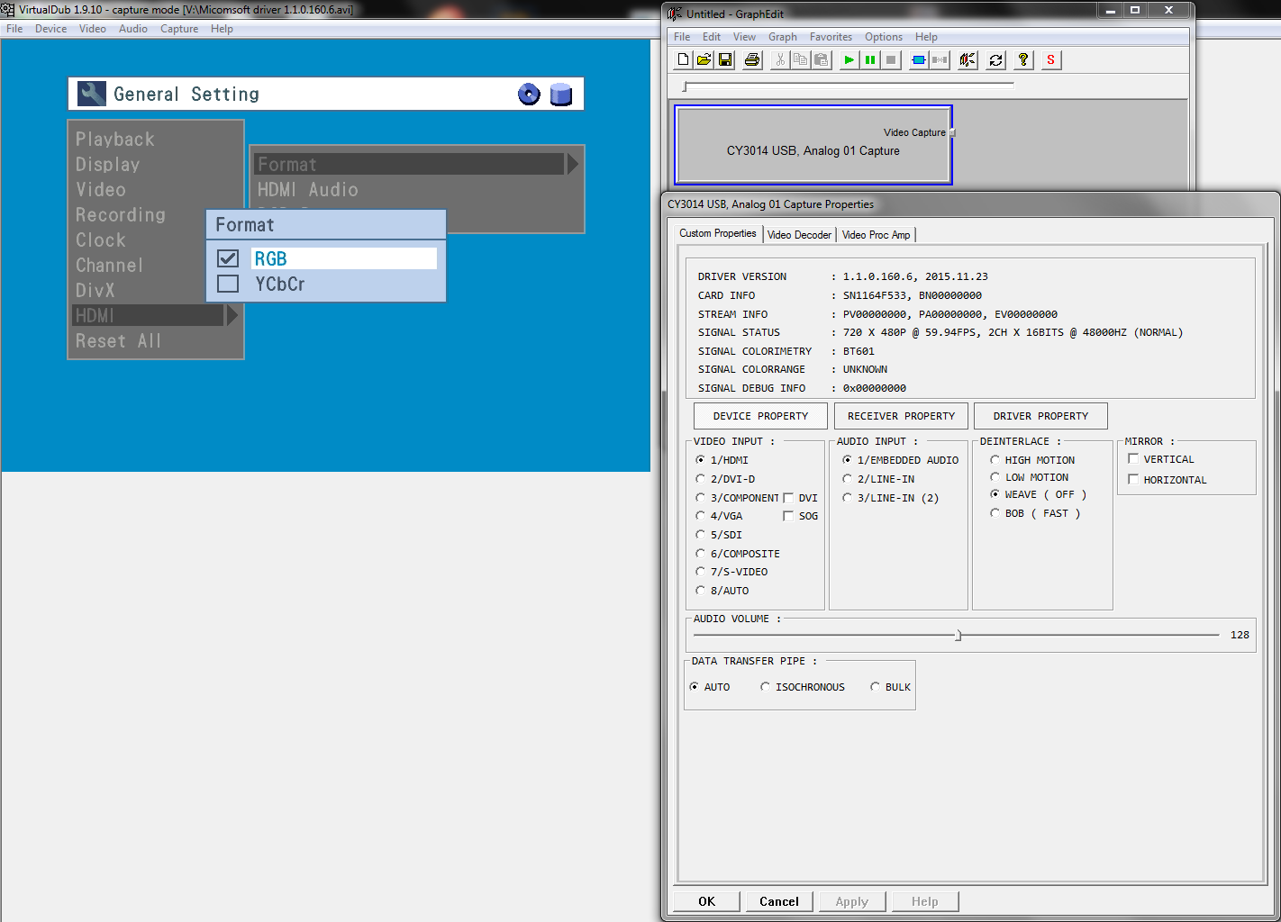

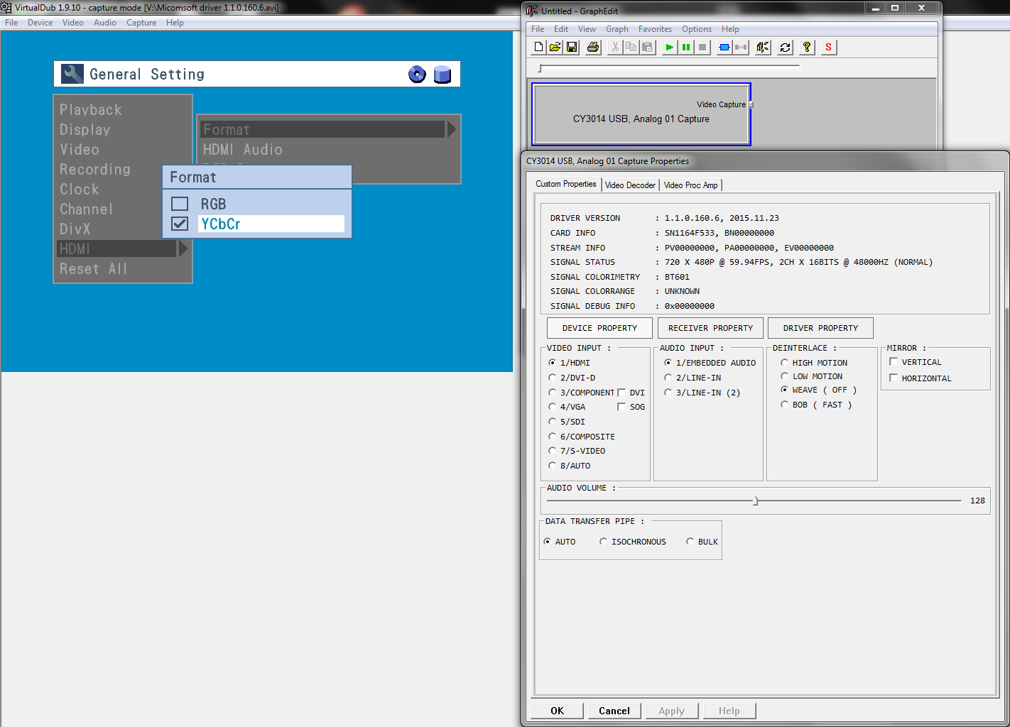

    Not for posting "raw" samples from HDMI.
    Sadly, that doesn't seem to be an indicator of anything.
Name:	Micomsoft 1.1.0.160.6, 480p HDMI, YCbCr.PNG
ID:	35698 Click image for larger version
Name:	Micomsoft 1.1.0.160.6, 480p HDMI, RGB.PNG

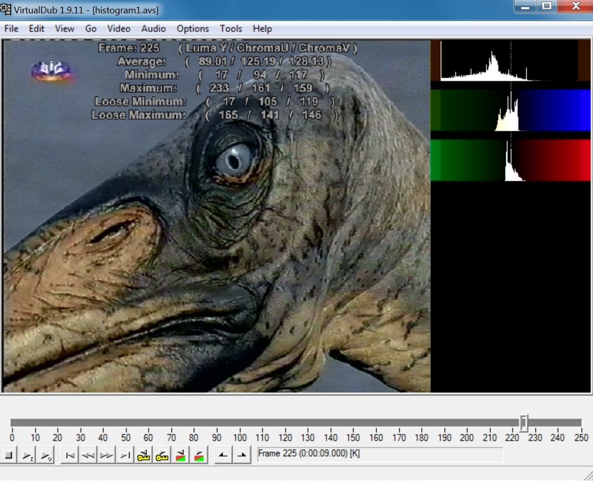

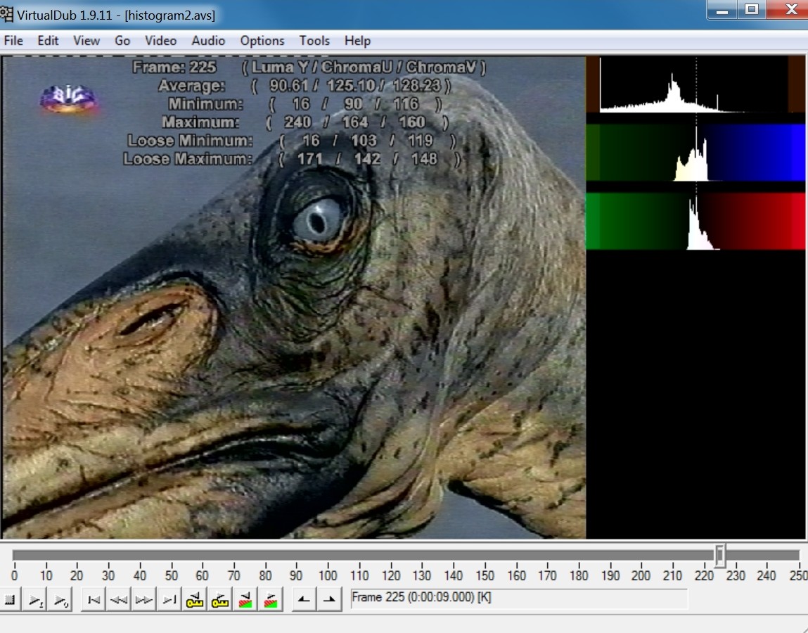

    Well I already had the idea that the tbc ( or at least this tbc) degrades somewhat the caps, however is the only way to avoid drop frames and the alike and for analog video is almost mandatory. The only other possibility is to use the dvd recorder in pass-through. However between a svideo-svideo pass-through only using filtering and tbc alike features vs also using the DVD recorder ADC it seems the last one gives better results. Also the startech seems to works better for digital hdmi inputs then for analog inputs.
    All the first 7 caps have been made with Proc. Amp. settings different from default. With the startech over hdmi this is not a problem however with the ATI 600 usb I think that using default values I will get clipping and over saturation but I can try.
    I have no noise reductions on the DVD recorder that I can access, only on the svhs deck .workflow 2 try to feed a raw stream into the dvd recorder ( all filtering an NR on the svhs deck off).
    First capture 1 and the new capture 1 in the subsequent post show the difference between using different values and default values in the startech video proc. Amp.
    Vaporeon800
    Well I see the startech driver reports identical info with different video streams (YCbCr/RGB). However probably the hdmi stream is YCbCr as I have the dvd recorder set to record in MPEG-2 and MPGE-2 use YCbCr color space.

Name:	workflow1_proc amp other values.jpg
Name:	workflow1_proc amp. default.jpg
    That's unrelated though: all(?) DVD recorders with HDMI output can transmit either YCbCr or RGB depending on the device they're connected to, and no DVD recorders can create RGB recordings.
    Mar 2015
    Europe
    I don´t know if this can assure the hdmi stream is YCbCr or not but according to your post "The OUTPUT COLOR RANGE options are actually active with YCbCr input"
    I tried to see if it´s active and the range changed when I select it from 16-240 to 30- 222.If this is also no proof, how is it possible to identify if it´s YCbCr or RGB?
    Well but what I was really interested to known was if any of you having to your disposal this devices and workflows would choose as the best one and why or would you do any additional variant based on this devices

    That post meant that it's active with YCbCr in addition to RGB (the option is normally used for RGB). I haven't thought of a way to identify whether the source is RGB, yet. My other capture devices dither RGB input when converting to 4:2:2, which makes it obvious, but the StarTech doesn't do that.

    Only for comparison purposes I am including a sample with the following JVC settings
    B.E.S.T. on , Pic. Control – edit , Digital3R-off, video stabilizer off , DigitalTBC/NR on
    WF1 – JVC->svideo->LG-> hdmi576i->Startech->Vdub-> Huufyuv
    WF2 – JVC-> svideo->LG->svideo->ATI600->Vdub->Huffyuv
    I can ajust the Ati video proc. amp to avoid clipping in the histogram within virtualdub but even so, captures afterwards have luma from 20 to 245!....

    My new (used) Panasonic DVD HDD recorder DMR-EH65 just arrived.
    I made a initial capture using the next workflow
    JVC HR-DVS3 (VHS)-> svideo->Pana DMR EH-65-> svideo->ATI 600usb->VDub->Huufyuv
    It does have in picture settings a NR filter ( comb filter) the captures have been made with this comb filter off.
    Is complicated to work with the ATI Proc. Amp to get luma in the captures between 16-235, it always tends to go near the maximum 255 hdmi are much easier to control
    However I am unable to record through HDMI , I think some sort of HDCP problem . It cycles between no signal , HDCP, and attempts to handshake at different hdmi resolutions , but no effective output . It seems as there are some sort of HDCP problem in between the Panasonic and the startech usb3HDcap. I read elsewhere that it´s possible to overcome this problem inserting a HDMI splitter in between at least with a black magic 4k . I already ordered one, as soon as it arrives I will confirm that this problem can be solved.
    I have used the scart av1 as source for the svideo signal as I have found in a German forum indication for preferential using this output in this dvd recorder and not the individual svideo, composite or component, they refer some sort of instability of video signals in these plugs. However the quality of my cables Scart->Svideo are good but not top quality ( profigold premium 1,5 m) and my svideo->svideo are top quality (QED QUnex 1m) .However the contact resistance in the scart plug must also be better ( smaller) as there is a large surface contact then in the svideo plug. In this case the better will be a top quality short scart- scart cable that is suggested in this site .I have an IXUS scart-scart 21 pins professional 0,6 m I will use it next time. However probably the eventually benefits are so small if any that are impossible to identify and the results will be exactly the same and all this discussion is only theoretical.
    http://forum.gleitz.info/showthread.php?46713-Zeitgem%E4%DFes-hochwertiges-analoges-Ca...er-HDMI/page55
    As soon as I have at my disposal the osprey 210e card I will do similar capture to see if the results are better them the ones from the ATI600 usb and as soon as the hdmi splitter arrives I will do also similar captures using HDMI if the HDCP problem is solved.
    I am still thinking about buying the matrox MX02 Le but the fact that it seems only to accept HD Hdmi and accept sd analog but records it in HD (720p and up) if my interpretation of the specs are correct are forcing me to read more about it and get additional info to see the real interest of this capture device as it´s in the price limit i will wiling to pay.

    I have some difficulties when it comes to evaluate a sample or a capture . Obviously as anybody else I can detect qualitative differences if they are evident , but when the samples are very similar in quality I have tremendous difficulties to identify what is the best capture and consequently identify the best workflow, settings whatever.
    Are there any practical rules to identify defaults , problems and quality in general qualitatively speaking in whatvideo footage is concerned, Are there utilities , filters , plug-in that can quantify quality in any way through variables that are quality related , resolution , jitter , noise , etc that allow us to confirm that a qualitative feeling is really supported by quantitative measurements ?

    I hope you're aware that only a small subset of HDMI splitters will strip HDCP. Most happily pass it along end-to-end, as they are supposed to.
    I take it this latest capture is with the JVC's TBC on, since the head switch area is uncorrected.
    Perhaps someone else can suggest worthwhile measurements for you.
