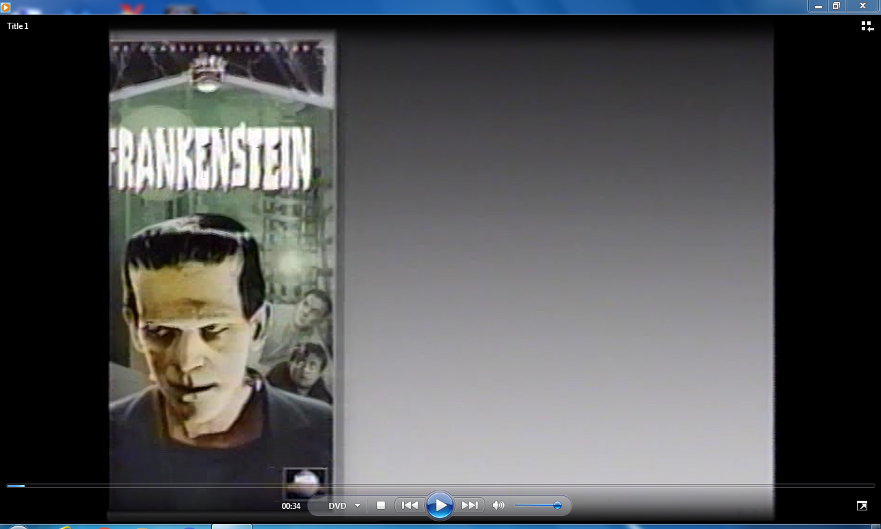

    This first grab comes from a DVD he burnt.
    Here’s from a video I had captured using EyeTV Hybrid (this was the same exact tape my friend captured).

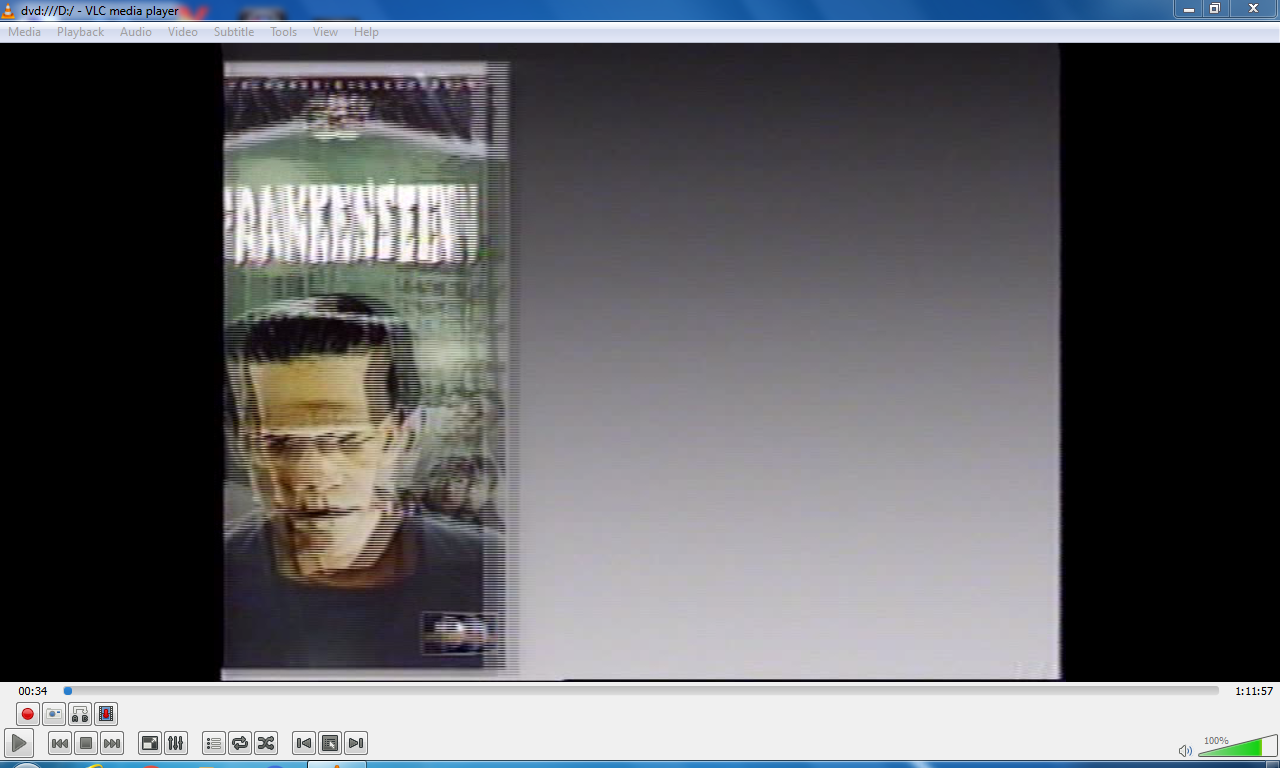

    As you can see very fuzzy and grainy. The sound is fine, the video not so much. Why is this? The actual quality that the videos my friend captured, aside from being a bit pixilated, I was very pleased with and have been trying eagerly to replicate but have not. I even tried a few other EyeTVs (Hybrids, 250, HD) and even tried Elgato Video Capture and all gave me varying results but not exactly to the look and quality my friend had. One other EyeTV I tried was this one. This was a 2009 tuner I believe.
    Here’s a grab from a DVD I burned using a video recorded with that tuner.
    This is basically the same look the 2008 Dazzle (DVC100) I’ve been using lately has been giving me when I try to do my Universal Monster tapes. It has this very washed out and bright look which for me doesn’t look very good. However, quality wise the '09 EyeTV Hybrid is much poorer compared to both DVC100 and the EyeTV my friend captured with. I captured my '92 SW Trilogy recently with DVC100 and they aren’t that low in quality nor have the washed out look. Not perfect perhaps but definitely better than the '09 EyeTV. Also the image above does not have the same geometry as my friends capture (note that his has more image on the sides). Just to back up a bit the first video capturing software I had tested was Honestech VHS to DVD 3.0. The main bugger about this was the ‘overlap’ the exported video gave me (why I had started this thread on FanRes https://forum.fanres.com/thread-724.html) and the Universal tapes had the bright washed out look. Elgato Video Capture, which I tried at one point but ultimately sold, gave me the same effect. My DVD (Honestech capture).

    The real fix for this is TBC as jagabo mentioned, but you'd need to add a device to remove the copy protection if you'd like to use DVD recorder passthrough.

    ON TOPIC: The first photo in the OP, intended to demonstrate what your friend's EyeTV looks like. Where'd you get that image from? That should give a clue as to which specific sub-model "silent revision" he had, right?

    To answer your ON TOPIC question, it was a screen grab from a DVD he had burned. The best I can elaborate on that was he used the same EyeTV Hybrid model in the first image I shared and the same model VCR in the other pic I shared. This is why this has been very frustrating for me because I have the same EyeTV model and same model VCR and don't get his results.
    To my knowledge he did not use a device with TBC to keep everything straight. I had many conversations about my repeated capture attempts and he never mentioned TBC or anything else to me. For the most part he was just as puzzled as I am.

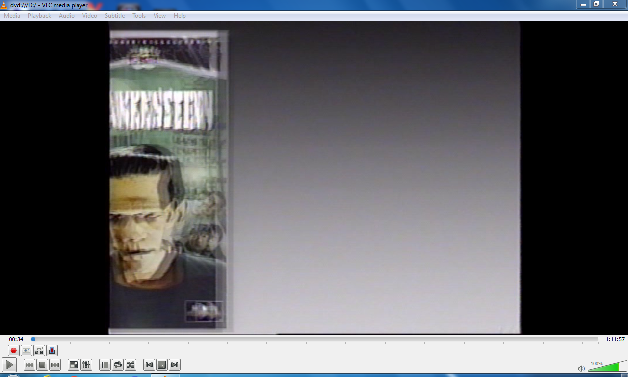

    To bring this up a bit I did try 950q recently and here's what I got. Here's a capture from the same VCR in the pic above.
    Same tape only this time on the General Electric VCR in my bedroom.
    Pretty interesting huh? Someone on another site suggested cleaning the heads so I have doubts that's the problem. I had been capturing lately on the same VCRs with Dazzle and didn't get that look and I do run a head cleaner in the machines pretty regularly at least when I'm about to use them.

  14. Your main problem is the lack of a line TBC. What you describe as "very fuzzy and grainy" below the second image in your first post is neither fuzzy (blurry) nor grainy (random static type noise). The problem is the waviness form the lack of a line TBC. Scan lines shift left and right, and vary in length, because the VHS head deck can't maintain a constant speed. A line TBC fixes that be aligning the sync pulses and stretching or squishing each line to the correct line length.

    In isolation I would say those two screenshots indicate that your Panasonic has less stable timebase than the General Electric. But earlier you said:
    I don’t think its a VCR problem either. I’ve tried the same EyeTV tuner on a 1999 General Electric VCR, a 2003 Panasonic VCR (same model as my friends VCR), and a 2004 Sony VCR. All have the fuzzy effect.
    So that's gotten me confused.
    Cleaning the heads is very unlikely to make a difference, though if you do it properly it can't hurt. Playing an abrasive head cleaner tape is not a good way.

    Here's my friends DVD on VLC player with Deinterlacing off.
    [Attachment 41384 - Click to enlarge]
    Same DVD, same player, deinterlacing on.
    [Attachment 41385 - Click to enlarge]
    Same deal but on Windows Media Player.
    [Attachment 41386 - Click to enlarge]

    No, I misunderstood. You should set VLC to Yadif 2x instead of Blend mode. It's in the Preferences. (You can also set it through the right-click menu, but it won't save the setting that way.)
