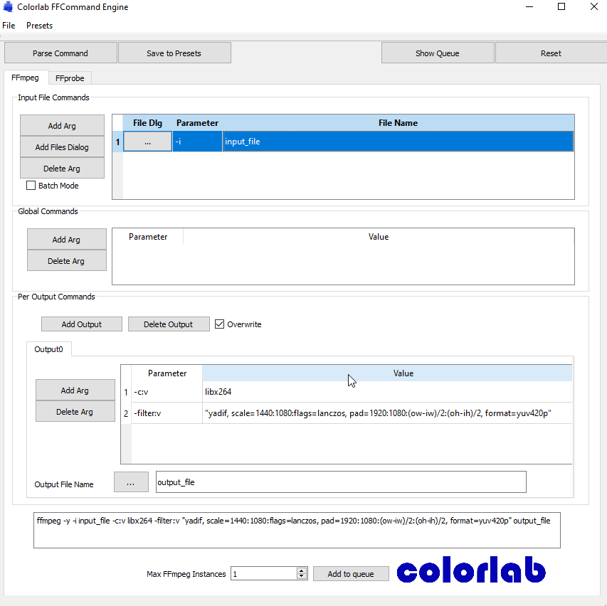

Ok, I'll double Post, because I re-read your initial post, and this is (maybe) actually gonna be more relevant :
You could be interested in ColorLab FFCommandEngine.
[Attachment 57380 - Click to enlarge]
Which is as close as you can get to a "commandlines" GUI.
You get to create custom user presets, but it also feeds from the https://amiaopensource.github.io/ffmprovisr/ repository (GitHub)
I also use this, but less often, so, this is a second guess...
Is this what you're looking for ? -

I didn't try it out; only had a Look at the ScreenShot and a Glance at its GitHub-Site:ColorLab FFCommandEngine
Seems nice and comes with C-Sources. At the first Sight the same BasicIdea as 'RunFFmpeg', but much more elaborated, of course.
