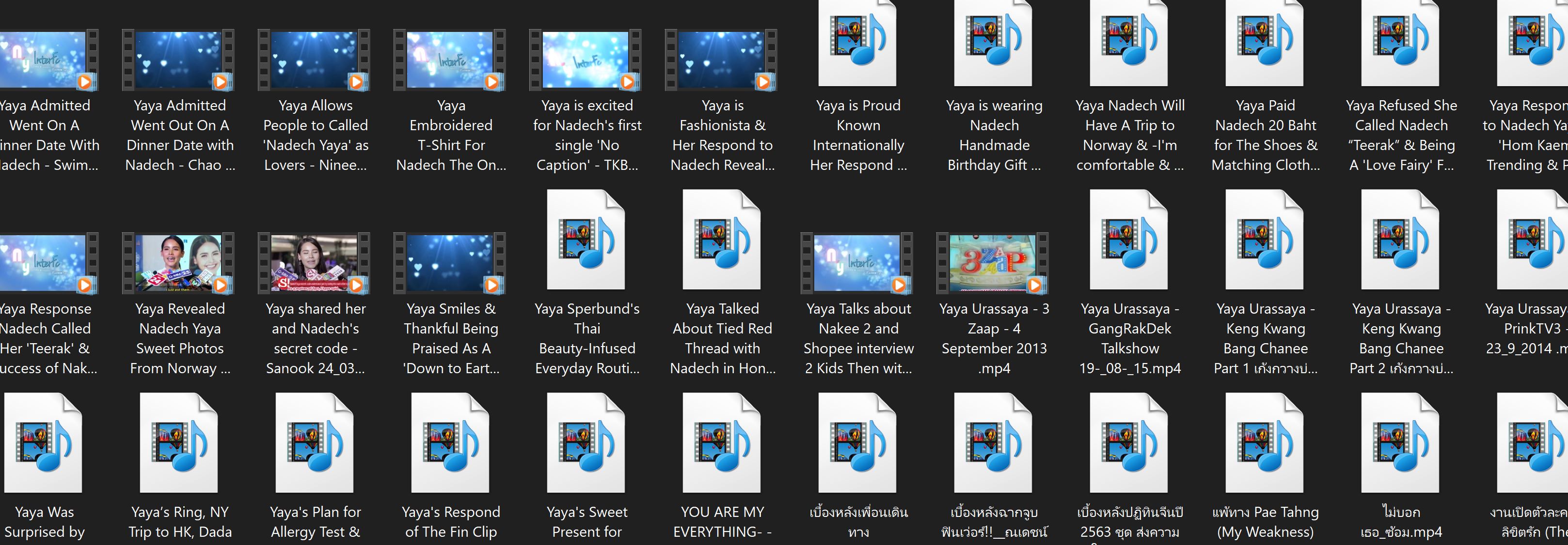

    My external hard disk is still quite new as I have only been using it for about 1 year and a half on a daily basis.
    One day, while I was transferring bulk files from the external hard disk onto my cloud drive, the hard disk suddenly failed and was disconnected from the computer despite the cable was still connected to the usb port. I literally didn't touch it and I was even away from the desk while the files were transferring.
    And ever since that incident, the hard disk runs very slow and some of the video files are not playable anymore! Look, as you can see, the ones with the thumbnails are now unable to be opened while the ones with thumbnails are still okay. How can I get them all to be fixed?
    [Attachment 56196 - Click to enlarge]

    I just copied directly from the HDD onto my desktop as usual without using any tools/software.
    The HDD is still partially working. It takes a long time to load and when it's done loading only a portion of files can be played (all the files on the HDD are media files btw).
    Yes, I read all the replies in the other thread but it's a bit hard for me to follow.
    I did a scanning with R-Studio but the results returned with 0 files.
