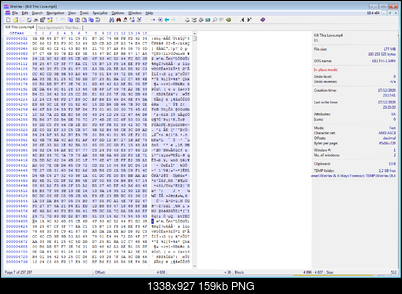

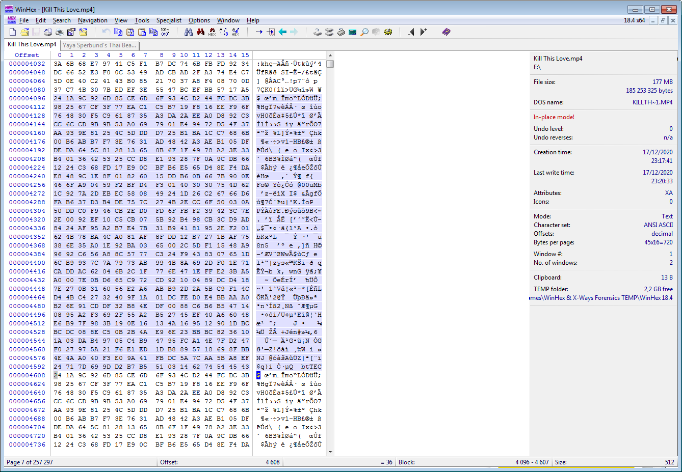

  7. The 122MB file doesn't have a valid MP4 header, or footer for that matter. Surprising thing is that is compresses to a 4.7MB RAR or 7Z file, meaning that it has a LOT of redundancy, despite looking like random data at first glance. A valid video file would have a very low compression ratio, since it's already highly compressed. (At best a valid 122MB MP4 file would compress to ~120MB. An encrypted file wouldn't be compressible at all.)
    And indeed, if (using WinHex) I select a short string at the beginning, and do search within that same file, I can see that the same 512 bytes segment is repeated over and over, seemingly until the end of the file. (So it could actually be compressed even further, don't know why WinRAR and 7-Zip need that much more, using pretty strong compression settings.)
    So obviously nothing can be fixed here, no idea how this could be produced.
    The 177MB file on the other hand does have a valid header, and is recognized by MediaInfo, which detects a video stream (but no audio) and a 6m09 duration. It doesn't play in common media players, though (although MPCHC does recognize a 1920x1080 resolution and 25FPS framerate).
    And if I do the same as above, but select a short string near the end of the file, and search it starting from the beginning, I can see the same pattern : after the first 4096 bytes cluster which seems fine, the same 512 bytes segment (which is also the same as in the first file — checksums match) gets repeated over and over until the end of the file.
    Problem solved. Or not. Anyway, nothing to recover, period. As for an explanation, God knows how this could happen, perhaps Chuck Norris and Joe Pesci too, but since all three are pretty quick to unleash their wrath, I wouldn't dare asking if I were you.
