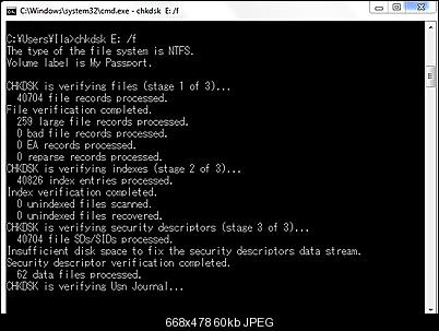

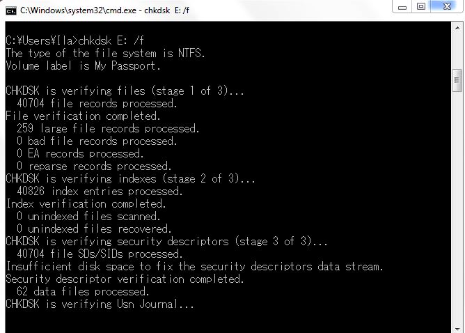

    I have a 1TB external WD Hard Drive. I have been using it for 1 year and a half and I have never experienced any problem with it until recently.
    It showed no symptoms whatsoever, and suddenly just went crazy.
    It started right after I edited a video file with avidemux. It was a simple edit, just cutting some parts of the video and saving it without any compression.
    Things got weird when the saving hanged. So what I did was saving the raw file to another drive which went well.
    Then when I tried to play the file on the bad drive, it took so long to open and eventually made the whole system stuck that I had to force shutdown my laptop.
    Then that's when I knew something was wrong.
    The drive behaves differently each times I power up its enclosure, but it is usually one of these things:
    Drive doesn't mount.
    Drive mounts after a few minutes. I see a generic "Local Disk L:" in Windows Explorer but, when I try to explore its folders, the computer takes about 15 minutes trying to read it (I can see the progress bar moving slowly across the top of the screen), and then says that "The parameter is incorrect." Drive disappears from Windows Explorer.
    Drive mounts after a few minutes. I see the full Volume name that I originally gave it, and can see all of the folders/subfolders. However, I cannot open or copy any files from the drive — on the few occasions I've gotten this far, I tried to copy some files from the drive to a different drive (thinking that I could free up some space and maybe get further along in the CHKDSK process). I hit "Copy" on a single folder on the bad drive, and then hit “Paste” on my target drive. The computer spent an incredibly long time "calculating" the file names/sizes. Hours later, there was a new error message: An unexpected error is keeping you from copying the file. . . . Error 0x800704fD: The request could not be performed because of an I/O device error.” I clicked on "Try Again," and got the following error message: An error has occurred. The destination you have specified does not exist . . . The drive had already dismounted.
    Sometimes, after the drive mounts, I run CHKDSK but it says that the drive is RAW.
    Then I’ll power-cycle the enclosure and try again, and CHKDSK says that the drive is NTFS and run its course... until I get to the "Insufficient disk space to fix the security descriptors data stream" message. Then I'm back at the command prompt.
    Now I am running the chkdsk again and it remains at "CHDSK is verifying Usn journal" for more than 4 hours now.
    I am attaching the cmd log for you guys to see.

    I tried to different ports and even on a desktop but it takes an hour to detect the drive. At least on my laptop which the drive is used to be plugged into, it pops up immediately as it always do. I tried opening it on safe mode, and I could access the drive but it is soooo slowww.
    I managed to copy one file of 678MB and it took about 5 hours to complete. Did the chkdsk in safe mode too but it didn't succeed because it says "insufficient disk space to fix security deciptors data stream" or something like that. Should I delete some files?
    Yes, delete some files.
    https://technet.microsoft.com/en-us/library/cc962242.aspx
    "Error Message:
    Insufficient disk space to fix the security descriptors data stream.
    Explanation:
    Chkntfs found a problem with the Security Descriptors Data Stream file ($SDS). This file contains the Access Control List (ACL) and owner information for the files on the NTFS volume. Chkntfs was unable to fix the corrupted file because there was not enough disk space to write all the information to the $SDS file.
    User Action:
    Delete some unneeded files from the disk and try again. If you continue to get this message, you may have to backup the hard disk, perform a low level format and restore the information."
    However, your best course of action has been posted several times above unless you're planning to RMA the drive under warranty. Remove the drive from the case since it's highly likely to be a bad USB interface that hopefully hasn't permanently corrupted the drive's contents.
