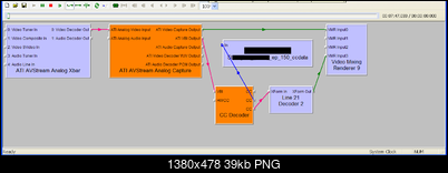

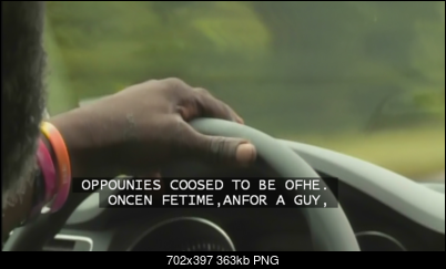

  2. So this WAS working as I wrote previous to this but it was the first time out for CCdata capture on the newly rebuilt dedicated win7 machine. I have to say this same phenomenon was showing up on the original machine I was doing s CCdata capture on as well... Now after one day I cannot get EITHER DEVICE TO DISPLAY INTELLIGIBLE CC'S. I do not believe it to be the hardware devices causing these issues because on a virgin install of OS/GraphEd/drivers etc, it was working fine using the same hardware.. Now all I am able to glean is jibberish/garbage CCdata. It's not the source as I have checked that already by turning on the source device hardware decoding and its all OK. It seems to me this is manifest of Graphedit[next] the drivers and filters. I have tried different cables and resetting and rebooting commputer/hpg hardware a number of times at this point to no avail.
    Is there a way to reset the filters/drivers/graphedit[next] to be as they were at ground zero BEFORE every capturing any ccdata on a given computer? This setup worked fine on my video capture machine the first time I tried it and then it started decoding CC jibberish just after the first capture session (shutting down machine capture hardware for the day, then firing it up again the next). In the past I was able to blindly remake graphs, reset hardware powering off back on etc and was somehow able to get CCdata to be decoded properly but at this juncture it's basically all screwed.
    So if there is a way anyone knows of that will simply reset all of this software junk it just before starting a capture session please let me know. I am currently UNABLE to capture any INTELLIGIBLE cc's with EITHER device (1950 or 955Q) until I can get this issue resolved.
    Here's an example...
    I was able to get a graph working for the 955Q using the native Dshow color space converter instead of the HPG one. But still unable to get intelligible CCdata to be decoded.

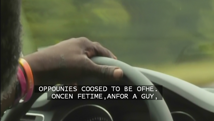

    Is the output file from the Dump filter also exibiting this problem?
  4. Originally Posted by usually_quiet View Post
    Yes. The CC data output to the .BIN file is WYSIWYG. Which is why I lay out the graphs with a video display included so I can see at a glance how well (or not so well) the CC data capture integrity is (or isn't). It's a necessity really given the way these softwares work (or don't work).
    I've been doing somersaults trying to figure this deal out. It's not computer platform specific as this issue follows to a whole different machine - the only similarities being the hauppauge hardware (1950 & 955Q) and the drivers, cabling (which I have already tried swapping, it's not cables), and graphstudio(edit). I have tried older versions of graphedit 32/64bit, the latest ones 32/64bit. I had been uncrating fresh copies of the Graphedit binary (and the associated graphs) each time before starting a capture session (I archived and sequestered working copies and simply pulled a fresh one from the archive) which helped but still dicey operation at best. I even had seen good capture data at the beginning of a session of one piece of content and successfully completed the entire 1 hour capture and stopped to get the next capture of another piece of content going and found good data being capped at the beginning only to come back after around an hour to find it had degraded to crap whilst doing the capture.
    There has to be a better way than this.. I have tried messing around with different filter combinations to see if that helped but there are so very few filters that will work with this hardware in the first place it's really not practical. Very curious as well that first runs of these softwares on the platform machines are fine but all other subsequent runs hence are dicey as hell and almost impossible to GET IT TO WORK correctly. Seems like that if it works one day then starts defaulting to crap from then on there should be a way to reset the environ back to a state where the stuff will work. I dunno, just grasping at straws now... But like I said I have been able, between uncrating fresh binaries/graphs, and rebooting the platform machine and the HPG devices, to get some proper content captured but it's very dicey. Yesterday I was messing with the thing all day to no avail at all - most frustrating, and lost a whole days worth of capture time.

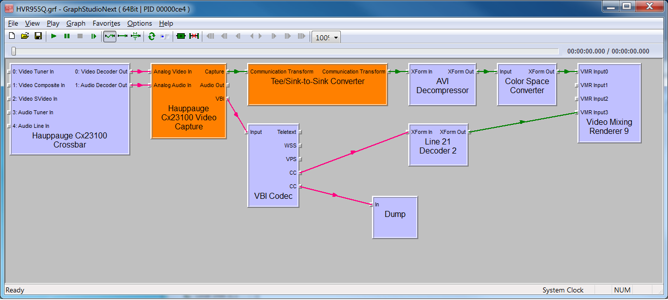

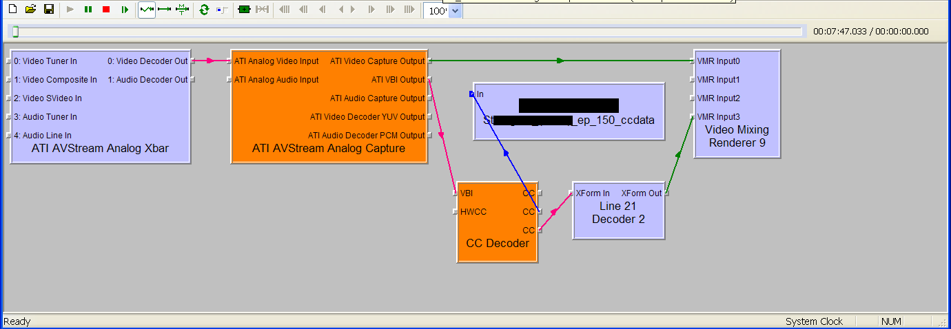

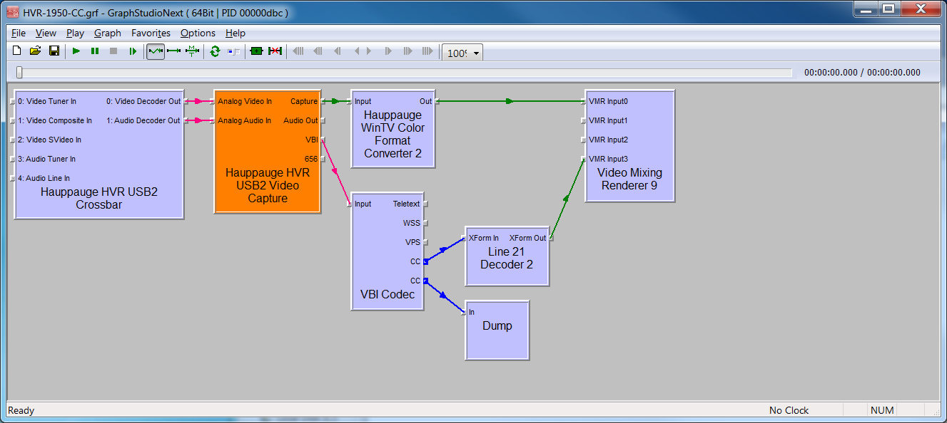

    These are the graphs I built on the new machine platform (which are virtually identical to the ones built on the original machine) for the two HPG devices. They are simple and to the point nothing real fancy going on - just bringing in composite video/audio from the device crossbar to the device capture filter, splitting the video content on to the renderer and the vertical blanking signal down to the VBIfilter, to the line-21 decoder and finally on to overlay the CC's onto the content display from the renderer. The CC's being displayed is what gets dump.filtered to the binary CC capture file. These DO work and will display CC's over the video. Just that the CC integrity is for the most part, junk ;
    For the HVR-1950
    and for the HVR-955Q
    Has anyone else had this happen before using hauppuage hw and drivers? Curious.

    I haven't yet seen the problem you are describing with the DirectShow filter graphs that I built for the HVR-950Q but to be fair, you have probably used your devices a lot more than I have used mine. I don't have any theories that would explain the problem.
  6. Ok I believe I have found A solution but it's somewhat around the bend and possibly out of reach of some...
    I am fortunate that my test machine has a VERY wide range of support in that I can successfully image OS's on it from WinXP to Win10 and everything in between. In this instance I have built a WinXP x86 image onto it and installed WINTV 6 along with Graphstudio. it was said that WinTV 6 (later versions DO NOT have this capability for composite video) has the capability of recording CCdata inside a captured composite video file for later extraction and it does seem to work. However using the graphs are FAR more efficient and I have been able to simply fire up the computer in the morning and all day long these graphs have been doing pristine CC data captures from composite video, BACK to BACK with out degradation, dropped dialog, missing words, letters, etc. This was unheard of on more recent platforms in my experience here. I have come to the conclusion that the only real difference in the graphs I use under WinXP is the "CC decoder" filter. This is the ONLY real difference graph wise from WinXP to win7 or win10. The "CC decoder" that was dropped from subsequent windows systems after XP was apparently replaced with the "VBI codec" from Vista on up thru win8 and 10... I believe the VBI codec is substandard and unable to hold up to any sort of intensified CCdata collection.
    So, to finalize, if you're having issues with CC data integrity while doing multiple captures back to back from composite video, THE solution is WinXP 32, Graphstudio and WinTV 6. I have had NO more issues with re-initializing capture devices or resetting graphs or rebooting host machines. Just fire up and go. Which is the way it should be...

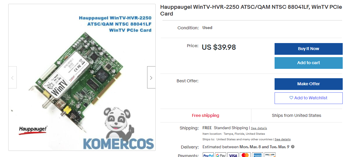

  11. aBigMeanie aedipuss's Avatar
    Oct 2005
    666th portal
    this is listed as HVR-2250 PCIe but the board pictured is definitely PCI not "e"
    [Attachment 57503 - Click to enlarge]
    The card pictured is not a WinTV HVR-2250 or even suitable for use in N. America. I found another listing that identified it as a Dell Hauppauge PAL C599 PCI Card WINTV-26152.
    [Edit] The most recent Hauppauge TV card with a PCI interface that does software encoding is the Hauppauge 1288 WinTV-HVR-1150 PCI. It is still being sold new although there are no Windows 10 drivers available. Cards that encode video and audio using software are more likely to allow CCs to be recorded by themselves in a separate file.

    Diamond made a few PCI and PCI-e cards that could capture closed captions via composite. I owned all three versions of the TV-Wonder 650 (PCI-e, PCI, and USB) but I captured closed captions as part of the MPEG-2 GOP user data. The USB version, which could only encode video and audio using software running on the PC, could probably capture closed captions in a file by themselves. I'm less sure that the other two, which could use either an onboard encoder chip or software running on the PC to encode video and audio, could also do that.
    Does this look like the TV Wonder 600 PCI that you had? >> https://ebay.to/3qRTAo2
    The 600's were JUST CAPTURE cards right not Hybrid capture+system video? I believe that has a (top down) RF Tuner IN, S/Video IN, Composite Video in (rca), Audio IN (1/8" phone jack) correct?
    Sorry. I misremembered which USB device I had and corrected myself in a later post. I had the PCI and PCI-e versions of the TV Wonder 650 and the USB version of the TV Wonder 600. I never owned the PCI or PCI-e Version of the TV Wonder 600.
    The two internal TV Wonder 600 cards (which I never owned) use totally different hardware than the USB version of the TV Wonder 600 so my experience with the USB version isn't applicable to the two internal versions of the TV wonder 600.
    Using the TV Wonder 600 USB, I could build a graph to capture CCs in the MPEG2 video GOP user data but I never tried capturing CC's alone. I still have a TV Wonder 600 USB but I don't know if it still works. It may be fried due to inserting it into a bad USB port. I haven't had the courage to try it again since then.

    I have my own issues capturing CCs to a file all by themselves with the WinTv HVR 950Q. I get an empty file or a file containing 2 lines. Capturing them as GOP user data using the TVW 600 USB's software encoder and software muxer seems to work OK.
    My track record with questions isn't great, but here goes. Are you setting up the graph to use the clock? Using the clock synchronizes the filters in the graph. Otherwise, they all run on their own schedule.
    I never had a BT878 card or any of the others that you mentioned so I can't tell you about them.

  25. So get this.. I found a ISO image of HPG WinTV 7. Installed it on the XP box and was getting PERFECT captures from the 955Q for about 4 days IN A ROW. Then today I come in, fired everything back up, got all ready to start another "perfect session" of CCdata captures, and did a caption check before I actually started to roll.
    The Caption check was a total fail. Today. For 4 straight days previous it was pristine, TODAY... Total crap... No idea...
    It just so happens that the ATI TV Wonder 650 PCI arrived today as well. So, I boxed up all the HPG gizmos and threw in the ATI card. rebooted. Built a quick graph for it to capture CC's to a raw file thus;
    ...and we're off to the races once again... The ATI TV Wonder 650 is capturing CCdata just fine - just as fine as the retarded 955Q WAS doing for like 4 days previous before it just plain stopped grabbing intelligible captures, YET AGAIN.... I will admit that the PCI card is a MUCH cleaner looking setup than the USB. I'm not even bothering to connect audio up anymore for captures since It's not needed anyway. Just once RCA cable to connect video's ant that's it.
    Sooooo.... Now we'll see how long it takes the ATI 650 PCI card to totally crap itself...
