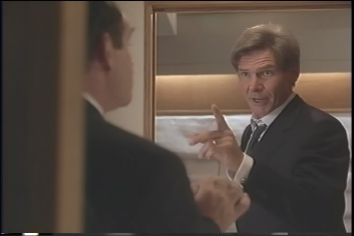

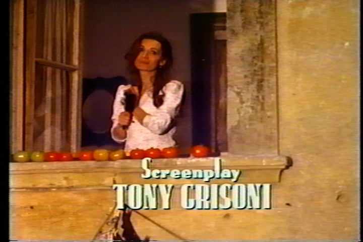

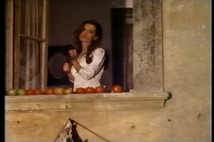

    [img]airforceon1413pinnacle.jpg[/img]
    The next is the hd-pvr capture also via svideo at 10mb to m2ts:
    [img]airforceone1413hdpvr.jpg[/img]
    The last is the dvd I authored from the hd pvr using avstodvd (without cropping by the way). It was set to max out a dual layer dvd - the file size of the folder is 7.86gb - g spot says 10mbs but that was the original file so I think it is just reading the original bitrate not what avstodvd created
    [img]airforceone1413dvdfromhdpvr.jpg[/img]
    I think this turned out very well. I am definitely pleased with the hd pvr result. Upon closer review however the pinnacle did not do too bad of a job.
    By the way it was to tough to get three seperate files as close as I could to the same spot - even reading the second with mpchc was tough to get the right up tick of the hand.
    Comments? Suggestions?
    FYI I am not in a position to buy a full tbc or any other hardware at the moment. But I think I am satisfied with the results I have been able to get so far.
    Also please note these were done all with base line settings on pinnacle and the hdpvr. I did not tweak any color settings or anything like that.
    EDIT - correction the last picture is the snapshot from the original file that I recorded on the hdpvr - the middle one is from the dvd I created from the hdpvr file - sorry.

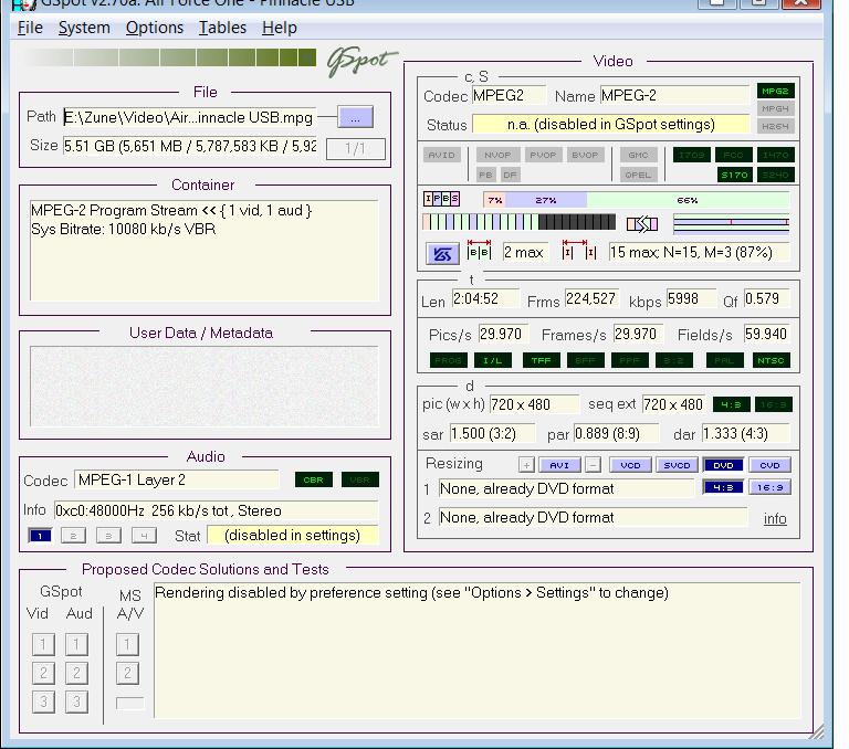

    I don't know. Here is a gspot snap of the original file (I kept it just in case there were more questions - if you want I can sign up for rapidshare or some share site and upload a short clip of both the pinnacle and the hdpvr cap.
    [img]gspotairforceone.jpg[/img]
    The dvd from the hdpvr cap turned out nicely. I burnt it to a dl and it played cleanly on my xbox 360.
    I am planning on doing a different movie at 5mb so that I can fit it on a single layer disc. My 10mb hdpvr file was 6.8gb and I'm hoping for close to 3.4gb for the 5mb capture. That way upon conversion to dvd even if I max it out for a single layer there shouldn't be too much extra padding for the file. The dvd from the 10mb 6.8gb file came out to 7.8gb from avstodvd using its dvd-9 template. I would hope for a similar performance with a 5mb cap to single layer dvd.
    I'm hoping the 5mb capture should look good also. If so than I won't have to use up dls for vhs captures.

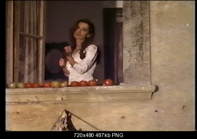

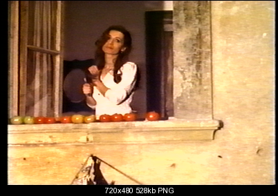

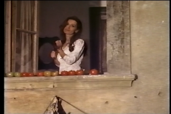

  15. I'll start uploading some sample images comparing the Diamond ATI TV Wonder USB HD 650 and the Hauppauge HD PVR (and a few other caps too). All my caps are with VirtualDubMod so they include the usual rec.601 contrast stretch. I'm using an old commercial, ex-rental, VHS tape of Queen of Hearts. This was not a great transfer from film. The tape is one of the few commercial tapes I have left and one of the only ones without Macrovision. The VHS deck is an old cheap hand-me-down Toshiba W-602. I used a Panasonic ES15 passthrough as a TBC/frame sync. I adjusted the ATI 650's proc amp settings to best accomodate the input. I could not adjust the HD PVR's proc amp settings. (I'm pretty sure I used to be able to do so but this is a different computer). I left the sharpness settings of the two devices at their defaults. Neither seems to be overly or underlie aggressive in this respect (no oversharpening halos). The noise filters were left at their defaults.

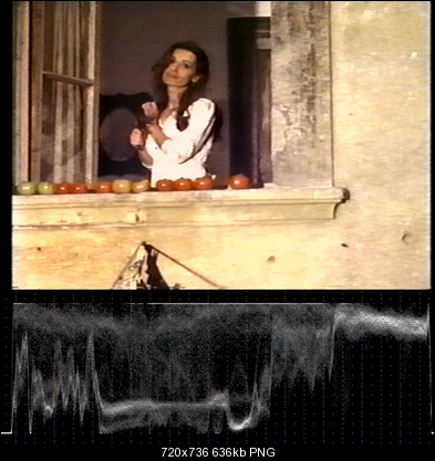

    First the ATI 650 has a problem with its over-aggressive automatic gain control. It sometimes crushes blacks and blows out brights. No amount of adjusting the driver's proc amp controls could fix this.
    Here's a frame from the ATI 650 just after a cut:
    A few frames later:

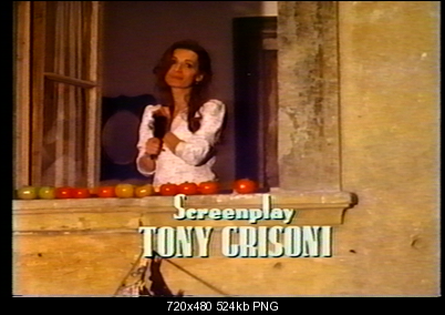

    A few seconds later the levels are ok, you can now see details in the Woman's dress but the picture is over-saturated:

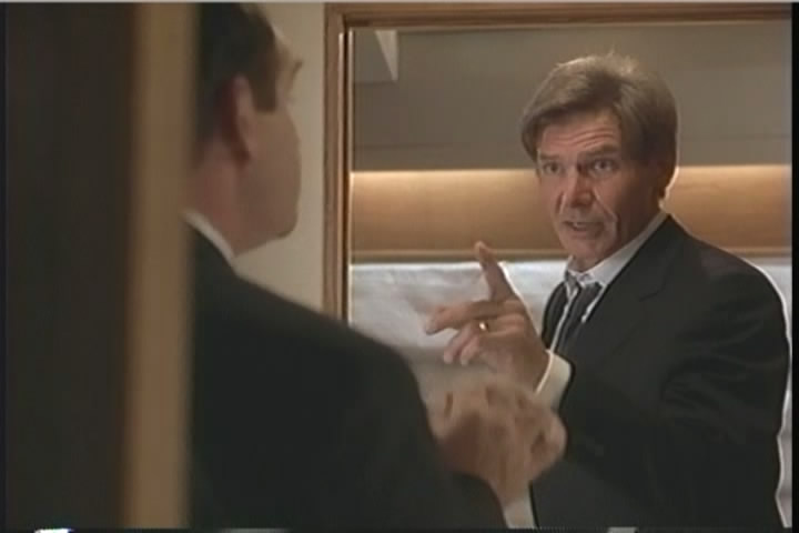

    The problem is not because of Macrovision (one of Macrovision's techniques is to screw with the AGC circuitry of VHS recorders.) because the same thing happens with several home recorded VHS tapes.

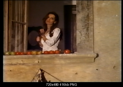

    The sequence from the HD PVR cap was consistent (this is the same frame as first image above, the others were about the same):

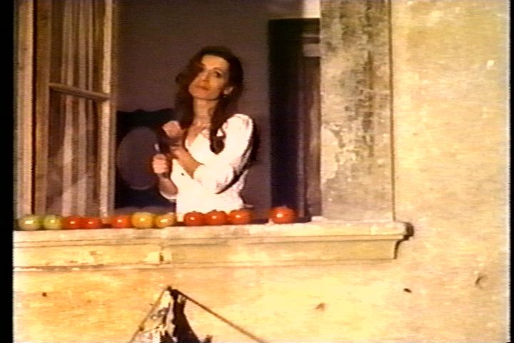

    Colors on the HD PVR are a little under saturated. The reddish color cast is in the VHS recording.
    The HD PVR has more aggressive noise reduction and is less sharp, maybe partly from the intentional noise reduction and sharpening filters, and some from the h.264 compression.
    Here's the same frame from a Hauppauge PVR-250 at 12,000 kbps MPEG 2:

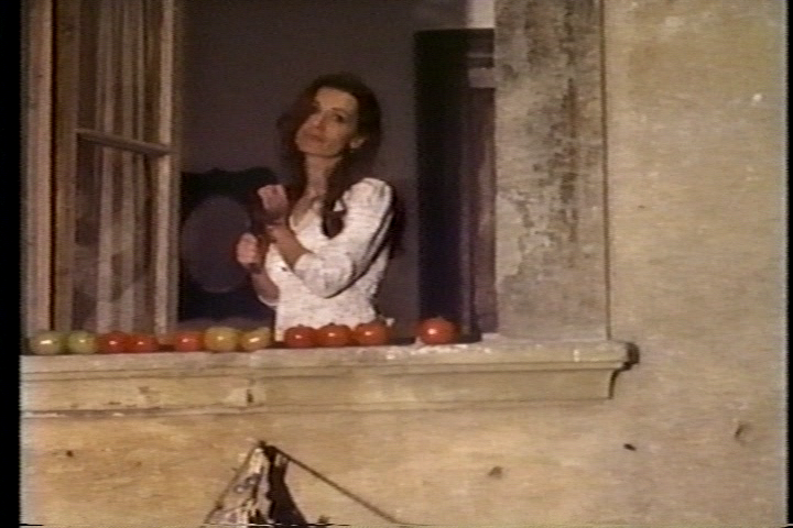

    From the same VHS deck, recorded on the Panasonic ES15 DVD recorder in XP (1 hour) mode:

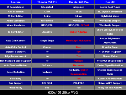

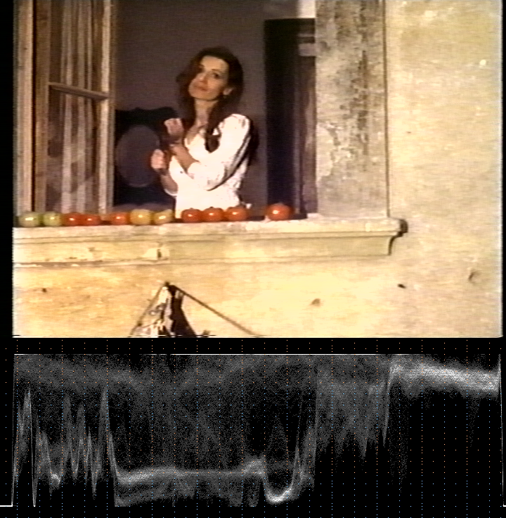

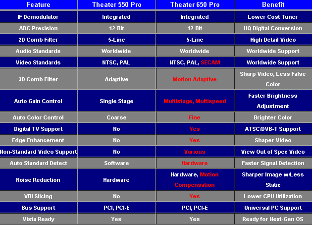

    This is also true for Ati HD750. Theater 550 don`t have this issue. The reason behind this is that Theater 650 have a new Auto Gain and Auto Color over the Theater 550. There is no user way to fix those. Sometimes is better to feed directly the card with signal from vcr. The negative side will be the TBC errors when regular vcr is used. On vertical synch Theater 650 do a good job but on other dimension do nothing.
