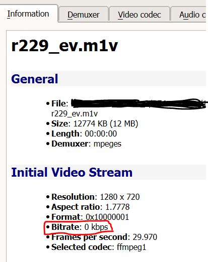

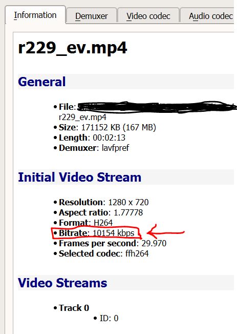

  10. ok so now I guess I need some help with the settings of ffmpeg. While it works well i'd like to improve the quality, as it seems a bit pixelated, even at 30000. When I look at the information it shows as 0kbs:
    [Attachment 53801 - Click to enlarge]
    while comparing it to another video stream created with Xmedia recode which has much better visual fidelity:
    [Attachment 53807 - Click to enlarge]
    Here is the output of the ffMpeg while converting with a setting of:
    ffmpeg.exe -i r229_ev.mp4 -c:v mpeg1video -b:v 30000 r229_ev.m1v

    Perhaps there are other options I could be using to help yield better results ? I mean, certainly 30000kps seems like enough but what seems odd is that the better looking video was encoded at less than half that much. I even tried it with 60000kps and there was no visible change in the poor quality.
    I did see somewhere in the output bitrate: 10472 kb/s so I am wondering if this is the actual value the video outputted as ? Even if so, the video doesnt seem to look that good.
    Any help is appreciated!
  11. aBigMeanie aedipuss's Avatar
    Oct 2005
    666th portal
    lol the filesizes should give you a clue. the "better" one is 10 times as big. so the other one has 1/10 the bitrate or about 1500kbps. it's crap for anything over 240p.

    Yes, using K worked well, but there is still the lack of the Bitrate being showed in the movie players which is very useful information. I have asked about this in my last reply.

    Most programs show the bitrate that's reported in the container's header. m1v doesn't have that header. Programs will have to check the video's size and divide by the running time. MediaInfo does that for m1v. GSpot will do it too. Mpeg File Bitrate Viewer will parse the entire file and show the bitrate distribution.
    So I guess the bitrate info I was seeing form the m1v clips I made in Xmediarecode were created by that software then? Im not sure why m1v files written with XMediaRecode show this info and ffMpeg does not?

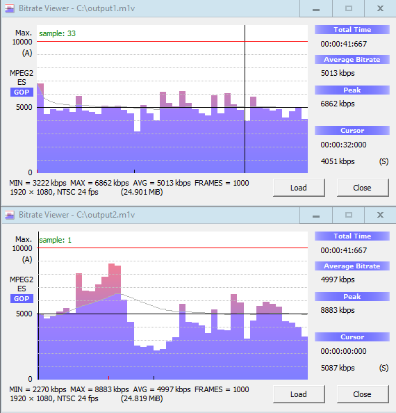

  30. 2 pass encoding:
    ffmpeg -y -i input.mp4 -an -c:v mpeg1video -b:v 5000k -pass 1 output1.m1v
    ffmpeg -y -i input.mp4 -an -c:v mpeg1video -b:v 5000k -pass 2 output2.m1v
    But that won't help if the encoder can't deliver the bitrate you're requesting. With a test I ran at 5000 kbps I got this for the two passes:
    [Attachment 53811 - Click to enlarge]
    But when I asked for 30000 kbps the encoder only delivered 15000 kbps and the two files were nearly identical.
