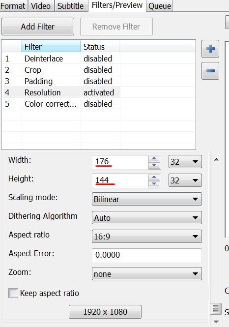

  1. Having an issue with converting a 1920x1080 video in M1v format. It seems despite that the original video I am trying to import is 1920x1080 I still cant seem to change the resolution in the Filters/Preview pane. I want to maintain the original dimensions for the output video, but as you can see in the photo below, the resolution is stuck at 176x144:
    [Attachment 46577 - Click to enlarge]
    It should be noted that this does not happen if I chose another container, like MKV for example.

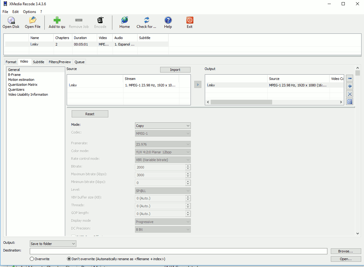

  17. Originally Posted by gdx View Post
    That is a stupid limitation of XMediaRecode, but you can do 1080 mpeg1 in it if you select the ouput format as "MKV" or "MPEG TS (DVB TS)", then when you have the ts or mkv with mpeg1 at 1080 you can extract the m1v from them in XMediaRecode selecting copy instead of encode using the output format m1v.
    Thanks for the info. I tried this before coming to this forum and some partial success but there's part of this I dont understand and I'm hoping you could elaborate on the steps to help me get this going. Could you elaborate on the part where you said:
    "can extract the m1v from them in XMediaRecode selecting copy instead of encode using the output format m1v." When I re-import this MKV file and set the output format to M1v raw video the dimension restrictions are back to those mentioned in the original post .
    Maybe a step by step would be helpful.
    Cheers, and Thank you

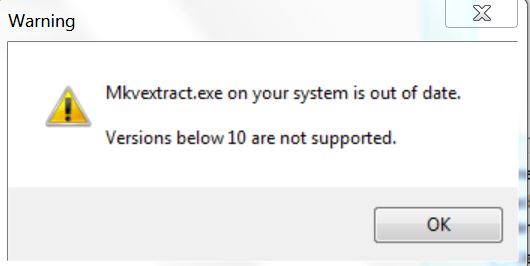

  18. [QUOTE=hello_hello;2527683]
    MKVCleaver will extract it from an MKV as mv1.
    Video To Video Converter is even happy to do mod2.
    [Attachment 46592 - Click to enlarge]
    I tried using the latest release 0.7.0.2 but I still get this error.
    Strange error message about MKVextract exe. Is this a separate program that works in tandem with MKVcleaver.exe?
    Running Windows 7
  19. Are you using on old version of MKVToolNix? The current version is 20 something, I think (I haven't upgraded it myself in a while). MKVExtract.exe should be in the MKVToolNix folder.
    If you want to keep using the older version of MKVToolNix yourself, download the latest portable version, put it somewhere and tell MKVCleaver where to find it, but you can keep the old version too.
    Alternatively there's gMKVExtractGUI, although it'll probably need a fairly new MKVToolNix too. I think it extracts the video with an mpg extension, but you can change it to M1V yourself.
    I just discovered Inviska MKV Extract too. I haven't tried it yet but it looks promising.

  21. well I'm back, with the ssame issue that was never resolved. I think it is a bug with the program because I had the height/width working for quite some time but now it is capped at some incredibly low resolution. I have tried a newer version of the program with the same bug.. My resolution width/height are capped and I cant fix it.
    I have tried to do the COPY instead of CONVERT but there is no option to copy on the drop down, only CONVERT
    EDIT -I was able to get the program to allow me to use a custom ratio by clicking on the 32 32 buttons. This hasnt always worked in the past, but for some reason worked today. I am still convinced this is a bug.
    I had to try another method as well and switching from m1v to mpg2 and then back to m1v also worked.

  26. I've never used XmediaRecod but some possible issues are...
    It looks like the program doesn't want to allow resolutions over 768x576 when you are using MPEG 1. Look for a Profile@Level setting somewhere. If there is such a setting set it to High Profile, High Level. Main Profile and Main Level are restricted to SD resolutions.
    What are the choices in the Aspect Ratio pulldown? In the video it's always set to 16:9 but 1920x1056 is not 16:9. Try 1:1 (pixel aspect ratio) if that's one of the options.
    The boxes to the right of width/height are modulus values. They limit the width/height values to be integer multiples of those numbers. For example, if the width modulus is set to 16 only integer multiples of 16 will be allowed for the width. For MPEG 1 you want those set to 16. Maybe even 32. 1920x1056 is suitable for both of those.
