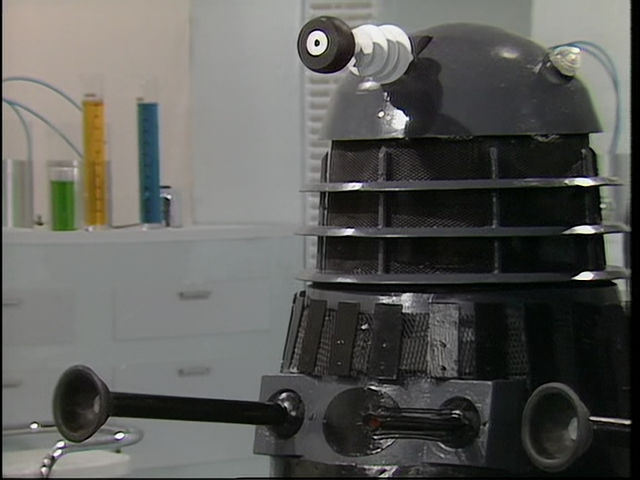

    I've no idea what you're on about. Does it have any basis in reality? Why would I deny anything? Below is a screenshot showing what I'm cropping from the sides of a DVD as we speak, and it's only 720 pixels wide. Who's going to lose sleep over cropping 10 pixels out of 1920?
    I'd end up with the second screenshot below after resizing, while you're limited to cropping 8 pixels each side before resizing because any other the maths is too hard, and you'd be left with the third screenshot after resizing. Aside from it looking ugly, you actually boast about it being the better way to do it. Mental. How much aspect error can you see in my resized image compared to the way you'd do it?
