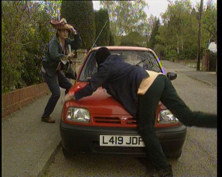

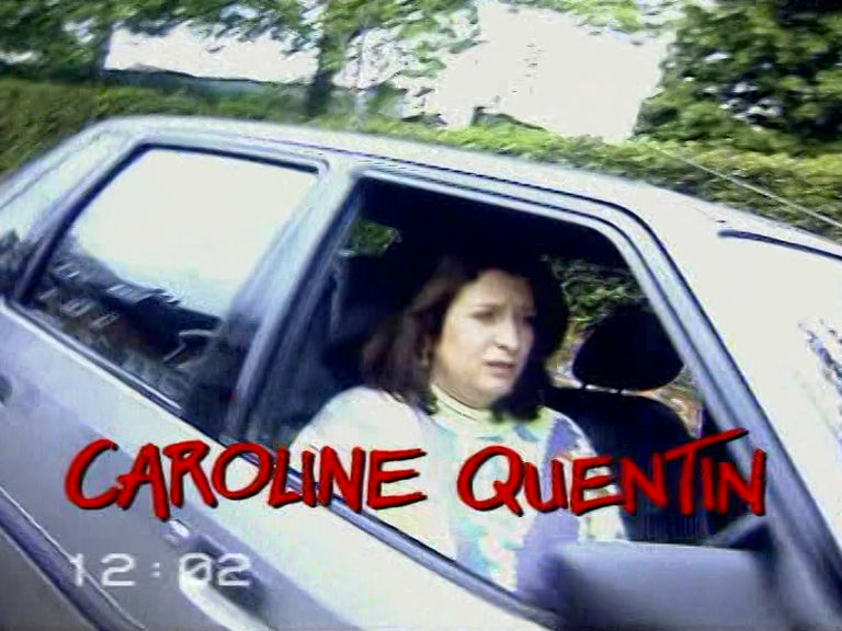

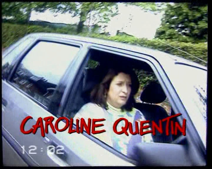

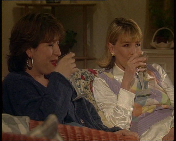

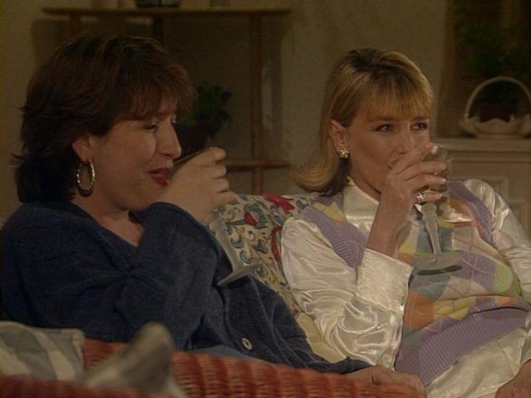

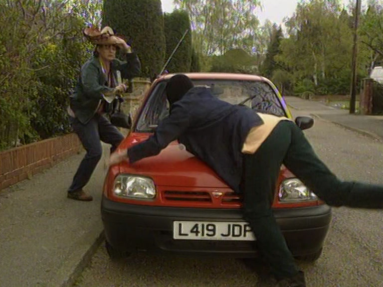

    Here's screenshots from an episode of a PAL DVD. First from the source and then after cropping and resizing to the same square pixel dimensions with zero or virtually no aspect error (the maximum was 0.06%).
    I've seen far worse than this, but you'd want to be doing it "backwards", as you describe it. You mightn't care if your encodes look nice and neat, but many people do.
    Funnily enough, I roughly know what the numbers should be, and I couldn't work out why they were a little different and the aspect was slightly off. Then I realised I was using the template I created with the resizing before the cropping.
