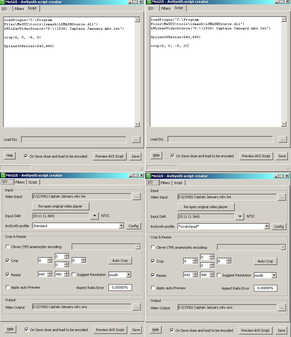

    - Open your source video using MeGUI's Script Creator. You can add filtering such as de-interlacing or noise removal if need be, but disable cropping.
    - Resize to exact 16:9 dimensions. The closest width to 720 that gives you exactly 16:9 is 704, so you'd resize to 704x396. It's mod4. If you want a slightly higher resolution, try 832x468. It's still exactly 16:9. I use both those resolutions regularly for standard definition 16:9. I generally use Spline36Resize.
    - Save the script, but don't load it for encoding.
    - If the Script Creator closed, open it a second time from the Tools menu. This time, instead of using the source video as the input for the Script Creator, use the script you just saved. Your source will now be 704x396 or 832x468 etc, at least as far as the Script Creator is concerned.
    - Disable the script creator's resizing if need be and apply any cropping required to remove the black, keeping it mod4. The remaining picture will be the remaining picture aspect ratio without any aspect error, whatever that turns out to be.
    - Save the second script and encode it.

    so as he put it, Tools/avs file creatore/ dgindex (I chosed), then go into queue to start indexing. Then actual avs script creator pops up.
    Then it should be done rather this way:
    firstly, in that AVS script creator window, one better to change default "avs script profile" pressing CONFIG button for right order, or make a new profile:
    <input>
    <resize>
    <crop>
    you can delete everything if not denoising and just paste in that above, note resize is above cropping, save it
    Then back in avs script creator window, you change crop, you do not know what values, you can enter some values like cutting 10 from top and bottom. Then select resize (yes nice exact 16:9) , then check preview window for intimidate graphic image feedback pressing "PREVIEW Avs Script button"
    Then just correct crop as you please, and again press that "PREVIEW Avs Script button", do it , correct it as many times needed, after that Save it.
    Go to the queue and encode.

  30. Originally Posted by _Al_ View Post
    But you actually omitted how to do it properly
    and
    there is actually a visual feedback for cropping changing so anyone can crop as pleases, yes that feature that you were mocking as a non existent actually exist right underneath your own arse
    Personally, I'd recommend you omit the personal insults when trying to prove you know better, because you're once again blaming someone else for your own behaviour.
    Forgetting for the moment you're at least partly wrong, maybe if you'd been all grown up when you started posting here and explained how to do it, you'd have saved a lot of arguing.
    <input>
    <resize>
    <crop>
    I've used MeGUI for many years so I know it quite well. The problem is, MeGUI always bases it's resizing on the cropped input, even if you swap the order of cropping and resizing. It's something anyone who's cropped and resized before should notice.
    Admittedly you can do it exactly how you described, but next time you explain it, be sure to emphasise that if you change the cropping/resizing order, MeGUI's aspect error calculations will be wrong unless you calculate a new Input DAR yourself and change it. Or you could manually add the cropping to the script rather than use the GUI, or you could even cut and paste the cropping MeGUI adds in order to move it below the resizing, and yes and you can preview the result, but how would MeGUI factor that into it's aspect ratio calculations?
    A newbie probably wouldn't know to ignore the aspect error though. That's why I suggested doing it in two steps. First you resize, then save the script and use it as the basis for creating a new one, and when you open it, MeGUI will base it's calculations on the script's display aspect ratio and show the correct aspect error. You could even use the anamorphic option, make note of the aspect ratio MeGUI adds to the top of the first script, and set that as the Input DAR after loading it as the video input for the second script.
    Check out the following screenshots. If you've gone through the process yourself I'm astounded you didn't notice what was right under your arse. I've resized first myself and then cropped on occasion, if was warranted for some reason, but you need to know to ignore the aspect error MeGUI displays and do any necessary calculations yourself. The OP did ask how to determine the correct resolution in MeGUI though, not how to get it to display the wrong one.
