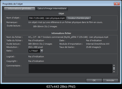

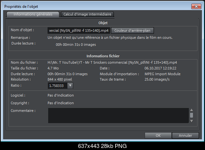

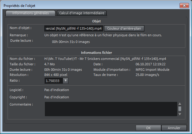

  1. The attached video, downloaded from YouTube, has a resolution of 854x480 according to MediaInfo and various other media players / editors — but for some reason, it is imported in the editing software I'm using (Magix Video Deluxe 2016) as 844x480, with an aspect ratio of 1.758333. If I change that aspect ratio in the clip's properties to 16:9, the height is reduced, but the frame remains incomplete. If that MP4 file is remuxed to a new MP4 file with mp4box, ffmpeg or Avidemux, the resulting files are also imported with an erroneous 844x480 resolution. Only a conversion to a lossless AVI file gets imported with the correct 854x480 resolution. Is there any weasonable explanation for such wandom weirdness ?
    (Since it's a relatively simple editing task, which involves mostly appending a bunch of short sequences together, with a few fade-in effects, I could do it with Avisynth, but since they're in different resolutions it's more convenient to do it from full-fledged NLE, also one sequence needs to have the audio slightly offset for proper synchronization, I don't know how to do that with Avisynth.)
Name:	Mr T Snickers commercial [NySN_plfiNI -f 135+140].mp4 -- fichier MP4 chargé dans MVD.png
Name:	Mr T Snickers commercial [NySN_plfiNI -f 135+140].mp4 -- fichier AVI Lagarith dans MVD.png
Name:	YT - Mr T Snickers commercial [NySN_plfiNI -f 135+140].mp4 -- MVD info.png

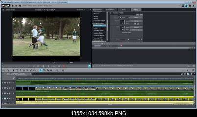

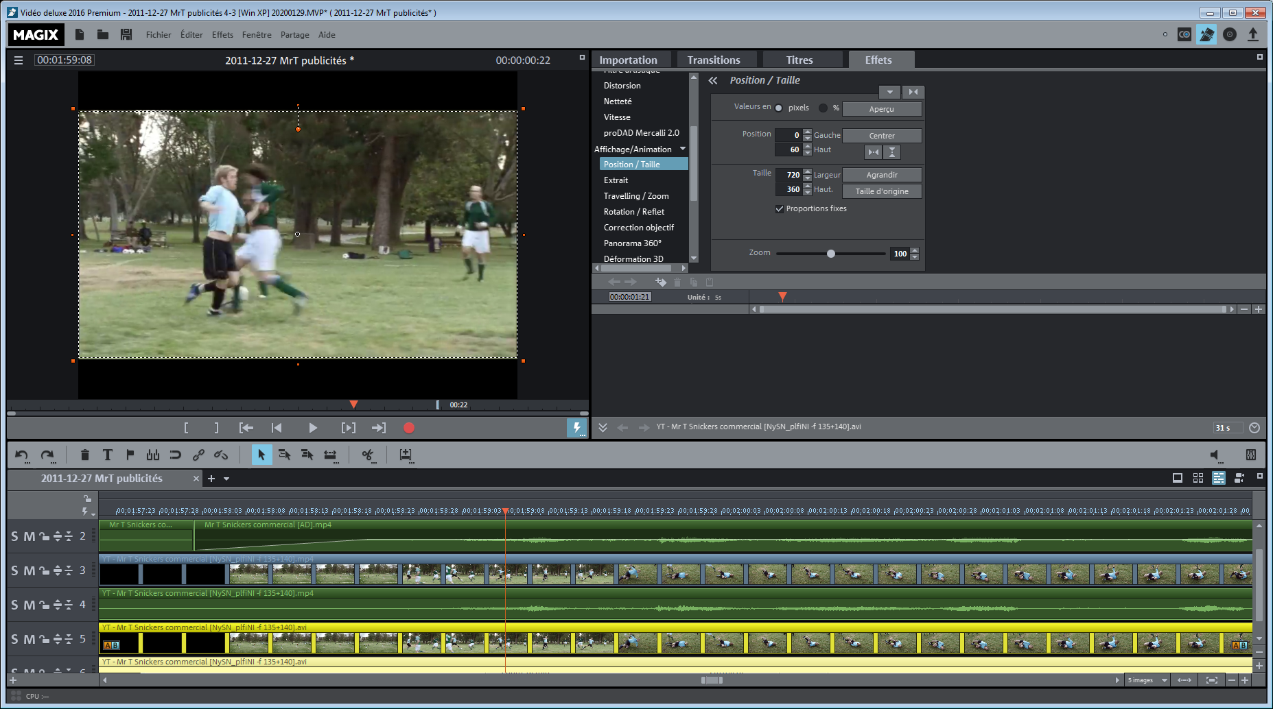

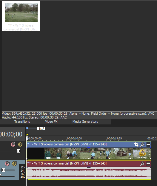

    it imports into magix vegas pro 16 as 854x480 just fine. but it's f'd up anyway as that resolution is ntsc and it imports as 25fps which is pal, not ntsc.
    [Attachment 51716 - Click to enlarge]

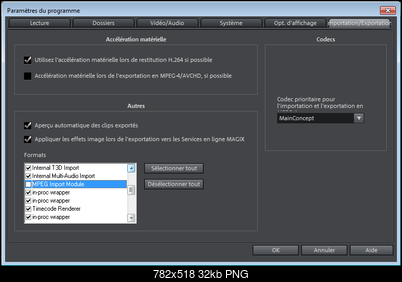

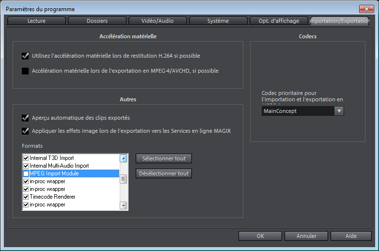

  3. So, seeing that it was imported with "MPEG Import Module", I disabled this module in the software's global settings, then re-imported that file... At first it didn't change anything, most likely because it was still associated with a .H0 file (don't know exactly what they're for but apparently they keep track of each imported file's metadata and whatnot), then I created a hard link of that file (or I could have just renamed it but it would have required to first close the editor) and re-imported it — and now it appears with the correct 854x480 resolution, while the Information panel indicates that it was imported with "Internal DirectShow AVI".
Name:	MVD MPEG Import Module.png

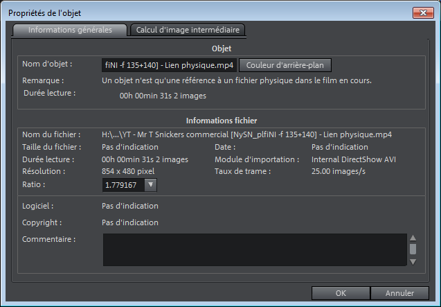

Name:	Mr T Snickers commercial [NySN_plfiNI -f 135+140].mp4 -- Internal DirectShow AVI.png
    Is this a known issue ? Are the importing modules in editing softwares somewhat standardized components, or does each one have its own brands and flavours ? Generally speaking, is there a way to control which file types are imported with which specific module in editing softwares, or is it something that is not meant to be tampered with ?
