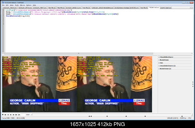

  5. I don't get it. I adapted my script based on your advice :
    V = LWLibavVideoSource("K:\GCarlin extrait 10m39s72-25m06s72 [Avidemux MP4v2 Muxer].mp4").BicubicResize(640,480).AssumeFPS(29.97)
    A = LWLibavAudioSource("K:\GCarlin extrait 10m39s72-25m06s72 [Avidemux MP4v2 Muxer].mp4")
    AudioDub(V, A).FadeIn(20).FadeOut(20).DelayAudio(0.200)
    TextSub("K:\GCarlin extrait 10m39s72-25m06s72 [Avidemux MP4v2 Muxer].srt")
    The playback is just as jerky in VDub2 and the resulting encoded file is strictly identical to the previous one made without AssumeFPS (same checksums – the audio delay did nothing because I copied the audio from the source file for the encode, considering that it doesn't require the fade-in / fade-out so it avoids a generation loss).
    If I load the source file with Info() and without AssumeFPS it reports a framerate of 29.97 FPS.
    Oh wait, I used “LWLibavVideoSource”, indeed with “LSmashVideoSource” I get “1.7331 FPS”... And the length is about 4h10m, and it gets totally confused if I try to display a random frame, or parse the footage backwards. Then with AssumeFPS it seems much smoother indeed, although I still don't get why / how.
    So is it specific to LSmashVideoSource, and if so what does it do that LWLibavVideoSource doesn't ? With AssumeFPS, how can it create frames which (unless I'm mistaken) aren't there to begin with, without a complex interpolation function which would almost inevitably produce artifacts ? (As you explained here five years ago, from a link which appears below, while we're doing some archeology.)
    EDIT : Side question, is it wise to resize to 640x480 before uploading, considering that YouTube would resize it to that resolution anyway, possibly with a lesser quality algorithm ? Considering the quality it would be overkill to upscale it to 1280x720 (although I've been told that the bitrate allocation on YT was significantly better for so-called “HD” resolutions compared with 480p or 360p).
    EDIT : Also, how can I set the audio delay with ffmpeg ? (If muxing the native audio with the re-compressed video.)

    LSmash uses the index that's within the MP4 or MOV file, and only works with those containers. LWlibab builds its own index (hence the .lwi file) and works with any container. Apparently both of them screw up with this video, but in different ways.
    AssumeFPS() doesn't create or remove any frames. All the frames are already present in the MP4 file. ffprobe.exe shows the file contains 25985 frames. At 29.97 fps that equates to about 14 minutes and 27.033 seconds.
    I don't much about what youtube does with uploads.

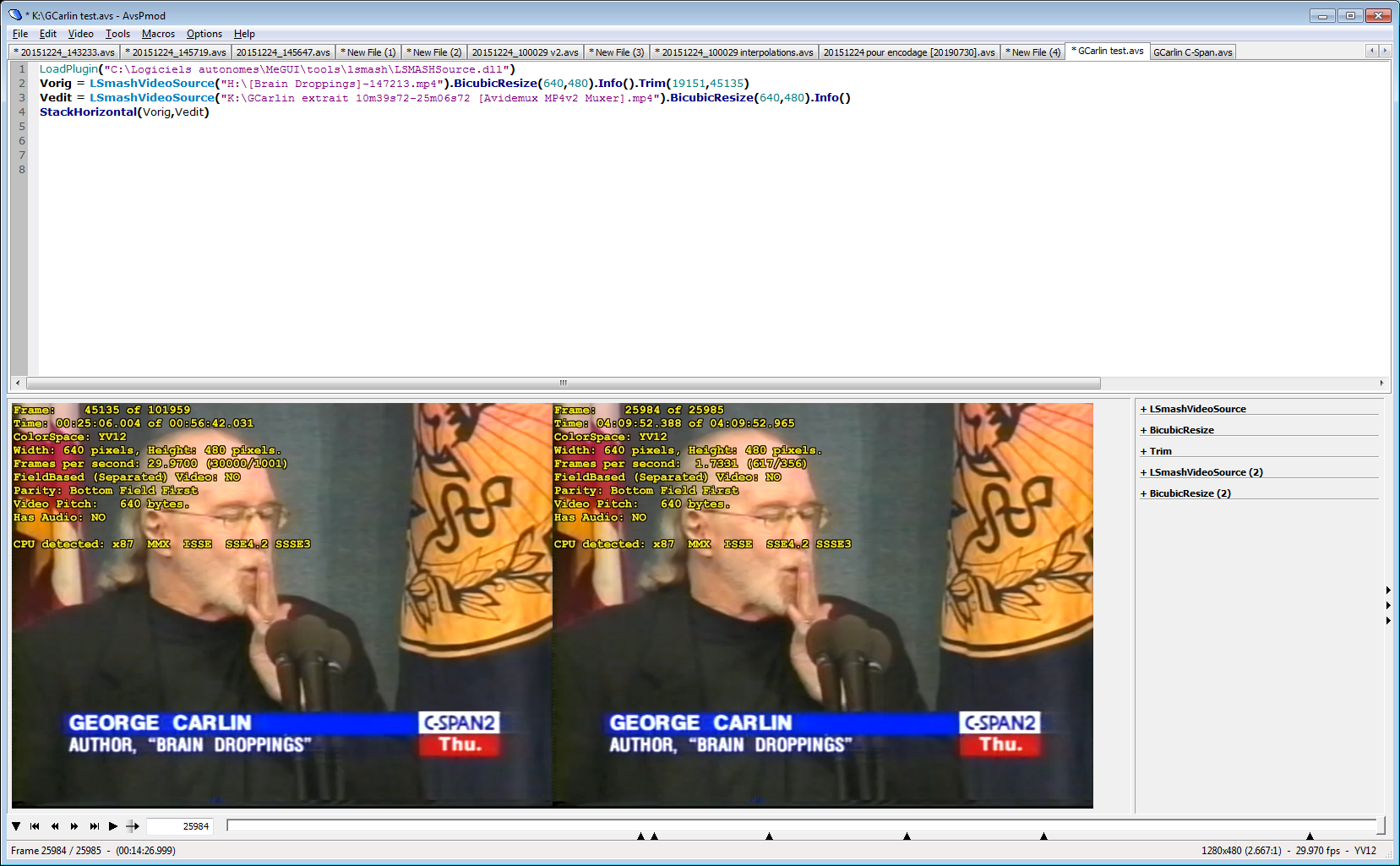

  11. On my computer it says the min is 29.91 and the max is 100.000.
    Then that was introduced by Avidemux when I cut that excerpt. The MediaInfo report above is based on the original full-length file. I get the same values when analysing the excerpt instead.
    When loading the original file and the Avidemux cut excerpt in AVSPMod, using LWLibavVideoSource, and synchronizing them, I can clearly see that many frames which do exist in the full-length file appear as duplicates in the stuttering excerpt.
    Vorig = LWLibavVideoSource("H:\[Brain Droppings]-147213.mp4").BicubicResize(640,480).Trim(19151,45135)
    Vedit = LWLibavVideoSource("K:\GCarlin extrait 10m39s72-25m06s72 [Avidemux MP4v2 Muxer].mp4").BicubicResize(640,480)
    StackHorizontal(Vorig,Vedit)
    So... is this a known issue with Avidemux 2.6, when using the “MP4v2 Muxer” ?

    Maybe this just a muxing problem from trimming?
    It would seem like it. But I don't know if it's somehow due to something somewhat irregular in the source (full-length) video (although it seems to play fine everywhere and to be correctly loaded by LWLibavVideoSource), or if it's a general problem with Avidemux's MP4 muxer.
Name:	GCarlin test LSmashVideoSource.png
