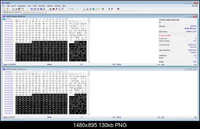

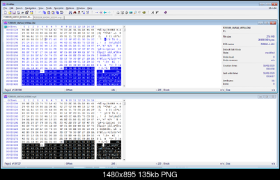

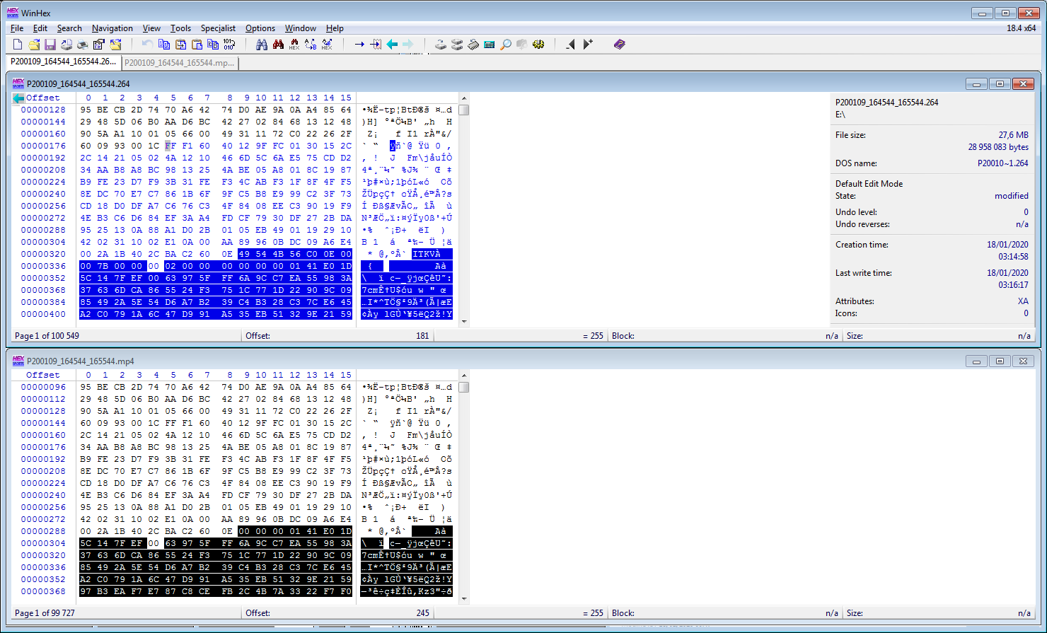

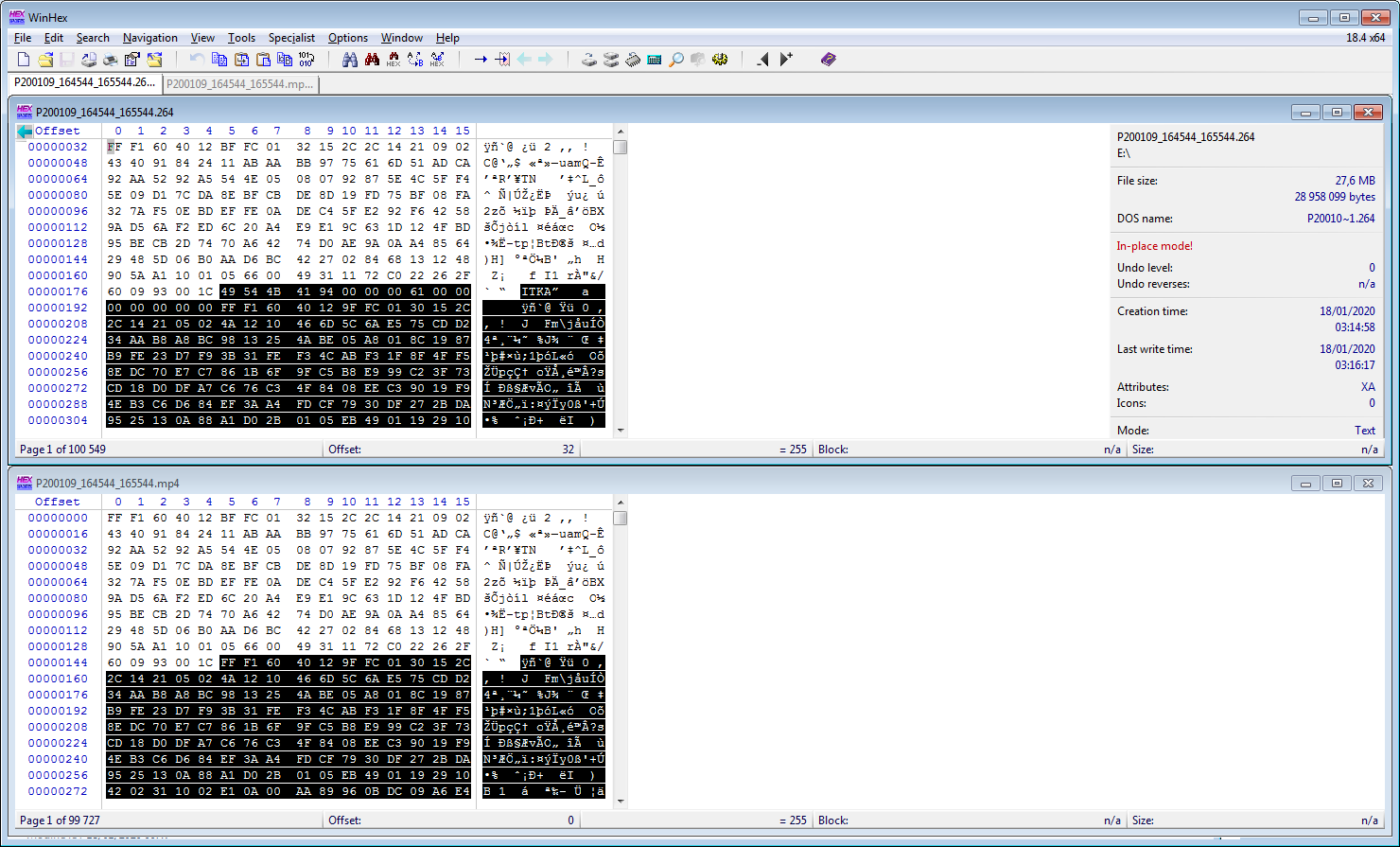

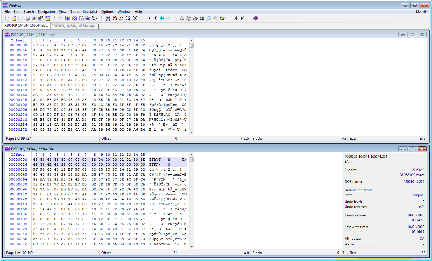

  11. Weird indeed...
    VLC Media Player doesn't read it indeed, but SMPlayer plays the video straight away (only with a “00:00:00” duration, but there's a timestamp displayed on the video itself).
    Tried mp4box : outputs many lines saying “[MPEG-2 TS] TS Packet XXX does not start with sync marker”, and can't remux the file.
    Tried ffmpeg : indeed the file can be converted but only has a video stream.
    Tried to remux the ffmpeg converted MP4 with mp4box, output has about the same size and it doesn't change anything.
    Tried to scan the file as a raw device image with both R-Studio and Photorec, they found nothing (no known header).
    TSMuxer crashes.
    MKVToolNix detects a 27.3MB AAC audio stream, but then converts it (with no error or warning) as a 6.71MB MKA file — which is completely silent when played with VLC. O_o
    Well, not exactly : there's some audible content here and there, for instance near 4m25s, but nothing identifiable.
    MPlayer extracts a 0 byte audio stream and a 27.3MB video stream.
    But Audacity can load the MKA created by MKVToolNix, the duration is 8m10, and the birds can be heard chirping. So by combining the MP4 video remuxed with ffmpeg and the MKA audio loaded into Audacity and exported as WAV or FLAC or AAC, it should be possible to get a playable video with audio, only problem is to get the correct synchronization since the durations don't match. The audio seems normal, so it should be obtained either by setting a delay, or by changing the framerate, or both ; perhaps 11FPS would work (5383 frames / 490 seconds = 10.98).
    SMPlayer also recognizes the MKA audio correctly.

    I tried a very rough hexadecimal analysis, with little knowledge of video files binary structures beyond the basics, found out that :
    - when comparing P200109_164544_165544.mp4 with P200109_164544_165544.264, it appears that the 32 first bytes are stripped on the .mp4 ;
Name:	WinHex P200109_164544_165544.264 ~ P200109_164544_165544.mp4.png
    - if synchronized at offset 0 / +32, both files appear identical up until a “ITKA” string appears in the .264 file — apparently each audio chunk begins with a 16 bytes header indicated by “ITKA” ;
Name:	WinHex P200109_164544_165544.264 ~ P200109_164544_165544.mp4 synchronized 1.png
    - if deleting 16 bytes starting from “ITKA”, the files are identical again, up until a “ITKV” string appears in the .264 file — apparently each video chunk begins with a 16 bytes header indicated by “ITKV” ;
Name:	WinHex P200109_164544_165544.264 ~ P200109_164544_165544.mp4 synchronized 2.png
    - if deleting 16 bytes starting from “ITKV”, the files are identical again, up until the next “ITKA”, and so on...
    Anyway, an idea if all else fails would be to strip the first 32 bytes plus all the “ITKV” chunks from the .264 file, in the hope of getting something that contains only the audio and is somehow recognized as such by any one of those tools... But that's kinda tricky, at least with next to zero programming skills, especially since the audio and video chunks have varying lengths (about 2500-5500 bytes for video chunks and about 140-160 bytes for audio chunks). Did a thorough search : in this .264 file there are 5400 “ITKV” hits and 9375 “ITKA” hits {*} — so doing it manually would be crazy... If anyone has a better idea... é_č
    {*} Sometimes there are two “ITKA” in a row ; but it is strange because with an average length of 150 bytes per audio chunk and 9375 chunks the total size of audio chunks would be about 1406250, much less than the size of the AAC stream detected by MKVToolNix which is about 6.7MB ; perhaps there are bigger chunks somewhere, or perhaps I got this all wrong...
