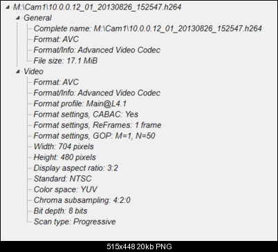

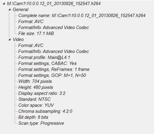

  23. OK,
    It has become fairly obvious, at least to me, that I have no idea what I am doing! When I ask Mediainfo to export the file I cannot find it even though it seems that it is being placed in the Mediainfo file. Since there is no help file associated with the program I guess I am going to need additional help just to get this this file before I can post it.
    SORRY and Thanks
  24. Since I couldn't come up with the file how about snippit

  26. Mod Neophyte redwudz's Avatar
    USA
    Probably the default location for the files in MediaInfo. You can change that in the program. I also didn't have any luck just uploading the text file from MediaInfo to Videohelp. I finally just copy and pasted the notepad file into a post here and that worked. Sorry for the confusion.
    I'm not that familiar with H.264 specifications, but others here may notice something in your file information.
  27. The MediaInfo data looks completely normal for h.264 video in an elementary stream. There's nothing there that would indicate why programs that normally work with h.264 elementary streams would have problems with it.
  28. Thanks for all the help. It is starting to look like it's just not in the cards for me to get this done. I tried all the fixes that were suggested and have seen no viable results. Guess we will result to only viewing the clips with the camera software. Again, thanks for all the help.
