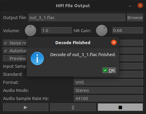

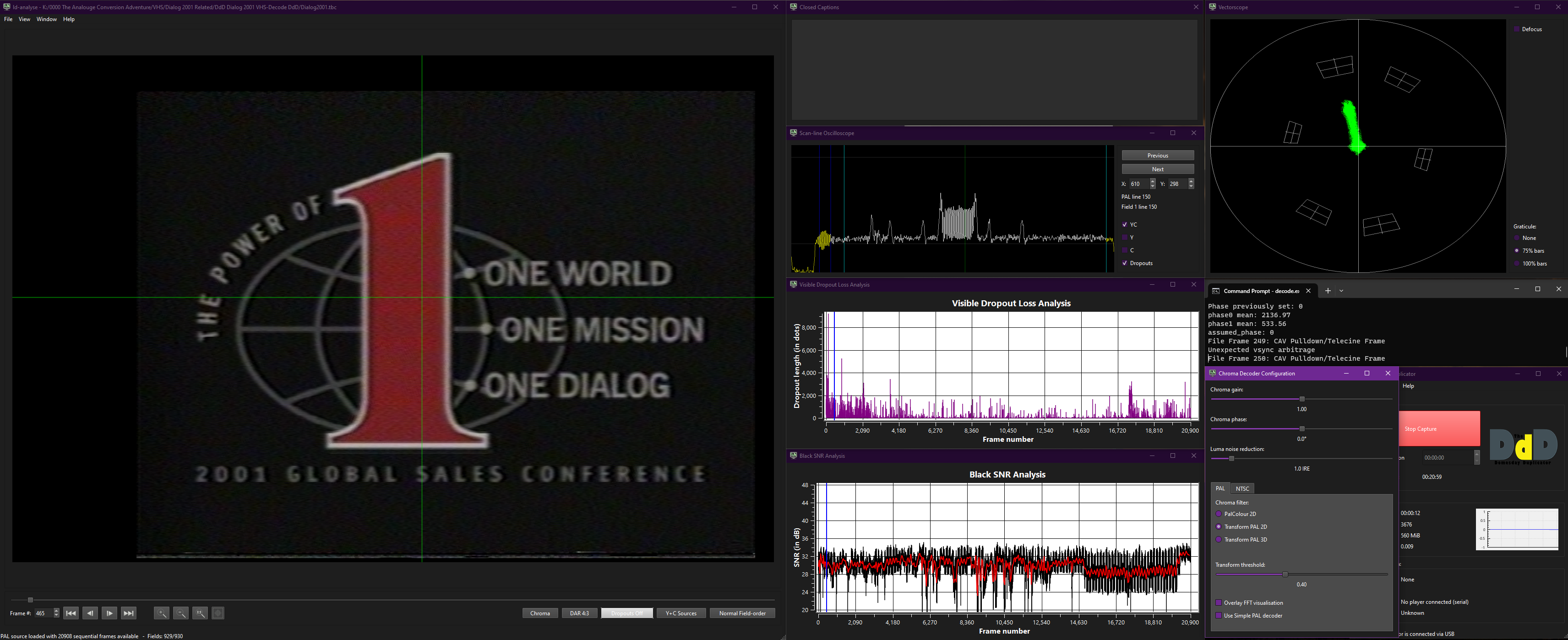

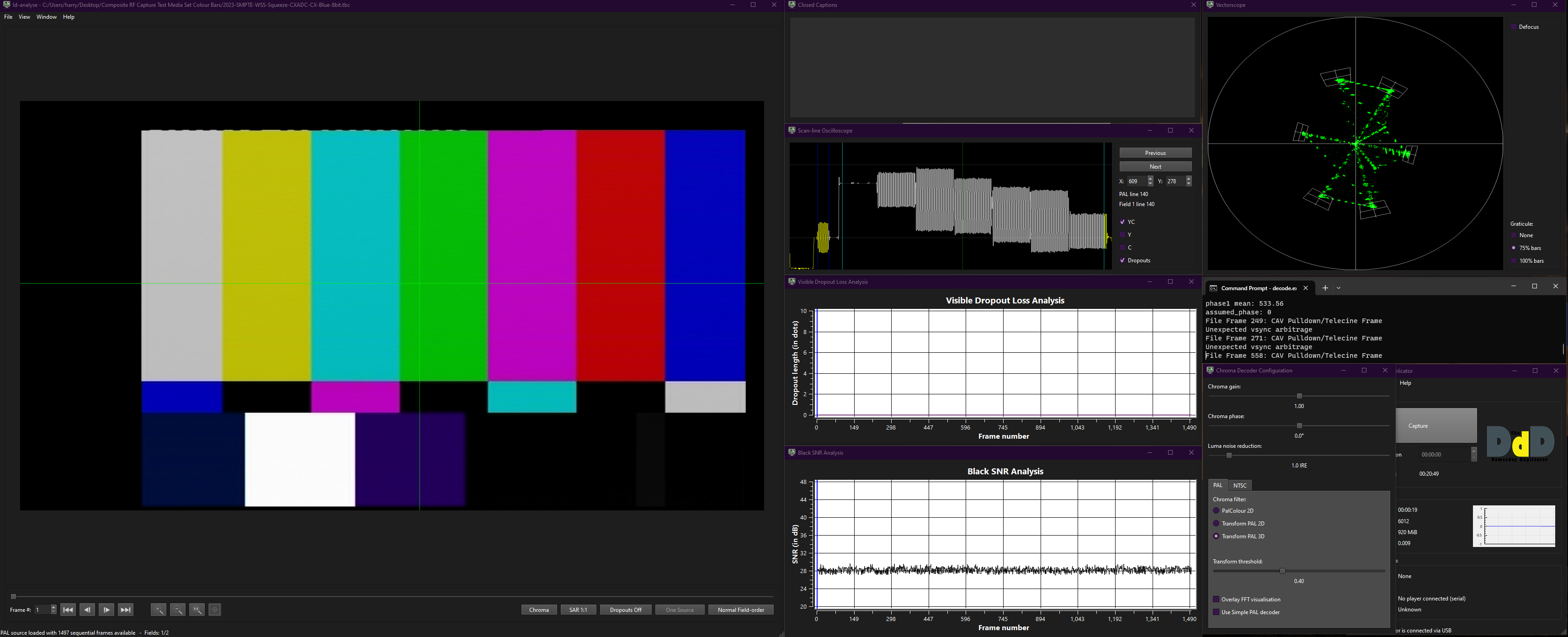

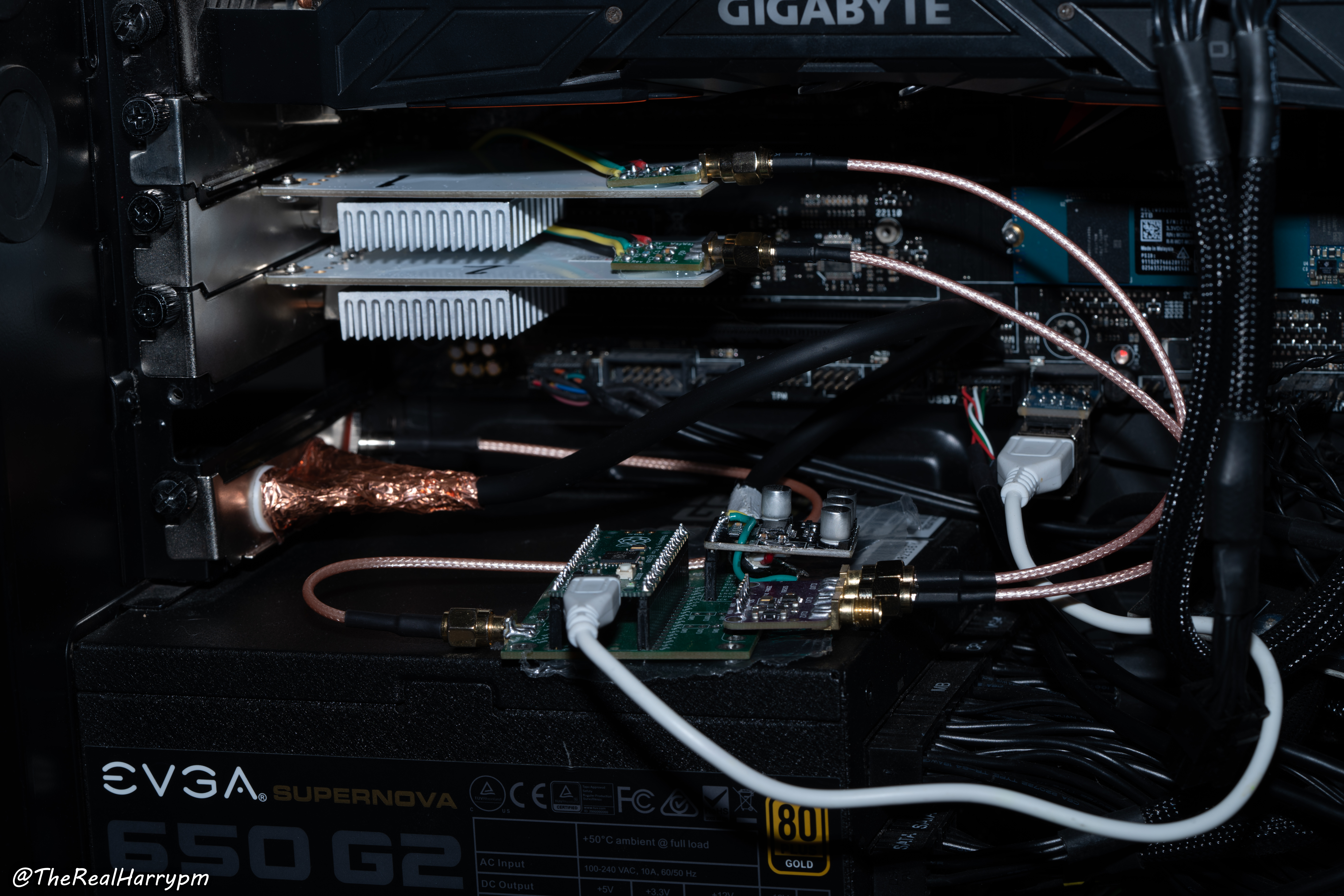

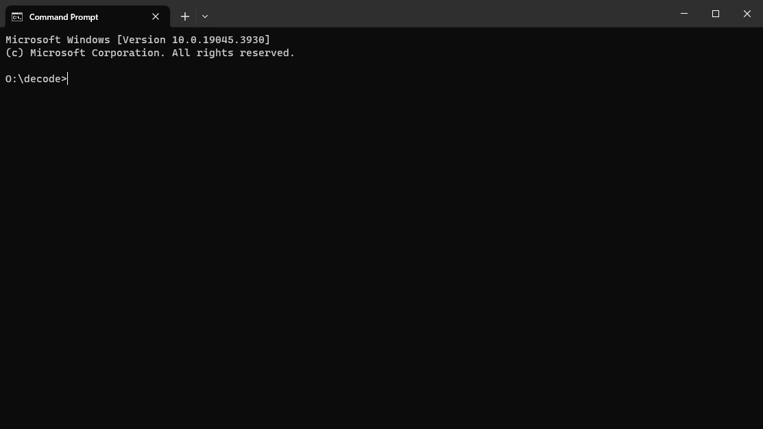

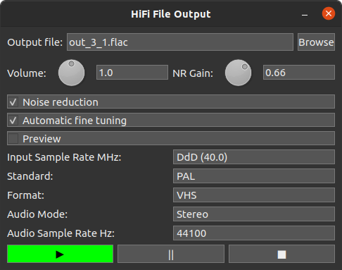

  5. For the 20 people who still look though this thread for project update info, which as mostly been abandoned compared to reddit and discord and the commit logs of the project its self alongside the wiki.
    I figured I would post about the new hifi-decode GUI and some new dark mode snips overviewing the GUI tool chain, also the new tbc-video-export tool which has full Linux/Windows/MacOS x86/MacOS Arm support and makes fully complient FFV1 files V210 files and soon with some updates broadcast complient ProRes files for Mac users.
    Recently there has been a focus on build automation, meaning every update will automatically get built into archival ready self contained binarys zero external depedencys required, this has already been fully setup for the export tool and will be for the new metadata tool which will provide graph data image and vector assets alongside automatic PDF reports in a human readable format with a single command.
    Also the conventional capture argument has been killed by a German, yes I know americans tired and the japanse hoped, but its over now thanks to MISRC "Multi Input Simultaneous Raw RF Capture" the name is pretty dead pan but It can do RAW S-Video or RAW CVBS capture at 12-bit resolution so basically its as good as your current gen capture chain chips with 40/65/85msps options just change a Crystal/ADC package and change the firmware a little for your desired speed 40msps is what we have settled for the standard release, comming to a chinese fab near you soon!
    This means people will have a plug and play duel channel capture device for Video RF + HiFi FM (+ Linear/TC/Ref via sub board) this is in additon to the next docs update featuring the workflow for the current syncronised CX Cards which provides a clear upgrade path for exising CX White card users or new commers who like a pure CLI or PCIe based workflow that is highly scripted at under 100USD cost to anyone in the world market wise even with new optimised amplifyers.
    Thanks to these new upgrades for the CX Card, a new mod is on the horison for existing DomesDay Duplicator users, providng an audio capture device using the same clock so Video RF + Syncronised baseband audio capture this will be comming in the next few weeks to months as its tested and standerdised.
    Also we figured out how to make lower end HanTek ossiliscopes output direct samples, they work for CVBS/FM capture too so a new additon to the ever expanding list of FM RF archival ready devices.
    Now for some images!

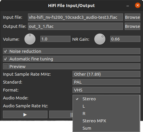

    HiFi-Decode
    [Attachment 76656 - Click to enlarge]
    [Attachment 76657 - Click to enlarge]
    [Attachment 76658 - Click to enlarge]
    ld-analyse toolchain in use
    VHS-Decode
    [Attachment 76660 - Click to enlarge]
    CVBS-Decode
    [Attachment 76659 - Click to enlarge]
    TBC-Video-Export
    S-Video --> FFV1
    [Attachment 76663 - Click to enlarge]
    Composite --> FFV1
    [Attachment 76662 - Click to enlarge]
    On these notes happy newyears & Chinese newyears and happy FM RF archival, and decoding forever!

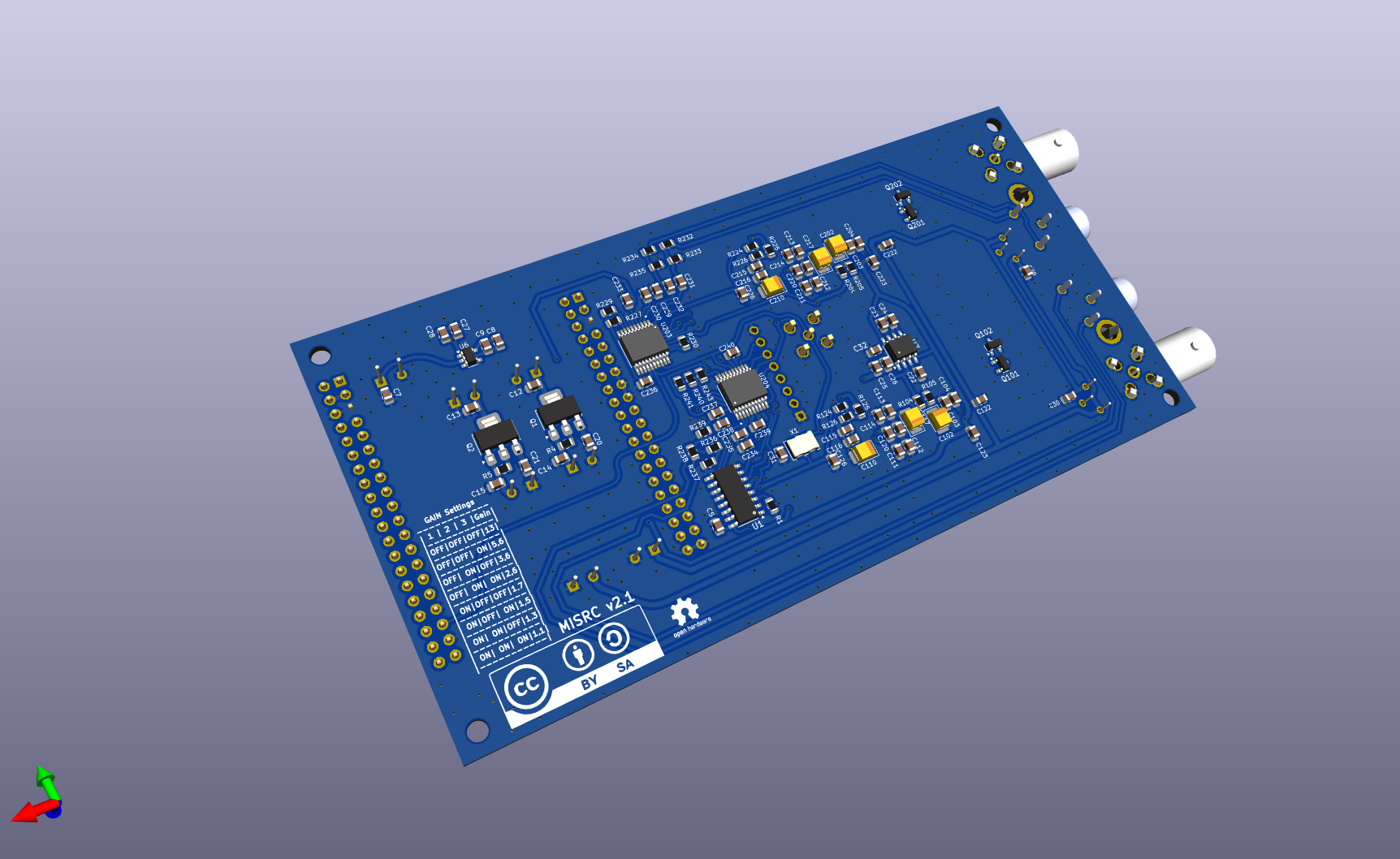

    As far as I know audio for video should always be 48KHz not 44.1KHz, the only case I see 44.1KHz could be used is when capturing HiFi audio from a music video to save audio only.
    How long does it take to decode one hour capture file? I may give that MISRC hardware a shot when it becomes available.
  8. HiFi-Decode is just sampling from the FM signal not baseband so the decoder is entirely software defined output, you can define anything upto 192khz (24-bit interger) I will note these images is just the inital demo snips used as the commit refrance, more accurate ones to current workflow will be used for the userguide although GUI is just a bit of polish, carrier adjustment mini-game comming soon.
    But for clarity the toolchain and recommended workflow is 48khz even the RTLSDR Decode scripts use 48khz for realtime HiFi FM decoding.
    HiFi-Decode is real-time able with enough raw compute tossed at it such as a AMD 5950x or newer but will improve over time its 20-40msps files that will be slow today, noise processing is the big hit compute wise.
    For video decoding speed thats a verible question relative to sampling rate of your captures really Speed Testing Doc exits to jornrnal the speed gains with newer hardware 16fps video decoding speed has been achived last year with the M2 Ultra with newer hardware even faster should be possible but not everyone can get top end CPUs tested as soon as it comes out.

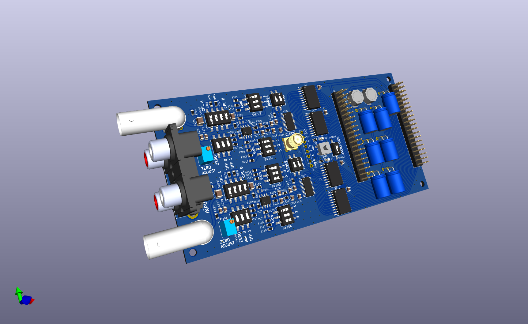

    So with the new MISRC hardware, is capturing both RF HiFi and RF video with perfect sync into one single file possible? or separate files are created and muxing and syncing them is part of the decode? Also would it be possible to add a convenient 2ch audio ADC for linear input into the hardware?
  10. Originally Posted by dellsam34 View Post
    Its 32-bits of data in a .bin file then the extract tool currently makes 2 files for the signed or unsigned format data streams .s16 or .u16 from 12-bits actual data, then that can be FLAC compressed filtered and down-sampled or decoded directly.
    Key point being there is a extra 8-bits of bandwith for an audio ADC for so HiFi ref + linear + timing signals like head switching or anything else etc this a very dev board style duel ADC setup with a lot of applications with just a flick of a few switches and a little firmware tweak here or there it can be used as a ossiliscope upto the 2v range.
    The hardware sync is crystal perfect, and there is a SMA for external clock output for outher devices, but some level of software automated checking and alinement is required for dropped frames and such, but we already have tools for that written when the CX Cards were being modded to do the same thing.
    There is plans for a 4 port TRS/XLR combo jack sub-board with so balenced inputs ready for use on everything from VHS to Betacam decks, its just a matter of finalising a design and doing test fab runs.

  15. The audio inputs on the MISRC are put on a sub board to allow for different configurations - it's not there as an afterthought - the design is still being worked on. vhs-decode is a community project that is continuously evolving, not a commercial offering with capital backing it, so you shouldn't treat it as one. I feel you are talking as if we're intentionally making it complicated - it's just a community project with limited resources so the software and hardware still needs a lot of work yet. I agree that audio sync is an issue currently, of course some of that also comes with the nature of capturing the raw undecoded signal and having up until now having to use capture solutions that haven't really been designed for this use case that have just had a single input.
    while most pcs have perfectly functioning audio inputs, that you can resample at will and match to video you're capturing.
    it's so unthrifty, so unprotestant.
    You can't easily do it that way and have it work properly, the audio capture needs to be on the same clock as the video capture to be synced to it properly in post unless you have some other reference point like say doing a conventional capture with audio. It's not the same as syncing audio to already decoded video that virtualdub does, one would need to be able to reliably decode the video faster than realtime to be able to do something like that which we are not anywhere close to at the moment. And no you don't have to capture head switch to be able to sync audio.
    As for making a self-contained system, it seems SingMai looked into this this as a commercial solution judging by the thread they made but gave up and went with just a composite/YC capture thing instead and even that comes with a pretty hefty price tag so I guess it's not so simple. And, if you are decoding on the fly and outputting a finished YUV signal you also lose the ability to refine the process and tweak parameters later which is also part of the point of this project.

  27. I feel like there has been some selective reading of the diagrams, not to mention lack understanding of this is a family of projects that only work together, because of the generic open source nature and unified community, there will be no magical black boxes or affixed workflows only options that are decided by the end users wallet and time.
    There is a whole "reference capture" line with most all of the diagrams, in any serious usage there is no assumption RF is the only thing being captured even if its just a GV-USB2 or a BMD SDI chain with a DMR-ES10 or something.
    Hardware of FM RF capture and the software workflow in of its self are 2 separate things, they always will be treated as such due to well things like RetroRGB calling it the "DomesDay Method" being a conflated term with clear issues of limited potential as the hardware is affixed the software is always being improved, the two are only married together if doing it all yourself. Now if your just pulling down a archive that's already made everything is pretty handed to you on a platter so that conflation is just annoying.
    The Clockgen Mod brings everything most users actually "need" today at a reasonable price of sub 100USD use case dependent.
    [Attachment 79680 - Click to enlarge]
    I'll just address the MISRC situation as this is not the community discord, and all info posted before is out of date on the subject and or should be assumed out of date after a week or month passes.
    The MISRC v1.0 is the base development version that's what you see on the main repo currently.
    (Both have AUX pins, audio was not a after thought it was a matter of get the core working first, then move onto how we want to deal with audio, and we also needed a PCM extractor tool, that's now been developed and has a binary)
    The MISRC v1.5 revision I have been working on optimized little things like vendors, replacing the BNCs with more practical ones or allowing SMA to be used.
    From a R&D point of view a stripped down dev board makes sense for people who want to implement there own audio boards with RCA or XLR etc, open source mentality nothing is a dead end black box and can be re-designed around newer chips or different SKUs or configurations.
    The MISRC V2.1 version we have 4ch audio capture via two PCM1802 chips built in (at full rate of 78125Hz 24-bit), would you like fries with that order?
    [Attachment 79647 - Click to enlarge]
    [Attachment 79648 - Click to enlarge]
    And yes we have plans for shielded cases too, but when you consider 300-700USD+ cost to run a test production batch the units, this is a slow and costly validation process that is out of my pocket and members who chipped in to get there own boards to help develop this out, I have the V1.5 physically in hand and there is a rough December release plan for this new v2.1 version
    Last edited by harrypm; 6th Jun 2024 at 10:30. Reason: Link to IA demo tape example.
