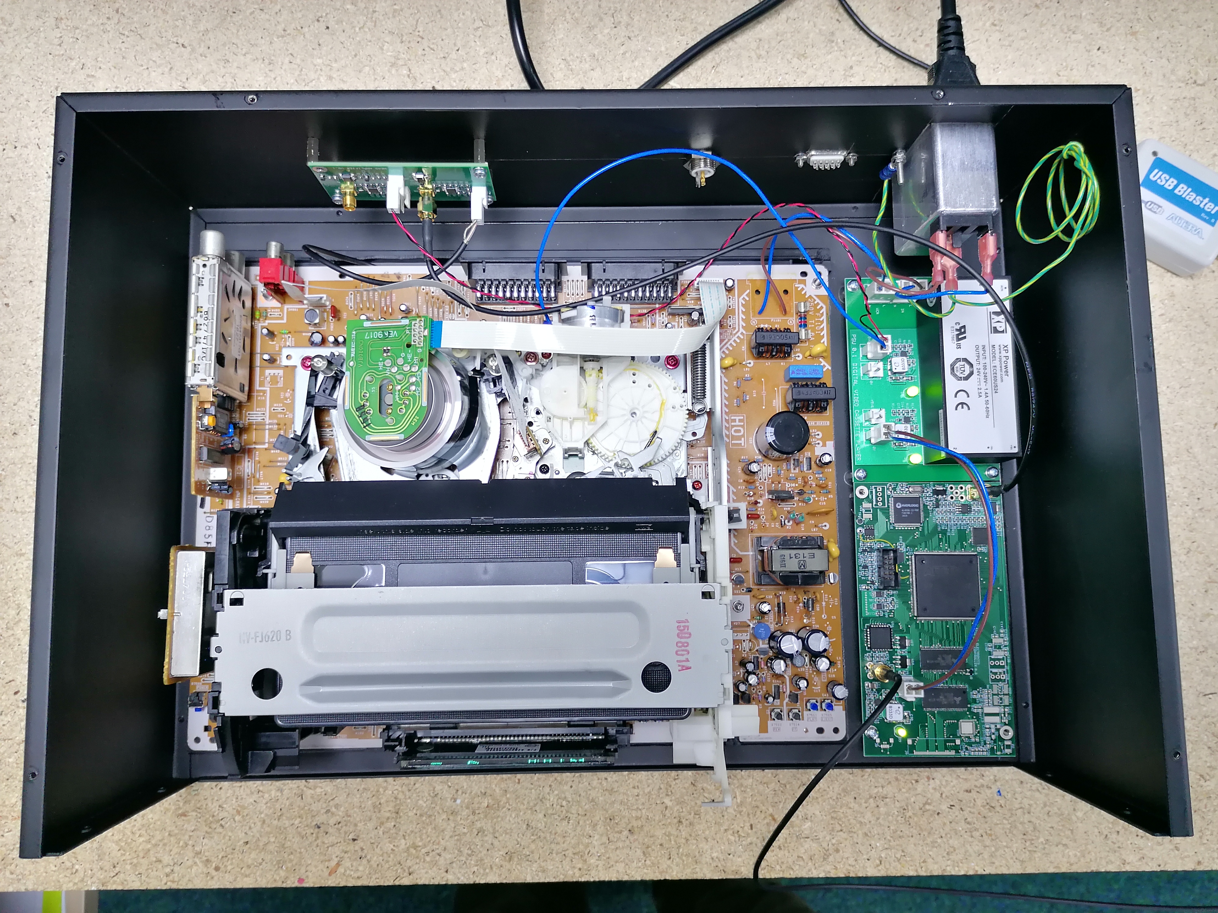

    [Attachment 59611 - Click to enlarge]
    "SingMai are currently developing an improved VHS player which will allow faster than real time, higher quality transfer of valuable VHS tapes to a more modern digital medium."

    The image at the top of the page is from Daniel's personal blog. At the bottom of one entry, he posted an image of an FPGA board wired to what looks like the guts of a '00s Panasonic VCR inside of a black box; the power supply is silk-screened as "PSU 0.1 Digital Video Cassette Player" and the board hooked up between the VCR section and the FPGA is "Head Amplifier v0.1".

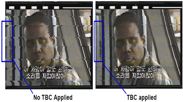

    The SM03 with Y/C input is finally out but no USB3 so a SDI to USB3 adapter or a SDI PCIe card is required for data streaming to computer, I hope SingMai will adjust their prices so the consumer crowd can afford them.

  17. Looks like it's all done on FPGA rather than using a off the shelf video decoder chip, so the actual decoding processes can be updated with new firmware.
    Where is that tbc image from? It's neither in the pdf doc or site for the SM03
  18. Capturing Memories dellsam34's Avatar
    Jan 2016
    Originally Posted by lollo View Post
    It seems an excellent piece of hardware. Unfortunately no Y/C input.
    What makes you think it doesn't have Y/C input, have you clicked on the link I posted.
    I won't be doing any tests since the device is way too expensive, If SingMai wants to send me one for testing purposes I would be glad to compare it to some few devices I have.
    It's from their server in a link to the SM03.
