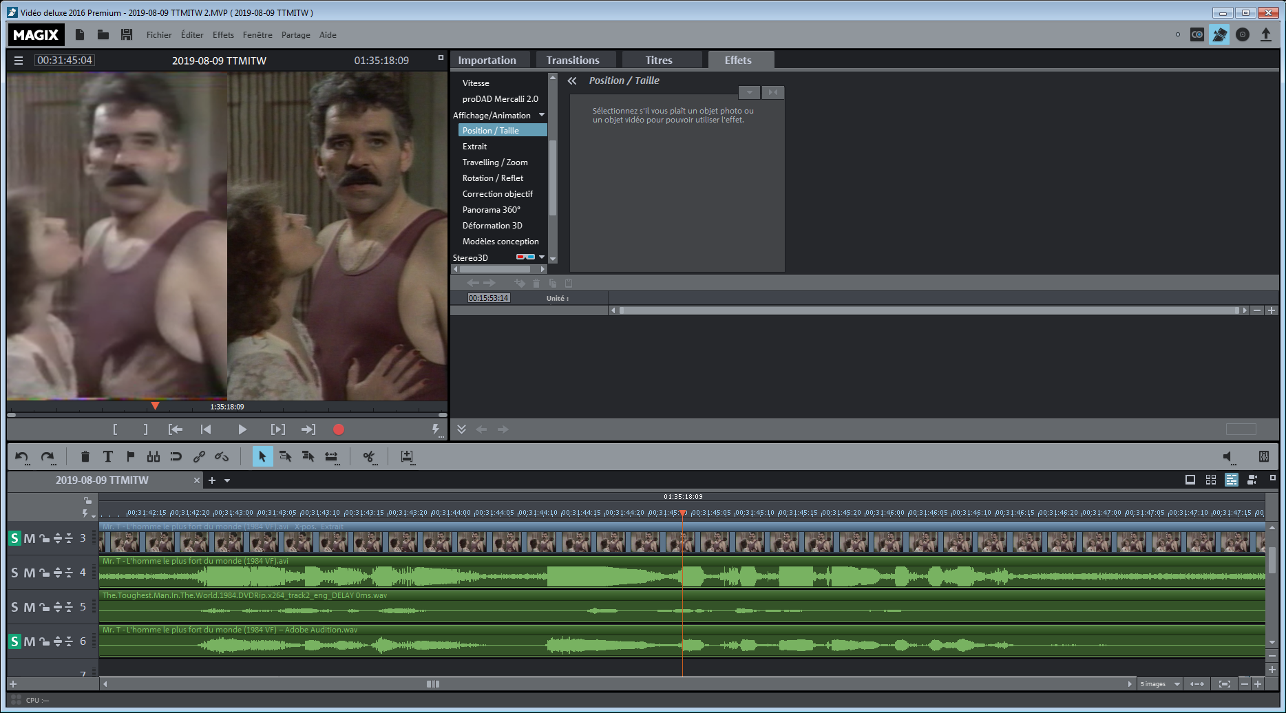

If I import both video files into the (Magix) NLE (direct import for the dubbed version, while the MKV file is imported through an AVS script loaded with AVFS), synchronize them precisely at a scene change near the begining, and scrub through the movie, I can see that it quickly goes out of sync (at this point I only check the picture), the MKV plays sligthly faster. Now if I listen to the audio, I notice that it gets progressively out of sync. It's also out of sync in VirtualDub2 with the same AVS script :Code:Video stream :- Duration: 137471 frames, 01:34:28.498 ColorSpace: YV12 Width: 708 pixels, Height: 480 pixels. Frames per second: 24.2517 (3468/143) FieldBased (Separated) Video: No Parity: Bottom field first. Field order: Unspecified Audio stream :- Audio length: 272094720 samples. 01:34:28.640 Samples Per Second: 48000 Audio Channels: 2 Sample Type: Integer 16 bit
I simply extracted the AC3 track with gMKVExtract, and converted it to WAV with ffmpeg. If I import the WAV audio into the NLE and synchronize it with the non-dubbed video, it does have the same length and the wave form looks identical throughout. What's wrong here ? (And I thought that only the dubbed file would be an issue... I don't like it when there are so many moving parts and I don't know which one(s) I can rely on !...)Code:V = LWLibavVideoSource("The.Toughest.Man.In.The.World.1984.DVDRip.x264.mkv") A = WAVSource("The.Toughest.Man.In.The.World.1984.DVDRip.x264_track2_eng_DELAY 0ms.wav") AudioDub(V, A) -

But if I put either of those files and the dubbed one on the NLE's timeline, and synchronize them right after the introduction, they stay synchronized (give or take 1-2 frames) up until that discontinuity at around 16m00s. Then once the audio track is cut and adjusted they stay synchronized again up until another discontinuity at 31m45s : a weird glitch on the MKV, with several frames missing and a sudden crack in the audio track, in the middle of a shot (that glitch is also present on the AVI file so it must be on the source DVD).
[Attachment 49793 - Click to enlarge]
[Attachment 49794 - Click to enlarge]
So it should be manageable to get something watchable, if it takes a few adjustments every 15 minutes or so...
